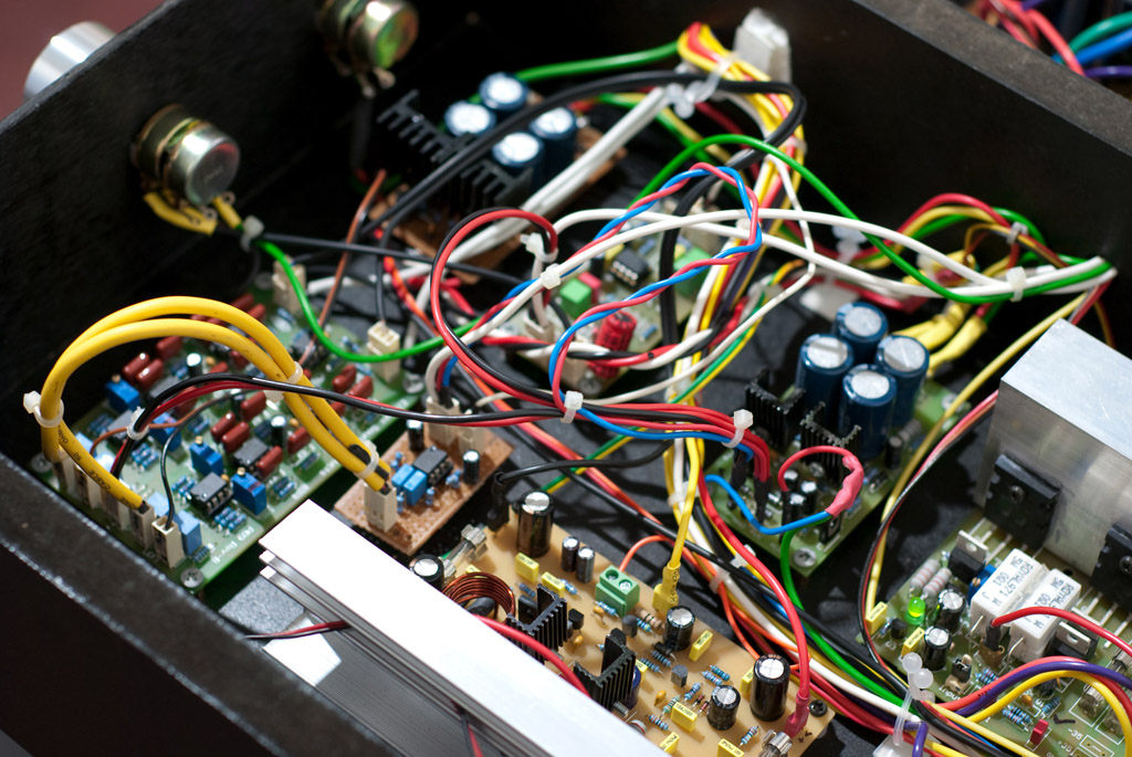

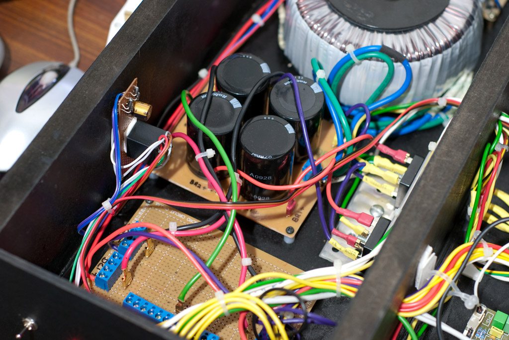

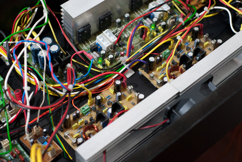

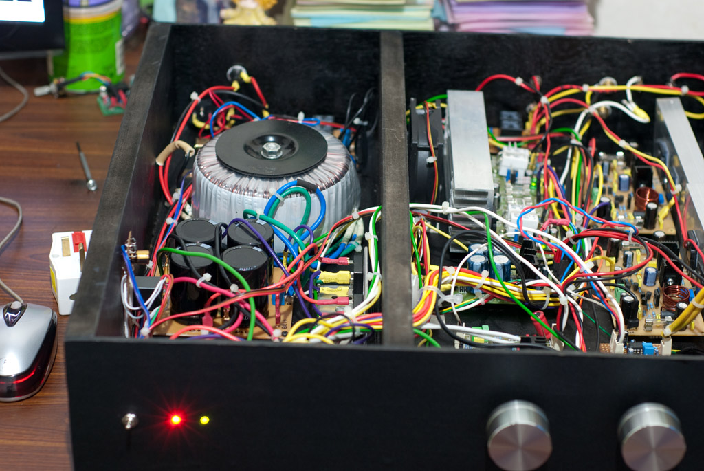

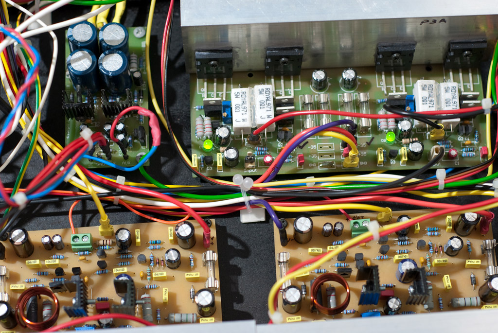

My Tri Amp System, Carlos DX Blame ST and Elliot P3A Bridge for the Sub
Hello Carlos my friend, this is my completed Amp, its properly DIY even the Casing is Made out of MDF, No noise issues, Dead Silent, I love the sounds of the DX Blame ST, Fantastic, Thanks so much Carlos, here are some pictures.😀
Thank you very much Zeraphine....nice pictures
I am glad you are enjoying your amplifier...this makes my day!
