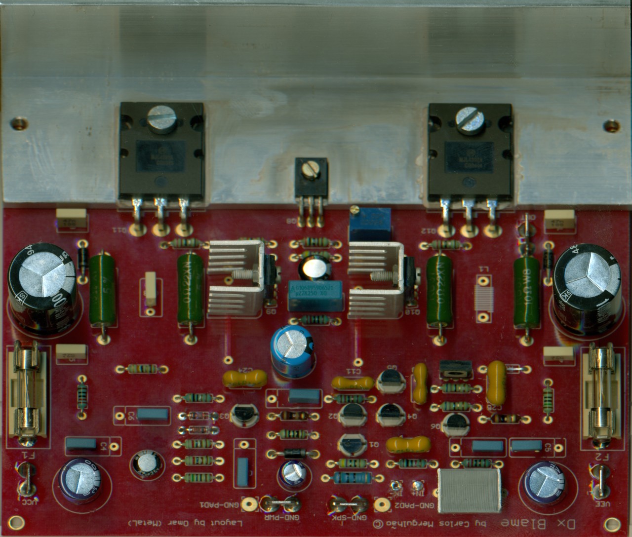

meanman, I built the ES version of this amplifier. I measured around 10mV of DC offset, this is OK with me. I calibrated mine to 25mA quiescent current, this is fair enough for me as well.
I ran both channels, they worked on the first run, no problems, no oscillation and no heat problems, this has been an amazing experience that an amplifier with many components runs first time connected to the mains. Honestly, did not spend much time checking what I soldered!
They are very very very silent, even when I am not connecting them to any source, they are deadly silent!
This is best DIY amplifier I heard indeed. Highly detailed rich highs, excellent mids and bass is just fair n OK with me. I did not expect this DIY amplifier to be so good, it deserves every penny I paid for it, even the two months of PCB art work I spent with Rudi on it. What makes me even happier is that I can go to the ST version in no time! But I dun think I will go there, I am happy with the ES version, and it is stable!
Making the angled heatsinks and drilling them was the best part of it, it was not easy to drill them manually as they are 4mm in thickness. I used bigger bolts, 3.81mm, so I had to drill both, the output transistors and PCBs, it was real fun!
The smaller heatsinks were the ones I left space for, and they exactly fit, very nice indeed, very nice, I like them so much. The transistors TO-92 spacers are from Farnell, the order code for them is 519960 for those interested in making their amplifiers look neat and beautifully assembled.
Still I got to wind the output coils now!
I hope you are enjoying your amplifier meanman, it's damn good, thanks to Carlos, whom we are waiting to come back, impatiently! I hate this sinbin thingy...

I did not even use a toroid. A couple of months ago, I put my hands on a 24x2 EI Japanese transformer rated at 240 watts and I am using it with the two Dx Blame ES channels. This is more than enough for me, as you can see, we are not going to party with it. For moderate listening levels, this serves just excellent.

The PCB quality is excellent. I have already unsoldered many parts, especially the TO-92 transistors because I for got to use the spacers, also unsoldered many resistors and capacitors, this PCB was capable of overcoming harsh unsoldering process indeed, it was on purpose to see how good it is, and it turned out to be excellent. The good thing is that pads are large, soldering was fun with this PCB.
