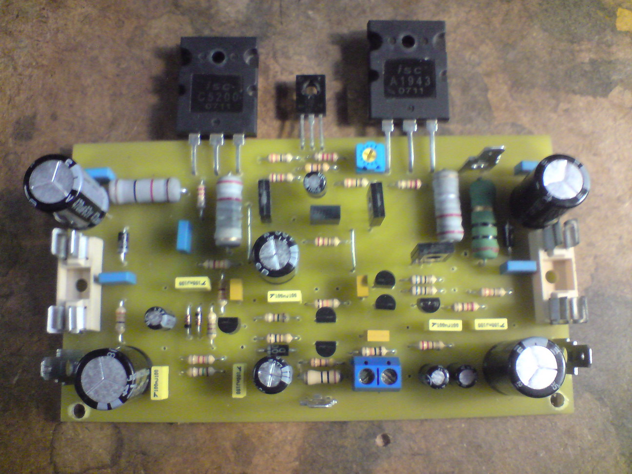

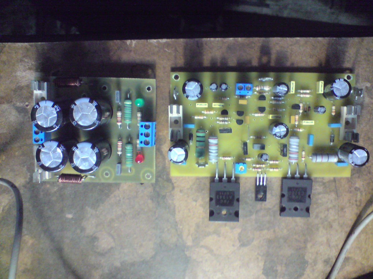

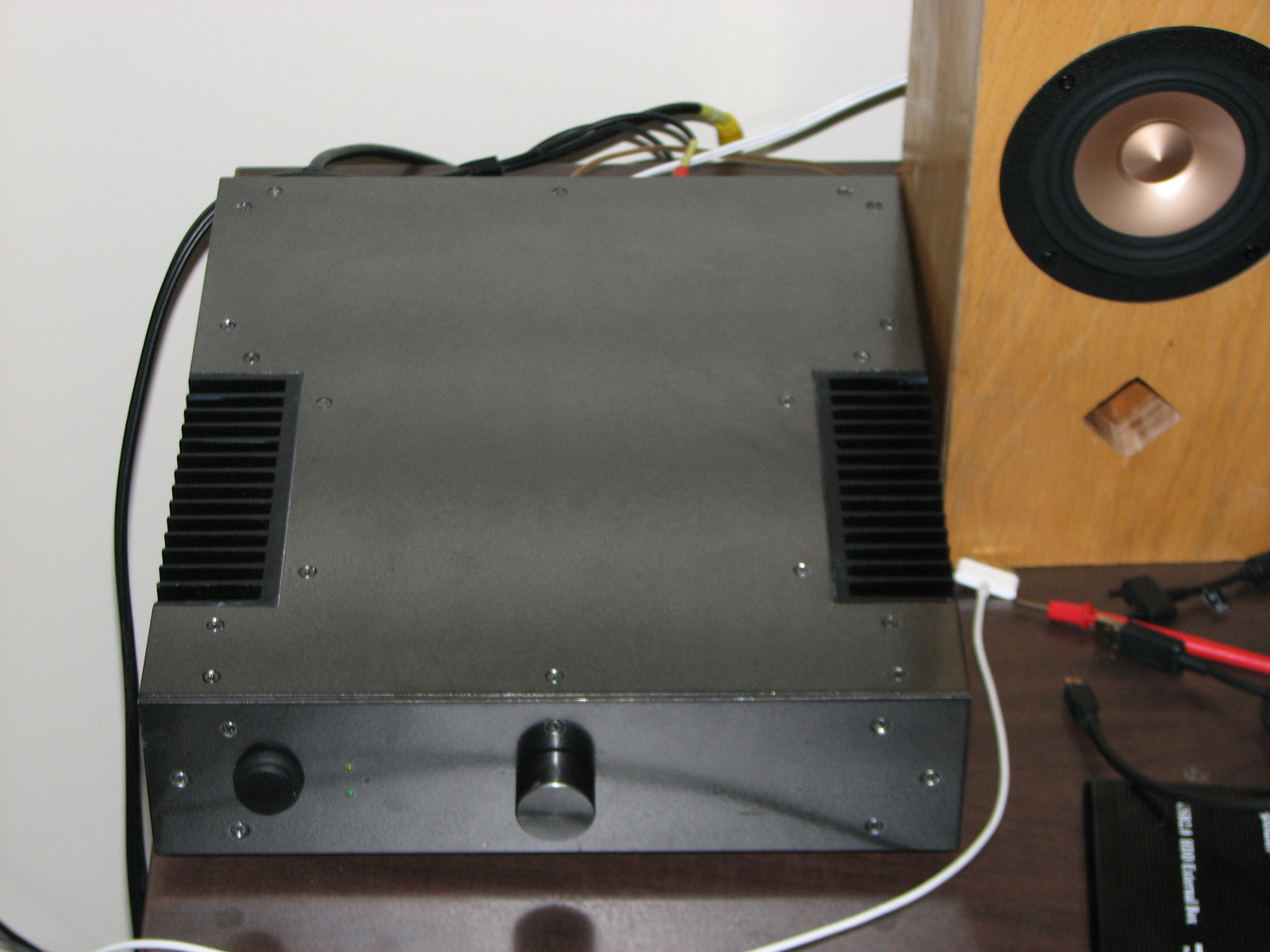

DX-ST Complete
Hi Uncle Charlie,
I completed my DX-ST last week already. I was to busy listening to this wonderful amp and forgot to post some pics here. My comments: This is a wonderful amp. Sound is excellent and bass is strong. No switch on or off thumb. I will get my supply transformers tomorrow and assemble complete unit over weekend. Cannot wait.......will keep you posted......😀😀😀😀

I receive this news with undisguised joy dear Macd
You've always been interested in our Corporation, the Dx Corporation, the happy audiophiles Union... now going to 600 members.
You use to assemble uncle charlie amplifiers, and this is very much appreciated, also your presence back here again.
I thank you by the confidence, the preference to assemble a Dx amplifier, when we have other good ones in our forum..you're an excellent member of our Corporation, someone developed, that has experience, skilled to assemble, does not brings doubts to the forum, never tries the change projet items...simply build and trust, in a very silent and efficient way.
I love all builders, but of course i have some of them i love the most...the golden frame to your picture (send me) in the hall of fame of the Dx Corporation Headquarters, the highest position in the wall, reserved to golden five stars members.

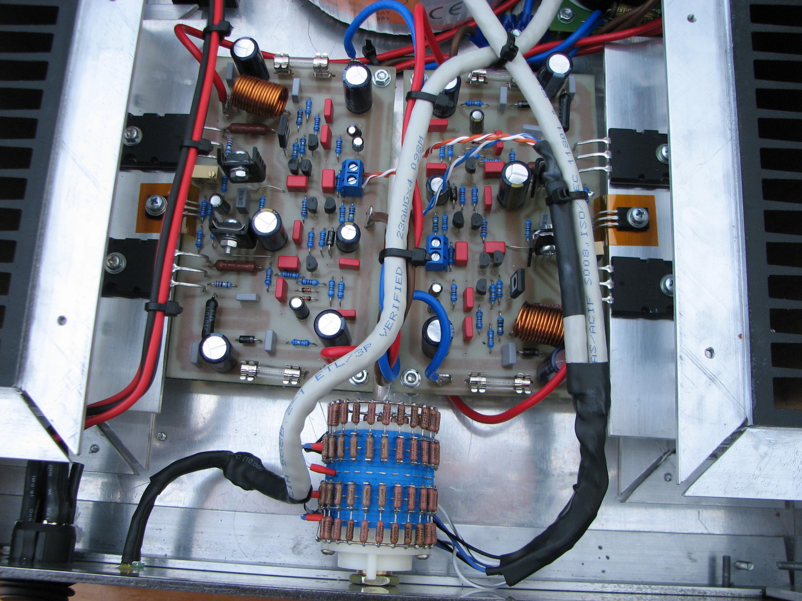

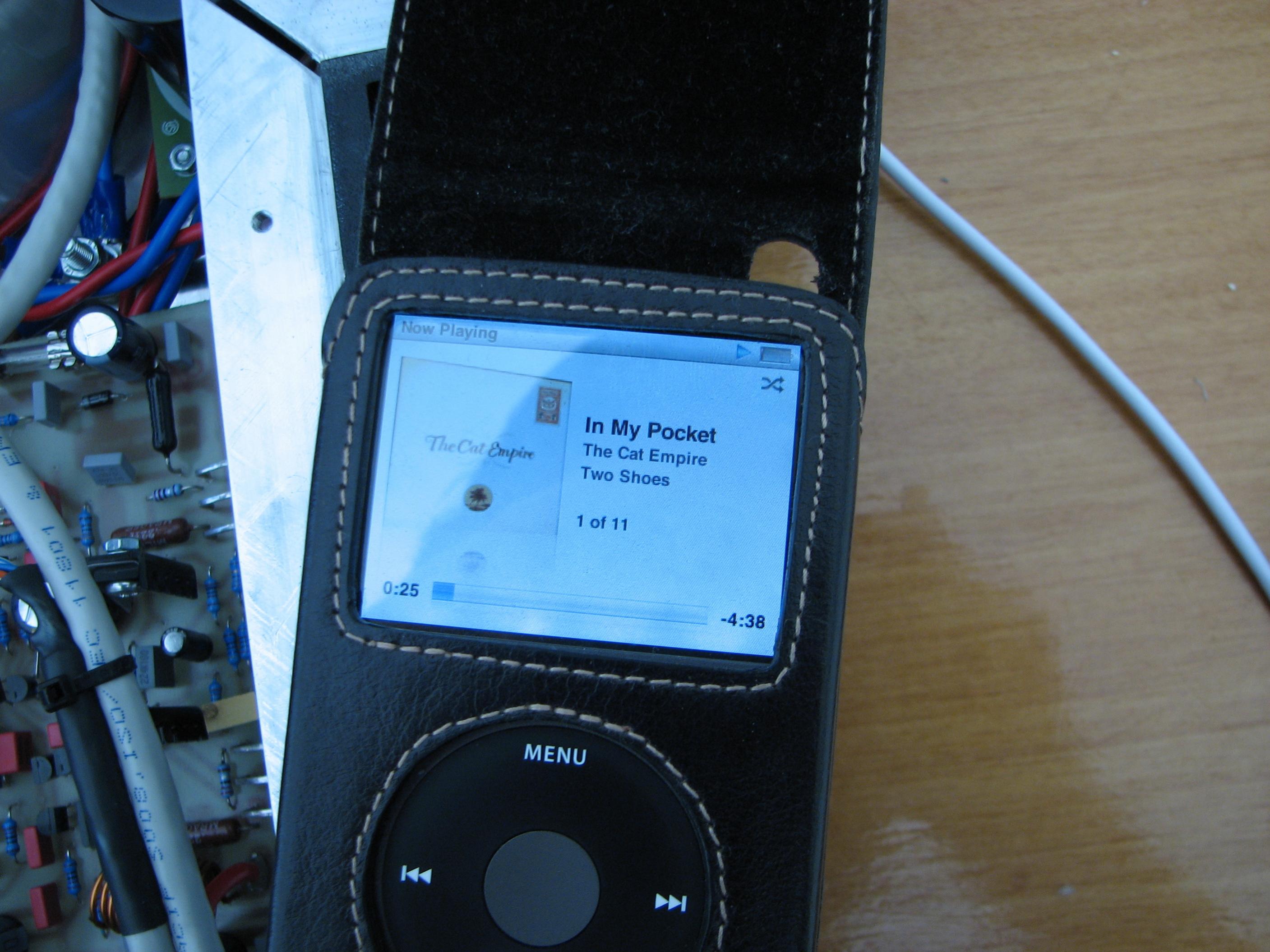

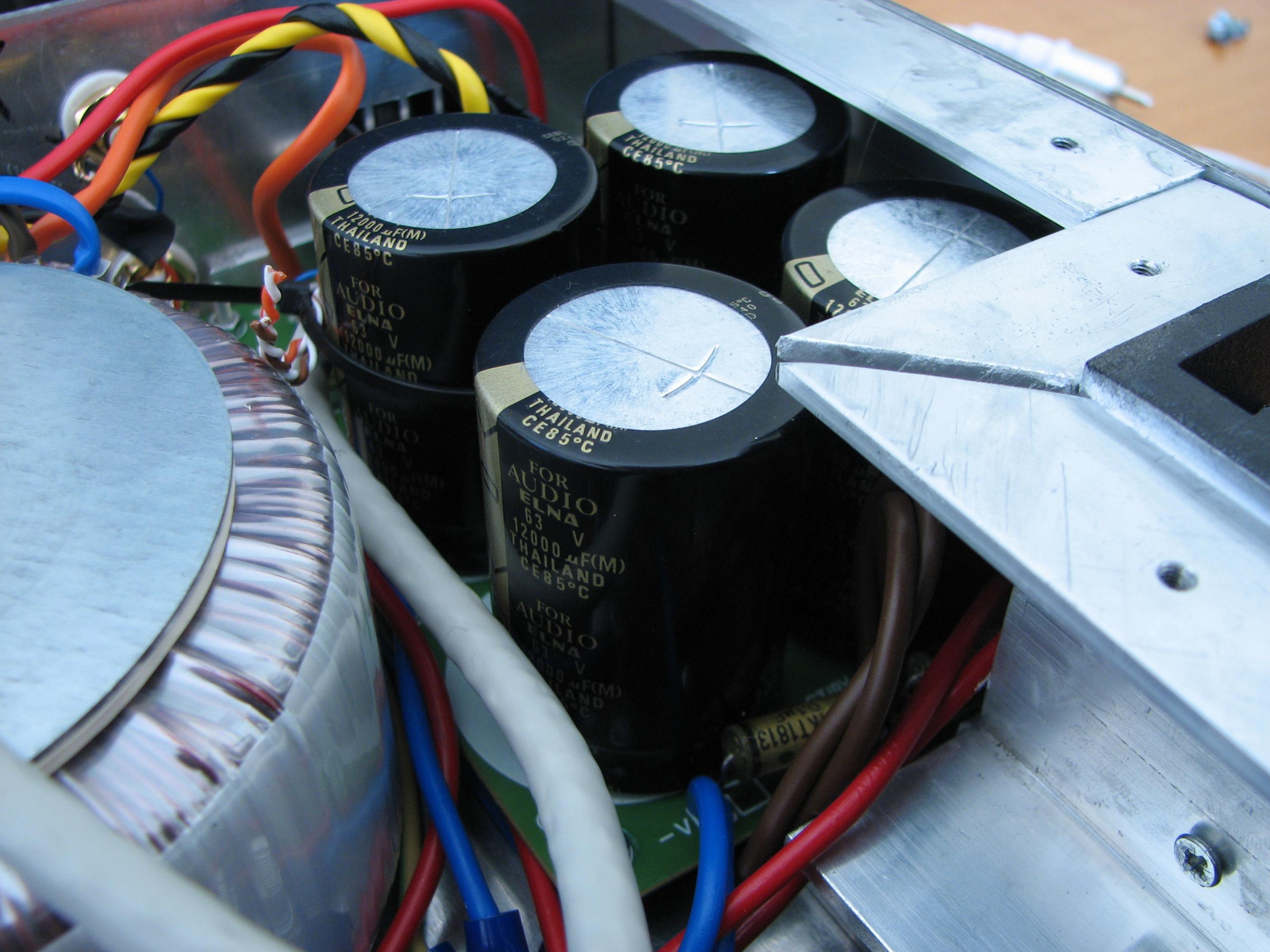

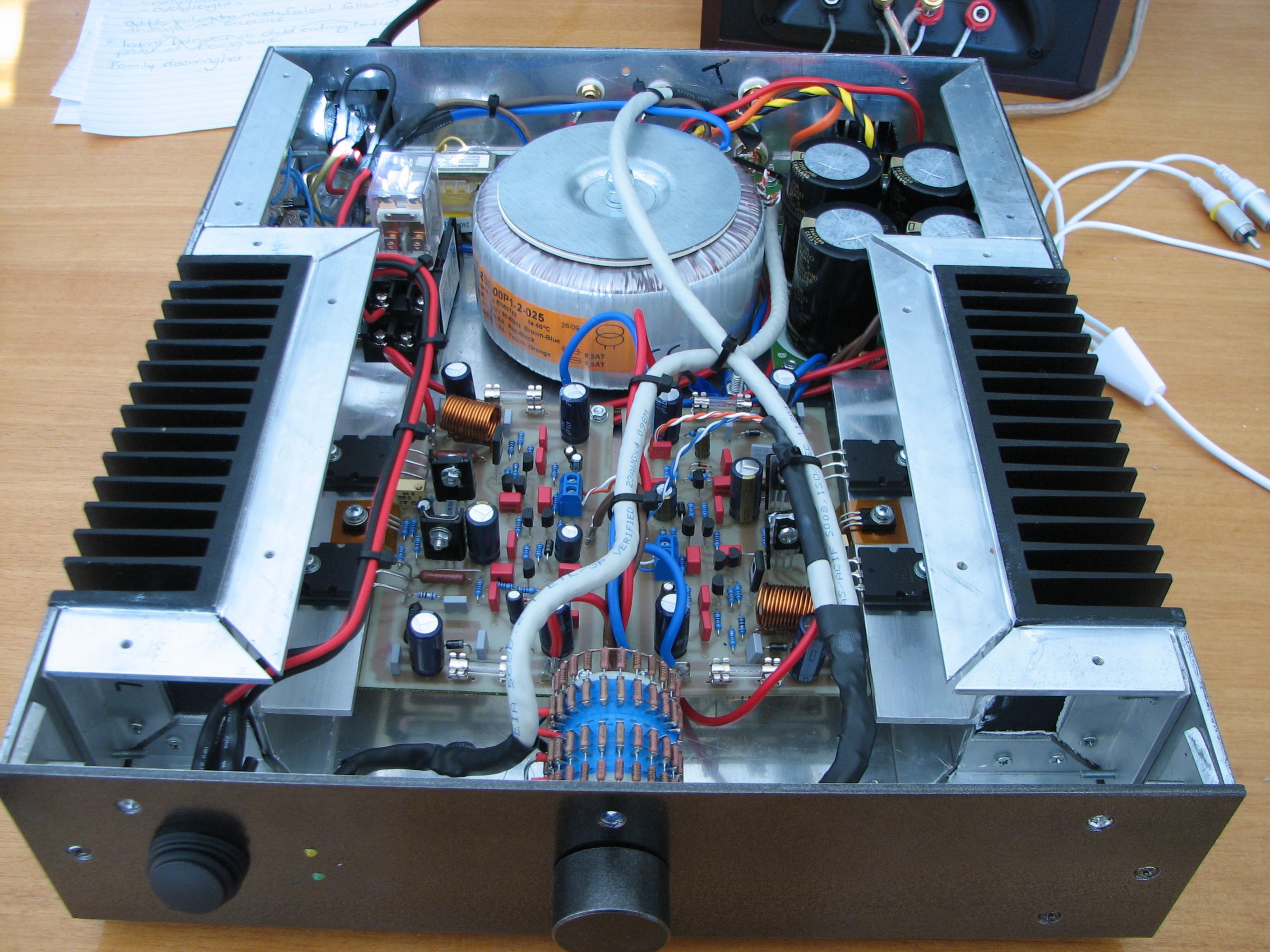

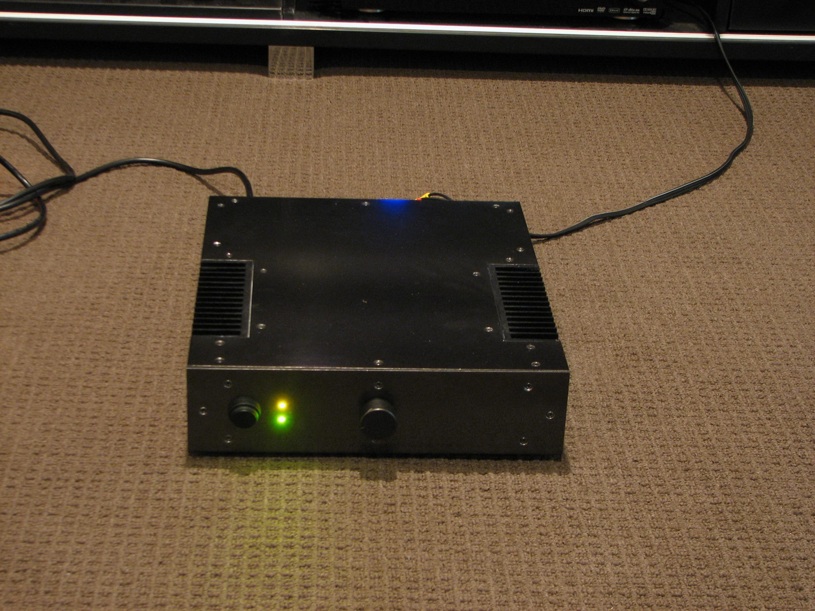

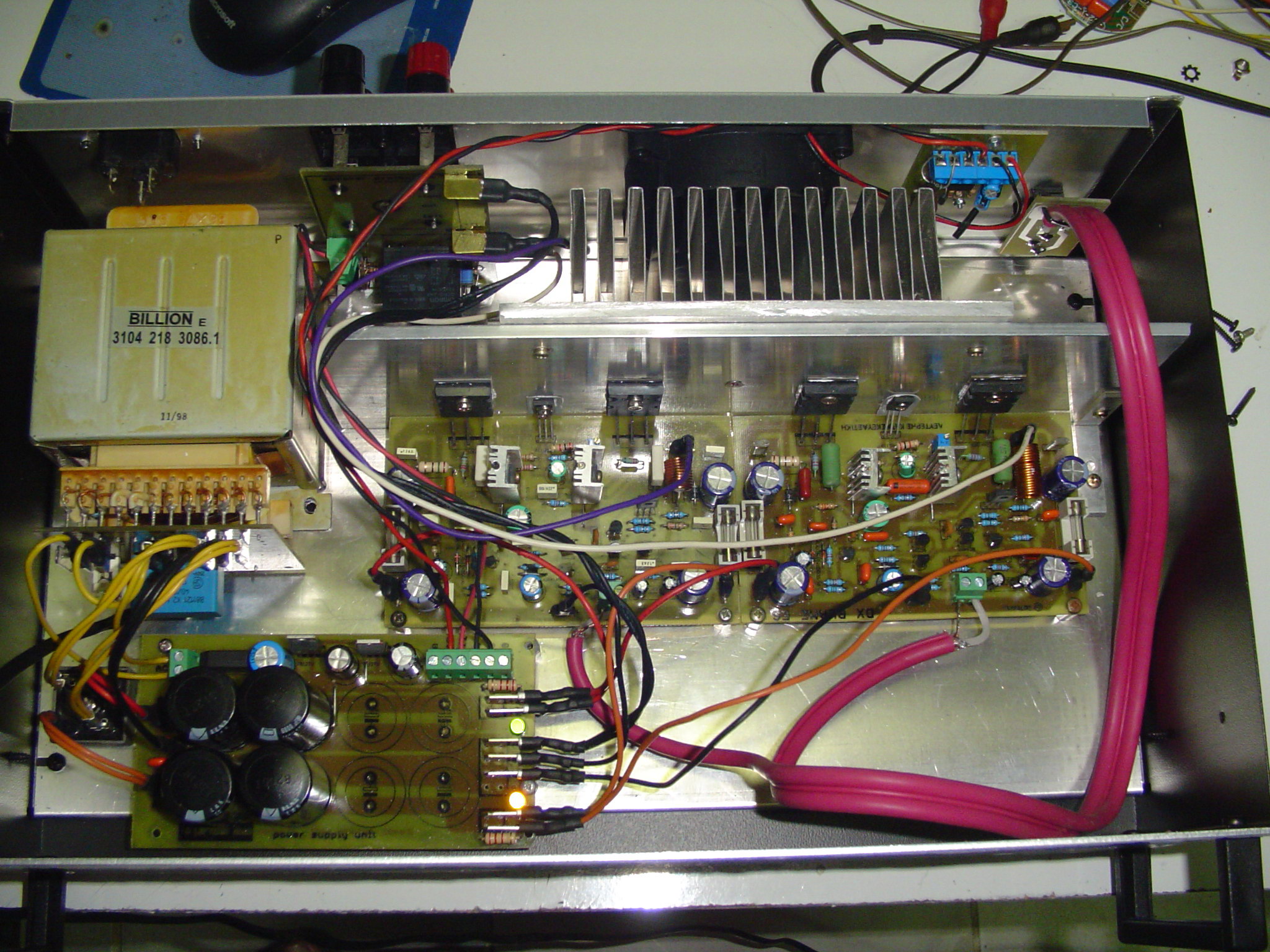

Final question about sensitivity and some pics
I noticed that while testing the amp that I was only getting a maximum peak voltage of 10v AC as measured on a multimeter when playing music at maximum volume. This was the same as when using a cd player with rca outs to when using my ipod with rca outs. The rca plugs are giving out around 0.5v output into the amp. Can some resistor changes be made to make the amp more sensitive? Is 10v AC max on a 50w amp normal? The rails on this amp is 38v?
Regards
Niss_man
Regards
Niss_man
can you input a constant voltage constant frequency AC (sinewave) test signal?
Compare input signal voltage to output signal voltage.
Testing on music proves little other than the signal varies a lot.
Measuring with music, dear niss_man, usually shows this voltage or less
give a try with sinusoidal audio entering.
If you have not a generator, them use 60 hertz, because digital multimeter can measure this frequency, in rms and having good precision.... this mains tone can be picked using a transformer, a small one, these ones for 4.5 volts, 6 volts or 12 volts...you take the AC output and connected a 10 to 50K trimpot, them you will adjust your signal to 750 milivolts rms... multimeter can do that....and then pick this sinal...one trimpot extreme plus the cursor (trimpot center lead)..the same you have adjusted 750 milivolts and connect to your amplifier input..you should read 20 volts if your supply, under this condition, and during this moment of load, maintain the voltage to 35 volts or more.
Of course, as you know, if your supply voltage drop below 35 volts you will not have this result anymore....the amplifier put out 20 volts RMS with 8 or 4 ohms load...minimum!.... should put out even more.
Watching the scope you gonna see the unclipped waveform.
Thank you by the nice pictures... and send me one of yourself if you want to the hall of fame.
You have made a very beautifull construction..congratulations!

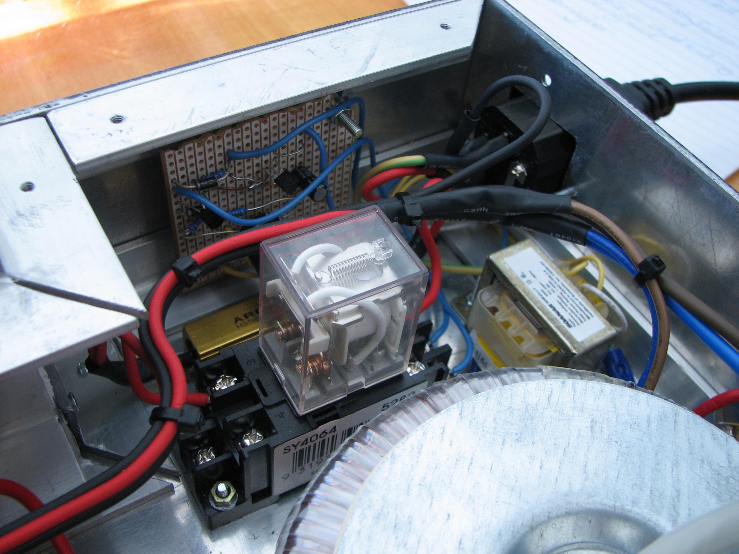

Very clever!
Congratulations, niss_man. Everything very clever.
Your pics teach us a lot.

For an input voltage of 586mV rms I measured 15.39V rms no load connected. Input frequency was 20Hz. This is a gain of 26.26. Peak output voltage for the corresponding input is 21.76V, while Peak-to-Peak is 43.52V. It was not my goal to see the highest input required to reach the highest output voltage. Transformer used is 24-0-24 AC.
Multimeters, are not precise at 20 hertz..they may measure lower voltage
they can measure but usually loose precision.... these small digital multimeters, usually measure AC mains voltage (200 and 600 volts scale usually)... and measure with 60 hertz...observe this is the mains frequency...the frequency where they are precise.
Well..if you have measured with multimeter.
Also... the power should be measured over a load (resistance) or speaker..this way you gonna have supply voltage losses and the power measured will be realistic....with open output your are not measuring the real thing .
Your peak to peak informed was result of calculation or you have measured in a scope calibrated display?

The results were from multimeter only. Peak and Peak-to-Peak results are only calculations based on multimeter measurements. Concerning loading when doing measurements, if I decide to perform more measurements, I will get my self a couple of 20watt 8 Ohm resistors.
Usually 20Hz won't be perfect frequency at which we can use multimeter to perform measurements. At 20Hz, on the back of my brain, this should give me some idea about the relation between input and output, it is not accurate as if I used 50/60Hz.
