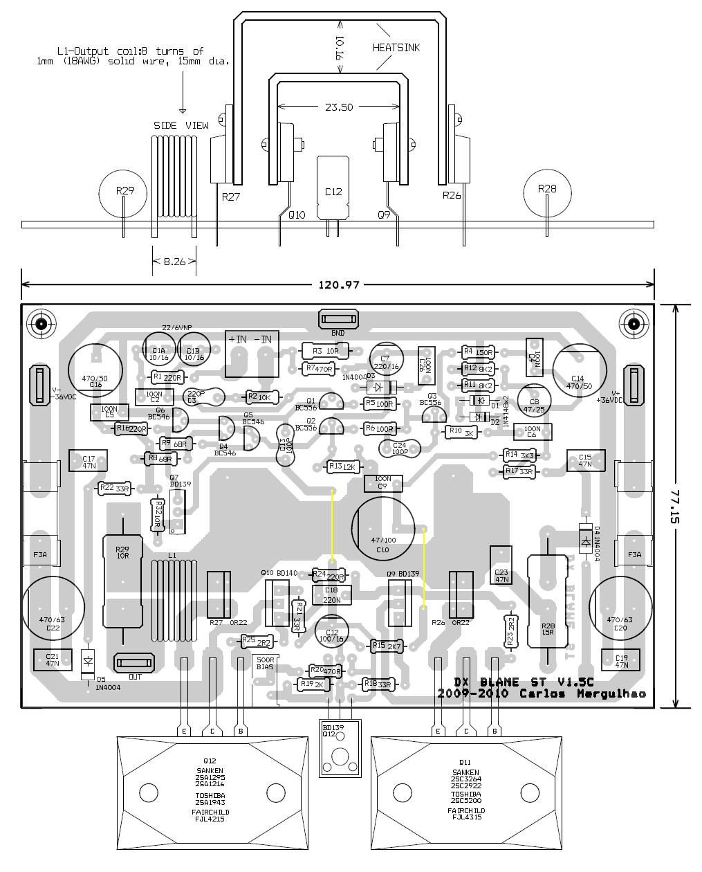

So. it seems i underestimate your heatsink...it may hold twice i said
This is good....will operate cool and confortable even in my country average temperature (29 degrées celsius).
Will be great in your place!....would be able to face full undistorted power, continuously, both channels driven and using 4 ohms loads...better than that ...only if i could have heatsinks alike yours!🙂🙂🙂
Also will be able to have 5 channels attached to the heatsink.

I think your first comment will suit, I forgot to mension that the heatsink is force ventilated by two small (6x6cm) 24 volts fan.

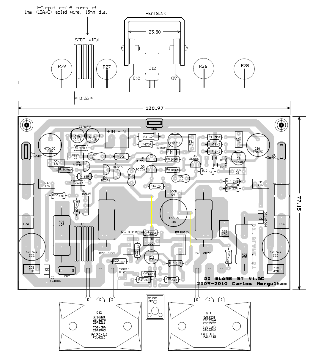

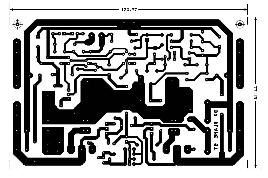

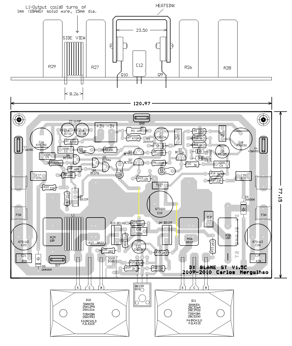

Yes...i like it...very professional look..the heatsinking linking transistores
was interesting, also vertical power resistances ...in the reality, these resistances can be 1 to 2 watts without serious problems..but i like it... low heat with these resistances...looks good...layout is well made...good distance between lines.... you seems to know what you're doing.
I see..you are using what you have in your part's bin..... interesting that you found room for them this way.
Thank you as you have shared your nice work with us.
Congratulations!
