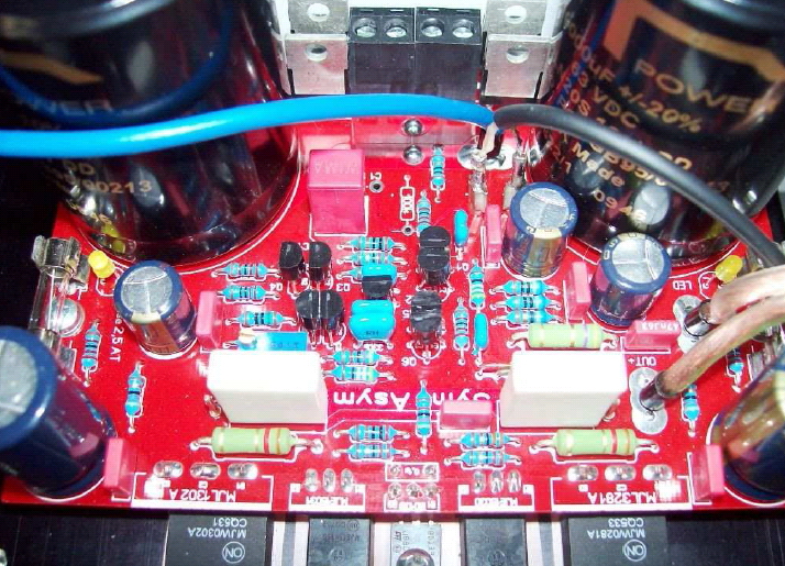

Thanks Wendell....you know, i will develop a new amplifier
Because of Rudi from Germany....he thinks will be a good idea because of Symassym popularity, then i can use the first symassym design published, or the second (the one Michael Bittner loves the most).
Will be an unashamed copy from the Dx Blame ST (already looks alike Blameless) having a marriage with Symasym.... will try to see if this sounds.
This way i will join the one i think it is the best, with another one has enormous popularity, in special, in Germany... the best plus die besten!... alles gut meinen freunds!
Then, offering more power than others, more quality than others, better sonics than others, the possibility to use 4 and 2 ohms loads (difficult loads) and switching features (top secret ones!) i will make something i will give, for a while, the name "Terminator"... to be released by thin uncle charlie during month of November...dead line will be Christmas day.... another gift form your uncle, with all my heart, for the good and nice forum diyers.
Of course, if i do not succeed (I doubt that), will not be published.
Competition!... you should start to feel fear..to shake your bones.... I will be back!
ahahahahahah!.... wait for uncle Charlie research and comparative Rudi are making with the Symassym.. the one Rudi has..do not know if a good sounding one or some tragedy made i have assembled...well..there are several...seems Roender (Physicist, engineer, electronic man and gênius) did.
So, uncle charlie (amateur, curious, not an enginner, a little bit stupid and once sinbined) will make one better.
I promisse you and i guarantee decence, will capture second symasym schematic, will join with Dx Blame ES and ST, will study the topologies merge... will recalculate each stage, will introduce mine own personal touch, will tune it for audio performance and we gonna see...and all that without even read other symasym threads, without watch their amplifiers...without knowing their solutions...doing mine, by myself, alone and researching...producing prototype, board layout, torture test, videos proving and then offering a "ready to go one"
ahahahahahahah!🙂
regards,
Carlos
ahahahahahahah!🙂
regards,
Carlos
The next will be Dx Symphony.
The best of 2 worlds..the input will use fets, 2SK170 ones.
I will not be influence by other one's ideas than Tommes, the German.
I do not use to visit Symasym threads...i really dislike what people did inside Michael Bittner thread..i found that an invasion and hyjacking..i felt bad...angry...i found that untolerable and disrespectull..others made in a better, they have opened their own threads.
Reason why i do not know, and also i am not interested, what others did...if they invaded, i dennied to be there..not to be acomplice... also their schematics and ideas could no enter my mind as the behavior was not approved by me... and they were banished from my heart...Michael Bittner was a good friend.
The Symasym version, from another German.... tommes.... if he is not from our forum... will be merged with mine.
If mine result alike others...means a coincidence, or obvious solutions, or ideas i had too... does not means copy or cloning of forum folks, wich diagrams i insist to ignore as i have explained... if we match ideas, means they are so good or better than me to achieve good sonics...good for all of us to have several "sonic" guys in the same forum... but i will test, will calculate, will change currents and will listen for sonics...if current is standard of not, or solution is the best technical or not..i will not bother...really do not give a .... for it.
If i discover tommes beeing a forum member and that have published here..then i will go back to Bittner original ideas or will call Michael to help me....i can accept Michael's help as he never imposed himself as a consultant, he never suggest anything we have not asked him.... bittner was a nice man, behaved hundred percent fine in our forum, he always took care of his own business too.... till people took care of his business..invaded the thread, had modified his schematic with him pointing that "this is not a good idea"....me to go there and read them is impossible, would be easir to you to see me kissing a man or a horse than to visit that thread once again.
With all that class he had..dear Bittner....he just left good ideas (explored continuously since he made the first and the great one)..and with a silent good bye, he kicked our ...., i do not know about you..but since that i feel some pain to sit over a wooden chair.
Symphony..... Sym from Symasym.... phon from sound, acoustics, sonics.
regards,
Carlos
regards,
Carlos

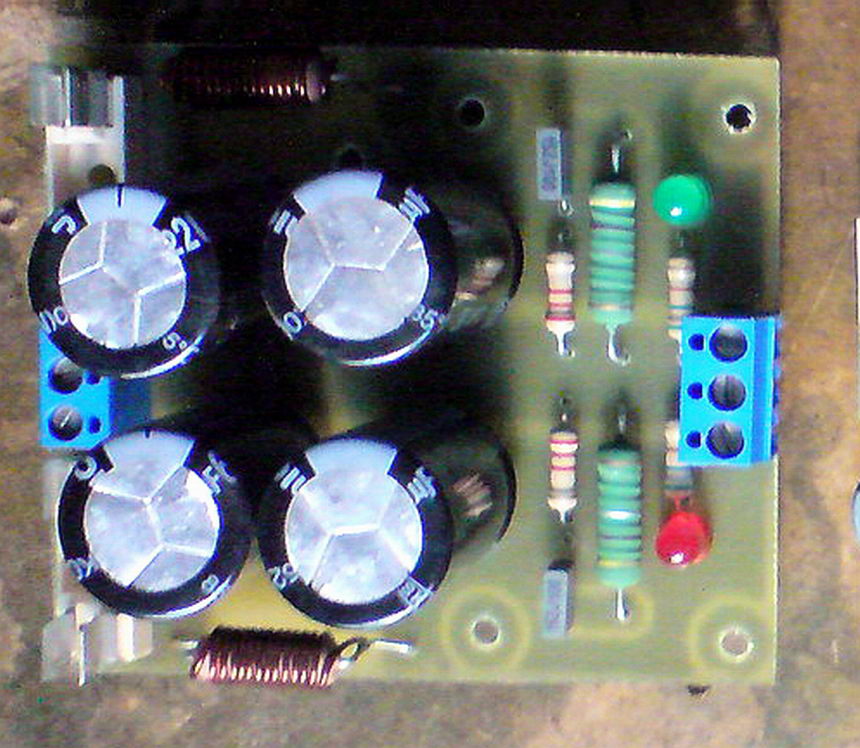

By what yourself and others have written DX it seems my amp is running exactly as it should be. I will still endeaver to use a signal generator to test as shown below. I expect everything to be normal after reading these replies.
Pocoyo. I am sure the Elna caps bought from you as used in the power supply will do a superb job and last the life of the amp. They cirtainly make a nice discharge weld mark when accidently touching ground with a rail wire😀.
give a try with sinusoidal audio entering.
If you have not a generator, them use 60 hertz, because digital multimeter can measure this frequency, in rms and having good precision.... this mains tone can be picked using a transformer, a small one, these ones for 4.5 volts, 6 volts or 12 volts...you take the AC output and connected a 10 to 50K trimpot, them you will adjust your signal to 750 milivolts rms... multimeter can do that....and then pick this sinal...one trimpot extreme plus the cursor (trimpot center lead)..the same you have adjusted 750 milivolts and connect to your amplifier input..you should read 20 volts if your supply, under this condition, and during this moment of load, maintain the voltage to 35 volts or more.
Of course, as you know, if your supply voltage drop below 35 volts you will not have this result anymore....the amplifier put out 20 volts RMS with 8 or 4 ohms load...minimum!.... should put out even more.
Watching the scope you gonna see the unclipped waveform.
Thank you by the nice pictures... and send me one of yourself if you want to the hall of fame.
You have made a very beautifull construction..congratulations!
regards,
Carlos

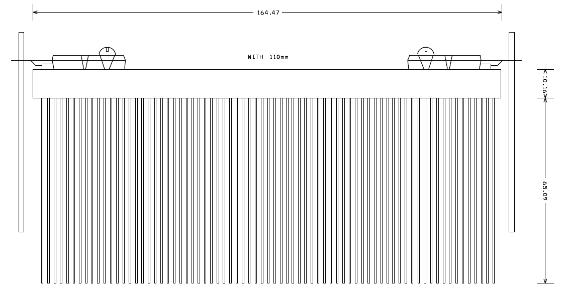

Please dear Coolet.... give me the third dimension i could not find
You sent me the length, the width and not the higth.
I need all dimensions to make my Dx style calculations (not precise but works)
Welcome to the Dx Corporation..send me pictures if possible.
The coil is not critical,... you can use around 22 turns of 1 milimeters enamelled wire coiled over the resistance.....yes..if needed you can use two windings, one above the other.
This picture from Macd (South Africa) shows how he made the coil..he used thicker wire... reason why he had less than 22 turns...no problems about that.
regards,
Carlos
regards,
Carlos
the thicknes and the height are in the right side. the thicknes of the cooling fins are 1mm.

Your heatsink is wonderfull..able to face 500 watts amplifier
not 500 watts of heat..... would face much more than that..maybe 850 to 900 watts.... excelent one...the best and biggest i had the chance to see.
If i have collected the correct dimensions of course..if i have understood.
This means your heatsink is able to dissipate 4 Dx Blame ST amplifiers, and may accept 5 channels if you use only 8 ohms when using 4 channels.
Heatsink is more than good.... it is excelent...if you assemble a single stereo, then you gonna have your heatsink at 5 degrees above environment temperature..very cool ones.
Ask Rudi if he can manage to order more boards to you...he is in this same thread.
