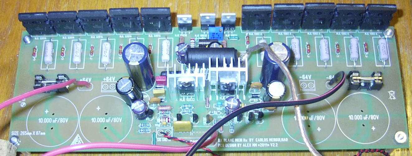

They will be very hot Juan, as i told before.
If you cannot or do not want to substitute them for bigger ones, then try to reduce current the way i have explained in this same thread.
Using lower voltage feeding your power amplifiers you may be rid from the excess of heat.
A good idea is not to use insulator in these transistors that goes to the small heatsinks, the vertical ones...but they must be insulated one related the other, they cannot touch one to the other to avoid dangerous shorts...or you screw them into the board or use rubber insulators to avoid heatsinks to touch one to the other.
Non insulated heatsinks have colector voltage on them...so.... if they touch one each other you gonna have shorts and damage..... by the other side, the use of insulators will avoid you to have shorts, but also will maintain your temperature higher than if you use transistor directly attached to these small heatsinks while using thermal compound.
Without the silicon rubberized insulator you shown, the heat transference will be better...the insulator is a resistance to heat transference to the heatsinks and use to maintain the transistor at highest temperatures.
Be attention.... these transistors heatsinks cannot touch one each other...insulators as you shown as good to avoid shorts but they keep the temperature too much high for 64 volts or more supply voltages....maybe your case of 54 will keep you rid of these troubles.
I have pointed and published something about this... sadly some guys have not read and i could see them using small heatsinks..... i am afraid some of them may have troubles..these small heatsinks are not good enough.
Premature death is what may happen when transistors works above 52 degrees centigrades....i could notice they work fine when temperature is low... from 40 to 45 degrees celsius (centigrades)
Want your amplifier to be working for unlimited time?.... say operating 40 years long without troubles? .... then keep it cool.
Transistor parameters are specified at 25 degrées celsius.... above this temperature they will be working out of their limits.... parameters will not be anymore respected, you gonna have other different transistors, not the ones specified and used for the design... they can die, this will be expensive and frustrating...be aware about heatsinks..they must be big enought to keep transistors cool.

That's the reason why i have not detected the need for a big heatsink
before....In my prototype.... as i have attached these transistors to the main heatsink in the testing prototype.... i have not assembled these boards you are assembling, i have not detected these heatsinks as not good enough (size is small).
I knew about the excess of heat when a friend (builder) reported he had troubles...his VAS and CCS was too much hot...then i have prepared text and video suggesting solutions....the first was the increase of heatsink size, and the second was the reduction of current to VAS.
It is not a good idea to wire them using 12 centimeters of wire as this wire length represents huge inductance (and some capacitance too) that may drive VAS to oscilate.... this VAS is high gain, some transistors are 240 of gain or more... this makes them a potential oscilator.... wire cannot be so long in stages we have gain.
Inductances appears also in straight wires....in the reality they are not straigh because in our Universe they are affected by gravitational forces and this bents wires some millionth of degrées..... this is enough to create a coil instead of the straigth wire we imagine.... even small the inductance, when associated with some capacitance creates a tuned circuit....these transistors can oscilate (operate) to several megahertz..sometimes we tune this frequency using wires added to the pcboard capacitances and inductances...if we offer to the transistor base a tuned circuit..then for sure the circuit will start to oscilate.
If you can install these transistors under (below) the board holes.... say.... a very small lead's lenght.... then it is OK....but 12 centimeters is dangerous....i am afraid you can face troubles.
You can increase (substitute) these vertical on board heatsinks by larger ones or reduce the current the way i have explained before, using text and video published (link posted for sure in this same thread).
I am very sorry....my fault....i am responsible..... i have assembled different than you....mine was attached to the main heatsink....so, i could not perceive it would be too much hot while using tiny heatsinks.... this is one of the troubles we face when we do not assemble a prototype before release boards to group buy people....not assembling we cannot know these details.... this appears in the real world construction.

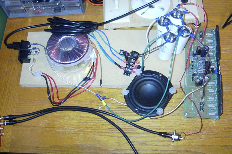

Joy at last!
You can't tell from the photo, but there is music coming from that little speaker! I built the second board exactly as the first. I was able to adjust the voltage drop across the 100R test resistors to 4.1V. Then I swapped out the test resistors for fuses, hooked up that speaker and gave it a signal.
:eguitar::sax::happy1::sing::note::note::note:!
That means that I either fried a component, or make a soldering mistake with my first board. It may take a while to hunt it down. I've already replaced or checked several components. I just have to slog through it!

These hot transistors (CCS and VAS) can be installed directly into the main heatsink
below the board (beneath or under)... a small hole must be made to allow you to insert your screw driver to attach or detach these transistors..... you can use 1 inch and a half wire length and connect your transistor using a "transistor socket"...this way not so long wire will be soldered into the board copper side and the socket will allow you to connect and disconnect easy because board is mounted using spacers that produces a room (empty space or clearance beneath the board)...so you can insert the socket.
The other option is to increase heatsink. using a taller one, a bigger one.
The third option is to reduce the current, that 22 ohms (in the CCS transistor) resistance should be changed to 47 ohms in order to reduce the current.
Good luck folks.

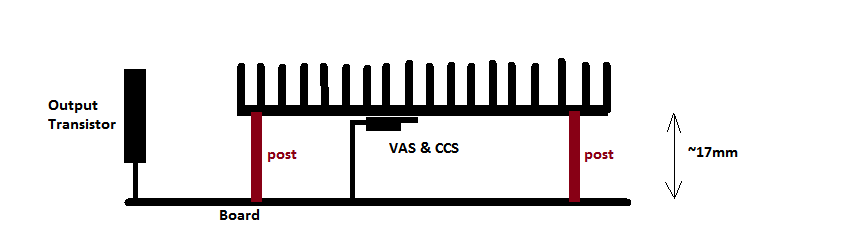

CCS and VAS temp.
Because space is limited direct on the board, and that I won't be having a heat-sink under the board, I thought of this (see picture). Both will be sharing the same heat sink.
Any thoughts?
Martin.

Cannonica,
Dats going to be pretty difficult considering the items being covered by the heat sink. Well unless we are talking 4 inchs of wire, would this be an issue with stability..? The way you are going you will have to make the tabs high enuf for clearance and servicability, you will still need 3-4 Inch leads@ a min.....:scratch:
I like it , if the wire lenght is not an issue ...
I like your solution Cannonica
But keep wires as short as possible... 2 inches is fine... 3 inches is too much.
Having long wires you will have big inductances.... and will create a tuned circuit within the transistor operational range.... these MJE are high gain (250) and high frequency (more than 150 Megahertz).... long wires combined to circuit and wire capacitances may create a tuned frequency... an explosive combination that may drive the stage to oscillate.
Use sockets..there are fine sockets and keep wires short...install aerial (roof style alike Cannonica suggested) or bellow the pcboard..... anyway you do, try to keep wires short in lenght.
These two transistors will need insulators because they will share the same heatsink.... this will be good because the colector will not be connected to a big block of aluminium...colector is audio output lead and will send audio to a high gain (current gain) darlington output transistors....so..... even not having high gain of voltage (more sensitivity to noise pickup) it will have high current (can unstabilize too...not so hard as voltage gain but is problematic too.... gain there is 2500 or more... current gain).
Keep them at less than 52 degrees celsius..... excellent temperature is something alike human fever..... 40 or 41 degrees celsius... doing this way you will have long life to your circuit...will be there, playing nice sound to your sons and grandsons.
17 mm is wonderfull Cannonica.... really very good...will work perfectly.... use insulators to both transistors.

Cannonica,
A brick-like heat sink of 70mm x 45mm with fins as high as the cabinet permits. Raised 17mm above board surface. It should clear everything.
TO-220 sockets MAY be all that's required to raise the transistors to the correct height, furthermore, it will permit cliping-on the heatsink-transistor assembly. I said MAY because I haven't verified yet as I don't have those sockets handy.
