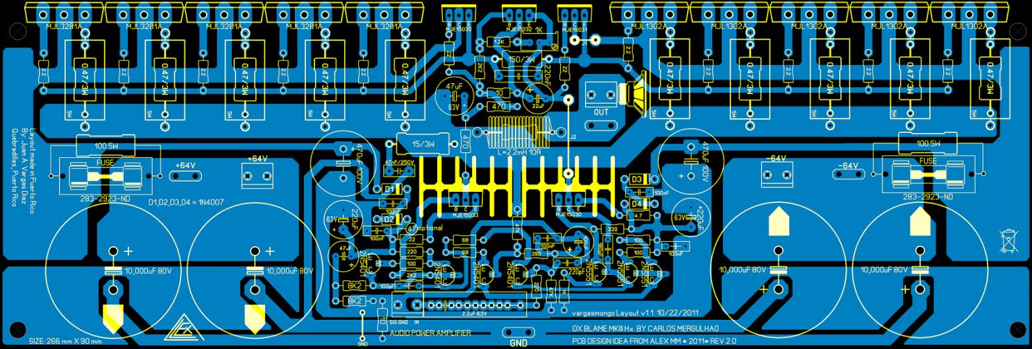

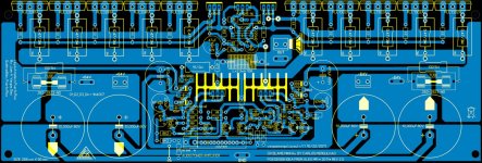

View attachment 246018Hi guys I been doing mister Alex MM layout for the future, I decide create a similar one like his board, but this is a "fanatic motivation for me",probably someone is going to complain or else but this is a way to help in some way, Alex MM board is unique, and I'm not trying to let him down, just to share ideas that is all, is someone like this idea I be happy to share to you guys is in Sprint Layout 5 format, so Carlos already told me it will be a waste of time if I don't share, this is vargasmongo a humble electronics enthusiast from Puerto Rico with lot of respect to you guys. I apologies in advance if my English is terrible.
regards
vargasmongo
Nicely done Juan but I think it's better for you to remove that footprint of resistor (100R) in parallel with the fuses. Edit: and that 10R(input ground) resistor can be deleted too 🙂
Oh that can be change Junie no problem
Aha that is just a reference not need to be on the layout
thanks for the tip Junie

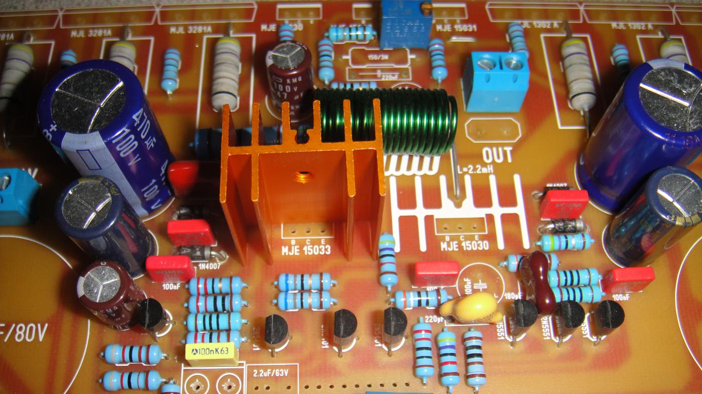

If it can be of any help, try photographing the solder side of the board. It's easier to find something wrong this way instead of looking with naked eye.
See the attached pictures, one is a the original framing at reduced resolution, the other is a crop at full resolution.... And one more to show my advancement. Still missing the small heatsinks. And I'll wail until the output transistors are screwed to the main heat sink before soldering the filter caps, for easier access.

Is that a ferrite core inductor in the output?
The Power entry third wire (PE=Protective Earth) must be permanently connected to the chassis.

Yes it's a Bourns 2100HT-2R2-H-RC.

Thanks. But is it suitable for that purpose?

Why not? it has correct inductance, high current capacity, low resistance and is documented as suitable to be used as an output choke. You think that not being an air-cored inductor can lead to problems?

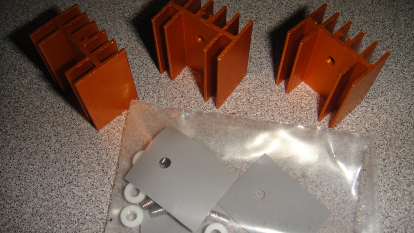

I just got the heatsink yeah!
I just got the heat sink today, it take forever to get parts here in Puerto Rico ! well I got to have patience.

hmmm... can you explain what kind of problem this can lead to?
EDIT: Well, a quick search revealed this (below).... I didn't investigate into this before selecting the ferrite-core inductor I chose. I may replace it.
[wiki=(About air-cored coils)
Its inductance is unaffected by the current it carries. This contrasts with the situation with coils using ferromagnetic cores whose inductance tends to reach a peak at moderate field strengths before dropping towards zero as saturation approaches. Sometimes non-linearity in the magnetization curve can be tolerated; for example in switching converters. In circuits such as audio cross over networks in hi-fi speaker systems you must avoid distortion; then you need an air coil.]%[/wiki]
