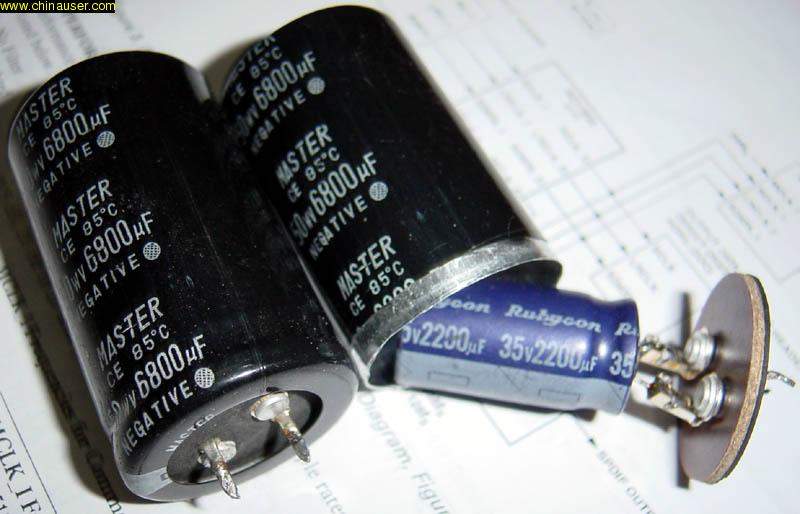

35diam * 50 tall, seems small for an audio cap of 10mF & 80V.
Have you checked ELNA data to see what the size is?
Hi Andrew,
I have checked the Elna datasheet but I can't find the Elna For audio 10000uF 80volt.
I email also Elna America to find out if they are fake.
It's worry's me the fake things you can buy from Ebay that comes from China.
Is there a good alternative for those 10000uF 80 volt caps on the Dx Blame MKIII-Hx board?
Have somebody experience with good 10000uF 80 volt quality caps on this place of the board?

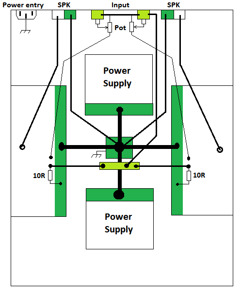

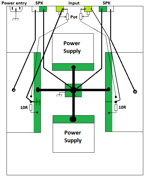

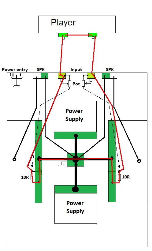

I can't draw like you two, so I'll try to describe Leach's alternative method.
Connect the two input socket returns together. They need to be very close to each other, to do this successfully.
Run the main Signal Ground from the twinned input sockets to the Main Audio Ground (MAG).
Run the two amplifier inputs (Signal Hot & Signal Return) from PCB to it's respective input socket. Repeat for the other channel.
Now the amplifier can measure the difference in voltage across the input socket and process that input signal.
Draw this on your diagram.
Move the Spkr Return. Run the new Skpr Return from return terminal to MAG. Now add that to your diagram.
Go back to the PCB and ensure the PCB Power Ground runs direct to MAG. repeat for other channel.
Add these to your diagram.
Look at your diagram.
Trace out the circuit that the input signal follows to return to the Source.
Trace out the circuit that the spkr signal follows to return to the PCB.
Trace out the circuit that the Power Supplies follow to return to PSU Zero Volts.
Trace out the circuit that the transformer currents pass to return to the transformer.
Note:
1.) the long route of the Signal circuit. This must have a low loop area.
2.) are any circuits sharing a length of wire/trace?
Leach suggests that the voltage reference connection from Signal circuit to Spkr circuit is HF restricted by high inductance. He suggests that there needs to be a low inductance path between these two circuits. He adds a low value resistor that must necessarily have short traces between Spkr circuit and Signal circuit.
I have found this method to give the quietest result for most but not all source types. The few that are not of the quietest are only slightly affected by hum.
I have experimented extensively and cannot find a solution that is completely HUM FREE for all source types. Usually each alternative has at least one "Achilles heel" with more than slight hum.
I hope this helps.

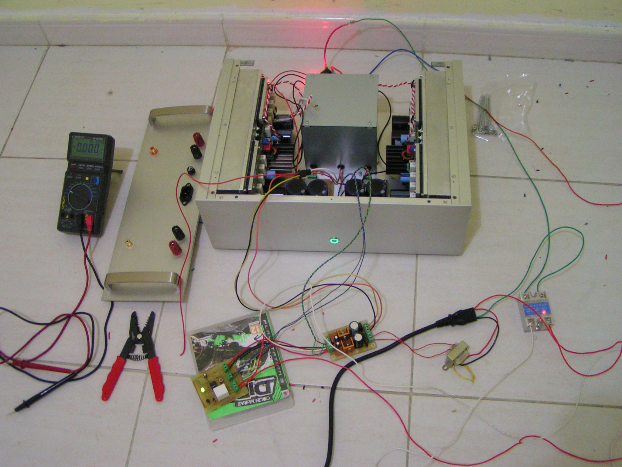

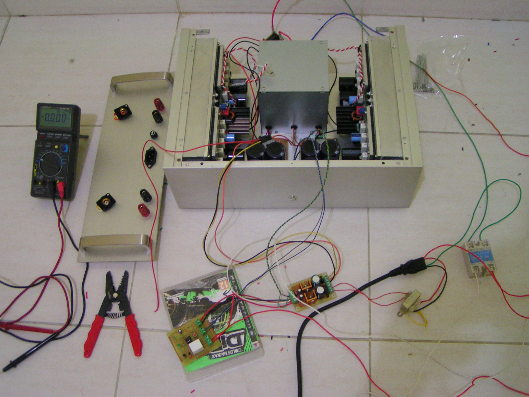

Testing in progress
I made a Toggle switch using 555 timer, circuit can be found in other website, also i finished Ostripper softstart hook it up altogether for checking and it works the way it supposed to be, very happy with the outcome. I like those "circle green light"
Here are some pics of my progress, messy but satisfying.

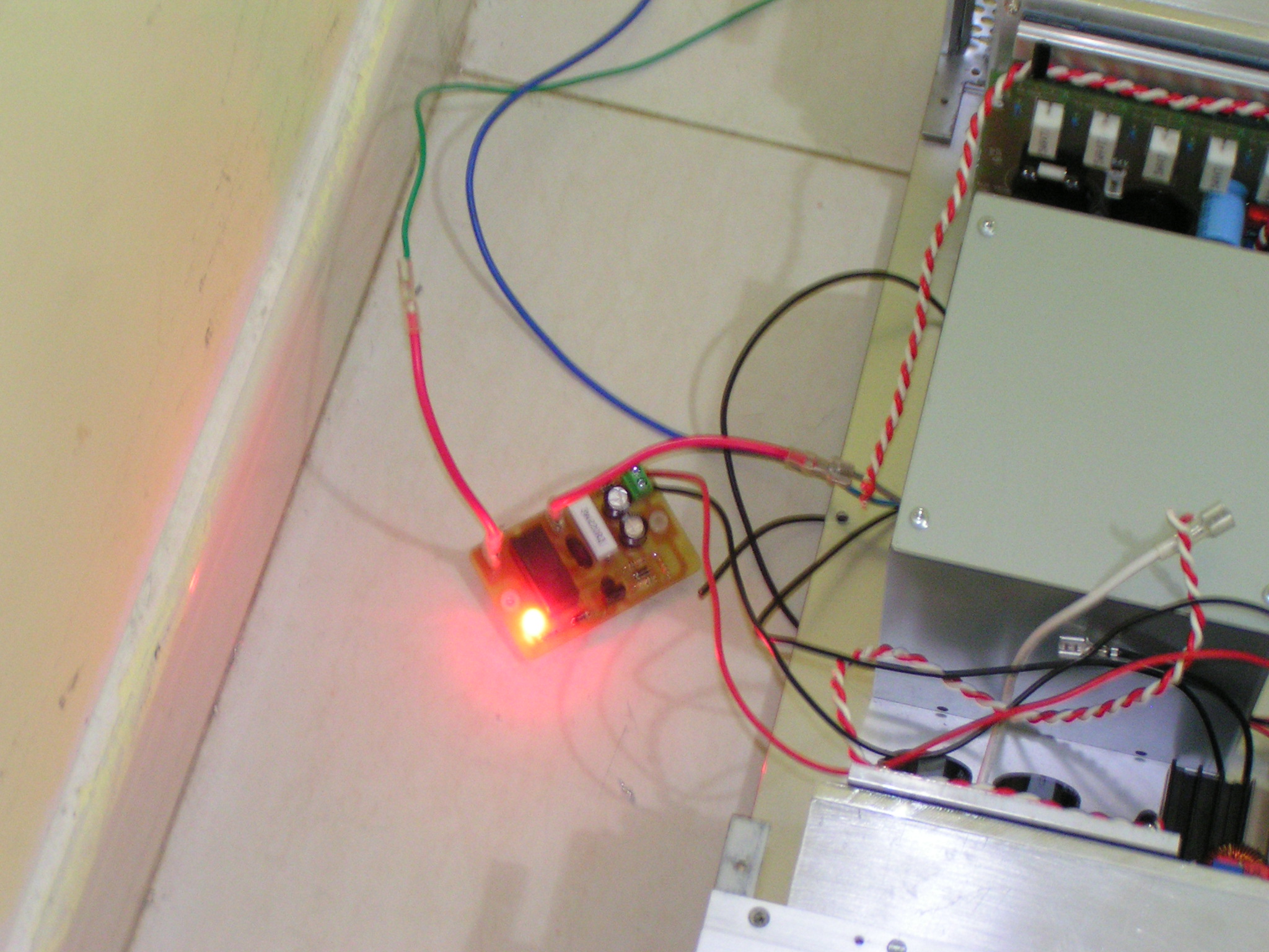

Junie , when you say that , i'm assuming you used a 555 timer in some way as a relay circuit because those switches are only rated at 2A ? am i correct and if so , please tell me how . i love those switches but their max amp rating is such a limiting factor .
cheers Woody
cheers Woody
Hey Woody, yeah 555 as pre driver and used SSR instead of Relay.
More info can be found here: Toggle ON / OFF Switch

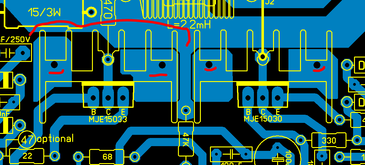

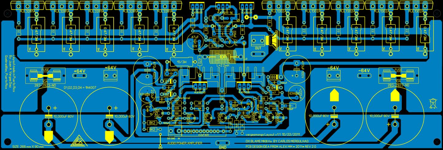

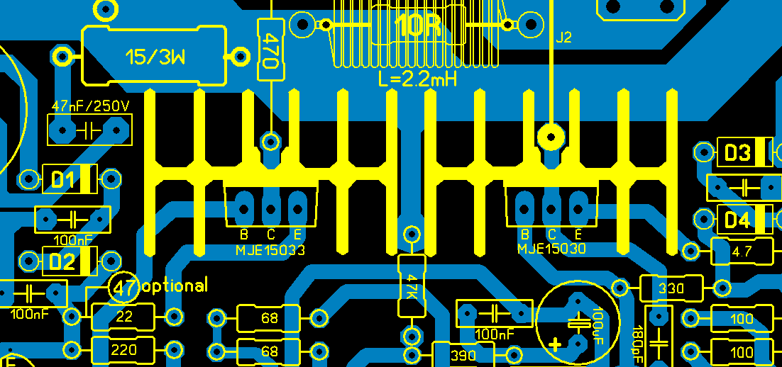

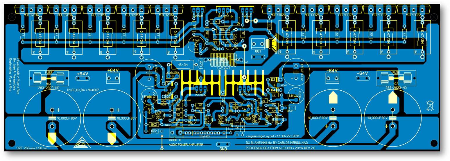

vargasmongo personal layout changes "heat sink'
Today a did some changes on my layout, I change the heat sink for a taller ones and the silk screen too, of course this is Alex MM layout don't get me wrong that is the man! well I got to keep looking analising and all that, I hope you guys like my ideas, "I hope so" lol , alright guys have a good one.
