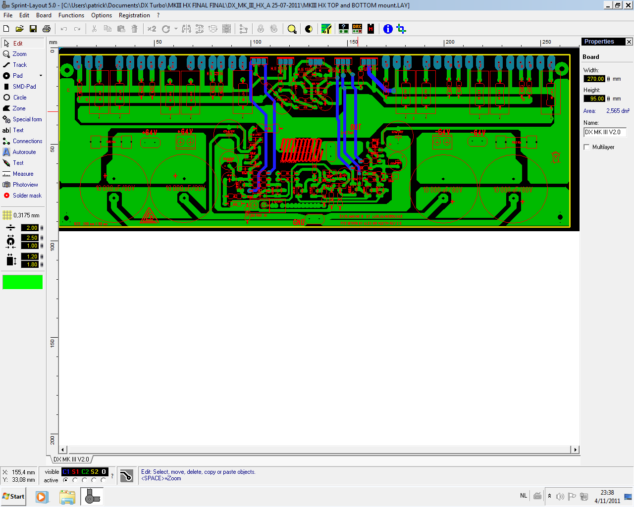

Today a did some changes on my layout, I change the heat sink for a taller ones and the silk screen too, of course this is Alex MM layout don't get me wrong that is the man! well I got to keep looking analising and all that, I hope you guys like my ideas, "I hope so" lol , alright guys have a good one.
Vargas,you gave me an idea thanks
what are the changes , support pads for the heat sinks ..?
I just got the heat sink today, it take forever to get parts here in Puerto Rico ! well I got to have patience.
What brand resistors are you using .....
taller heat sinks
taller heat sinkswhat are the changes , support pads for the heat sinks ..?
those are from eBay must of them but I use the wrong wattage they are 1/2W instead of 1/4W is ok for me. the brand 1 2w Watt 3.6k ohm 3k6 Metal Film Resistor 0.5 W 200 items in abillionstore store on eBay! no promotion, to them just information.
There is not much I can do on Alex MM layout is already good, I can not change numbers or position of components I move some stuff a bit not much for my personal layout, "heat sink taller" that is all I got in my mind guys lol have a good day guys.

I have to thank dear Juan by his help, as i am really needing someone to fix that stuff connected to the clearance to install bigger heatsinks.
I need to cool down these transistors that are on board, the CCS to VAS and the VAS transistor itself...or increasing heatsink size (larger and taller having more are exposed to the air, with more fins), or someone to suggest modifications to install these transistor below the board (Cannonica did that...thank you Cannonica), or other clever solution.
I have to thank all of you by the confidence, support and help...you know.... we have a problem.... these heatsinks (clearance, room for them, free space to install heatsink on board) are not good enough.

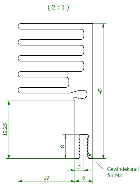

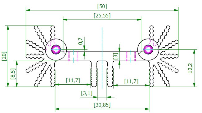

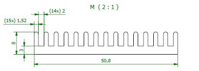

CCS/VAS heatsink options
Did some searching on the Fisher-website and found some
heatsinks that could be usable for CCS/Vas cooling..
From left to right:
SK427 - available in 50 and 75 mm height, would fit the pcb without modifications.
SK459 - 50 mm height, would require some modification of pcb or maybe use short wires.
SK576 - 25 mm wide so you would need two, and would cover some components.
Link to the Fisher website:
Fisher Website
Klaas

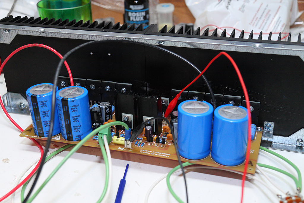

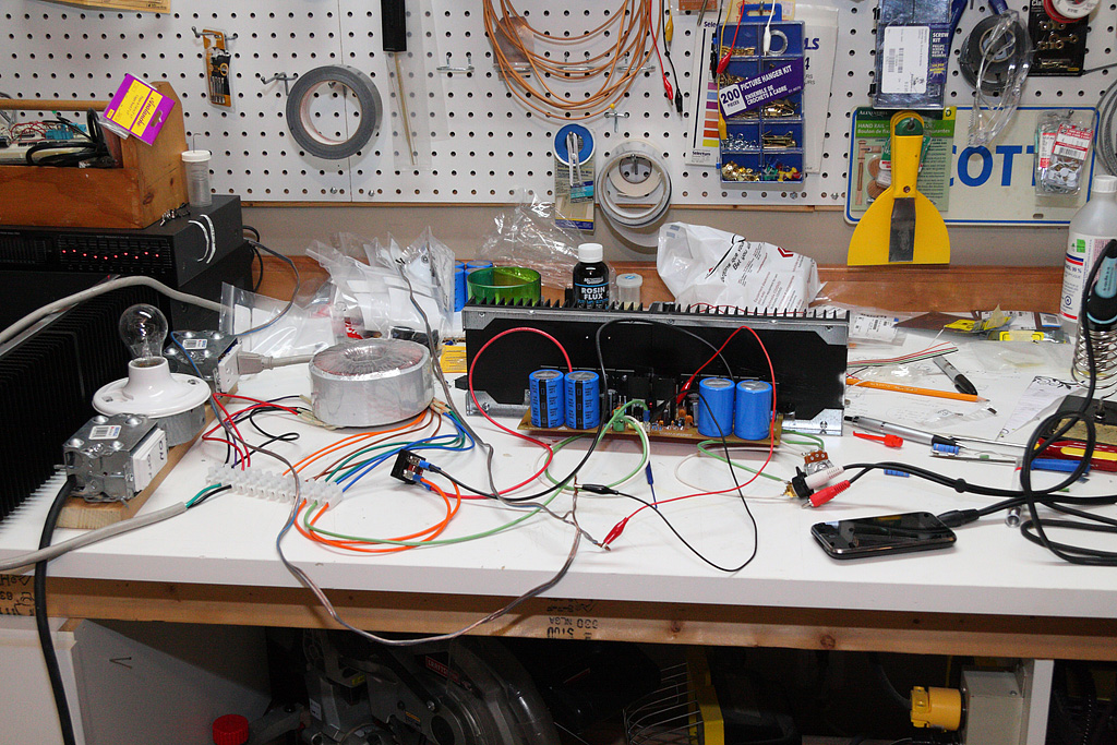

It may not look like, but this one is playing Sultans of Swing
I'm really happy, it's a one on one, everything went smooth and worked the first time (I cross my fingers for the second channel).
The only thing is that my Fluke 73 multimeter cannot measure the bias voltage at the output resistors. It seems its sensitivity doesn't permit that.
After measuring 3.1V at the startup 100R resistors and a few millivolts of offset, I decided to put the fuses into place and connect my iPod to the input. First sending a sinusiodal signal (using a signal generator) of 60Hz to measure "alternative" voltage at the speaker out. Just to check that it was amplifying and that my input pot wasn't upside down. I then switched to a musical program and plugged my speakers.
Seems to sound very good even without adjusting the bias. I didn't cranked it yet, everyone is sleeping in the house actually

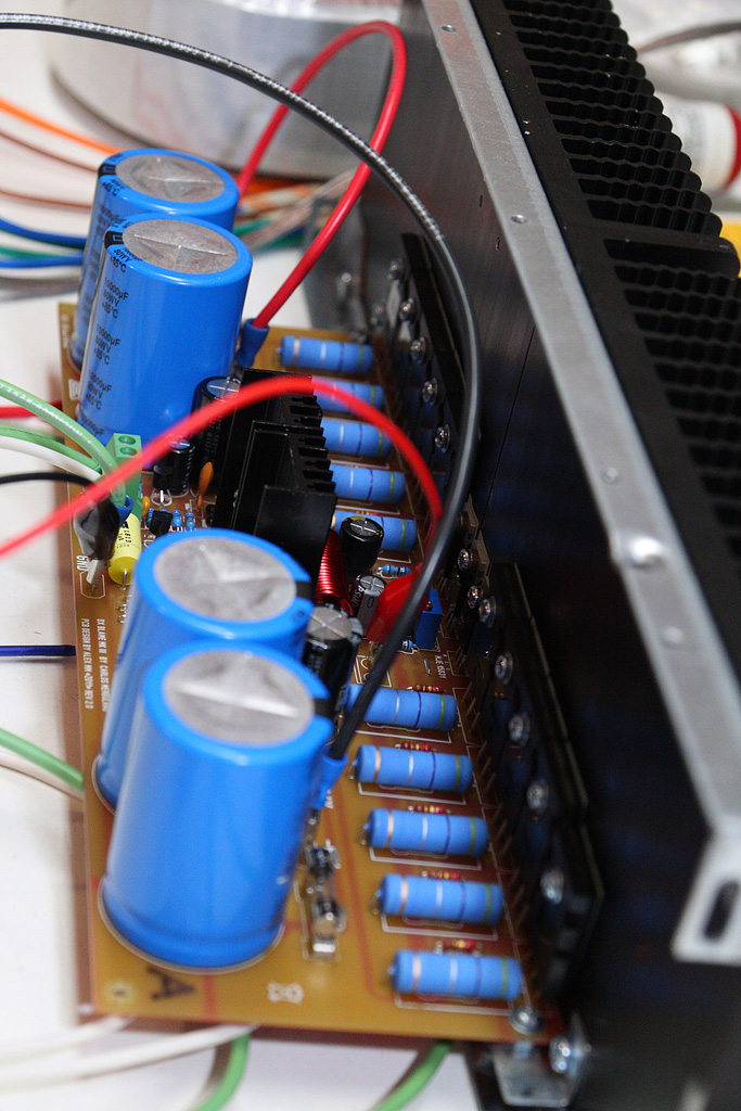

As expected my CCS and VAS heatsinks are between warm and hot, but I can leave my fingers and it doesn't hurt. It's definitively hotter than "human fever". I'll see what I'll do... but I guess I will leave them like that and see once the amps are in their cabinets how they go.
Now gotta put the second channel onto the main heatsink and expect it to work like the first one...
Some pics below.

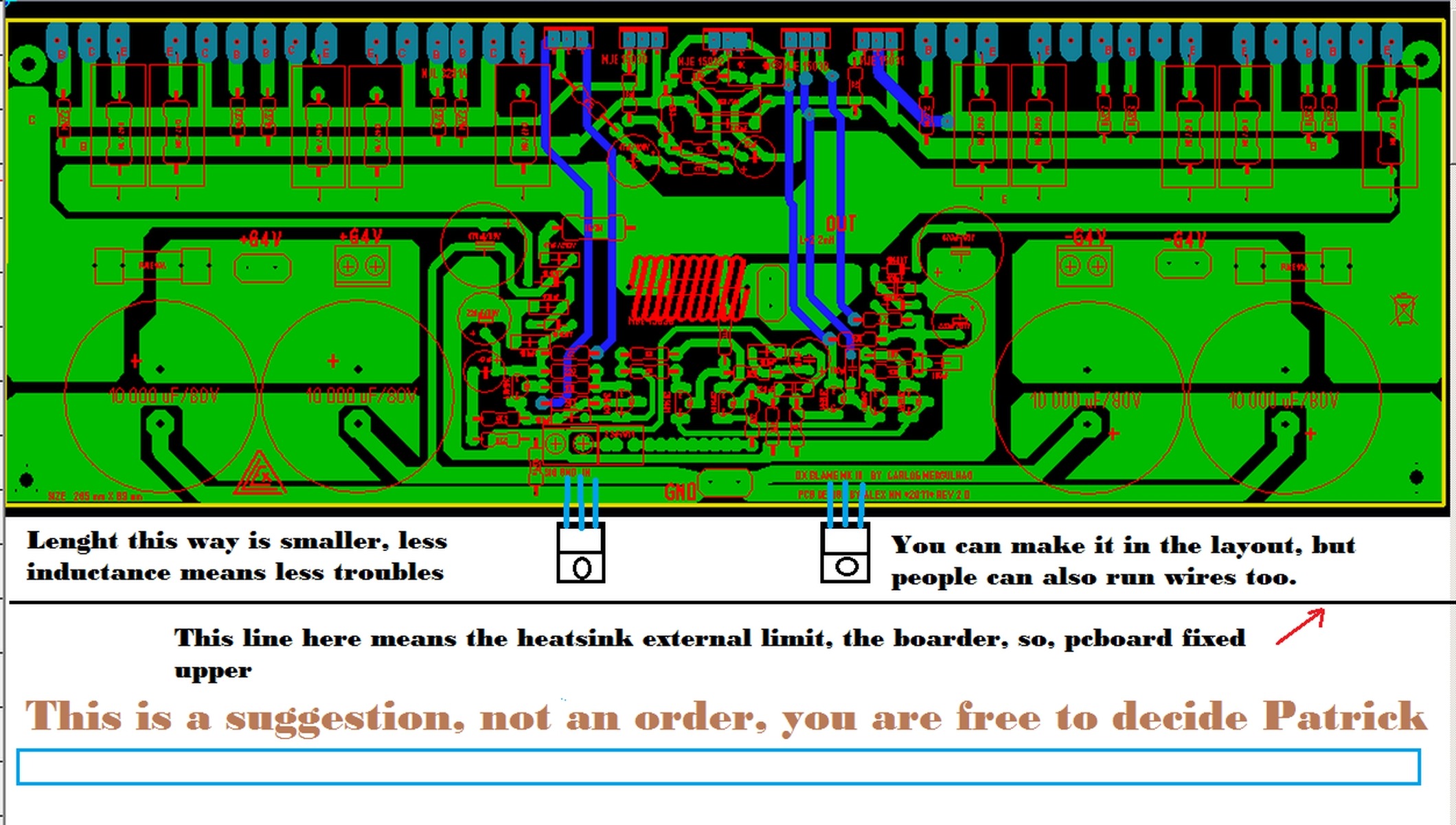

The track length may be a problem dear Patrick....if possible, change the position to nearby the input, this way the board can go upper, more atop of the main heatsink in order to produce clearance to these two transistors.... well...if less than 6 centimeters...then no problems....but your solution was fine... double face board?... copper track both faces? .... very good, but this may be expensive ... well ..... if needed this way, then go ahead and thanks.

Cannonica - MP3/4 players, Ipods and so on, use to have lower audio output level, exception is if you use the line out output jack ... having low level in the input you will not reach full power, then you should reduce the gain resistor connected to the second differential transistor base .... the feedback one ... the one you have connected to the output line through a 47K resistor.... Sultans of Swing is also one of my main test songs.... thank you very much by your support, confidence in Dx amplifiers and also your enthusiasm.... pictures are nice..thank you, go ahead posting...more!
