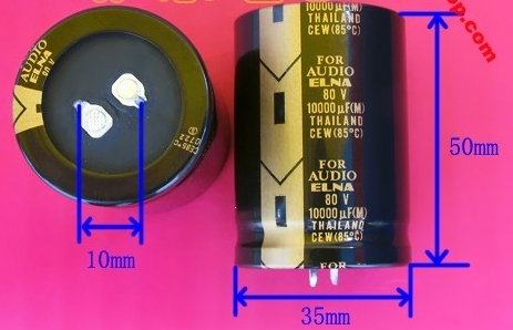

Elna 10000uF 80V For Audio Capacitor
I wish to order 8 of these, Elna 10000uF 80V For Audio Capacitor on the Dx Blame MKIII-Hx board but are these good caps or can I order better other brand caps, I need the 80 volt?
I can order these for a good price $10 each but the country is china, I hope these caps are not fake.
Is there a list for fake components from china?
Rudy
If you are on UK 240Vac supply and use a 230:40Vac 5% regulation transformer then you find that the maximum DC across the smoothing caps can rise to ~62Vdc. This just allows a 63Vdc cap to be used.
Any higher than 40Vac and you should use the next higher cap rating.
35diam * 50 tall, seems small for an audio cap of 10mF & 80V.
Have you checked ELNA data to see what the size is?

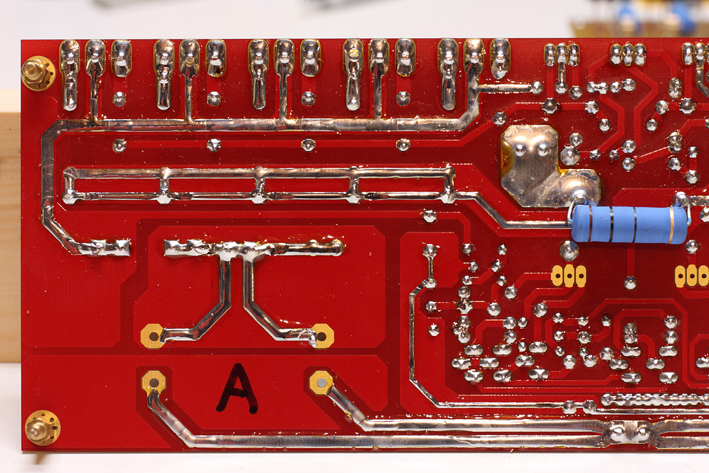

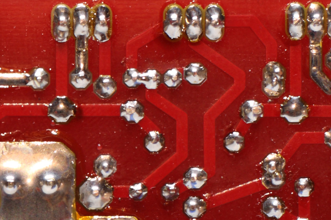

If it can be of any help, try photographing the solder side of the board. It's easier to find something wrong this way instead of looking with naked eye.

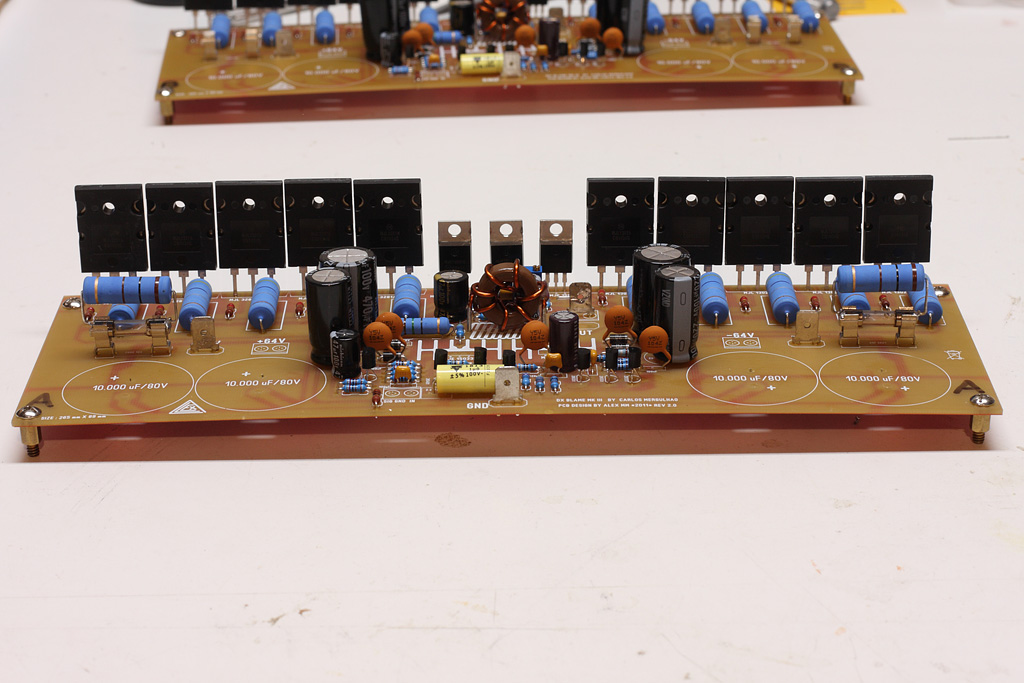

See the attached pictures, one is a the original framing at reduced resolution, the other is a crop at full resolution.... And one more to show my advancement. Still missing the small heatsinks. And I'll wail until the output transistors are screwed to the main heat sink before soldering the filter caps, for easier access.
Martin.

Thanks for the suggestion Canonnica. I tried that, but my digital camera just isn't good enough to see anything I can't see with my eyeball. I'm focusing on that crackling sound I heard when I first powered up the board. I'm sure something is fried. I just have to find it . . .

Hey canonnica where did you get those beautiful blue resistors and also the PCB stand up? , by the way gorgeous board really nice presentation.
regards
vargasmongo
The 5W resistors are Xicon 286-0.47-RC, 286-10-RC and 286-100-RC ordered from a well-know US distributor 😉 . I didn't want wirewound resistors. The PCB standoffs are only there for board assembly as they won't permit clearance of under-board resistor once screwed to the chassis.
It's my very first built 🙂 ... and as Mr. Carlos says in one of his video, because I'm new to amp building, I have a lot of respect to all the steps, components, design, etc... I take all the time that's required, I'm not in a hurry, it's a pastime.
I'm spending a lot of money and time into this project, I want it to succeed.
Martin.

You did a very nice job so far🙂

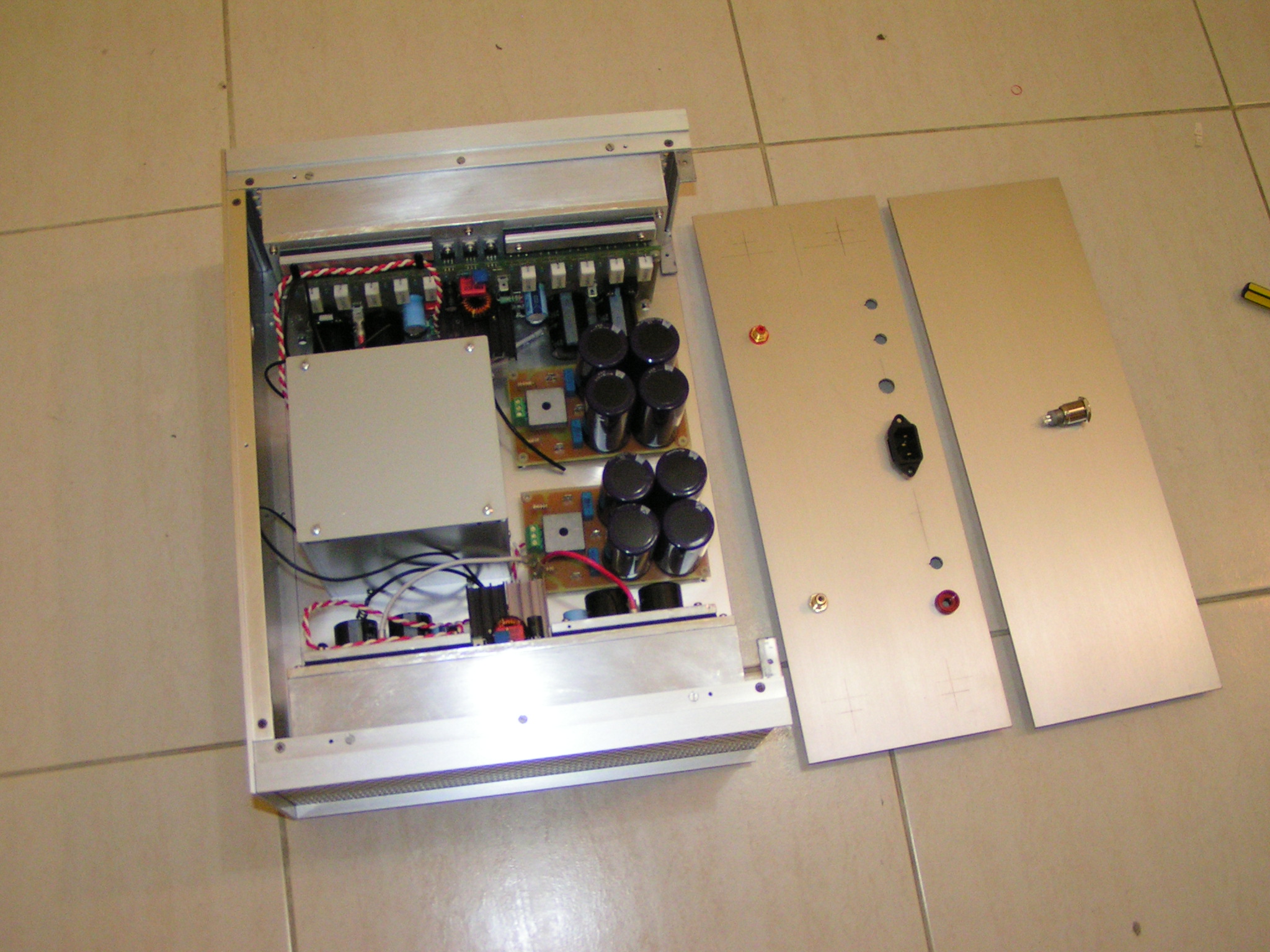

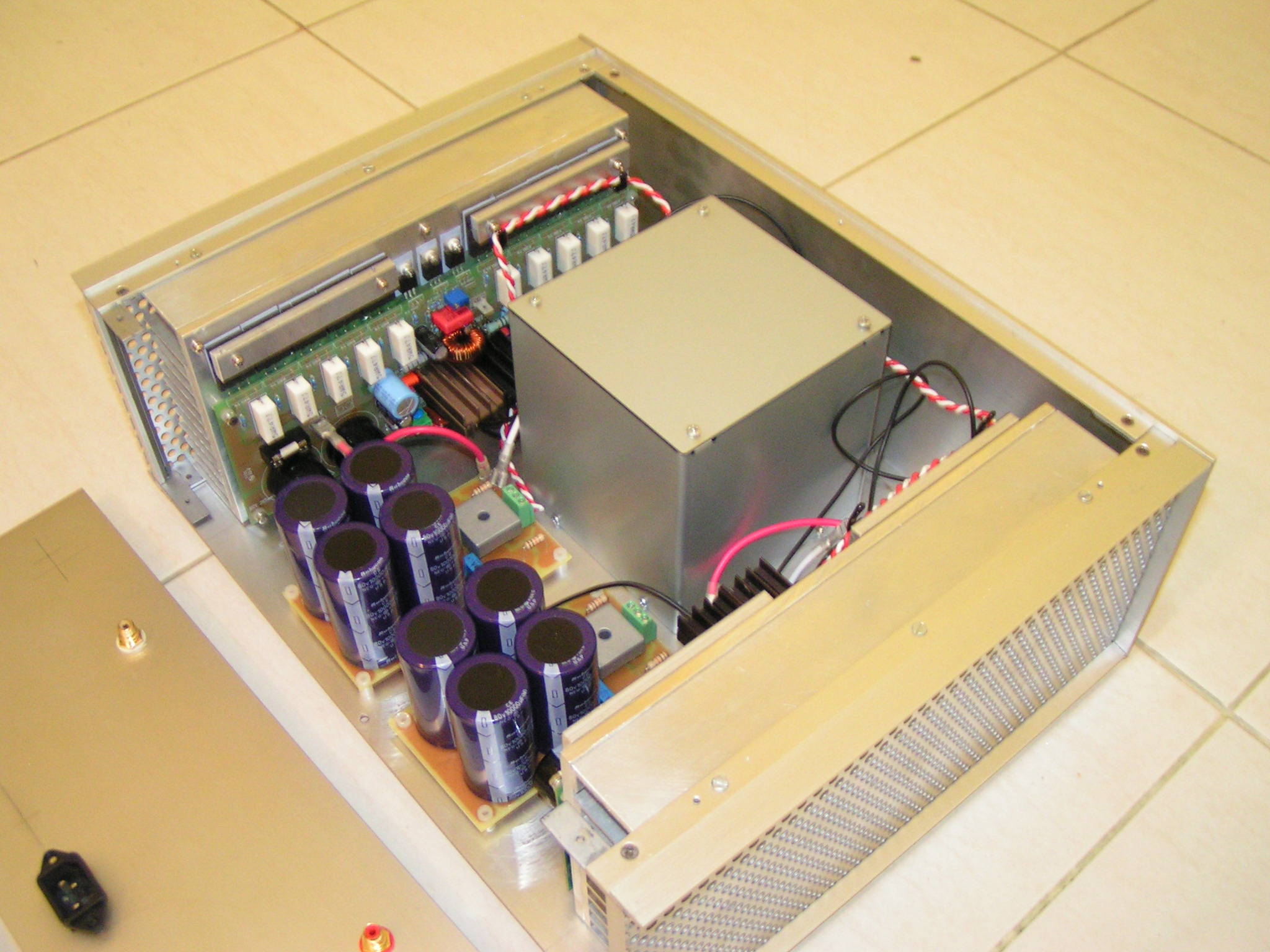

My progress
Sluggish progress due to office work but i did something last weekend. Not wired yet maybe again in the next few days I will do it. and Byron the Amp is workign really fine and sound fantastic you can find the culprit by checking what carlos mentioned.
