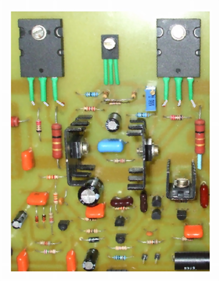

Dx Blame ES .... based into the Blameless, i am trying a new amplifier
more two lovely amplifiers will be constructed very soon.

Hi Carlos,
Congratulations on your Dx Blame ES design. I believe you use the laser toner iron-on method for PCB construction. I find this works well for small "production" runs. How did you tin the PCBs in post #557 if I may ask?
Steve

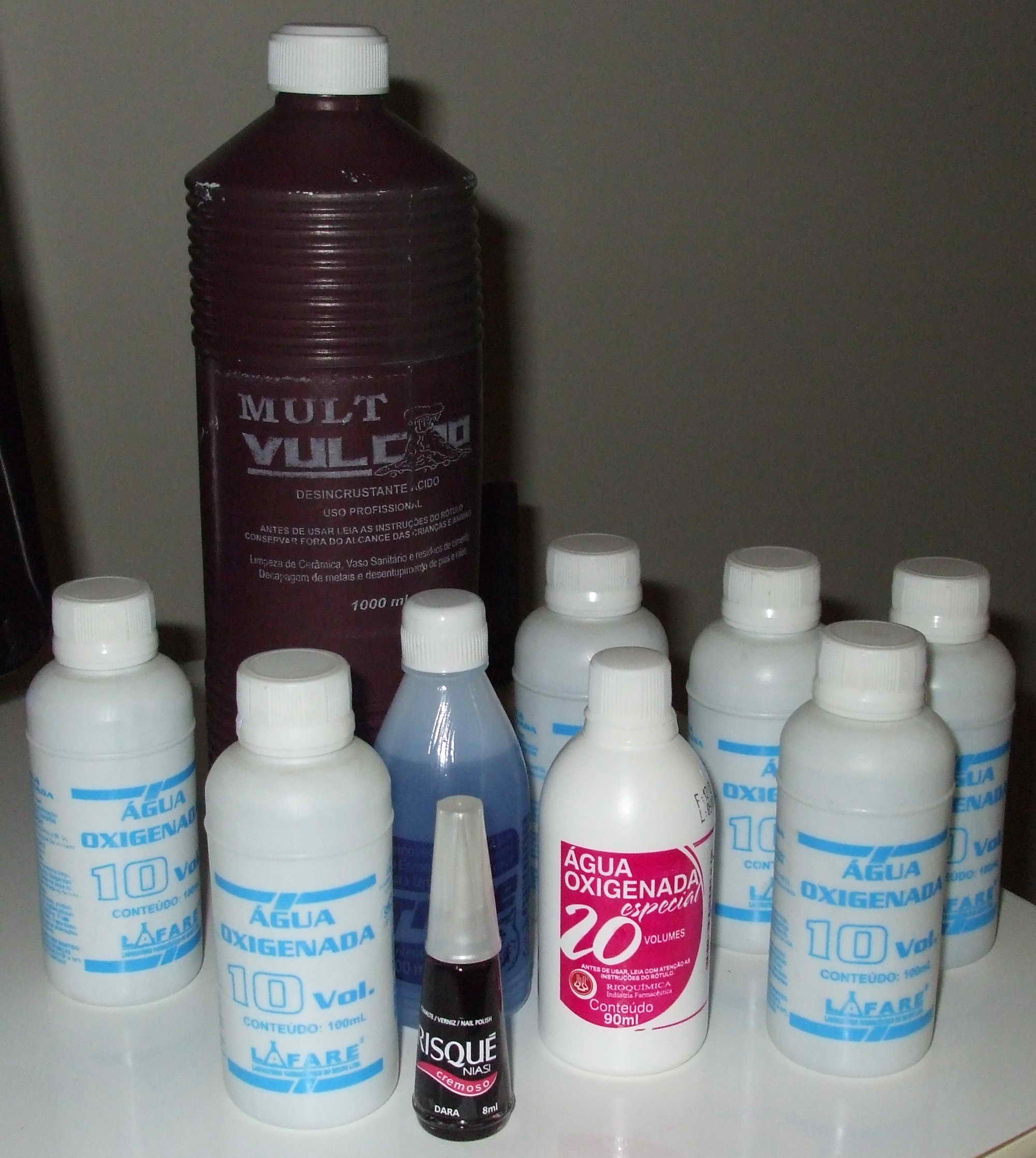

Thanks for the links Carlos. It was just the final tinning process I was wondering about. A product called "Liquid Tin" in your linked video was used, which only takes a few seconds. I will have to investigate a UK source...
Steve

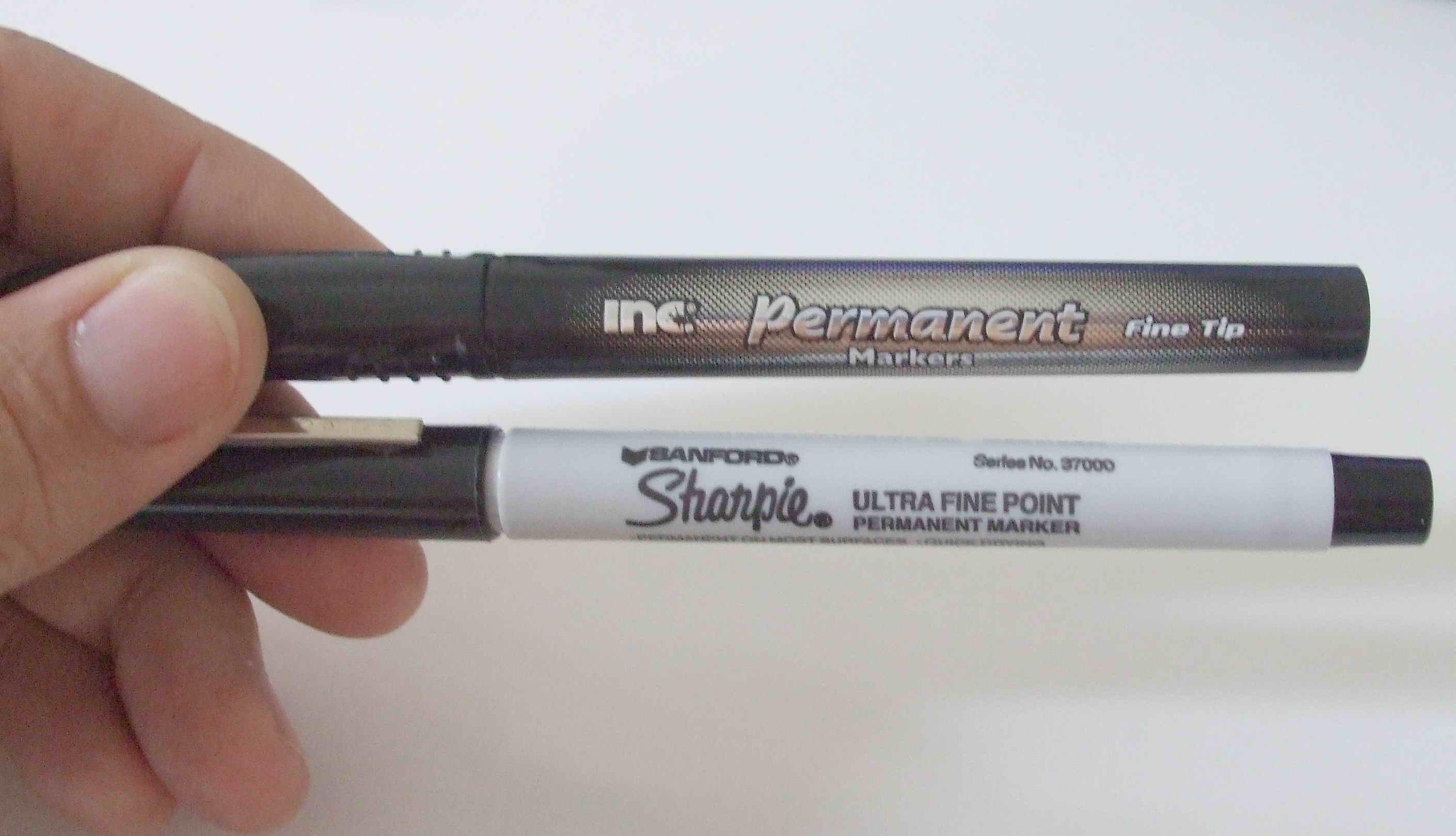

I used to use the pen technique when i was in school... they have special "Dalo" markers for that, but a really good permanent marker pen also works :)
Since discovering the toner transfer method thanks to Tom Gootee, i wouldn't go back. It even works well enough for SMD parts, with a good enough paper
I continue in the school, the school of life, learning things everyday
and discovering, each day, how much i was stupid yesterday.
I use good permanent pen...and all possible methods to etch boards, and i am learning and developing myself in all knowledge fields that can improve my activity (hobby) of audio construction.

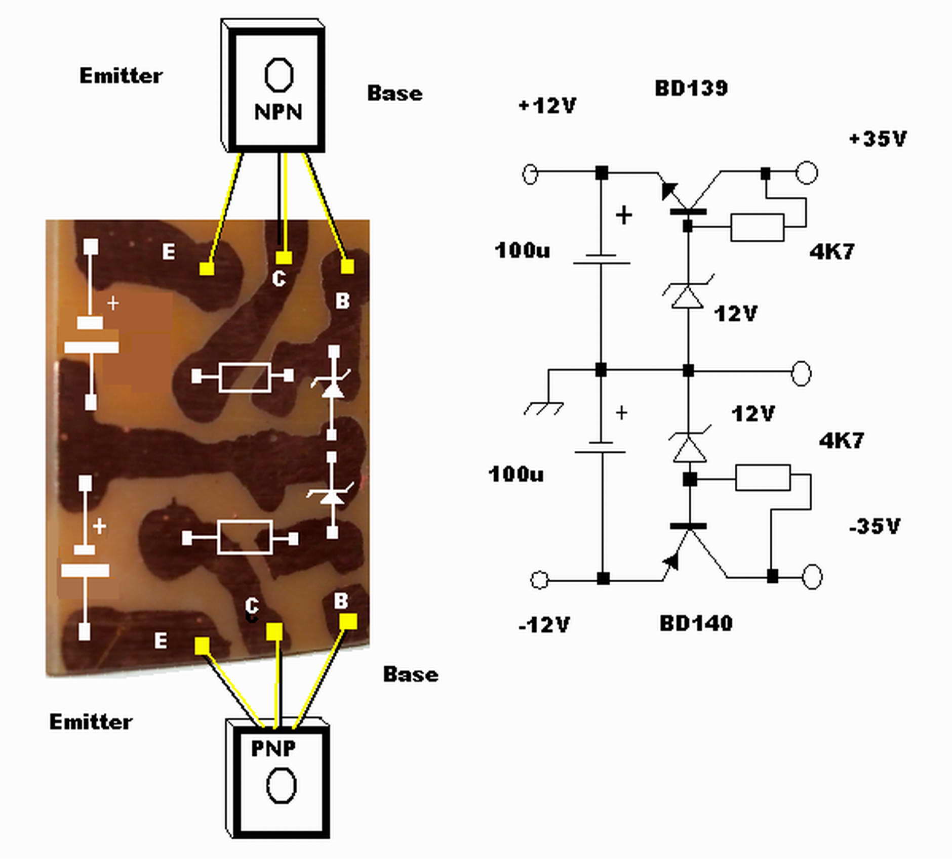

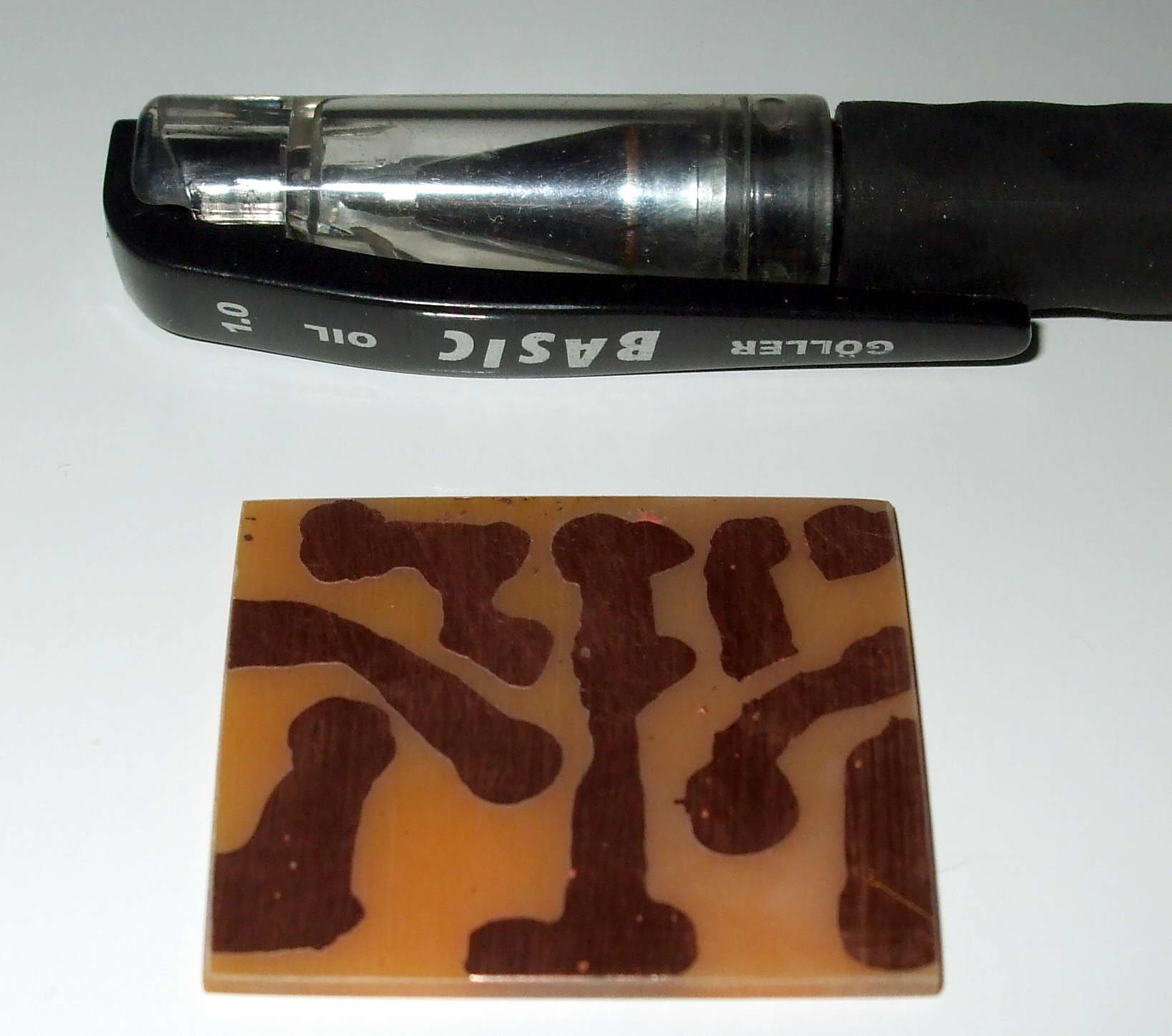

My method to produce boards is so simple that people do not understand
It is so obvious, so natural, that people feel confused.
Watch dear friends..it is the schematic painted over the copper..parts will be soldered over the copper, no drilling, you can glue your board and attach it against heatsink or chassis panels.
My people is confused also..unbeliavable that!...it is much more simple than eagle software, toner transference, optical image transference.....it is stone age, fast and simple..works great to prototype.
It is not pretty..... this may be the problem...people looks and dislike and this blocks their minds.
regards,
Carlos
