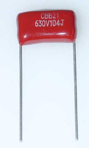

Nice ones...very nice ones...do not know about the distance from lead to lead
Maybe, (not sure) it can be a little bit big.
I have posted the part list... the BOM..... well, i think i did.
By the way..will post once again.
regards,
Carlos
regards,
Carlos

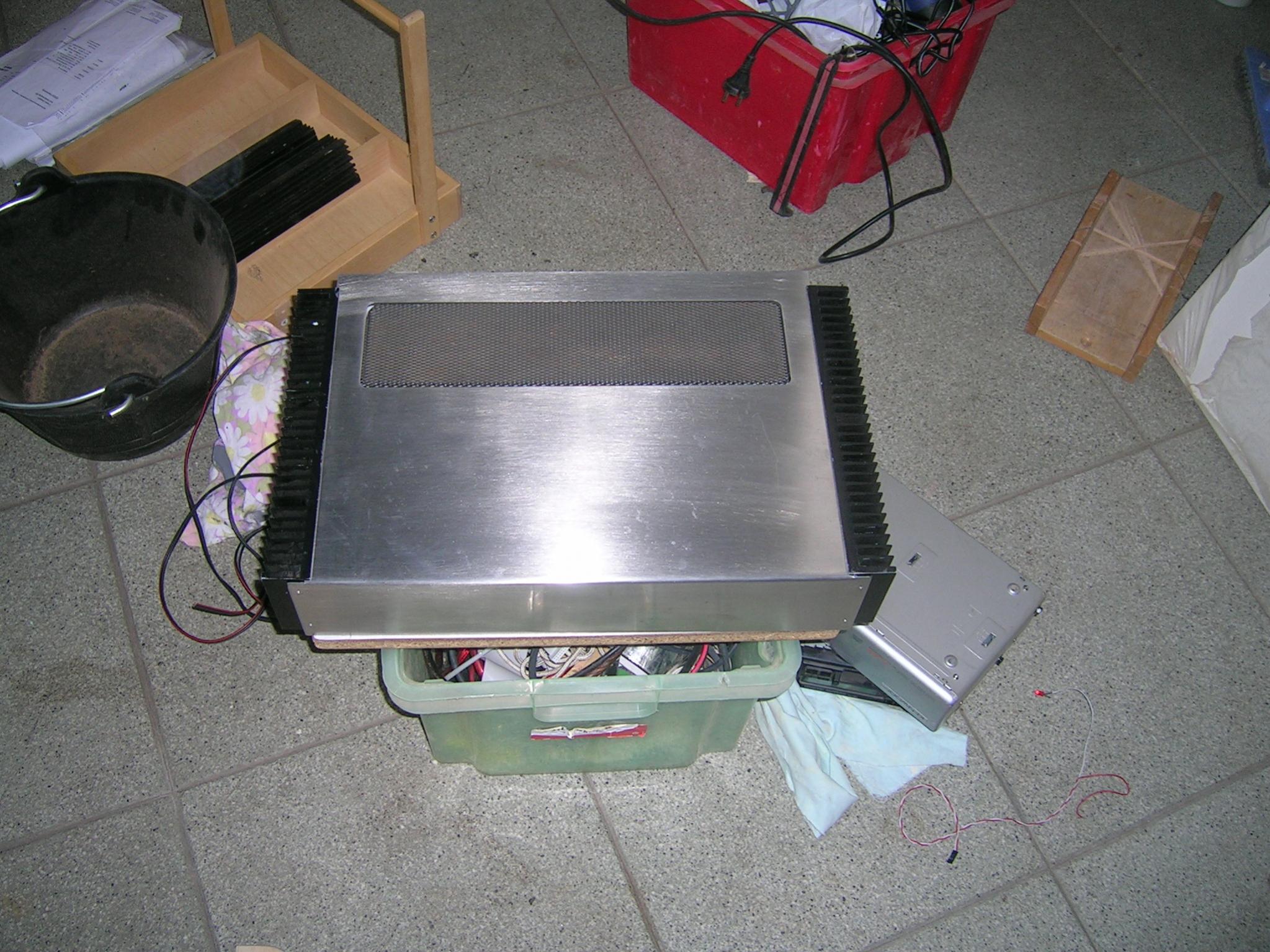

Good morning, Lex,
German division of DXCorp. Intl. is using the SANKENs (2SA1216 and 2SC2922)as well.
They sound like the BlameES waited for them to inspire the atmosphere with an orgy of sound.
Look how Volker mounted them:
He screwed them directly to his 10mm ALU bottom plate.
And as he told me: they are getting lukewarm even when he plays tracks with lots of bass in them.
He didn't of course feed a 20Hz sinus wave into the input - so the SANKENs (and the BlameES) are not driven to their extent.
So long - no problems with the SANKENs and passive cooling (even though I am still a little bit afraid when it comes to mounting his design into a case).
Best regards - Rudi
