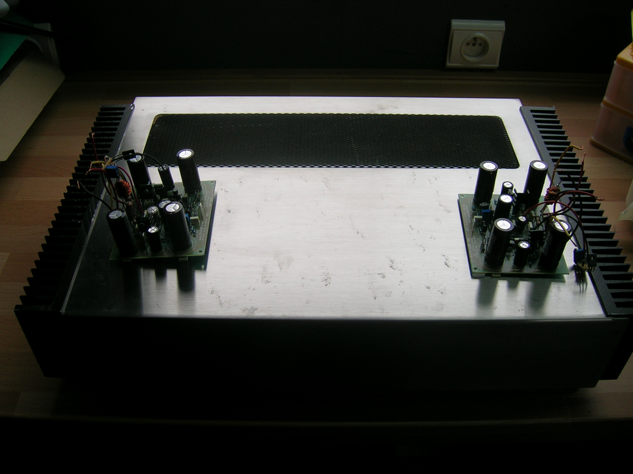

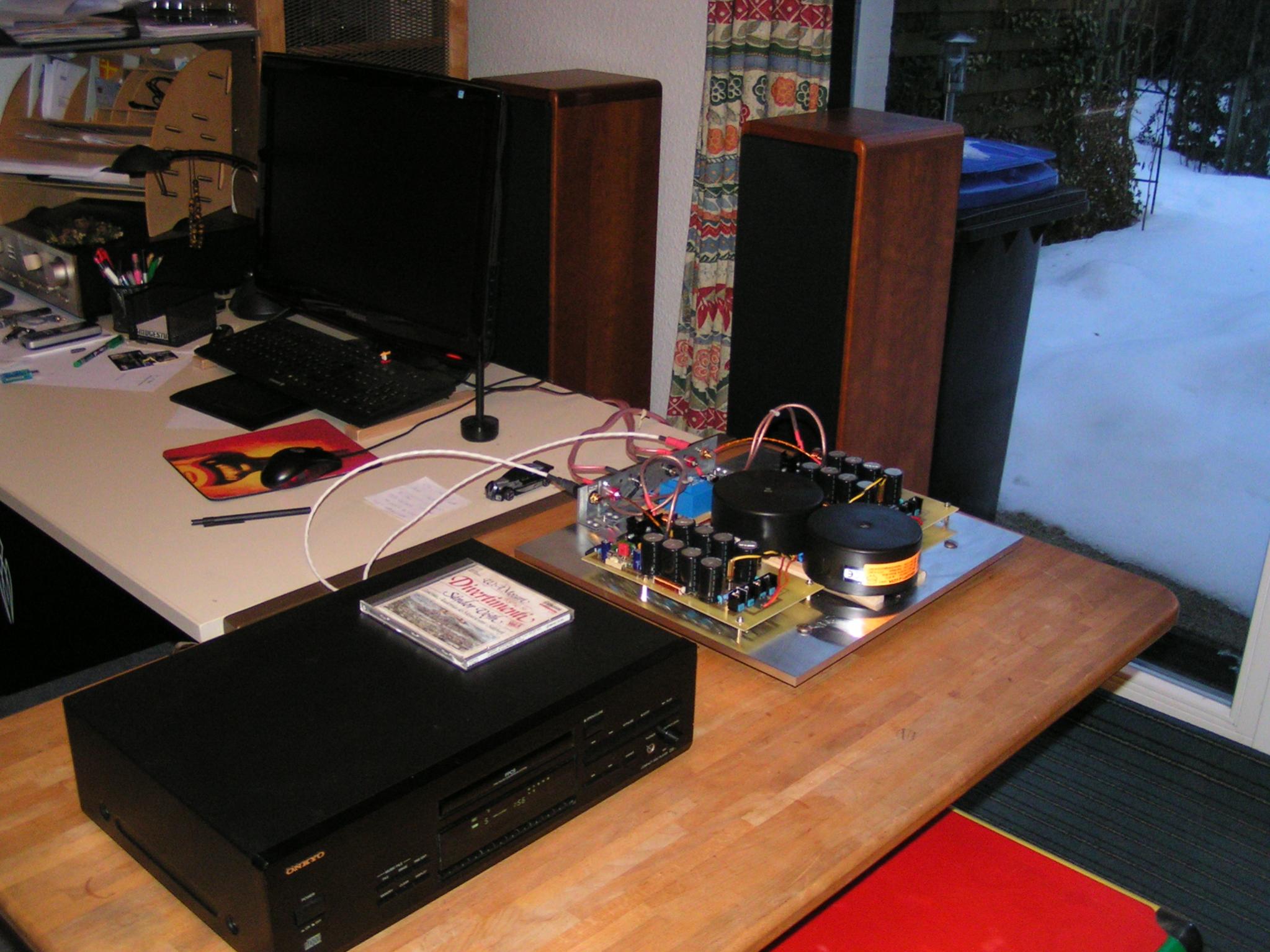

Now its working fine )
a little bit mV are in offset, 14 one side, 3 the other...
And, out of the box, there is a very nice sound, i´m very happy...
The Sankens are cold, after 30 Min Mozart......*g*
later more....now i must lissen !!
No problems with off set bellow 25 milivolts..even 25 milivolts represents
less than a hundred microwatts..nothing to worry about..differences are normal as you know, depends on parts matching, not only active but also some passive too.
Enjoy, sounds very good and you can increase volume and the audio source level and will be surprised.
Thank you by the pictures and congratulations by your construction, very nice work you have done.

@ Carlos....
hey, you have done a realy good work with this amplifer....it´s playing better and better, houer by houer.. and i have made only minimal basic settings, there is a great potential waiting for me
But ceep in mind, at last, this amplifer must do his work for testing with B&W N801, then we will hear the truth....but i´m not angry, i think the blame will do it without any stress
i love this amp, after 4 houers!!! realy very great!!!!

Thank you very much
I am glad you have appreciated the amplifier... i know Germans are very demanding...so, your evaluation deeply interests me.
Well, this amplifier plays lovely with my B&W speakers (Bull s--- and Waste) speaker... mine ones is that way.... of course will be good with your real units... excelent speaker, with world fame of highest quality.
My people felt your construction wonderfull.... having time produce more pictures.... your amplifier is looking great.

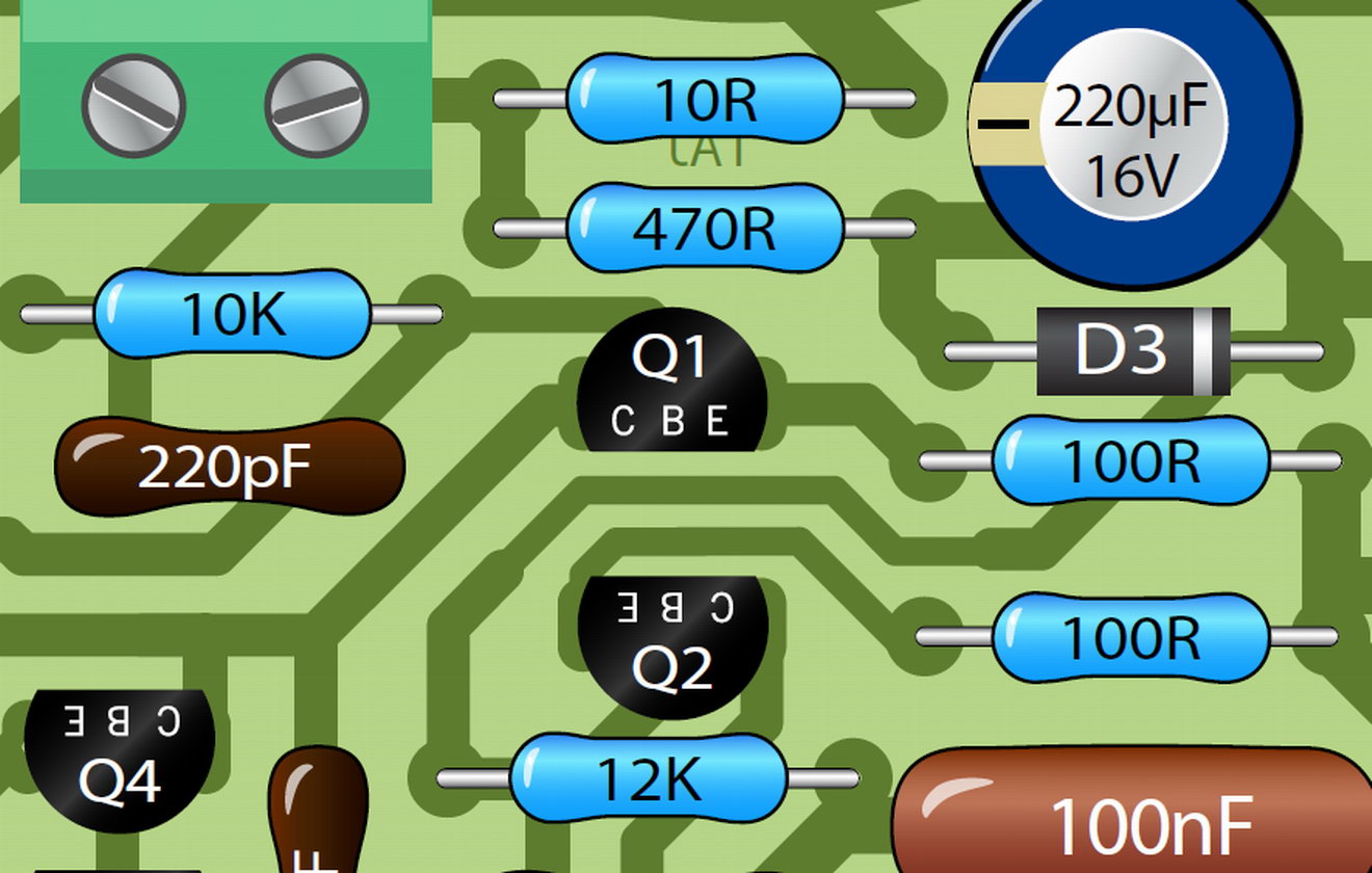

C18 is 220n.... or 0.22uF, despite part list says different compared to the schematic....not a big problem if use 2.2uF....just more noise during power on.
Do not increase C10 or C7, i have tried, sound lost focus.... big loss of resolution and details.... reduction of R26 is positive, even removal is fine (using wire jumper in place)..but please, do not increase it.

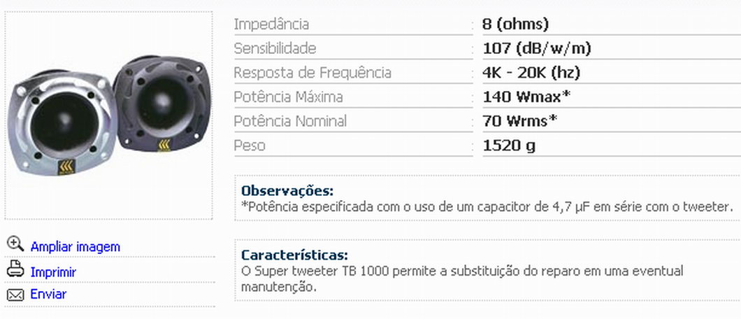

My speaker is using capacitors only to the super tweeter, a Bravox Professional high power unit..they suggest me 4.7uf...i found better to use 2.2uf....my midrange is also professional unit, and they asked me to use 15uf, i am using 10uf...the woofer is receiving the signal directly after cross a 10 amps fuse.... i have used a resistance in series with the midrange, because my home acoustics..i have used a software connected to my PC, a microphone captured my speaker sound and white noise was reproduced and captured by the microphone, i found my speaker reasonable, not flat, as no one is flat, but not too much unflat too.

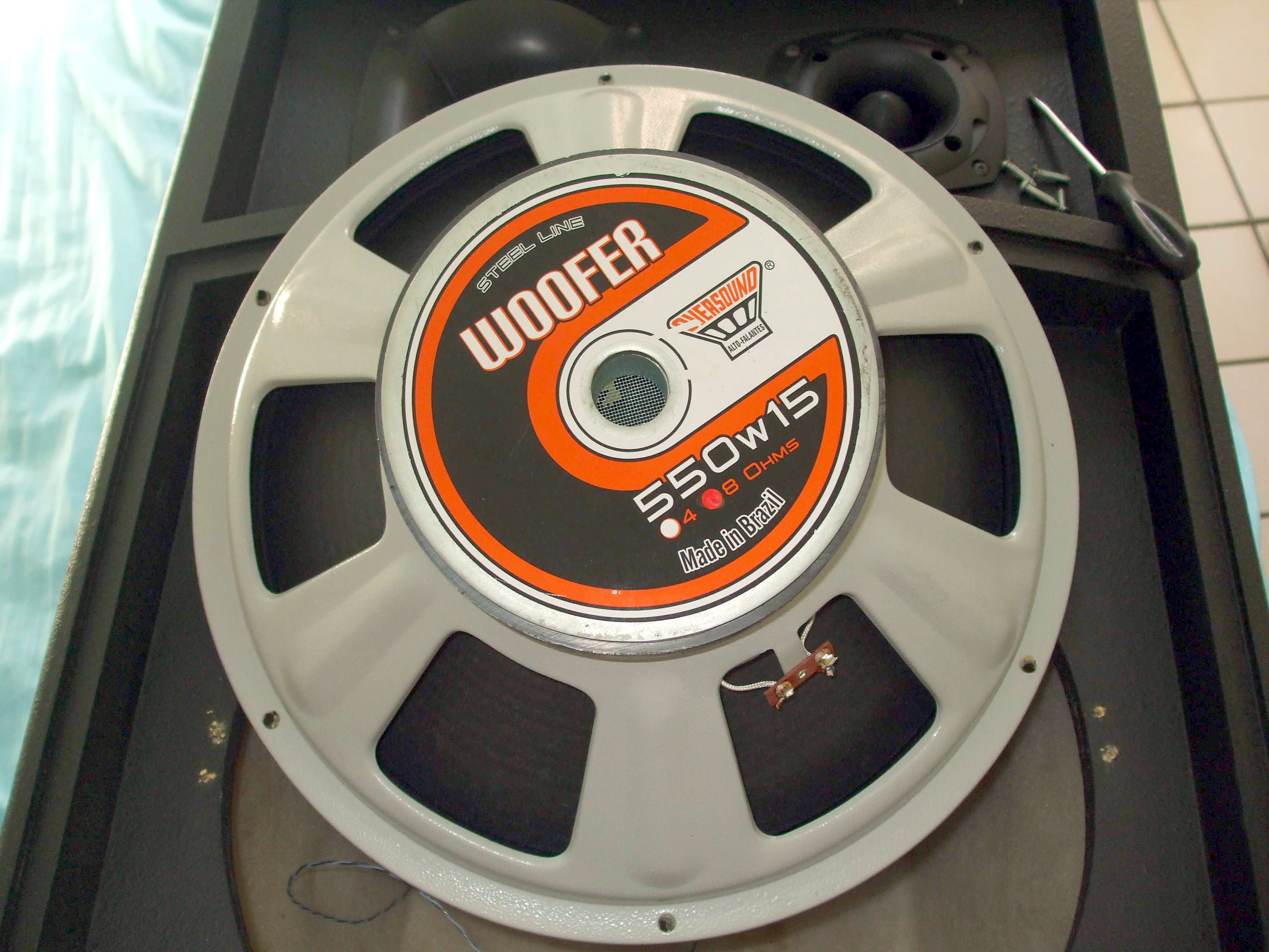

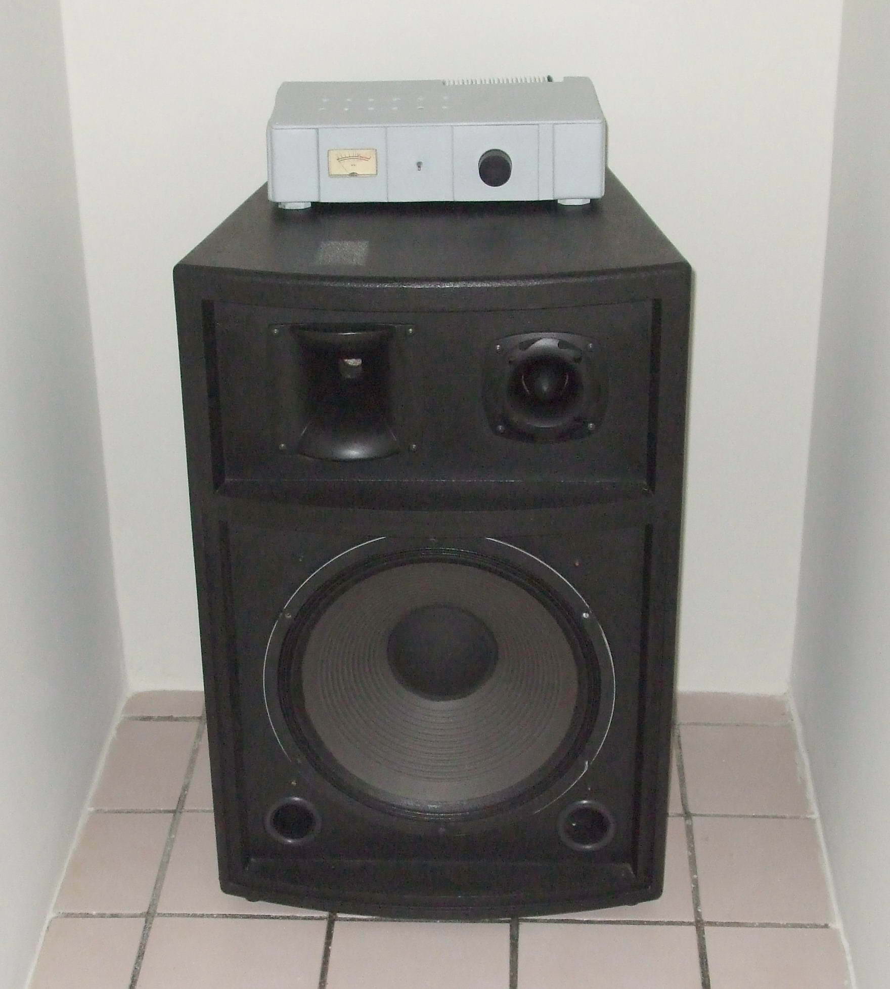

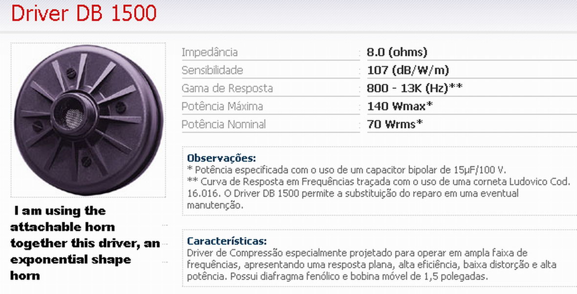

My speakers are fine, they are the ones i could afford... my woofer is
not that special, because this cost a lot here.... i cannot buy a Bravox subwoofer because price is too high for our standards, it is sold in USA by a very good price, we have not that good price because our standards, our average income is smaller than US income.
But even this way i am having a good speaker that can reproduce a very clear 25 hertz with 1 watt entering and drivers are professional ones.
See the pictures...i have used a software to check if they are flat.
regards,
Carlos
