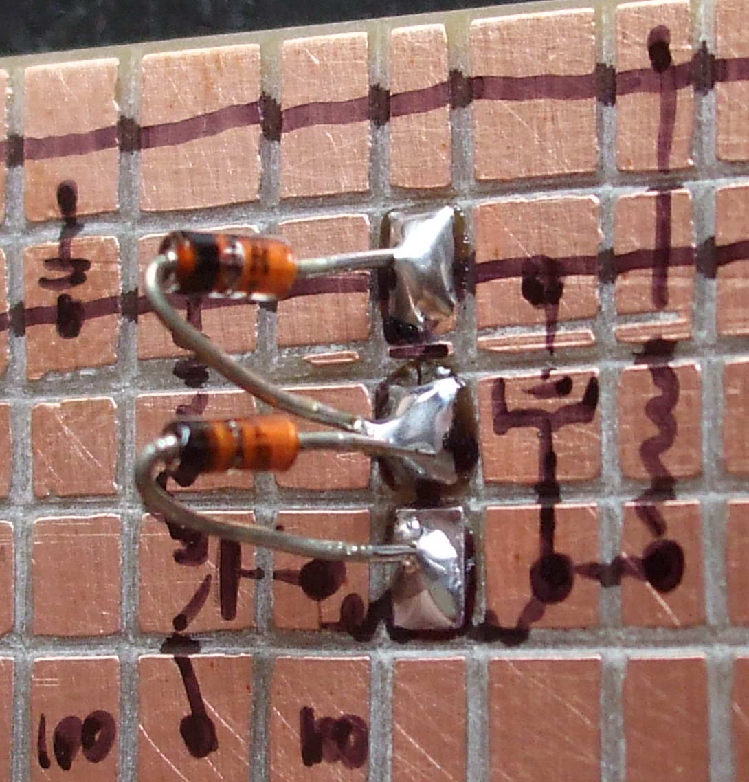

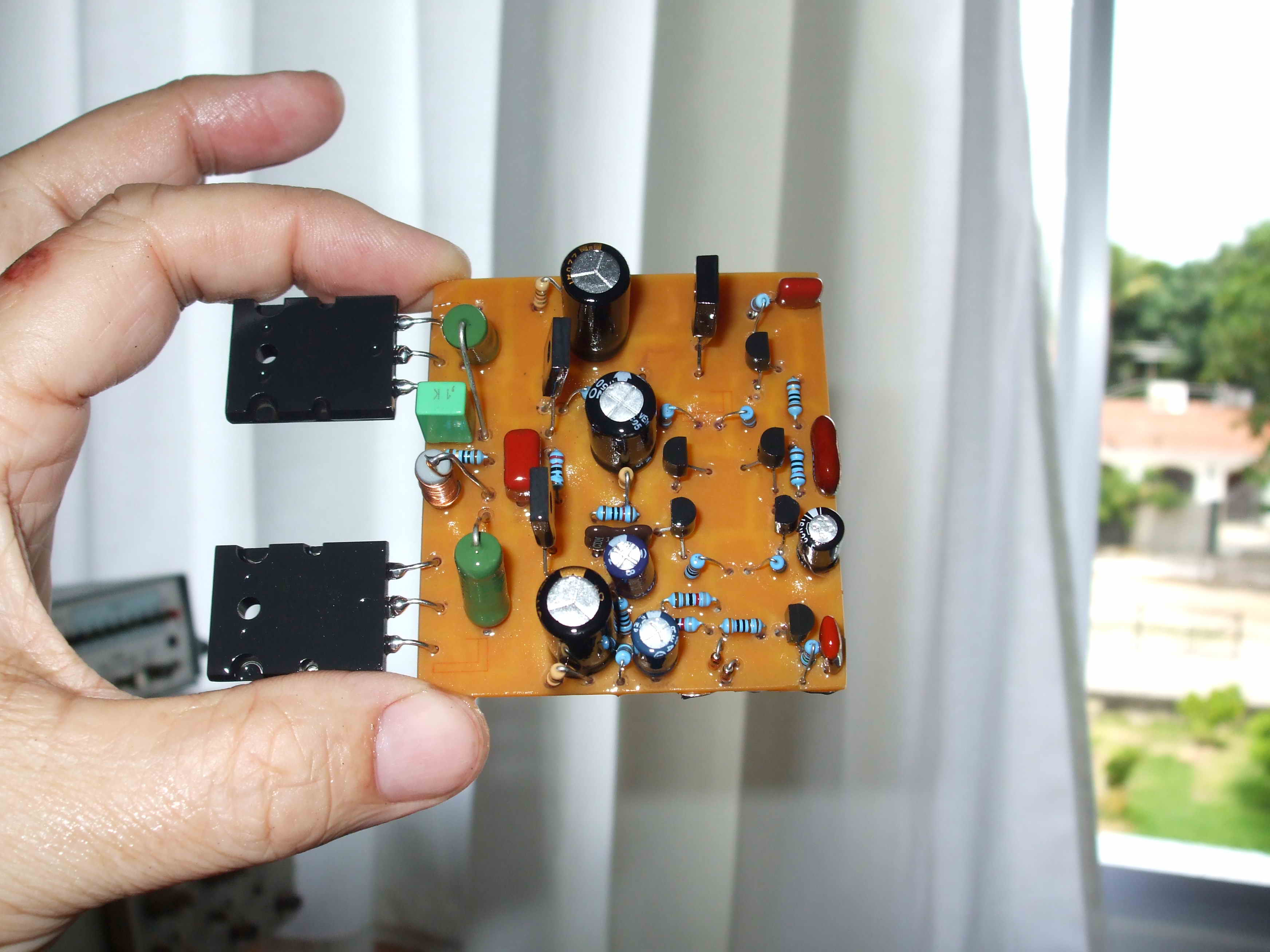

Sorry to jump all the way to the end without thoroughly reading all 64 pages between.
But I gotta say that construction method on Pg1 is awesome! I've seen the Manhattan
style before, where copper covered PCB islands are glued to a groundplane board. But
never occoured to me to simply gouge out channels on one side... What too did you
abuse to get such a clean groove?

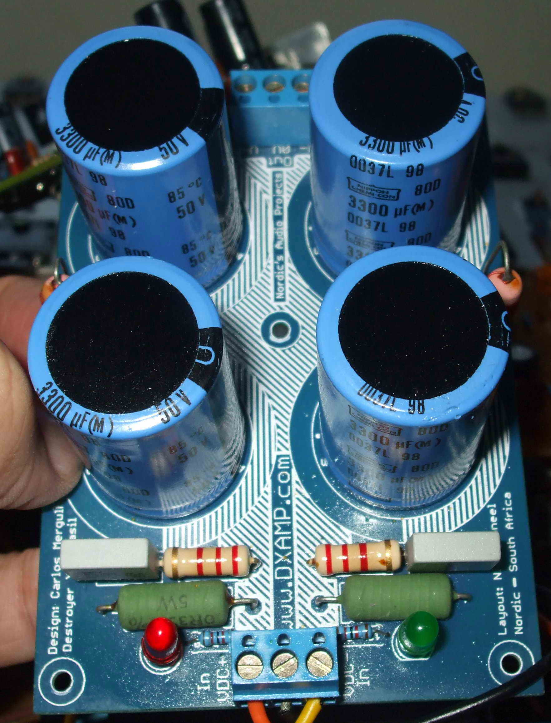

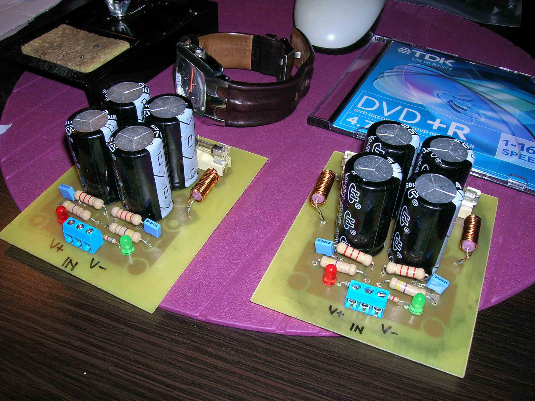

Luka, from Polland is building Dx supplies for his Dx Blame ES
Nice supplies, works fine!
regards,
Carlos

Thank you hermano, i have used a steel metal blade used to fix transistors in place
The blade had a hole, in the corner of this hole i have used a screwdriver as a tool to create a blade for cutting.
The blade was sharpened using sandpaper.... i think i have made a youtube video about that.
We need to use some strength. after a couple of minutes you feel pain doing that, it is not the best way to do, for sure, it was the way i found.
I will search for the video to post the lin....

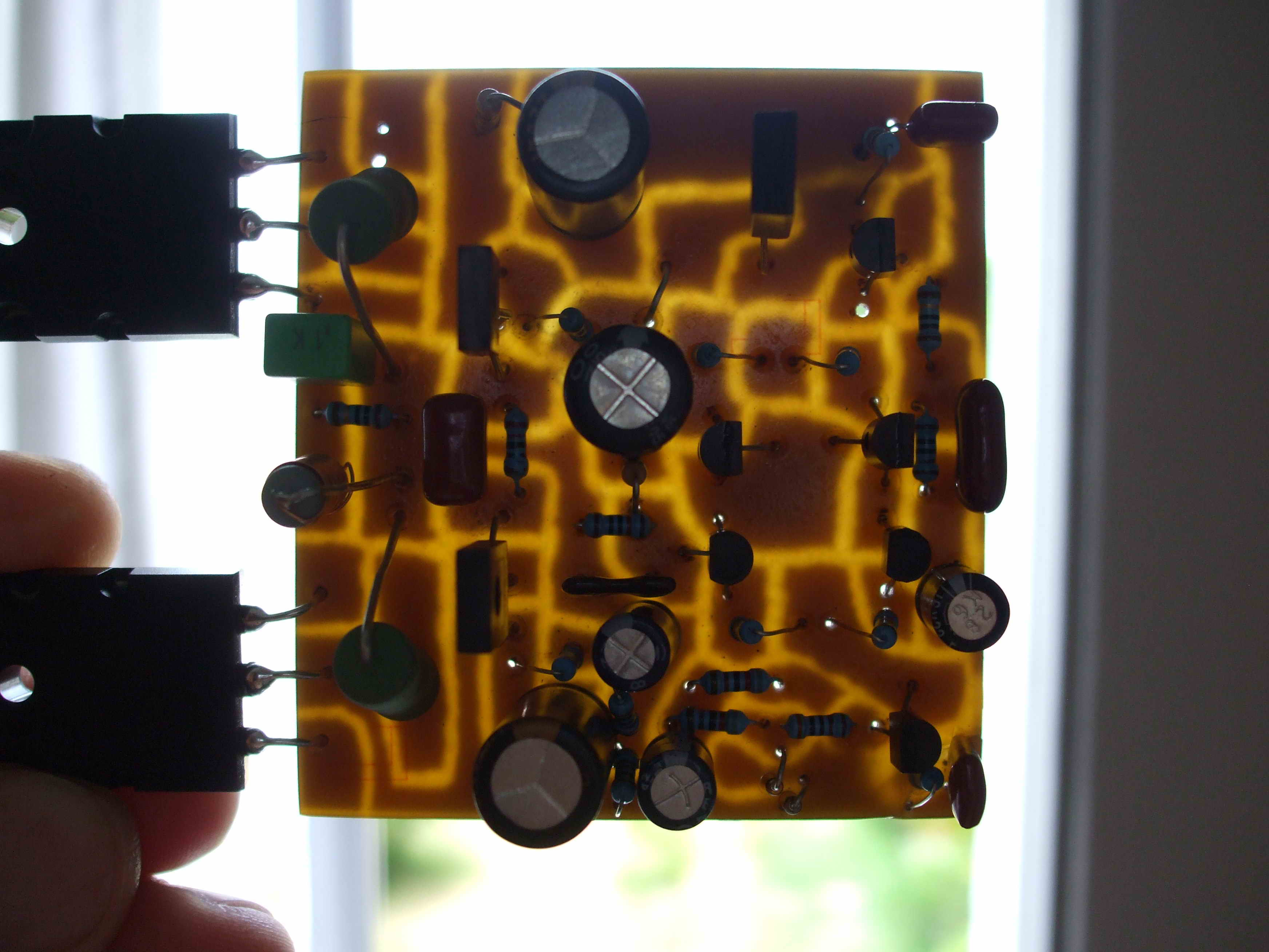

This other way is hard to be made, but can be used for emergencies
when we have no acid to etch boards.
You trace your schematic in the component side, then you open holes to the component leads... the other side only copper and holes...then you join the common holes in big islands painted with a pen... islands that will join several leads together... them, the last is hard, you have to watch the upper side, then turn the board and paint the same thing under the board, the copper foil side... finishing that you use high speed drilling machine with a dentist ball point drill bit to remove copper in between the copper blocks that were painted in black.
This method uses some insulated wire jumpers, travelling bellow the board.
When i started i was very young, had not money to buy chemical products, then i have developed other ways to do.
Here is a video that shows some pictures while constructing a board:
YouTube - Dx Blame ES, board made high speed drilling machine
regards,
Carlos

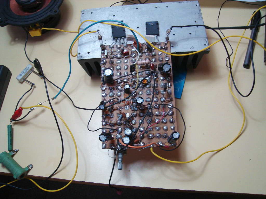

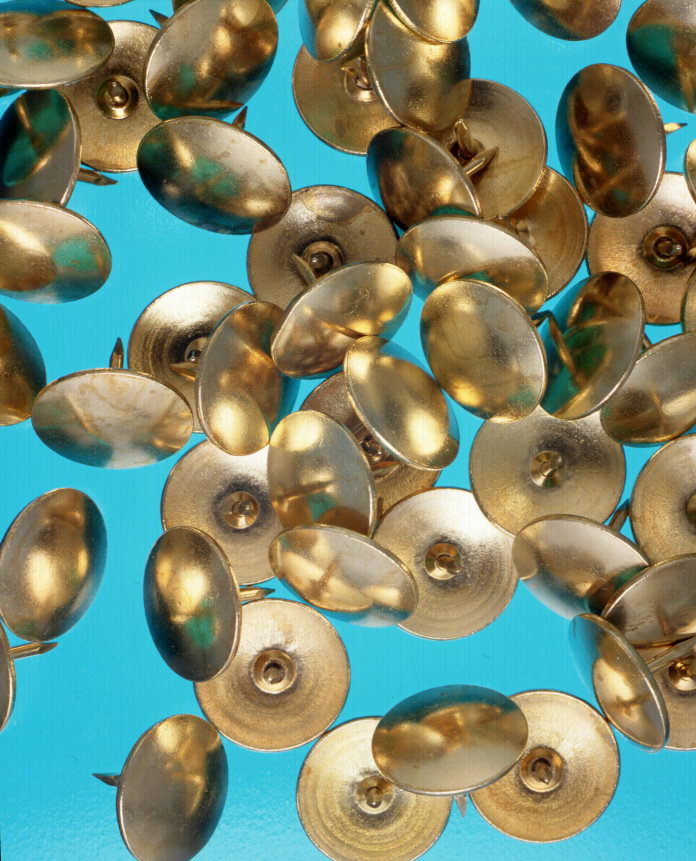

Other way, the first way i have used, was in 1960
Beach boys where playing "My 409" in the radio.
I used a piece of wood, and then i used a hammer and tacks, drawing pins, made of brass, things used to fix paper over a billboard.
So, i have used as connection points, as copper islands... telephone thin wire were use to interconnect .
Here you have an image, a prototype board i gave to a local friend...this one etched and having circles as islands, to solder over the copper side (SMD was first made by uncle charlie)... this one is the Dx Blame ES, assembled this way, by my friend Egbert.
First graphic equalizer was also made by uncle charlie, i have used uA741 ancient operational amplifiers... uncle is very old, half century buiding amplifiers, the best one was found in 1970, the boostrapped, the one attached, since that moment, my love and passion by boostrapped amplifiers never ended... this thing was my first wife, the ethernal passion...real womans, also wives (3) i had several. and love finished three times, but for the bootstrapped the love and passion is still alive.
In 1964 i realised that pré amplifiers were not needed, and that i could have better sound without them...since that moment, no more pré amplifiers..only volume potentiometers.
I use all methods to produce boards, or a base to solder parts, when i cannot use the best way, then i use some secondary method..but amplifier's construction never stops.
Point to point, using thick wires, i have used to build Radio Frequency Linear amplifiers, power units..but only with electron Tubes.
regards,
Carlos
