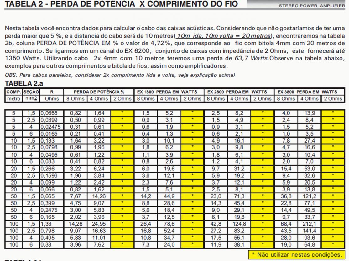

Yeah, those thick wires.... really...not needed.
I am using internet ADSL cable..then i remove the plastic cover... a lot of wires there, and very good, i have tested then with 25 amperes and they worked fine till 15 inches (we do not use more than that).
People loves to use those thick ones.... in excess i think, over dimensioned, overkill.
Crossover also uses this way...even length is small.
If we think about the speaker coil, the wire diameter, and having resistance, power there..we see that we overkill the stuff.

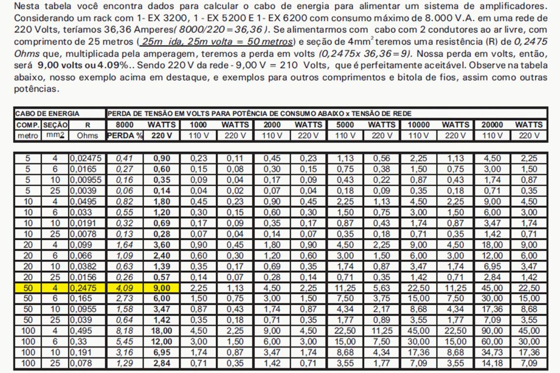

In this Brazilian power amplifier (schematic already with Jan Dupont), you see they have applied a chart at the final.... in this case, several meters of cable length, then we need some care about wire gauge.
Manual is 538K, so, if someone wants, just let me know... was sent to Jan Dupont.
I could not post because of size.
then i have produced pictures, the first one is the manual front page, the second shows power cable length in a chart, the third one shows the power losses depending cable length and gauge.
they are in portuguese, but power, lengthes, losses, all this is almost international.
regards,
Carlos

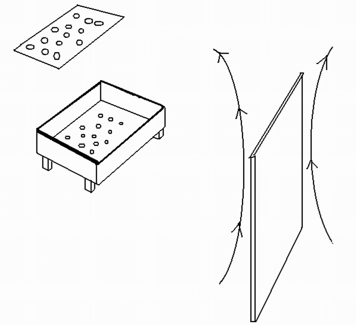

Bottom plate, and also the whole enclosure can be used
but are not very good heatsinks...hot air goes up, and sucks cold air from bellow the equipment...beause of that you need a big distance (long supporting feet... almost 3 inches) to reduce the air flow resistance... the bottom place have to receive several holes, at least 25 percent of the bottom plate shoud be removed with drilling machine... also, your top cover will need to have bigger roles or vents too, and to create the flow, top cover holes must be bigger in area compared to the bottom holes, to create a convection current.
This is interesting, but not efficient, works not very good, will help you but the power dissipation capacity is reduced this way, not exposed to the air, only one side will operate with 50 percent capacity of heat transference (my opinion) the other side, the other face, the one you have bellow, will transfer heat with 25 percent of the area transference.
This enormous plate, with top cover, placed over a flat table, will be good to an amplifier of 80 watts rms continuous, steady tone, non distorted watts, power heat will be almost twice (around 160 watts).... if outside the case, vertical position, exposed to free air, this same plate would be good to a 160 watt amplifier, sinking around 300 watts of heat to the air...but inside a case, as a case bottom, will be a oven, will cook all your condensers, resistances and so on....years passing everything will become dried, yellow in colour, capacitor plastic covers will crack, the yellow Silver Mica capacitors will became brown, ligth brown.
It may be good to two Dx Blame ES, playing music at average levels...it may work, maybe a fan, to exaust some air, using 8 volts as supply (not to be noisy) damped using pieces of rubber in their stand support, not to vibrate the whole case, may work fine.
I have tried this with a heathkit enclosure, all aluminium, and i have faced problems, worked in a very bad way...at the end i had to install outside heatsinks, fins in the normal vertical position to perfect cooling.
But even doing that way, we need feet to the enclosure, we need something to keep it high above the supporting surface, the table or the stand where the amplifier will rest... also distance from the wall is needed, at least 4 inches distant from the back wall, at least 4 inches to the furniture cover, door opened or not having doors if installed inside a furniture.
My experience with such things were obtained in a day by day basis, and of course, 29 degrées average environment,...if your place is 10 degrees average, then everything changes, and dissipation will be better...we do not want surface to reach 56 degrees celsius, this is the target after hours full undistorted continuous power... doing this way, your equipment will survive you.
Heat must go out, or be transfered to the air... this natural air flow movement is what makes wind.
