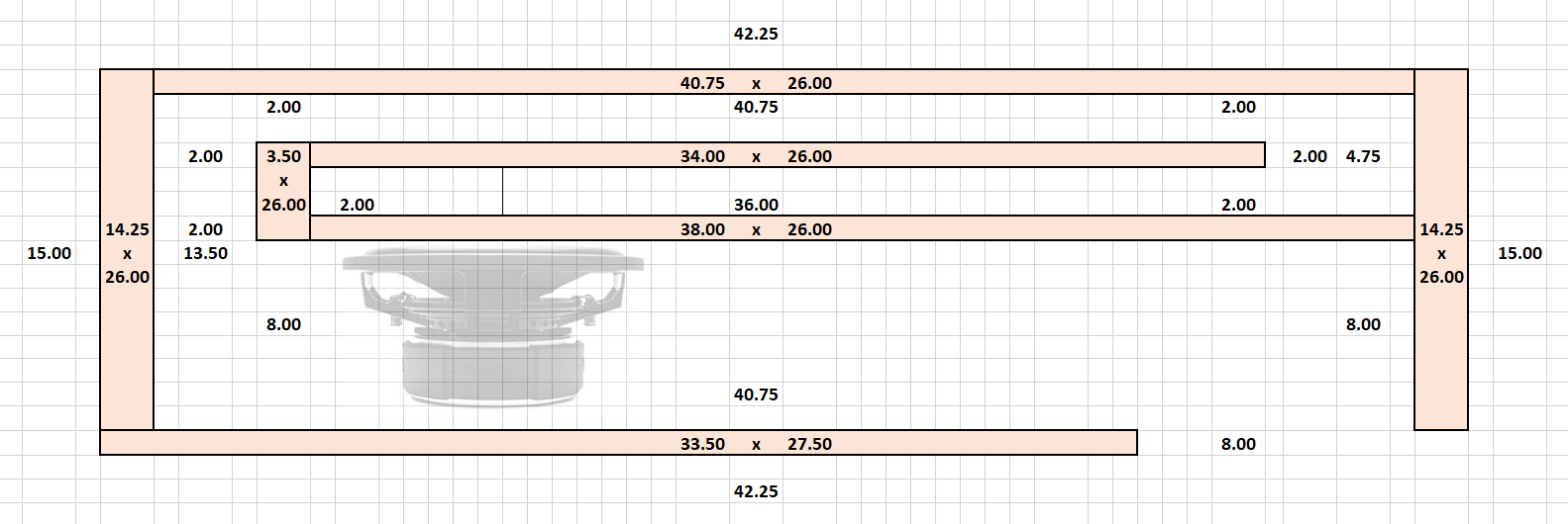

30 hertz is possible with a bigger enclosure...longer horn path. My last model is only 9ft. Remember, you stated 200-220 liters was the maximum.
Indeed, your post #151 model is 208liters, we have 12 liters more ( Wich is nothing) lol

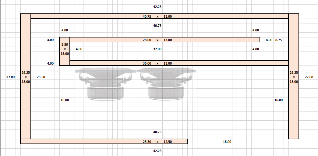

I assume you're referring to the C Cram since both mine & Bw's THs do a solid 30 Hz in much less net Vb.

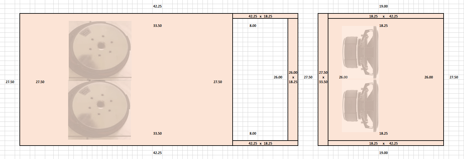

Yeah the CRAM, see 1 fold is maybe ok for HT as you don't mind a 6' or 7' tower cab, but for PA not practical to load unload from a truck.

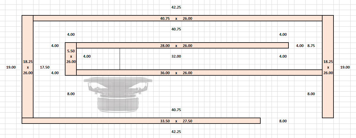

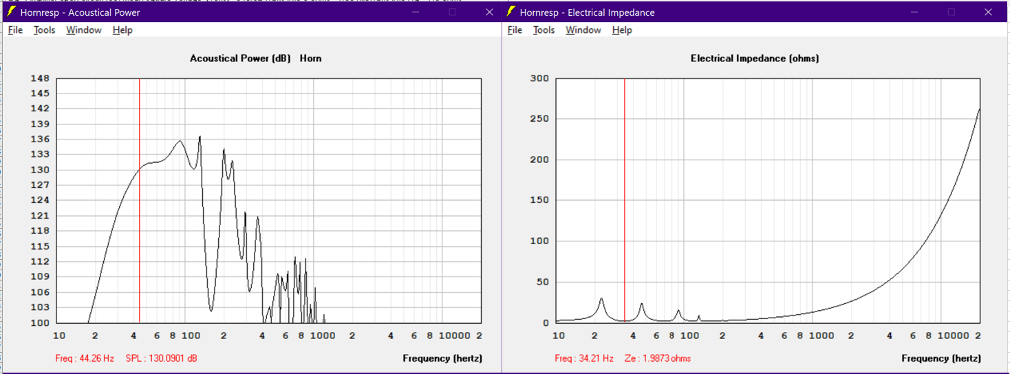

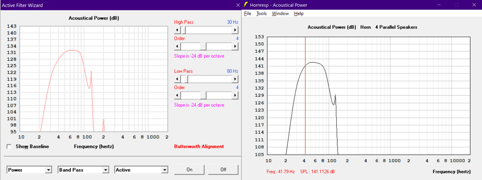

So you guys did not liked BP1 sim? It hit more than 140 with 4 cabinets.

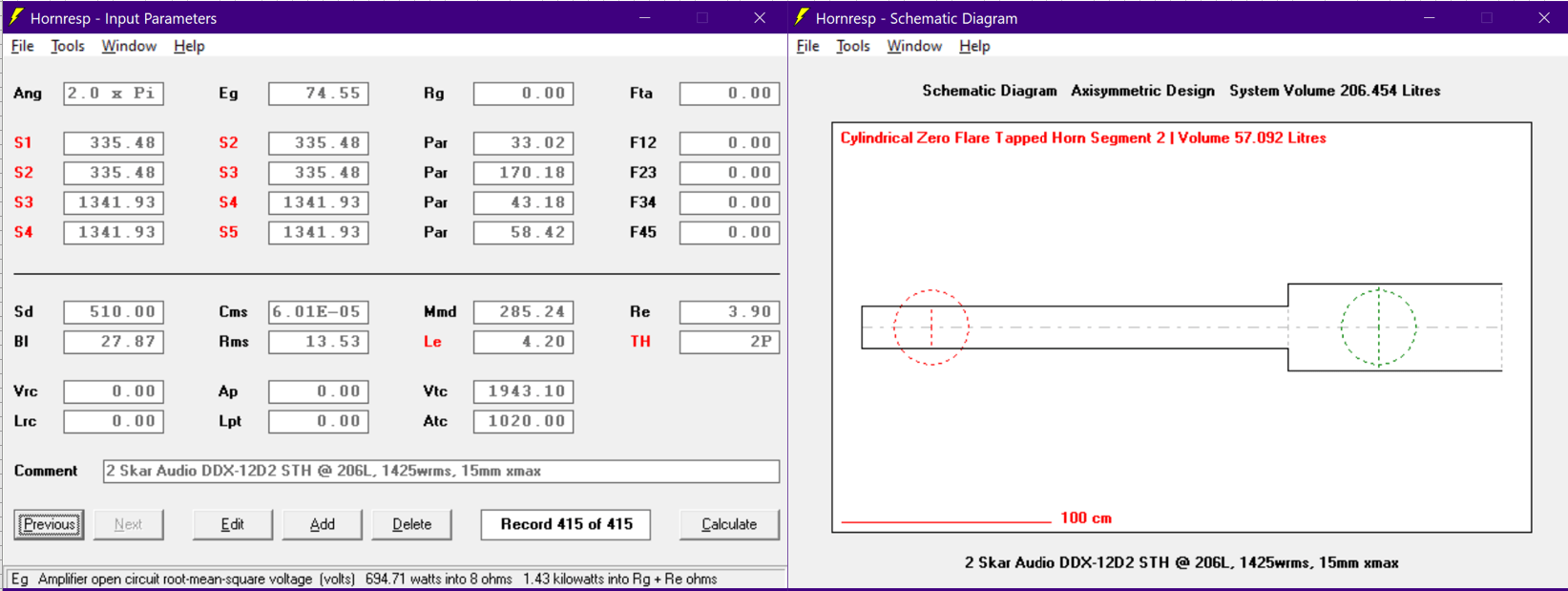

Dual skar 12.
Now in the other hand if there is a 18 or 21 driver than cost 300usd and do same or better, that is an option , my budget is 300 max for drivers per cab.
So right now 2 skars ddx12 are around 300
I want to hit 140 with 4 cabs if posible.

?? Both our TTL/TH can be multiple folded, though with no stepped piping, mine is easier to multi-fold.
Yeah, these 'missing' posts keep messing me up too! Really frustrating.

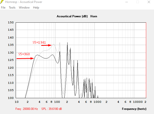

I've made no judgment of BP1's design; I mean his latest is just one of trading BW for a bit more peak SPL in a given max Vb, hence the need to go bigger to go lower at its present power rating; ergo obviously mine being smaller, yet having the wider BW means making more boxes to get the desired peak power, so only real gain is less 'back breaking' work (healthier long term*), but longer to set up/tear down and less power required.
Again though, 'we' weren't trying to meet your performance goals, just trying to educate a bit, but no, my alignment requires (8) ~150 L cabs @ 600 W/2pi to 'loaf' along at 140+ dB/m.

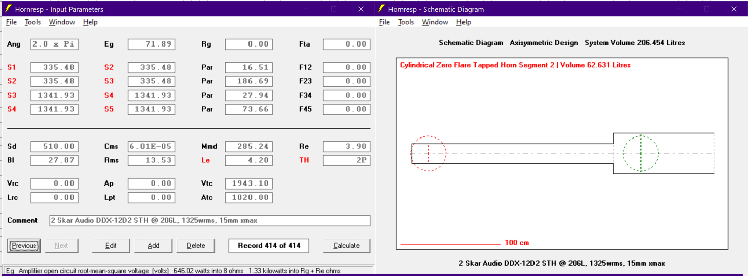

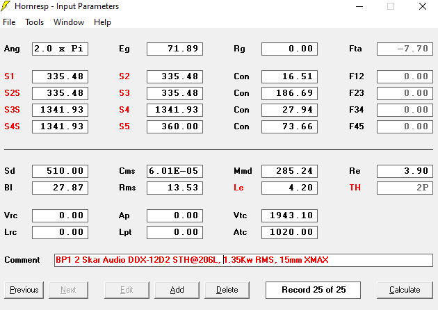

Hi BP,
Could you please advise what version or product number of Hornresp was used to produce the screen shown in the attachment.
Thanks,
David

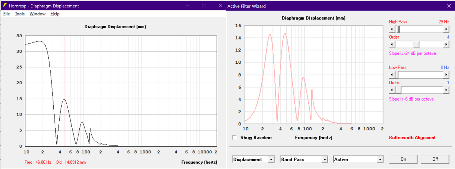

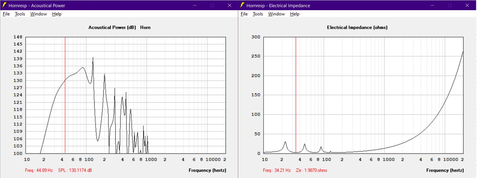

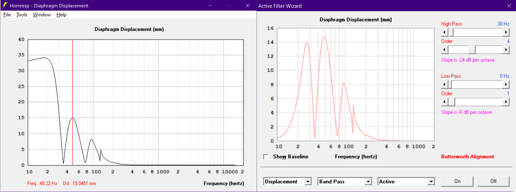

What does GM think about the high compression ratio And air velocity in 335 cm2 by chance? (I’m just curious, as ive run the ~same design at 400/1600cm2 and played it at ‘wide open throttle‘ often in a vehicle and it was intense!). Each ddx12 had its own pioneer 9701 amp and a lithium bank
The are missing letter S in BP1 screens right?
Correct, the same as in your Post #83.
I am trying to establish if it is a current bug, or one that has been fixed. I cannot replicate the problem myself using the latest release.

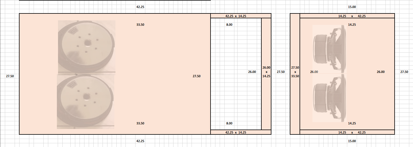

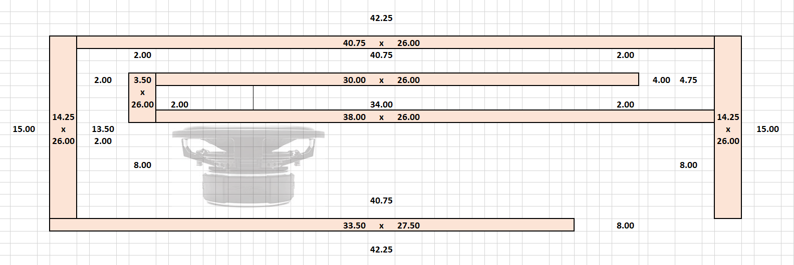

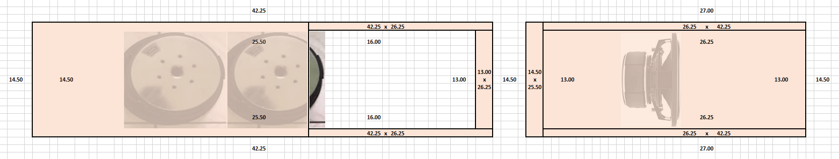

Then use the narrow enclosure with the 13" x 4" throat. Narrow or wide, you are getting 141dB @ 41hz with 4 enclosures or 0.5Pi for you bass guitar players 😉

- Dual Skar12 paraflex C CRAM
