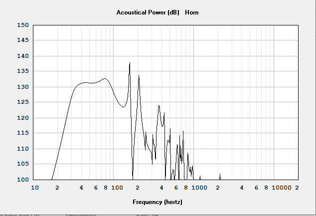

…just fills in the depression after the fundamental sides 3/4 harmonic as an added parallel offset entry resonator and appropriate TL stuffing As GM or Martin King would suggest.
I think this is a very basic description of some of the more current paraflex potential models/improvements. However, once stuffing so much and creating multiple resonators and shapes I quickly return to a simple offset entry TL/TP instead. It’s flat AF and ALWAYS consistent thru its own 5/4 harmonic. Additionally it can be tapered or reduced in the last of 3 folds to a ~6.66xFb bandwidth.

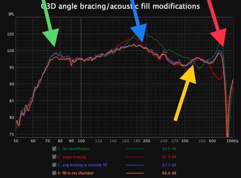

this isn’t a sub, but you can do the same )
green is fundamental
blue is it’s 3/4 and red is the 5/4.
yelliw and area of response that preceeds it is the split resonator that joins in parallel . Look at the lengths and associated freqs.. it all makes ’perfect’ sense

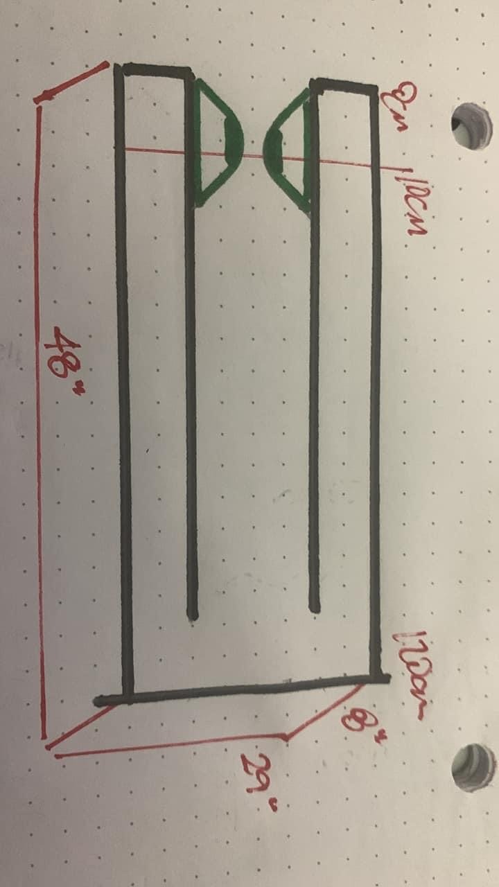

GM , like this(pic) ?

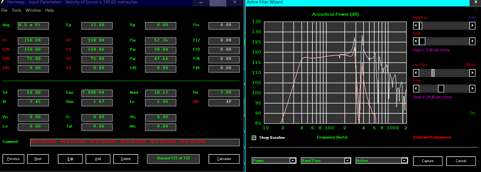

But, Ima math geek out too:
200cm 43.2 hz
66.66 cm 129.6 hz
40cm 216hz
150 cm 57.6 hz
50 cm 115.2hz(52.36 driver entry with end correction, mass loading and corner loading)
30 cm 288 hz
33.33 cm 259.2 hz (xo point shown)

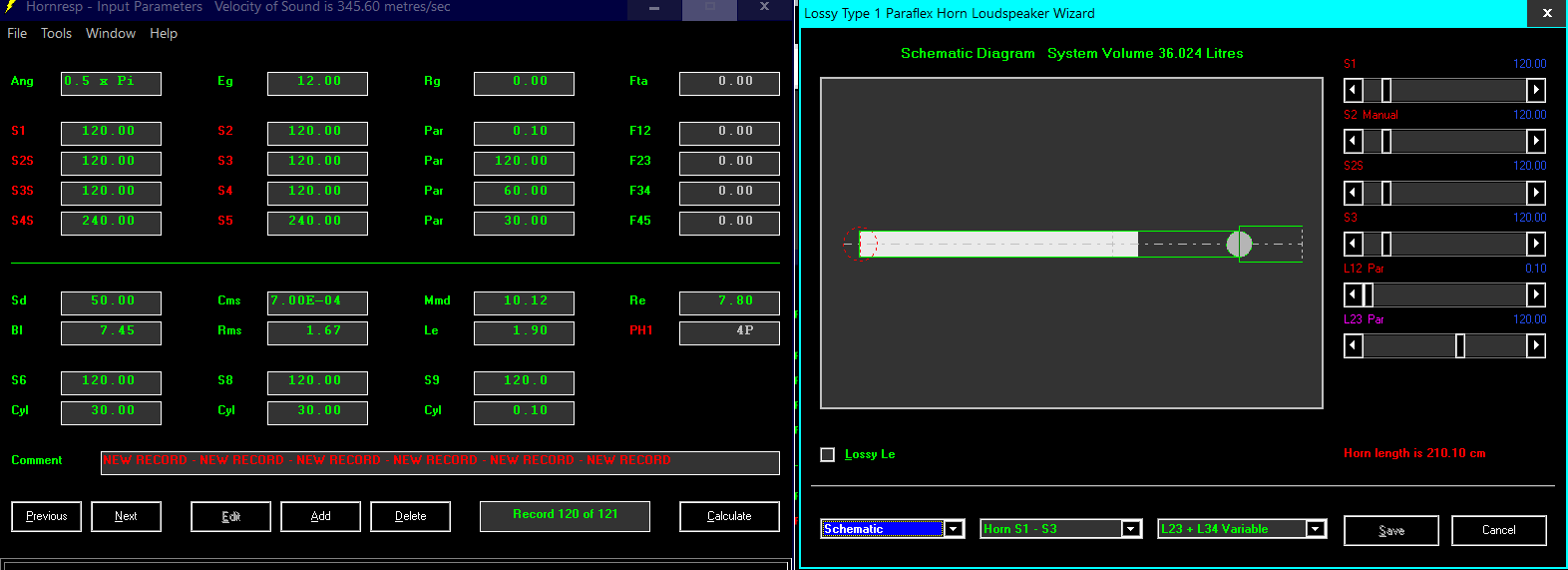

ID = 54.10
Comment = NEW RECORD - NEW RECORD - NEW RECORD - NEW RECORD - NEW RECORD - NEW RECORD
|RADIATION, SOURCE AND MOUTH PARAMETER VALUES:
Ang = 0.5 x Pi
Eg = 12.00
Rg = 0.00
Fta = 0.00
|HORN PARAMETER VALUES:
S1 = 150.00
S2 = 150.00
Par = 52.36
F12 = 0.00
S2S = 150.00
S3 = 150.00
Par = 50.00
F23 = 0.00
S3S = 75.00
S4 = 75.00
Par = 47.64
F34 = 0.00
S4S = 0.00
S5 = 0.00
L45 = 0.00
F45 = 0.00
|TRADITIONAL DRIVER PARAMETER VALUES:
Sd = 50.00
Bl = 7.45
Cms = 7.00E-04
Rms = 1.67
Mmd = 10.12
Le = 1.90
Re = 7.80
OD = 4P
|ADVANCED DRIVER PARAMETER VALUES FOR SEMI-INDUCTANCE MODEL:
Re' = 0.00
Leb = 0.00
Le = 0.00
Ke = 0.00
Rss = 0.00
|ADVANCED DRIVER PARAMETER VALUES FOR FREQUENCY-DEPENDENT DAMPING MODEL:
Rms = 0.00
Ams = 0.00
|PASSIVE RADIATOR PARAMETER VALUE:
Added Mass = 0.00
|CHAMBER PARAMETER VALUES:
Vrc = 0.00
Lrc = 0.00
Fr = 0.00
Tal = 0.00
Vtc = 0.00
Atc = 0.00
Acoustic Path Length = 0.0
|MAXIMUM SPL PARAMETER VALUES:
Pamp = 100
Vamp = 25
Iamp = 4
Pmax = 40
Xmax = 4.0
Maximum SPL Setting = 3
|ABSORBENT FILLING MATERIAL PARAMETER VALUES:
Fr1 = 100.00
Fr2 = 50.00
Fr3 = 0.00
Fr4 = 0.00
Tal1 = 0
Tal2 = 0
Tal3 = 100
Tal4 = 100
|ACTIVE BAND PASS FILTER PARAMETER VALUES:
High Pass Frequency = 0
High Pass Slope = 1
Low Pass Frequency = 259
Low Pass Slope = 1
Butterworth High Pass Order = 1
Butterworth Low Pass Order = 4
Linkwitz-Riley High Pass Order = 2
Linkwitz-Riley Low Pass Order = 2
Bessel High Pass Order = 1
Bessel Low Pass Order = 1
2nd Order High Pass Q = 0.5
2nd Order Low Pass Q = 0.5
4th Order High Pass Q = 0.5
4th Order Low Pass Q = 0.5
Active Filter Alignment = 1
Active Filter On / Off Switch = 3
|PASSIVE FILTER PARAMETER VALUES:
Series / Parallel 1 = S
Series / Parallel 2 = S
Series / Parallel 3 = S
Series / Parallel 4 = S
|EQUALISER FILTER PARAMETER VALUES:
Band 1 Frequency = 0
Band 1 Q Factor = 0.01
Band 1 Gain = 0.0
Band 1 Type = -1
Band 2 Frequency = 0
Band 2 Q Factor = 0.01
Band 2 Gain = 0.0
Band 2 Type = -1
Band 3 Frequency = 0
Band 3 Q Factor = 0.01
Band 3 Gain = 0.0
Band 3 Type = -1
Band 4 Frequency = 0
Band 4 Q Factor = 0.01
Band 4 Gain = 0.0
Band 4 Type = -1
Band 5 Frequency = 0
Band 5 Q Factor = 0.01
Band 5 Gain = 0.0
Band 5 Type = -1
Band 6 Frequency = 0
Band 6 Q Factor = 0.01
Band 6 Gain = 0.0
Band 6 Type = -1
|STATUS FLAGS:
Auto Path Flag = 0
Lossy Inductance Model Flag = 0
Semi-Inductance Model Flag = 0
Damping Model Flag = 0
Closed Mouth Flag = 0
Continuous Flag = 0
|OTHER SETTINGS:
Filter Type Index = 0
Filter Input Index = 0
Filter Output Index = 0
Filter Type = 2
MEH Configuration = 0
ME Amplifier Polarity Value = 1

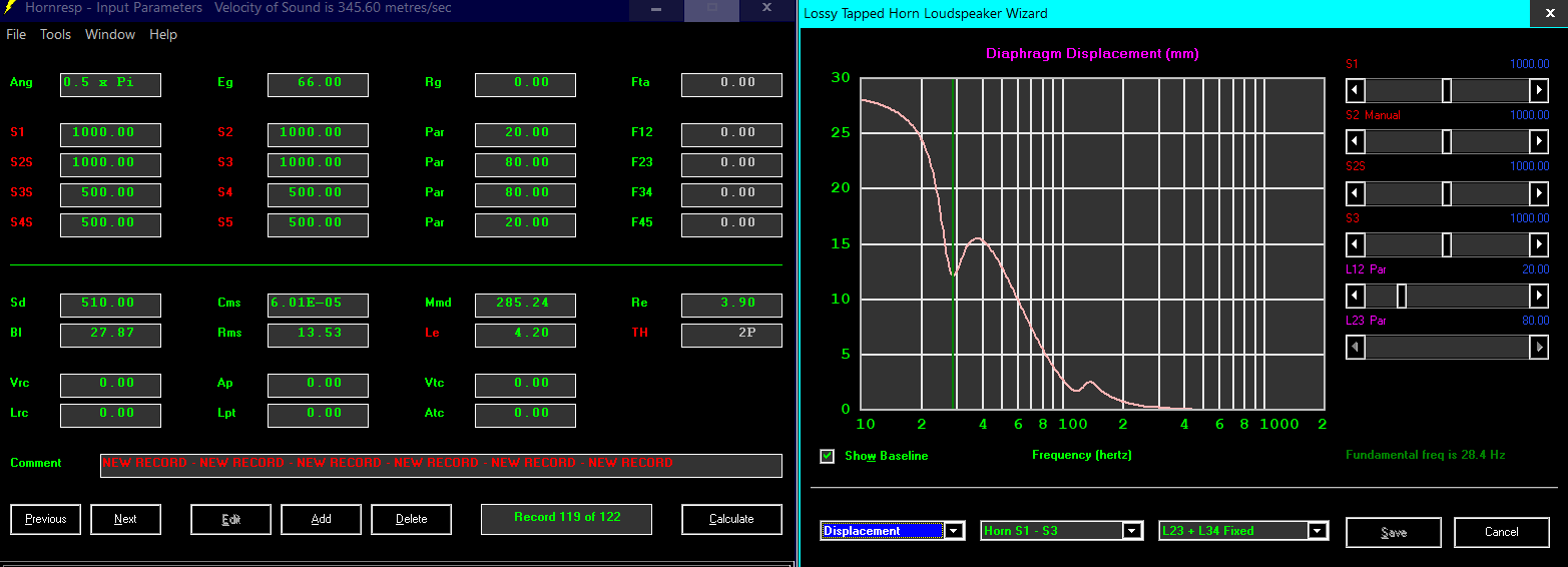

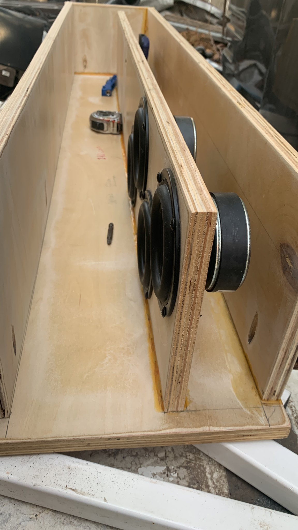

sorry, all i had pics of was the corner loaded sim... simple tapped pipe works great. (always)

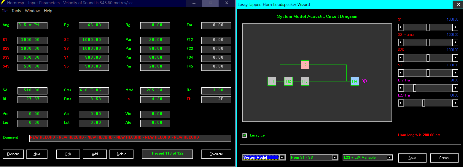

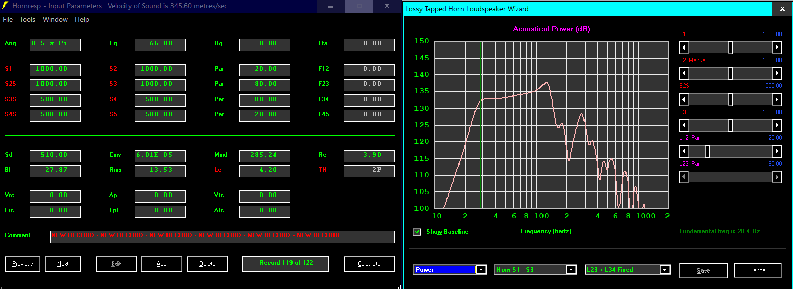

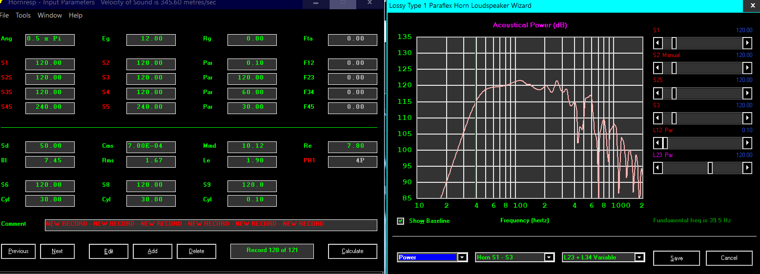

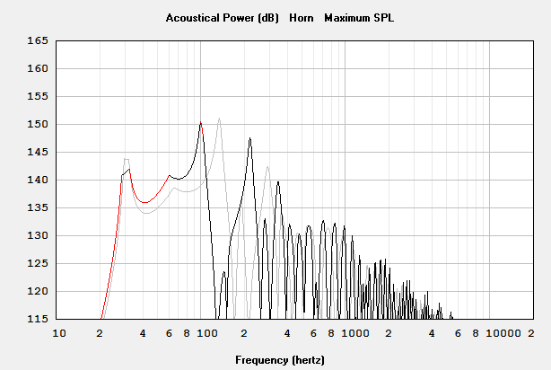

OK did a same size, tuning TH my non standard way Vs your 1/4 WL with mine being for max efficiency and yours (relatively speaking) max BW.
I used your 66 V/2178 W power, but realistically they can only handle 1 kW without using a HP to make them ~ a one note boombox.
  • SKARDDX12THgm.txt
Reactions: 1 users
