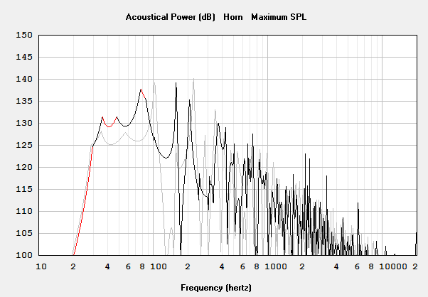

OK did a same size, tuning TH my non standard way Vs your 1/4 WL with mine being for max efficiency and yours (relatively speaking) max BW.
I used your 66 V/2178 W power, but realistically they can only handle 1 kW without using a HP to make them ~ a one note boombox.
I thought Max's original goal was 30-80hz?
See post #121I thought Max's original goal was 30-80hz?
That's where I am at as of now
What you think.
Well, both ours meet it, though admittedly it wasn't a comparison consideration.................I thought Max's original goal was 30-80hz?
OK, here's a comparison of my TH/TTL (150 L) and Max's C Cram (233.83 L) @ 1 kW, so factoring in the box Vb difference and the main difference is a ~ +6 dB/80 Hz 'one note' peak due primarily to its extra folding, tapering, so if size, simple construction is (one of) the primary design goal(s), seems like 'simple is as simple does' .
How it looks?
At this point dunno in that which of these designs best meets the needs of your app?

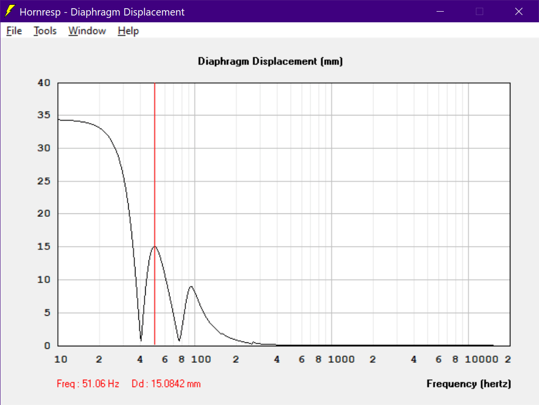

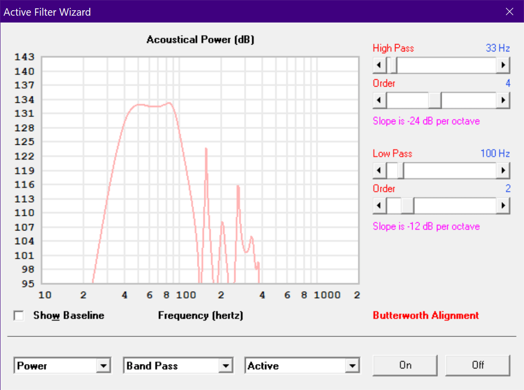

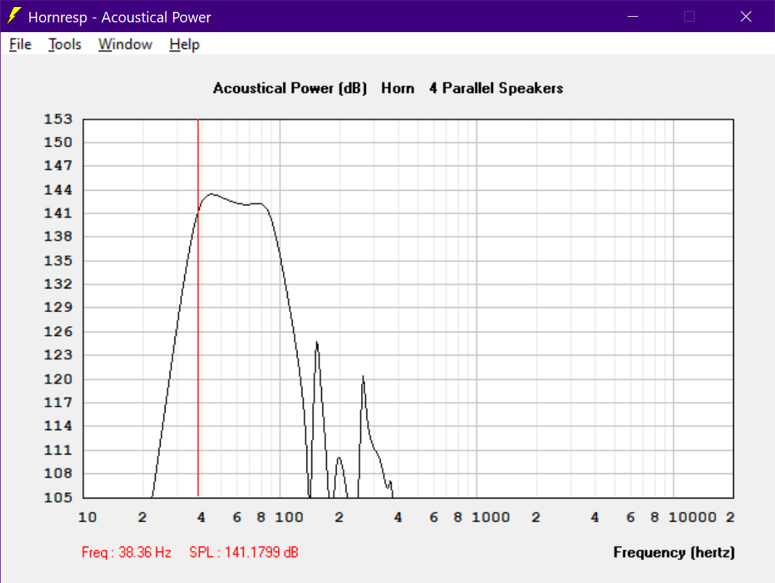

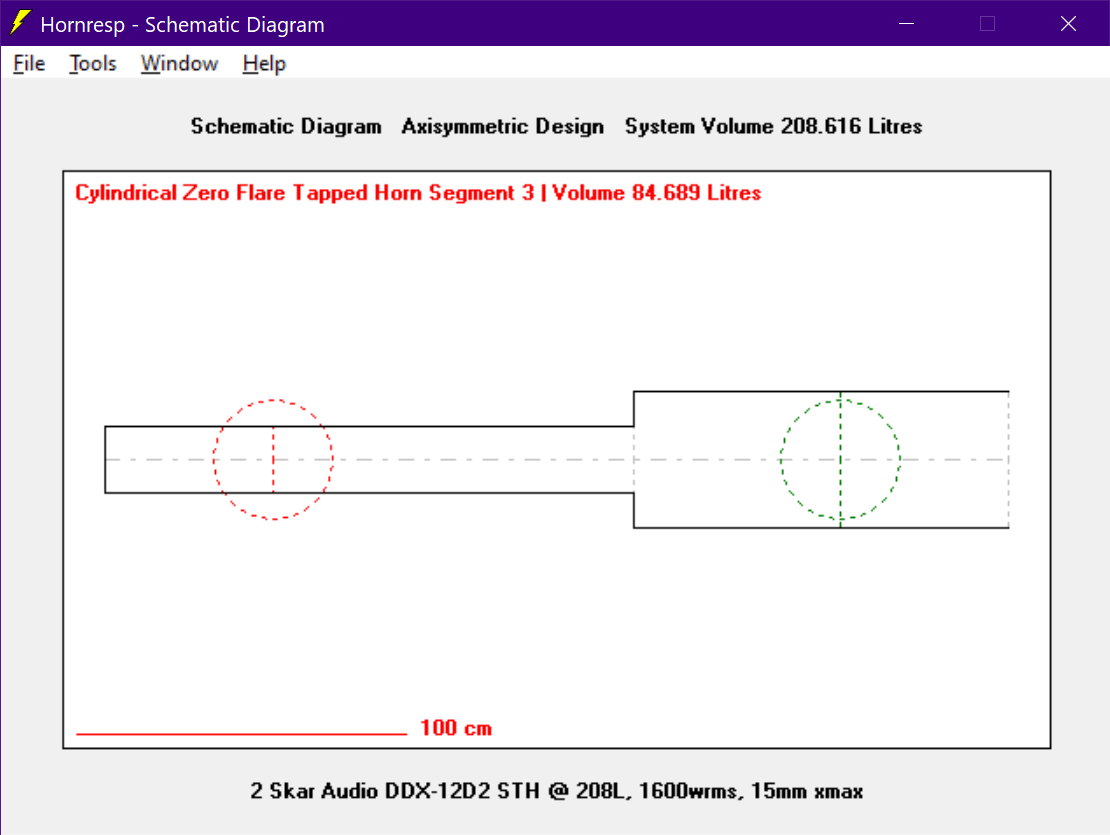

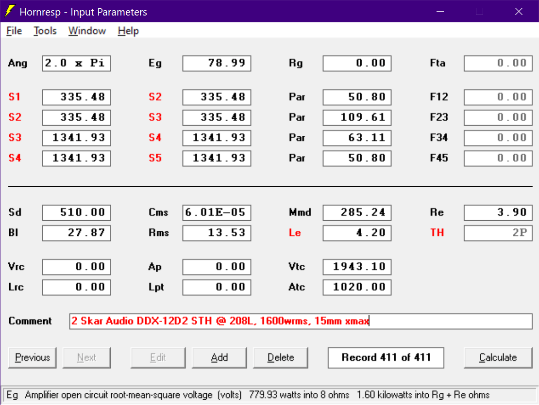

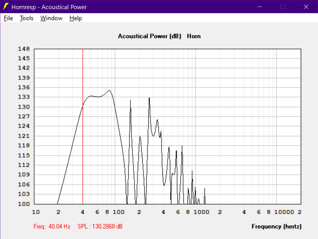

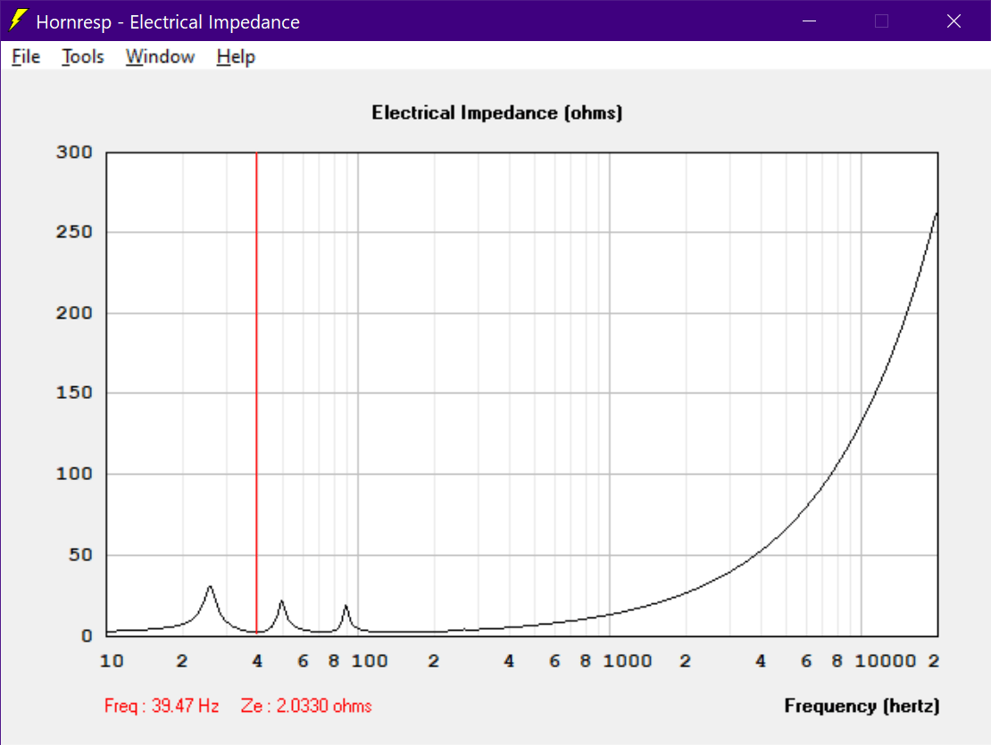

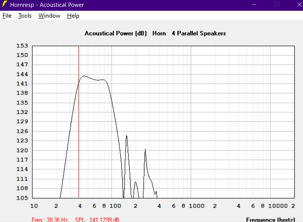

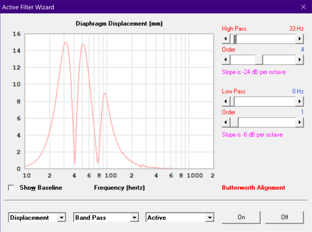

Ack! Missing new threads caught me out again! I was responding to Max's post.I showed 2pi (3rd & 7th screen shot) and 0.5pi (8th screenshot). I used your text file for the speaker parameters.

So then HornResp is screwed up ??30 hz with ddx12 is a joke right?
but not as a PA speaker. it won’t be ‘loud’ enough ?
