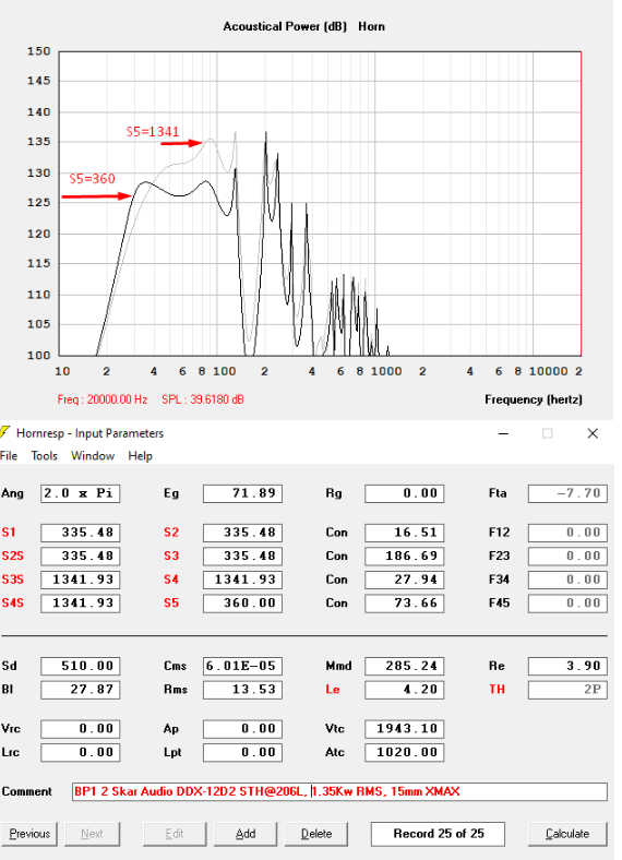

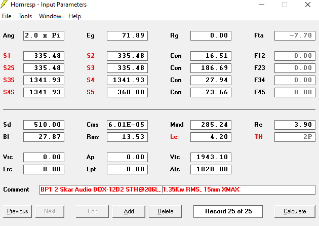

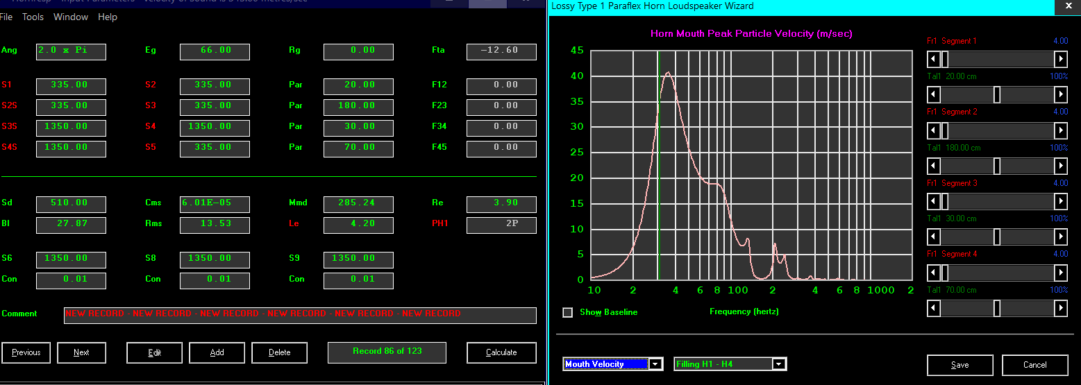

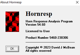

Hi BP,
Could you please advise what version or product number of Hornresp was used to produce the screen shown in the attachment.
Thanks,
David

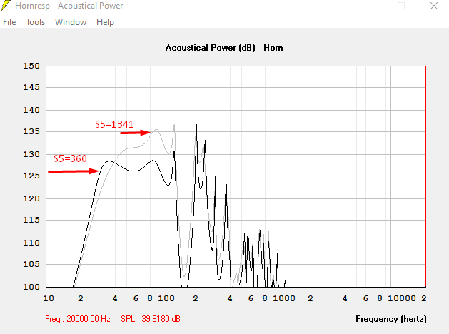

David,
im using the below

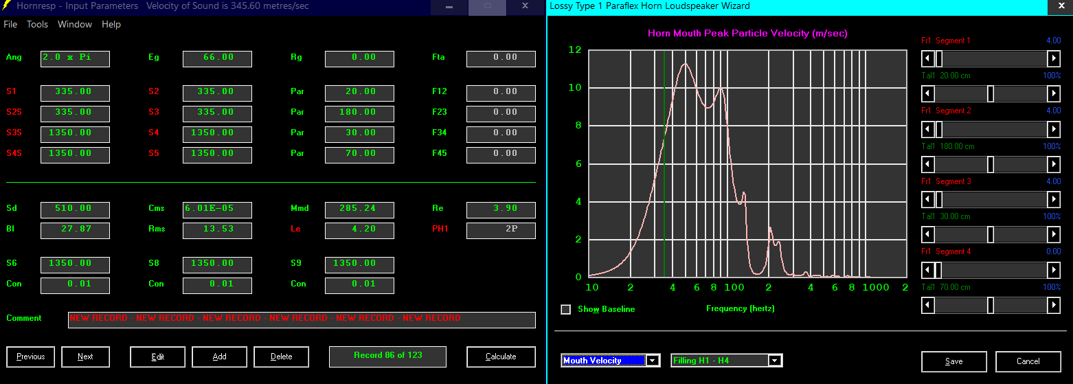

What does GM think about the high compression ratio And air velocity in 335 cm2 by chance?
TBH, I wasn't smart, educated enough to do other than believe in/follow the pioneer's (especially Bell Labs') extensive experience, so while Altec was known to use up to 12:1, experimented with up to 20:1 to find that Altec's was on the 'bleeding edge' according to my female listening group once critically damped, so max long term chose 10:1.
Without damping, never tried > the pioneer's 1:1.2561 max compression horn aspect ratio once any boundary conditions are accounted for, so can only assume/recommend HR's calculations and/or one's ears at the spec'd pi listening distance.

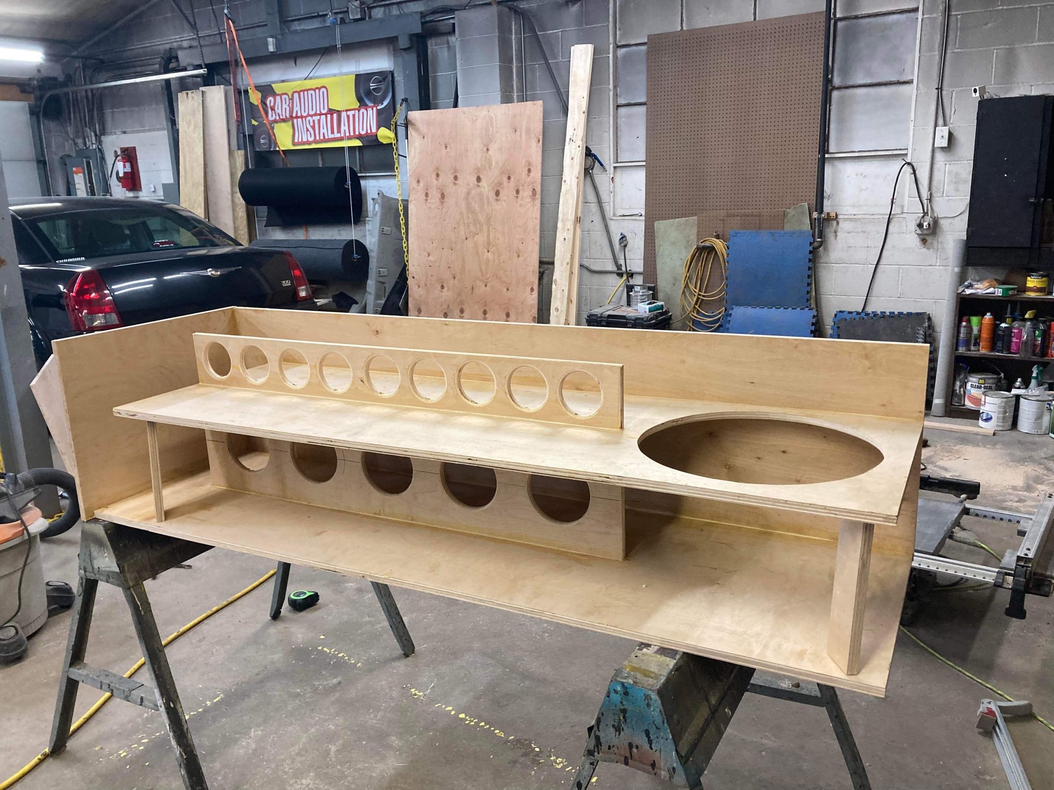

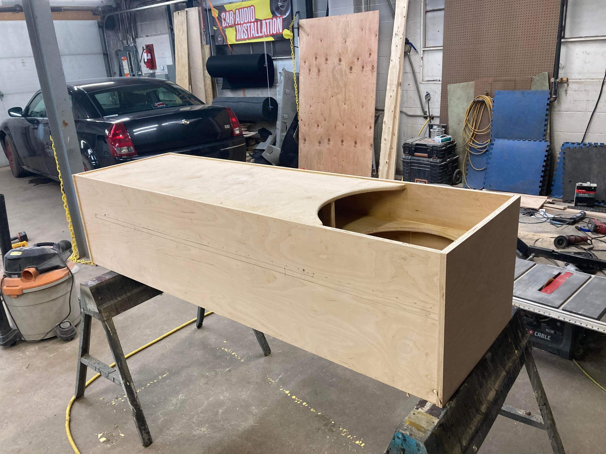

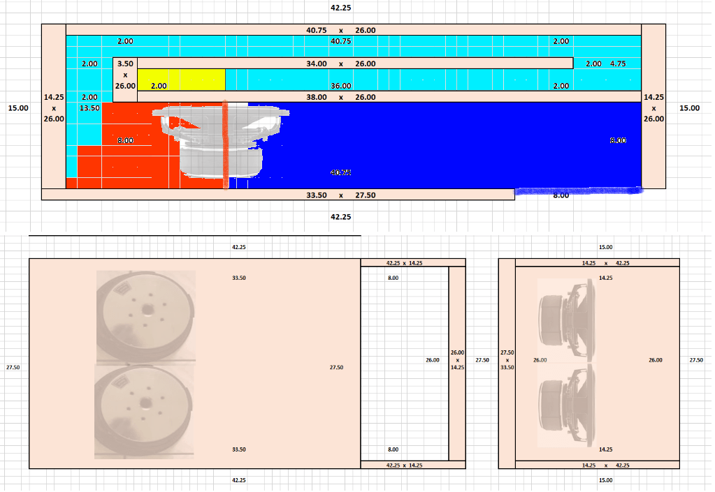

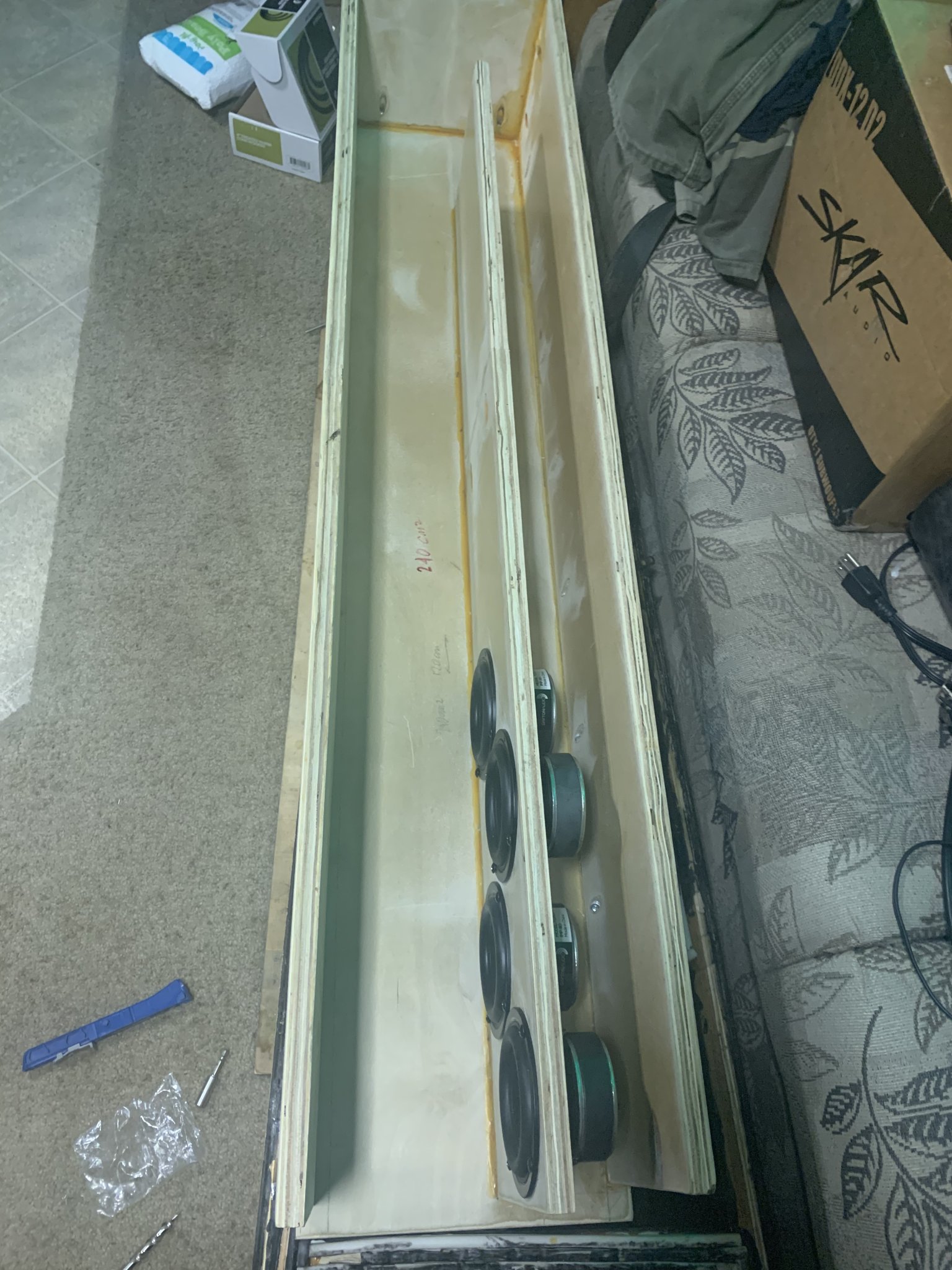

I ‘built’ a diy example/Proof to oneself of BP1s muddy/overwhelming bottom end type of sound experience and it ‘can’ be a bit bloated if you’re sitting against the wall or absolutely if you’re in the car.
at the same time, this helps in reinforce infrasonic tones( IMHO ), and is amazing down that low where things are felt more than ‘heard’ ? So there’s that application sometimes.
left is the ‘tapped pipe’ and right is the ‘ paraflex’ folded appropriately at ’identical ‘ 3:1’ segments. Apples to apples as this is the same drivers and box volume. things then are obvious here and starts to show what everyone needs to know/experience in all if this IMHO to make real discussions on higher order ’qw pipes’

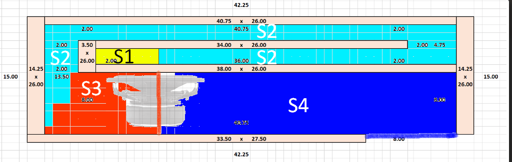

They are ‘skinny’ because of the small ‘VAS and Qes‘ requirement. It’s an illusion that scales away with ‘larger‘ drivers and their TS parameters affectively.
80 cm x 3 is 240 cm(36 hz) and 80 cm x1 (proper TL spacing in parallel ‘exactly’) is 108 hz. They aren’t ‘long and skinny’ in reality. But they appear that way with small 100cm2 and 200cm2 required by the drivers (Sd is 50cm2) in this scenario.
the other is 240 cm total (120cm twice)
32 or 48” respectively. the wavelengths dont change, these aren’t actually ‘long and skinny’ once you use the drivers your referring to ? (400-500 and 800-1000cm2 stepped for the ddx12 paired, for example)
