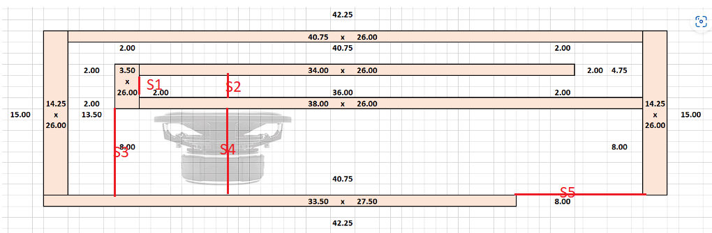

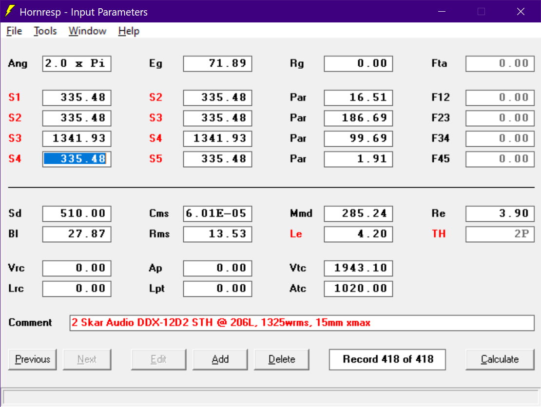

and S5 ??
S5 is the cross-sectional area at mouth of segment 4. That is, at the tapped horn mouth.
Don't confuse S1 to S5 (cross-sectional areas) with H1 to H4 (the four coloured horn segments).
Ohhhh!! ok so on the Sim i made s5 smaller, than means i need to make the mouth of the cabinet smaller
correct ?
and this needs to be
Par not Con... correct ?
correct ?
correct ?
Yes.
and this needs to be Par not Con... correct ?
Strictly speaking, yes for segment 4, although in practice it is unlikely to make much of a difference, given the dimensions.

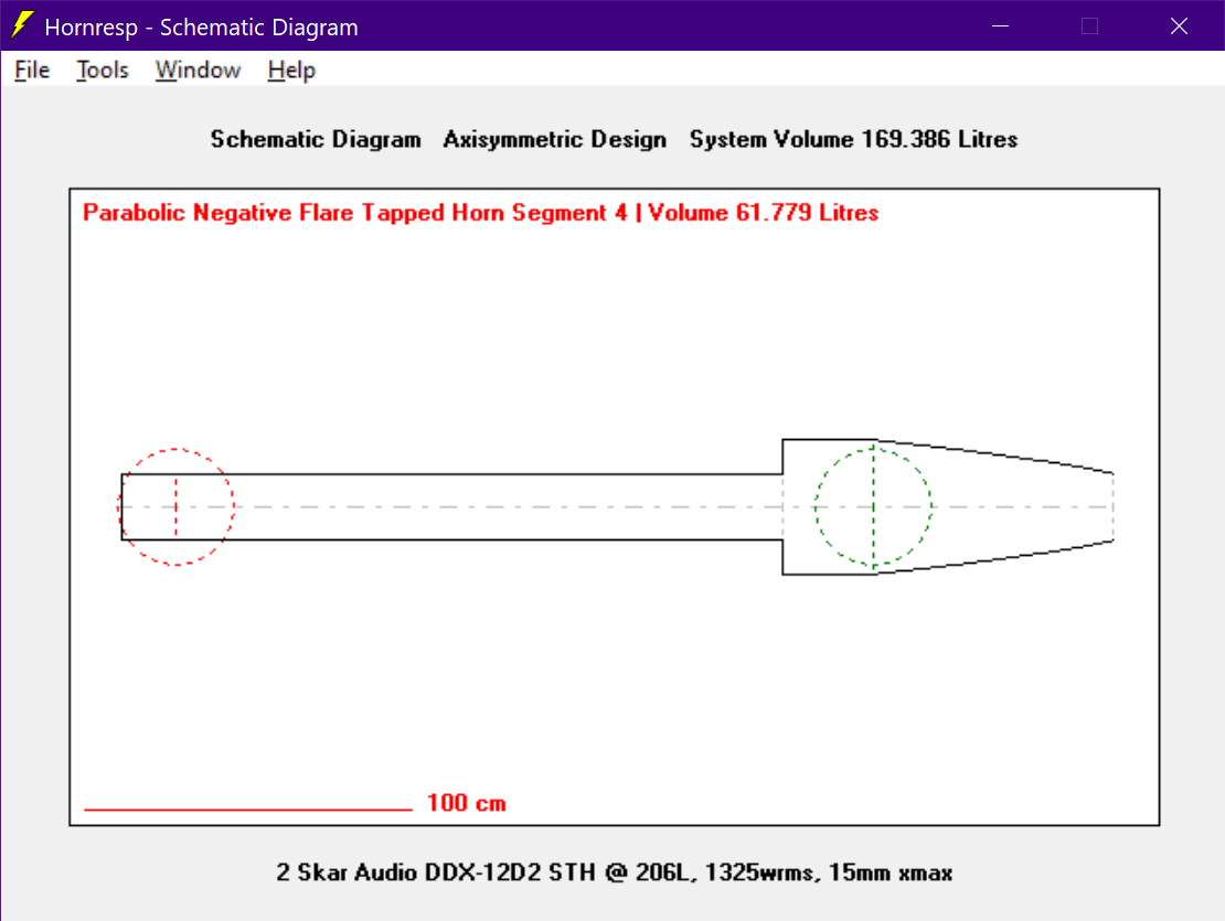

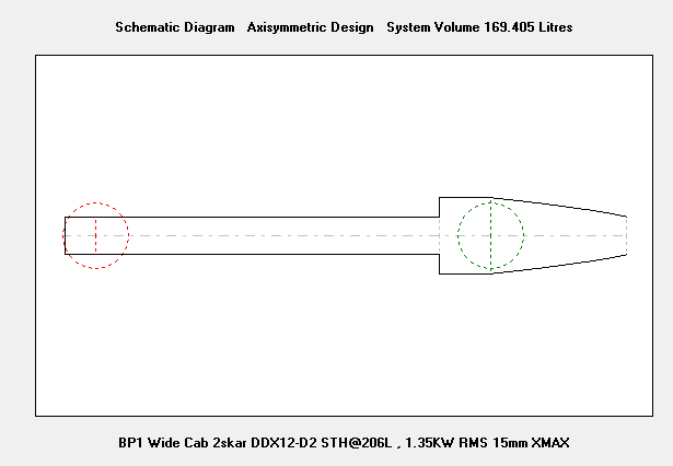

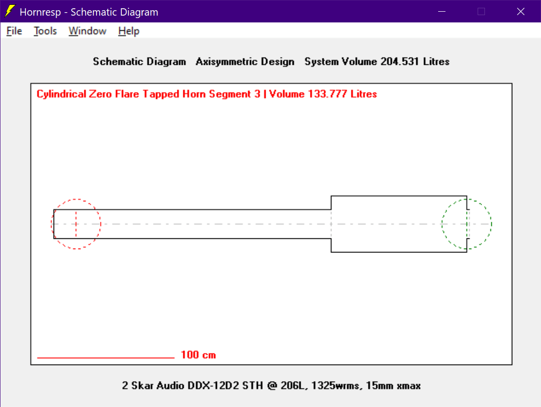

I don't think it's possible to model that layout in Hornresp. This is what I came up with, when I looked at the segments....
Note the position of S3 and S4. Taking the layout of the box into consideration, S3=S4 and S5=S4 must be true, otherwise the Hornresp model will not correctly model what's happening between S4 and S5 (as your model shows). In other words, the cross-sectional area of the mouth must match the cross-sectional area at the driver's position.
Note also that this is basically my BOXPLAN-BP6S2 layout, with the mouth (S5) moved to the side.
That's why I use my BOXPLAN workbooks, to make sure that the corresponding sim is representing something that can actually be built...
I think you can get reasonably close though, which is why I decided not to complicate things by raising the issue 🙂.

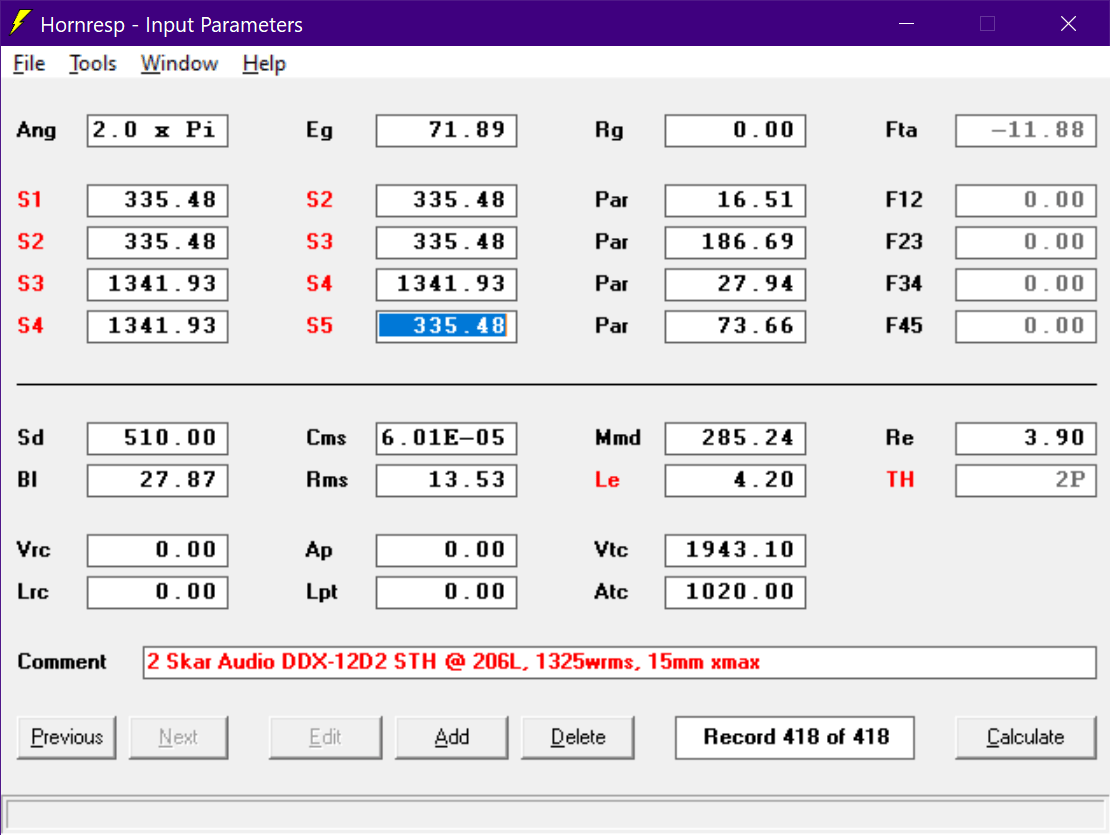

If segment 4 has a constant cross-sectional area of 1341.93 cm^2 and a length 73.66 cm, with a step constriction at the mouth reducing the area to 360 cm^2, then the overall performance of the system at low frequencies should not be dramatically different to that obtained assuming a final parabolic segment of throat area 1341.93 cm^2, mouth area 360 cm^2 and length 73.66 cm.

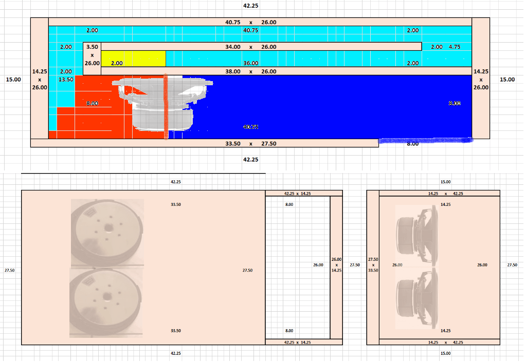

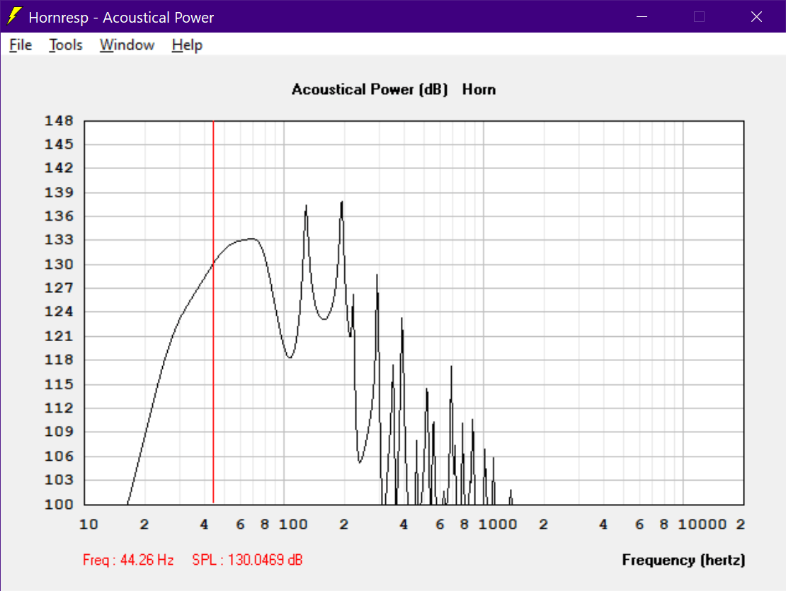

So I can make that mouth S5 of 360cm2 , I gain some more low extension and a little less around 60-80hz (-3db) that i can live with 🙂 , with 4 cabinets i can hit 140 still

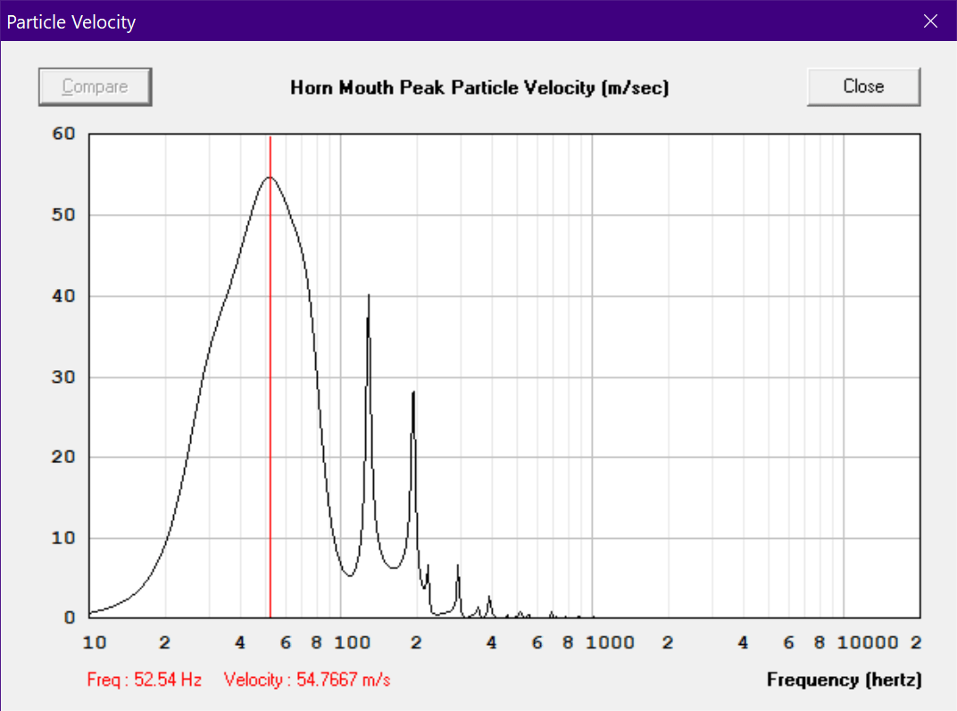

No, not necessarily, Look at port velocity in post 186🙈?

My box has parallel panels at H4 segment (dark blue) and this fact results in a constant cross section area requiring S4 to be equal to S5. How could I change only S5? Don't fool yourself.
Max, altering S5 forms a negative taper at L45. This is where HR needs a 5th segment.

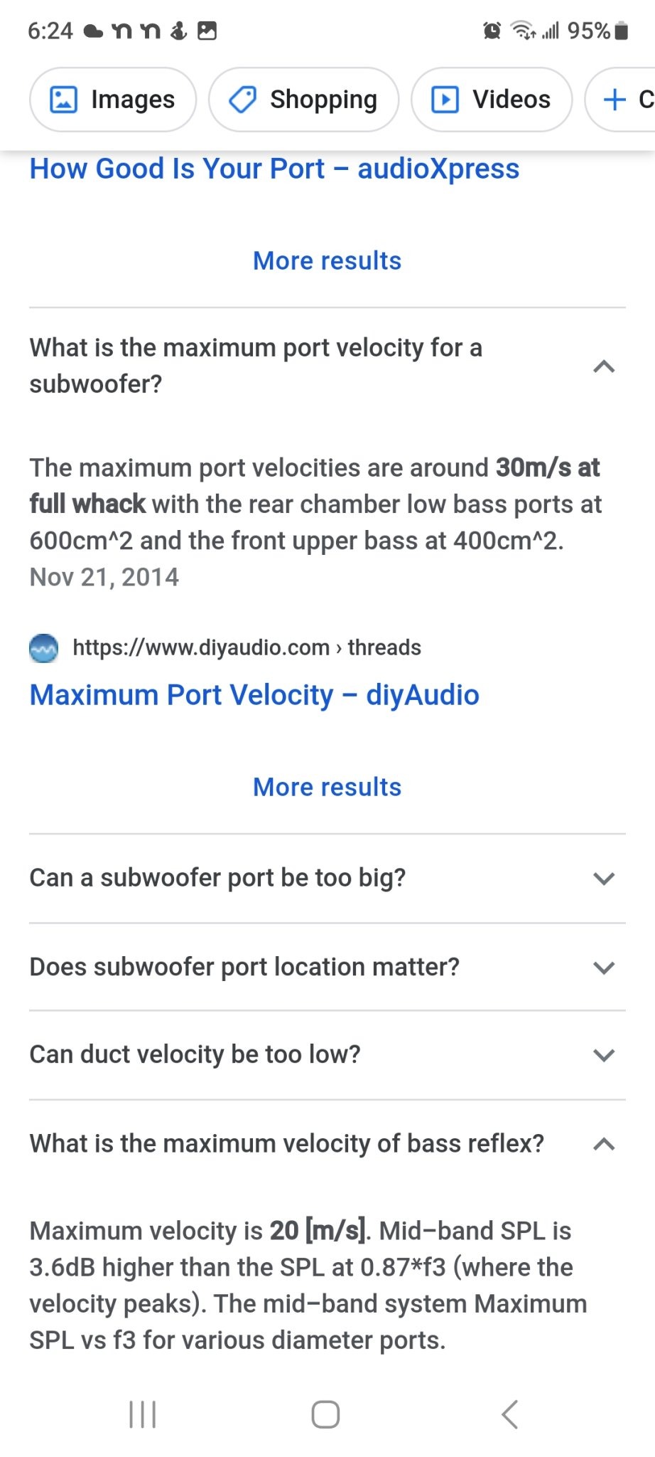

WinISD trained me on being under 15m/s. Usually, no smaller than 1/3 of Sd does the trick.
