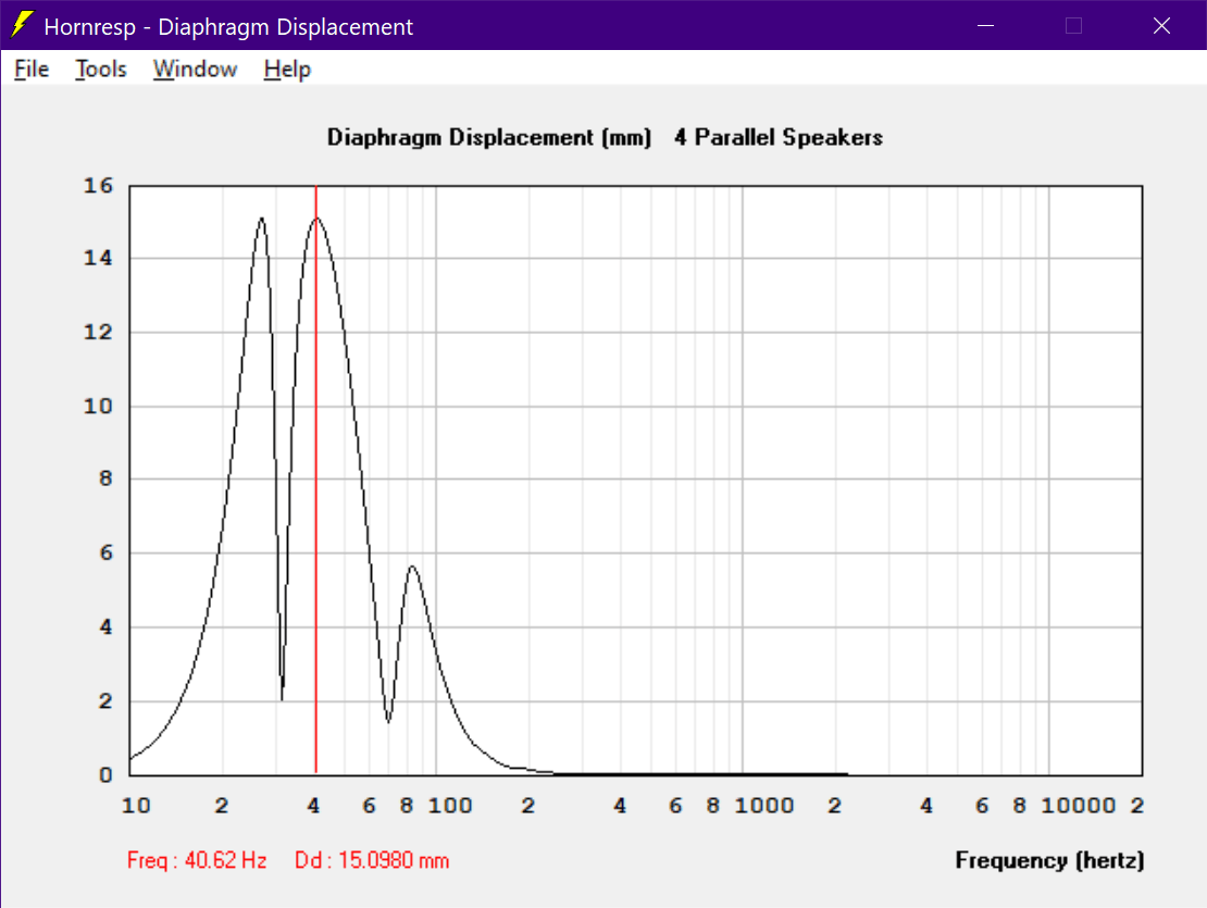

How are you running out of xmax with such a low wattage?Guys you rock!!!

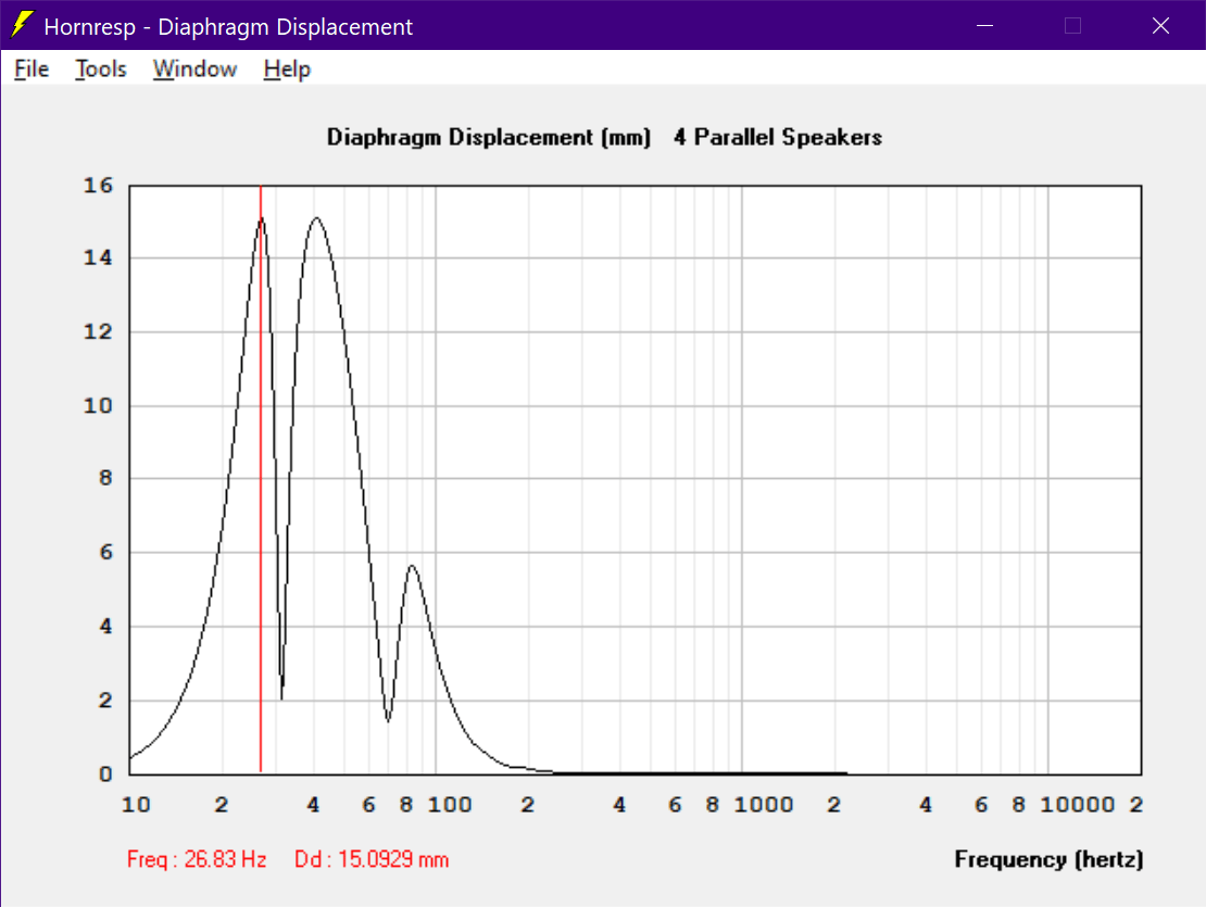

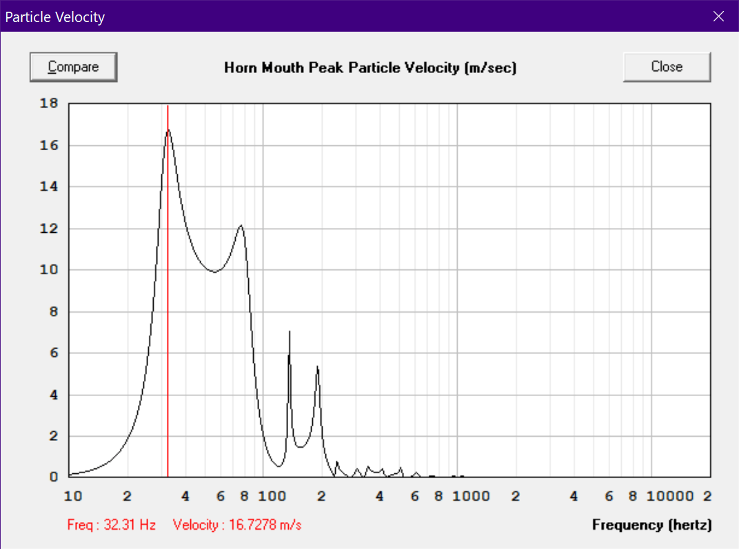

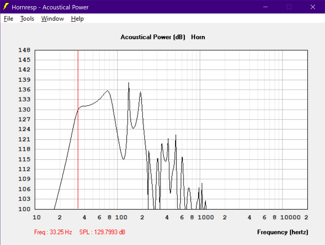

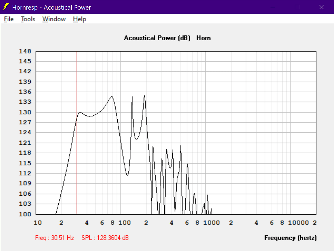

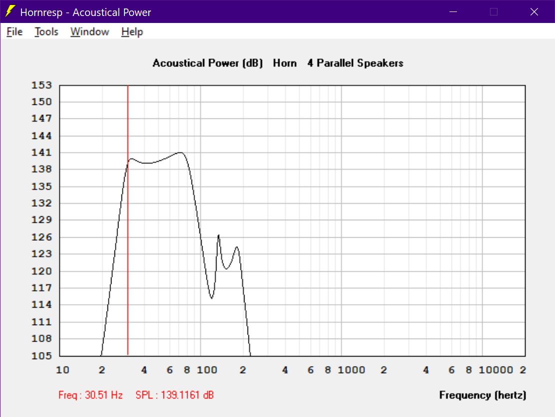

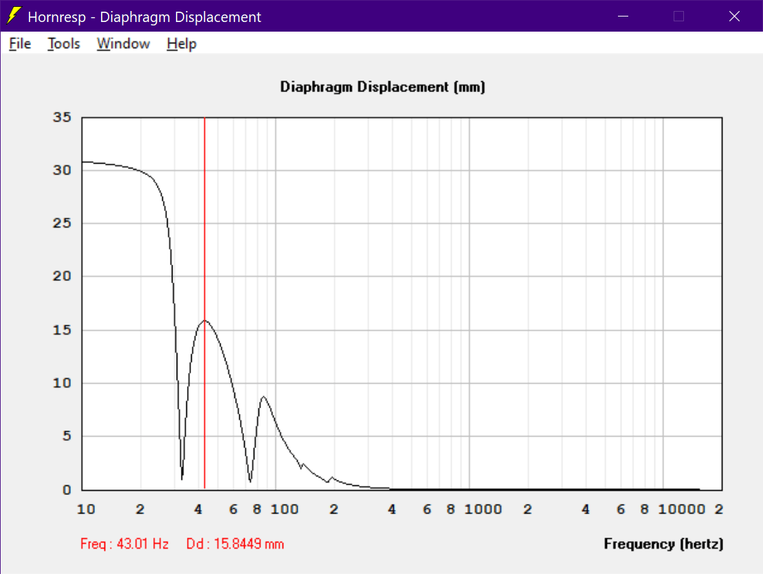

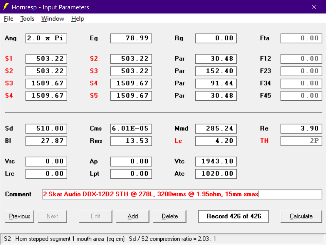

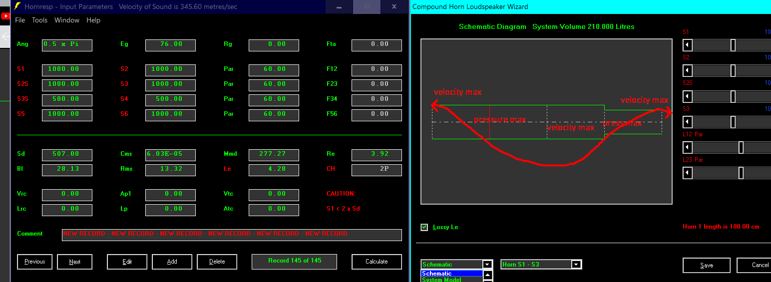

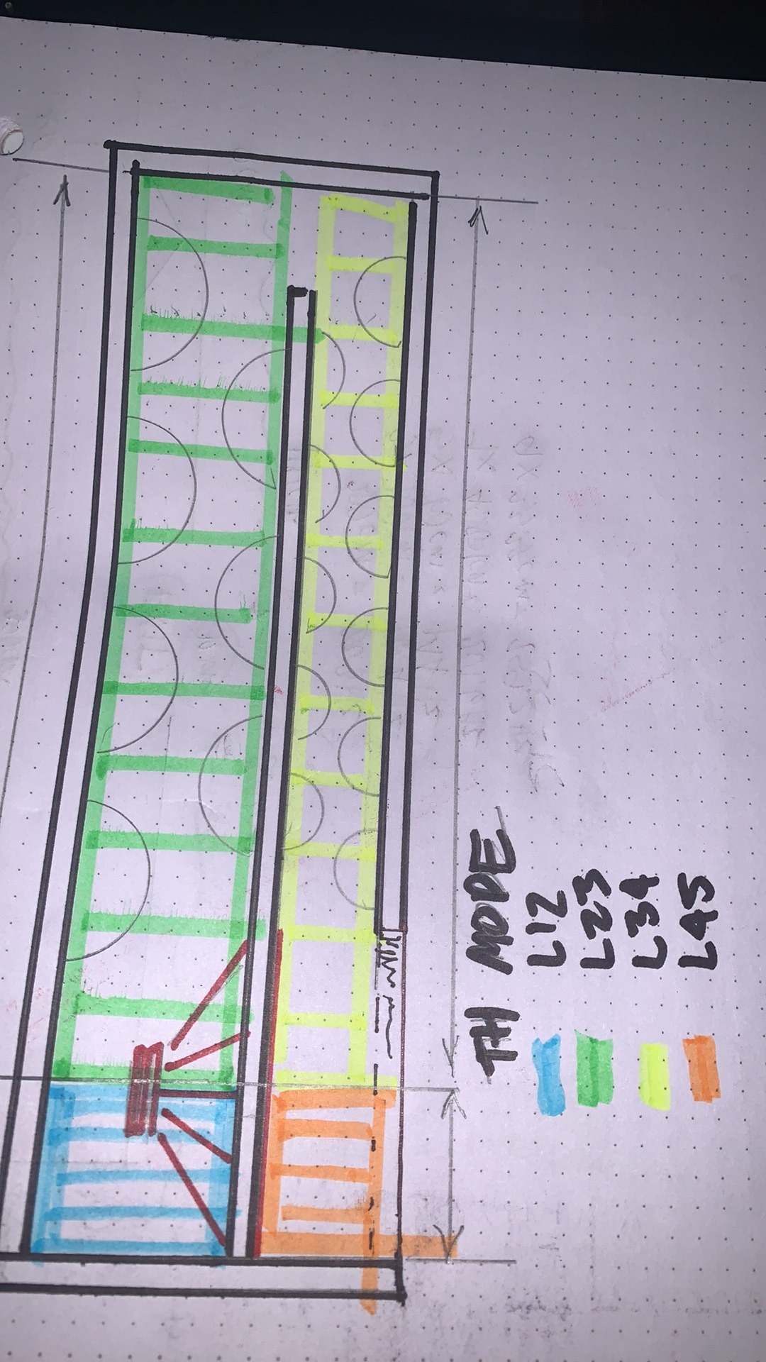

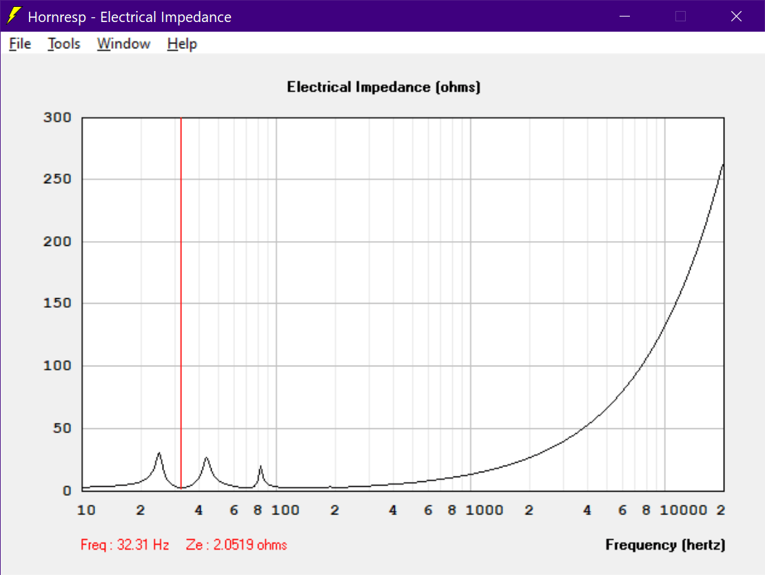

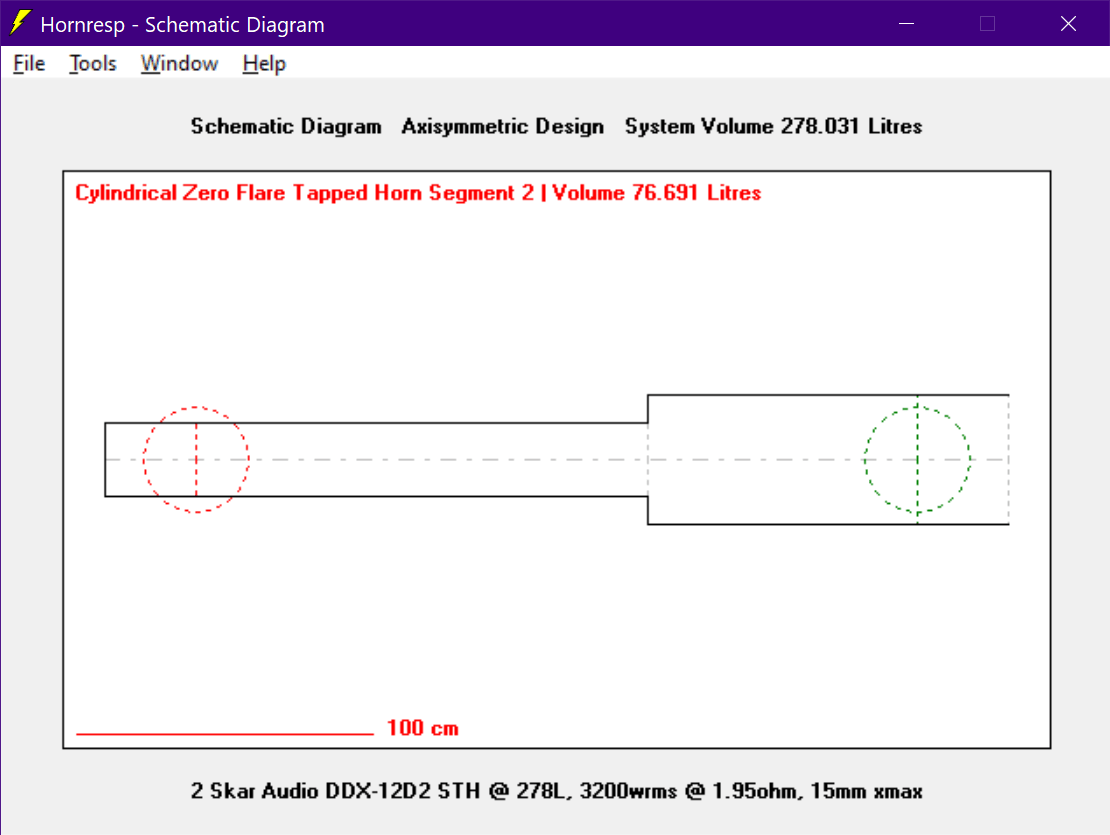

Boss was off today so ... I was simming for 4 hours... Almost all of Lord Sansui plans with freeCad...and HR....and always crash with a wall of xmax.... at 700...600..800 watts...
So I guess your fruits of your labor will be!!

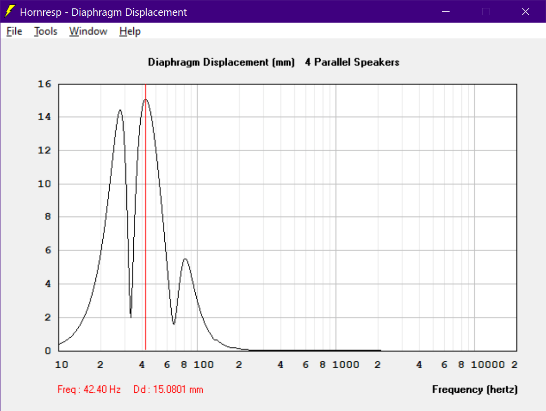

Cause I made the horn path longer to hit 30hz flat and excursion gone to the roof, so I hit xmax wall around 700;- 800 watts

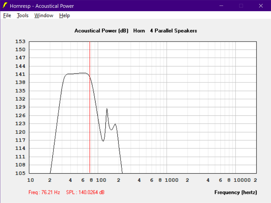

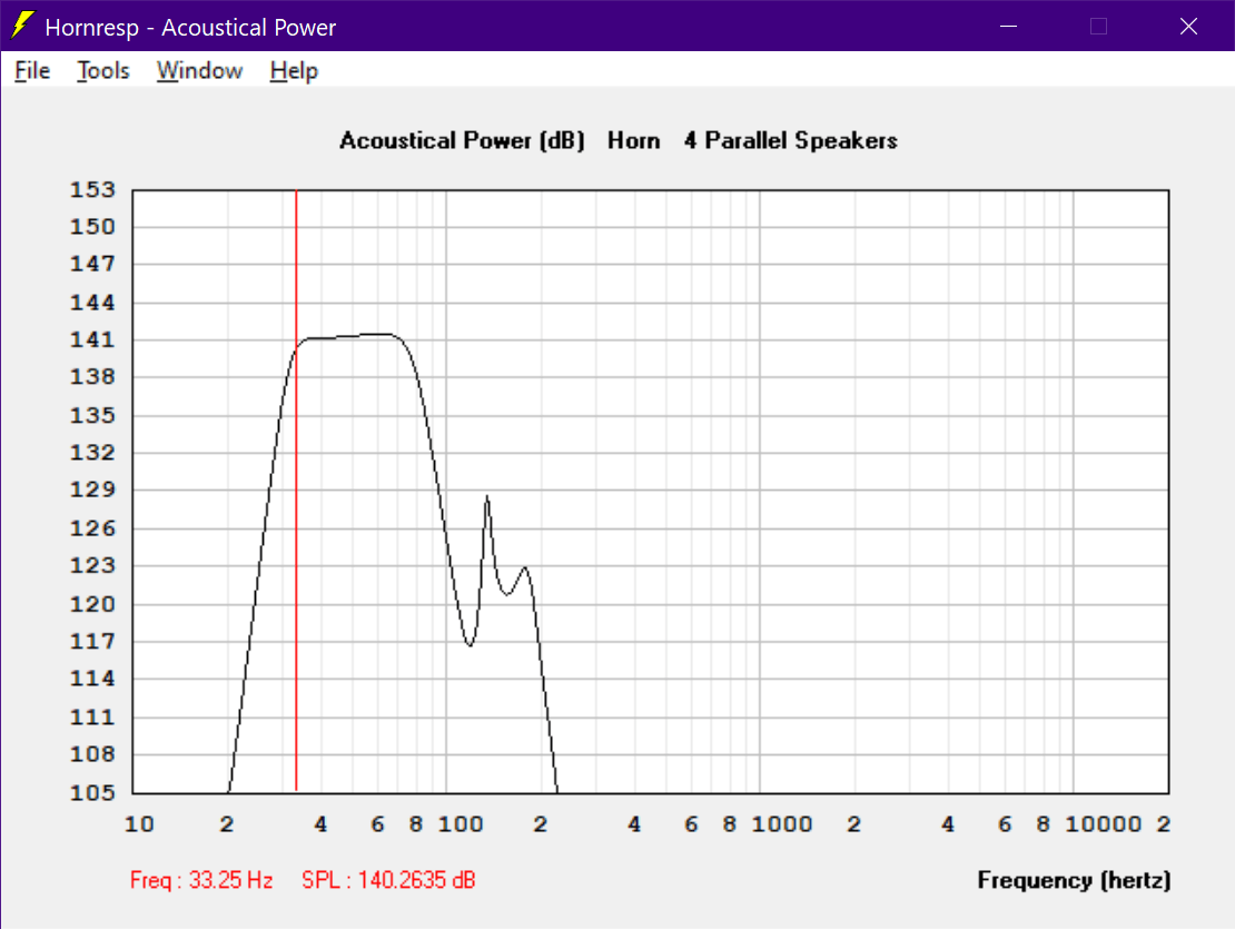

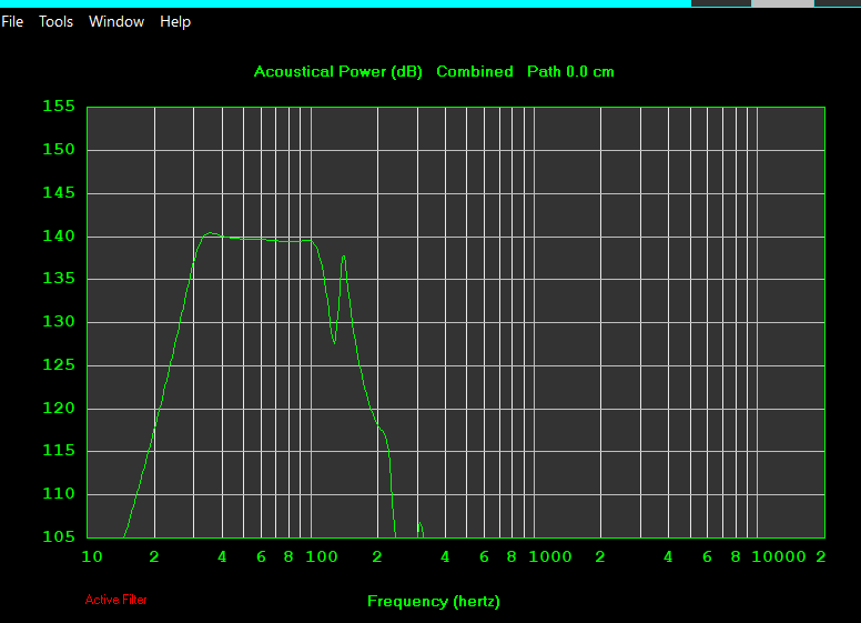

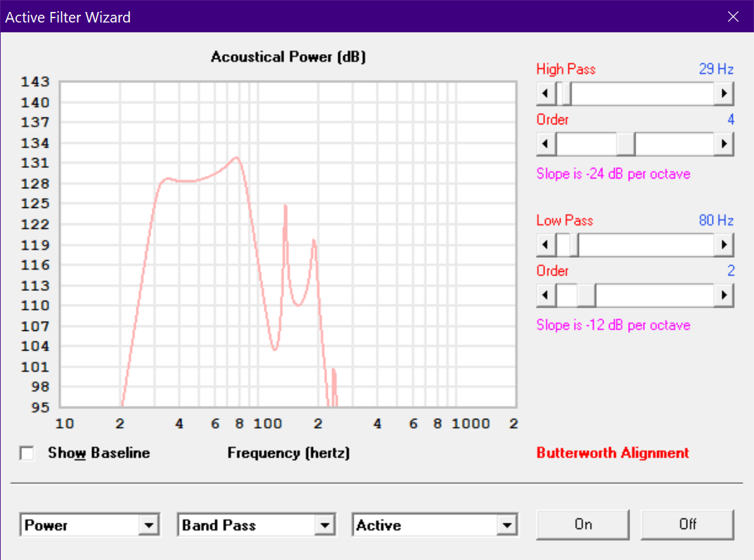

Alright Max, how important is 140dB @ 30hz?
What about flat from 33hz to 76hz @ 140+dB?

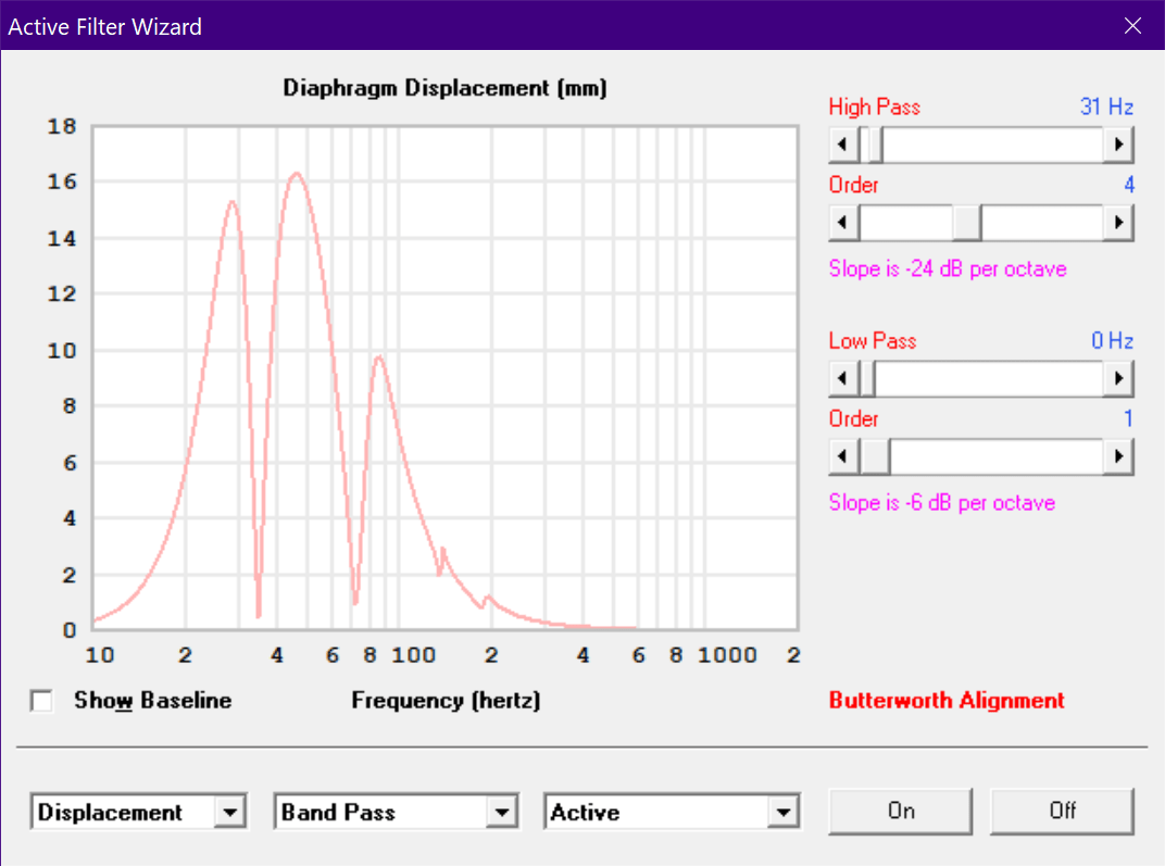

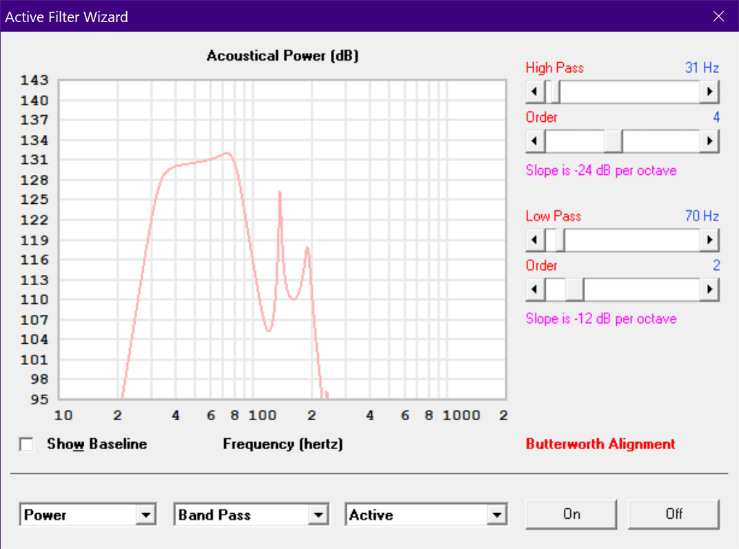

I couldnt milk it anymore in generic quick/dirties in the new Ch3 mode(another cool spin on PH1 without the parallel to series L45 exit by David!) or plain CH here as a folded wave cannon . Screen capture is in 0.5xpi, sorry in advance
Hell yes!! I can live with 33-76hz as long what booger said don't happen ... Smoked coils.Alright Max, how important is 140dB @ 30hz?

How are you going to fold that model into an enclosure?I couldnt milk it anymore in generic quick/dirties in the new Ch3 mode(another cool spin on PH1 without the parallel to series L45 exit by David!) or plain CH here as a folded wave cannon . Screen capture is in 0.5xpi, sorry in advance

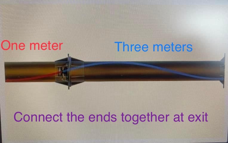

this is 1/4 wave. 1,3,5 . It’s not as difficult as you wanna make it . Especially after you build a dozen to see/hear and then keep following the patterns that already worked best, jyst sizing them for other TS parameters to suite
Shrink these pipes doen (csa) to nicer damped resonators for the TS parameters and you have something . Build a better paraflex, anyone can

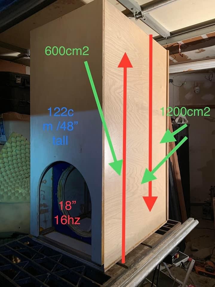

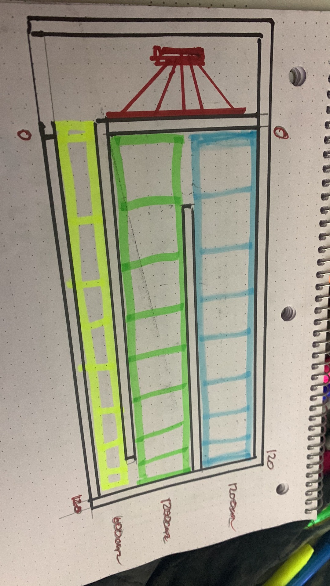

Simple . 30cm , 150 cm , 150 cm, 30cm
If you wanna type 33.02 ? go ahead. It doesnt matter ? 30 cm is 288 hz and 33.3333 is 259.2hz. (These are landmarks in time, compass, degrees (2880/90 or 25920/90?)
but 360 cm is 24 hz. And 85% less if you reduce the crossection by 50% in the second half. Or flip it the other way and invert the change ? Louder but not as low .

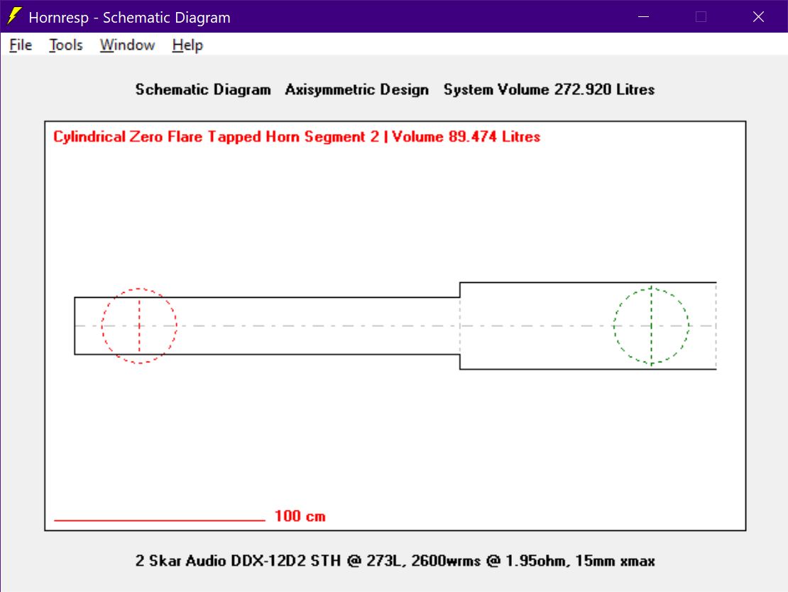

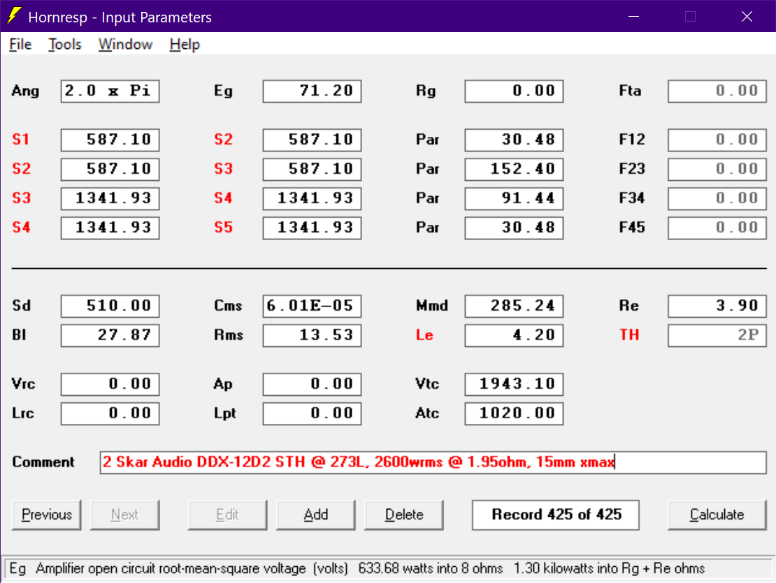

If 2 x 12's requires 1,066cm2 in a compound horn (BP6P), then you can't use 1,000cm2 for the model. They won't fit. In THAT model, the red line is the speaker mounting board.You guys nickel and dime things that aren’t even relevant. KISS works everytime and measurement is identical to simulation If it’s just plain and simple … (who cares about 1.548896537888 cm one way or another when resonator lengths is the only thing that must match up or offset driver entry points specific to the next harmonic , etc. (1/3 down in a tL or 3:1 paralle TL..).
Your wrapping up snakes instead of simple minimal folding and describing intimate details (+/- 2.36528843788cm of masterbating 😝) that aren’t measurable in a REAL cabinet as ‘ sound ‘
chasing detaiks that dont even exist in reality to resonance? just dumb it down and it always works
The wide bandwidth shorter rectangle version ? These are ‘simple’ and work great everytime. You might have to angle the baffle to fit the driver …
(these are way smaller with the driver you are using )

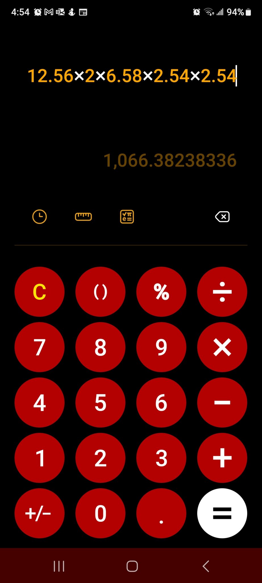

I appreciate the detail, (and it’s needed for the cutlist ). But did you subtract bracing volume and motor/basket displacement and…. (No)If 2 x 12's requires 1,066cm2 in a compound horn (BP6P), then can't use 1,000cm2 for the model. They won't fit. In THAT model, the red line is the speaker mounting board.
and we both know this.
but for ease of useful compare /contrast simulation and quick and dirty response shapes that matter …. 1066 isn’t even real, but use it if you want..it’s no better or worse. It changes Nothing in the response shape .
1,066cm2 is too small too. That is the smallest CSA you can go.
1,066cm2 = 12.56" speaker diameter x 2 x 6.58" mounting depth.
That's why I used 1,342cm2 for easy driver installation, removal, and room for the voicecoil vent to breathe.
1342cm2 = 26" x 8" {7.60" total speaker height}.
I like using whole numbers for easy math.
