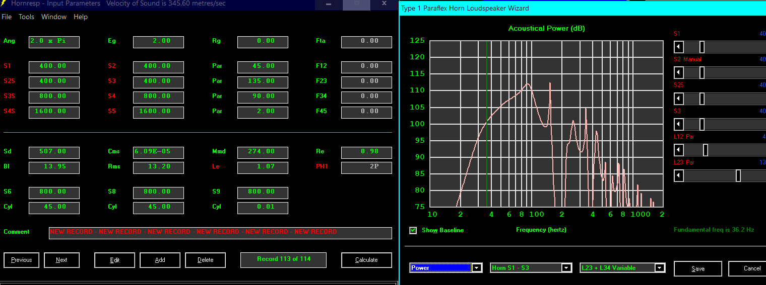

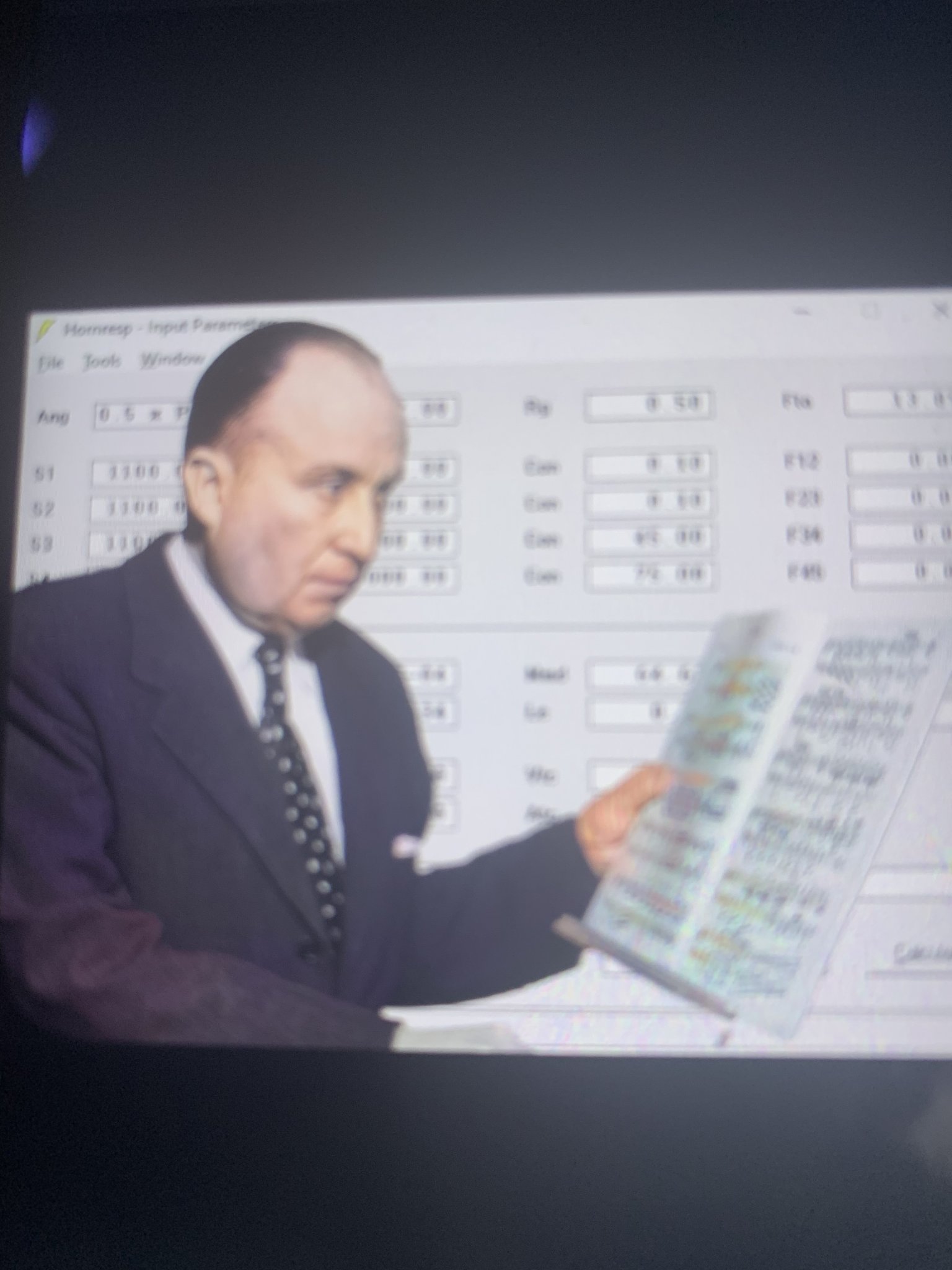

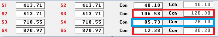

I would be very interested to know the sequence of events that led to the stepped segment screen layout shown in Post #83 (copy attached below). For some reason the S2S, S3S and S4S throat area labels for segments 2 to 4 are missing.
(The stepped segment screen layout shown in Post #89 is also not correct in that the S4S throat area label for segment 4 is missing, however I have found the problem in this case and the bug will be fixed in the next update).

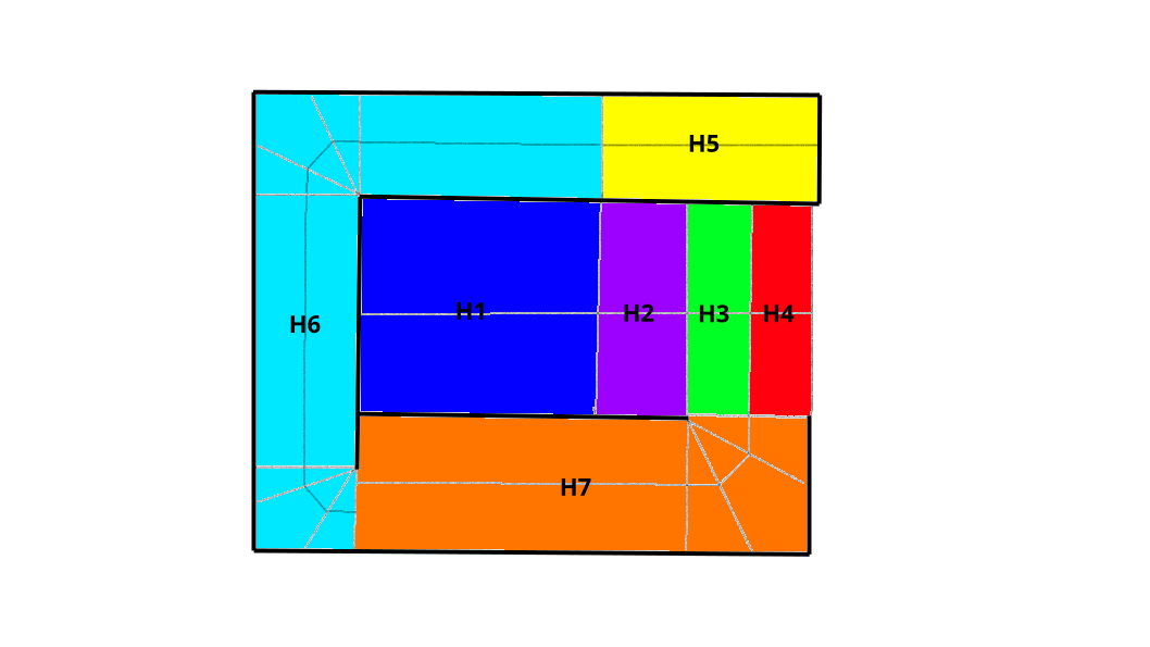

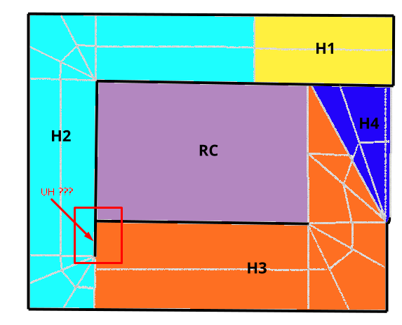

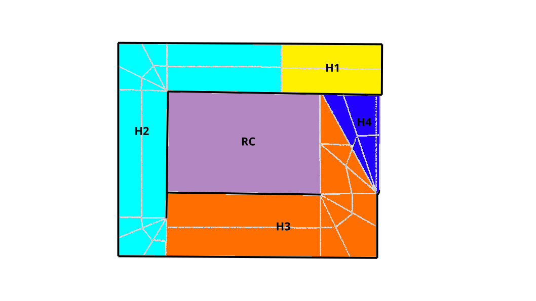

I mean, the paraflex C model he found, MMJ was modeling using TH with open rear chamber, while you and me modeling it as PH1, so, worth maxoline compare the results, maybe one is more accurate then the other.
To make it more visual, see attachments.
The box are exactly the same, but the way you define each segment and the way you arrange them are different, each model will present some small issues like:
For TH: What is the position and the size of S4?
For Paraflex: How to make H7 stepped at S8?

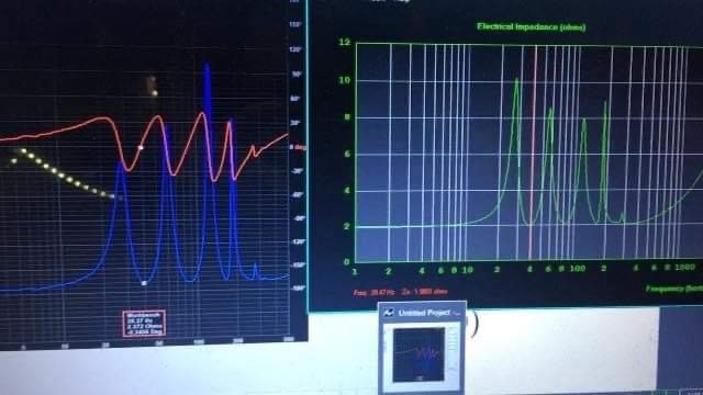

Neither it would seem. The results (as drawn and in many older ‘paraflex models) get tainted with the excessive size (‘Q’) CrossectionAl area of the too short sides resonator in comparison with the ‘fundametal‘ (long) side. Fix that and it ‘works’ much better By filling in the 3/4 harmonic issue ‘perfectly’ . (Qw basics)
the actual distance to exit and from both closed ends is what ends up in the impedance plot. especially with appropriately sized chambers that aren’t allowing akward discontinuities ina system that ‘shares’ its guts and the resonances if it’s smooth and ‘flat’ ish in the REAL response?
redraw/resize that and sim to see this in greater detail/ further understanding
so it’s ‘correct’ with what is measured when it’s done that way? that design isn’t promoting an ideal relationship between resonators in parallel And continues to create confusion and phase issues that don’t have to exist.
That resonator is ‘too big and too short’ to ever match up with the 3/4 harmonic issue created in the long side. They will never ‘match/compliment eachother’ ..

horn response continues to show the discontinuity. It manifests in ways you can estimate by simulating the exit as 0.1 instead of trying to split all that up (as parts of either, or?) hard to say, the real issue is the internal size and lengths that dont ’work’ anyhow(???) and until they do, it’ll never pan out ‘perfectly’.

I think that screen is well over a year old version of ‘horn response‘
Thanks Bw, if that is indeed the case then it's probably the reason why the screen appears as it does. Mystery solved .

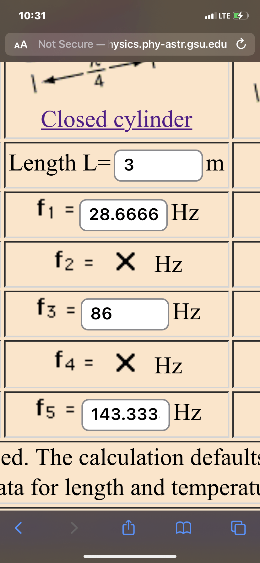

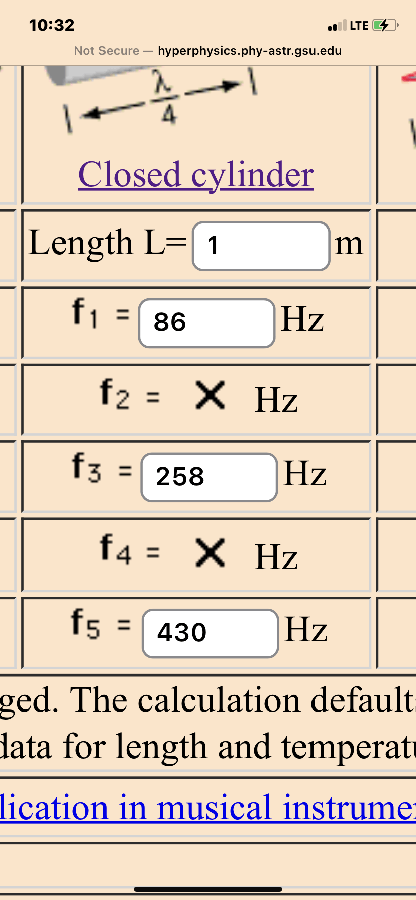

Ok , and that mean?? Cause what's the harmonic at 3/4 and what's the 1/4 fundamental?View attachment 1149313
’perfect’ being no trace of the 3/4 harmonic and cancelation notch from the long sides 1/4 wave lengthfundamental
I mean what freq?
The fb?
So 3m is the golden length of the pipe... Horn?

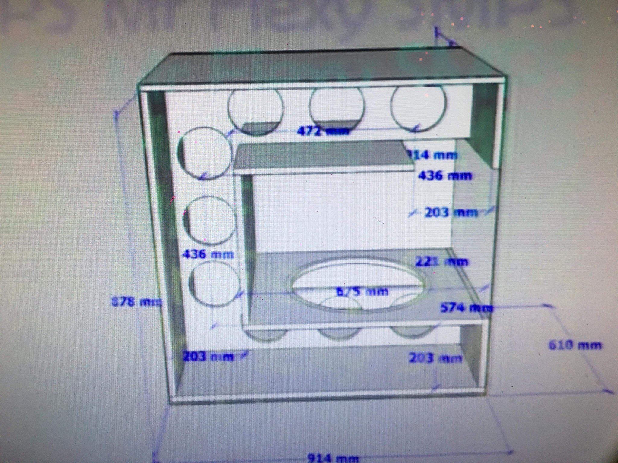

So if I aim for a 3m length that will put me in the sweet spot and the folding is the key so to have a box that do not resemble a tall locker but more like a big fridge ...

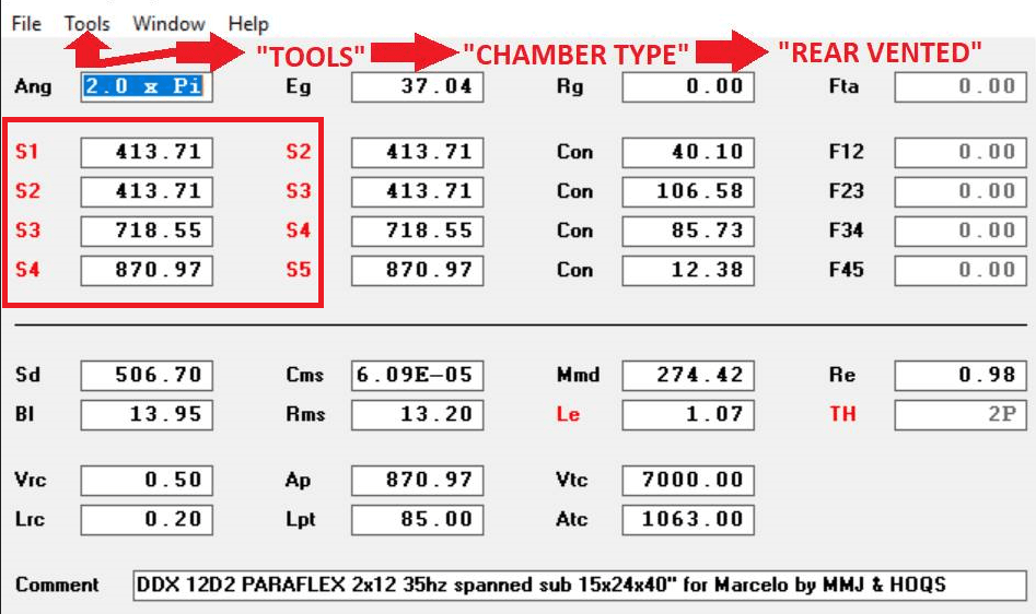

I am struggling to get the areas of the drawing in to horn resp, any tips to calculate S1,S2....S5
Crossectional areas?

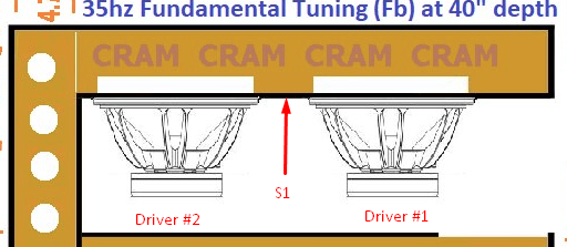

ok so , so more questions....
this is not draw to scale ( the drivers )??
where is S1 and S2 on the plan
cause i do not know when using 2 drivers one in top of the other, HR treats them as one bigger driver ?
so S1 must be in the middle of the 2 , instead of the middle of the driver #1 ?

This panel is increased to create the stepped joint, I mean, the throat of H3 segments is bigger then H2 mouth segment.
Sometimes this different acoustical connection can improve the response.
The opposite of stepped segment is to have the segment mouth = next segment throat a kind of "continuity".
As always suggested, you need to run simulations to see the results and confirm the benefits or not.

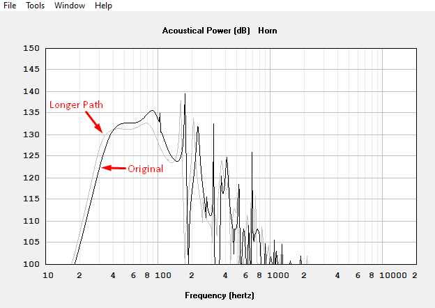

Horn Length increased from 244 to 277 cm
i tweaked the HR from the original CRAM to a bit longer path length to get rid of that spike
i increased the red boxed segments and decreased the blue boxed segments
also gained more lower extension
i dont care above 100 , 90 Hz for a sub

double 12 CRAM box...
just i need to confirm that the below looks good with you guys

s1-s2 and s6-s7 are the driver distance (to center of the pair)from the closed ends of each resonator in ‘ph1‘ mode which is the most accurate.
if you fold a 90 cm resonator up three times(270cm) and attach it to another( 90 cm ) resonator in parallel you have only to center the drivers at 45 cm to find a nice/simple in phase with no discontinuity in the enclosure As seen @ ~ 96 hz in your sim (the 3/4 harmonic of the 1/4 (32hz) hiccup that’s ‘missed’ the mark as shown )
what you have created looks great(close enough to the hypotheticsl ‘perfect’ )
