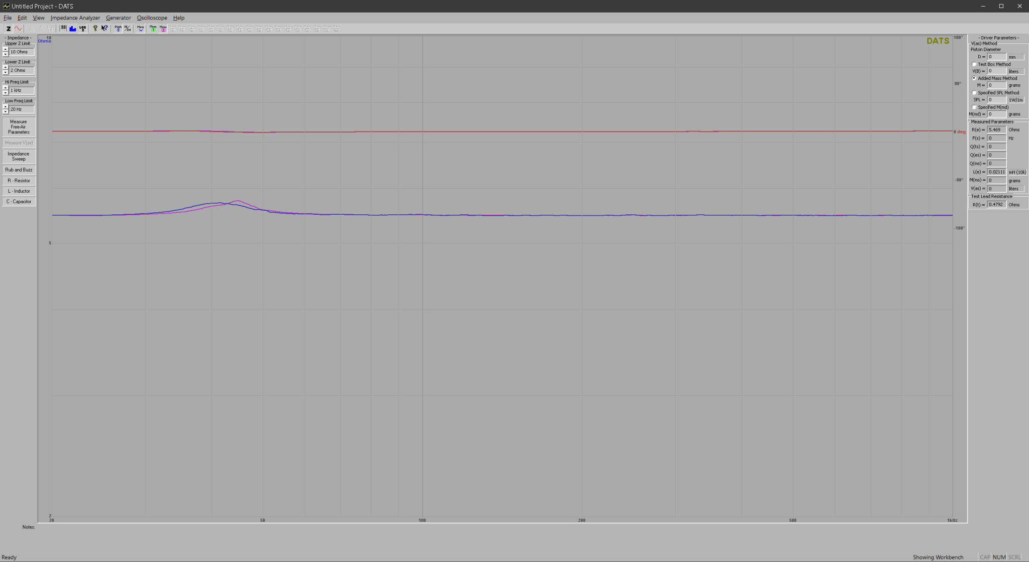

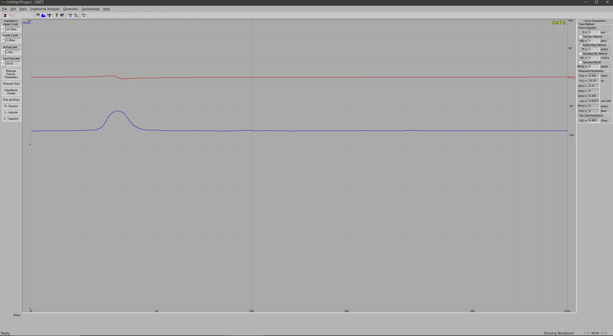

THen i added damping on one side, but lost the measurement....
Dats is a pain in the *** to work with really dumb GUI.
QTS went down to 4.5. then i added the same mesh on the other side of the magnets. and now dats cant make up the QTS 🙁 maybe not enough excursion to make up the differences i guess. it shows the response but wont fill in the numbers on the right.
i really have no clue why they could not include a bit more power in this DATS v3 , all in one thing. would not hurt to add like 2 watts , seem to be just line volume/headphone.
the reason it might have a hard time is because it has 2 main resonances one for each foil. so when the Q gets lower... the bump is rather wide and it cant make up his mind what the FS is for instance. since its much wider as with a normal speaker i believe.
let me tune one foil higher see what it does
So when tuned higher, the peak becomes more clear and the data is back again...
when i tune it ever so slightly lower again , it lost its way again 🙂 and cant figure out what the resonance is
this might as well be the reason why Qes is not showing up

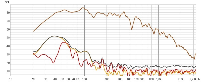

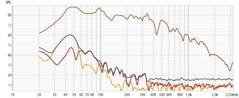

Here a distortion measurement of the panel with the dual MESH as seen in the last DATS measurement without any eq.

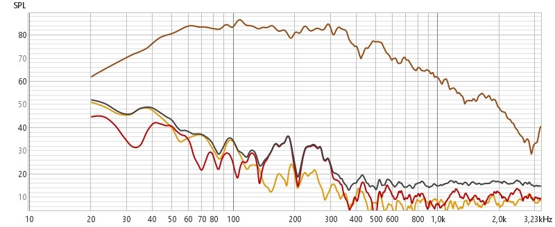

and second pic is the first panel i measured with DATS with EQ to supress the resonance hump instead of using mesh.
It can be seen the mesh or damping on the inside screws up the distortion. in the mesh panel 3th harmonics shoot up from 100 hz and down. the smaller panel nr 2 without mesh and with eq has far lower distortion down low.

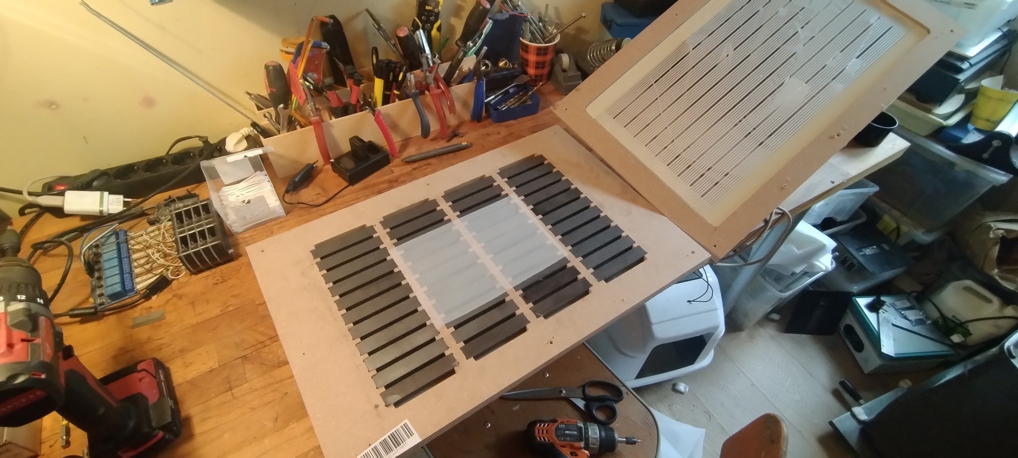

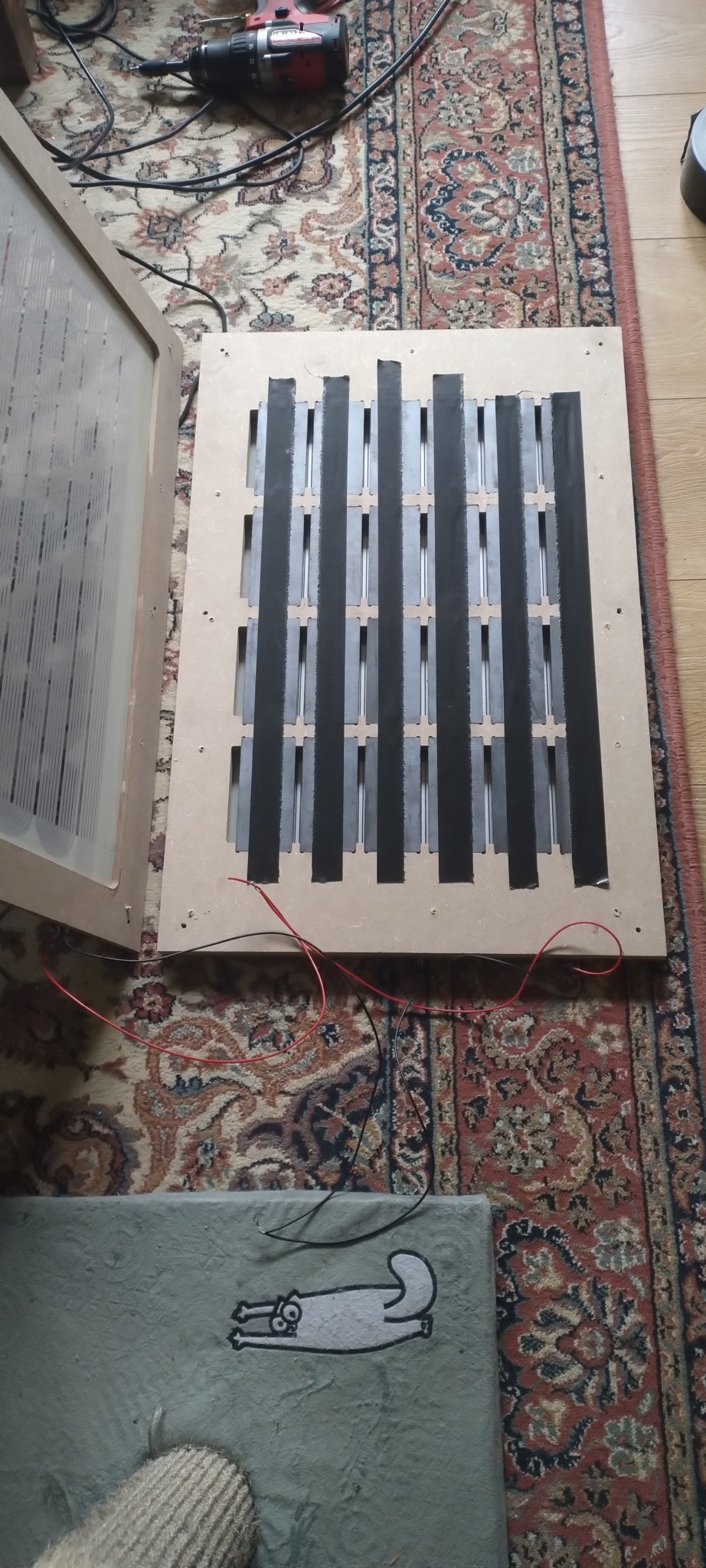

hmm maybe i need to cover the whole magnet structure with mesh. but i am afraid damping might be to big with the mesh i got 🙁 maybe alter the plate that holds the magnets to create a more gentle damping over its entire surface. by reducing the open area between the magnets.
By using holes for instance and play with thos... like taping some off to see what would be enough damping. i mean it would be cool to implement the required damping in the frame itself. ill try taping a few of the slots see what it does, first remove the mesh again...

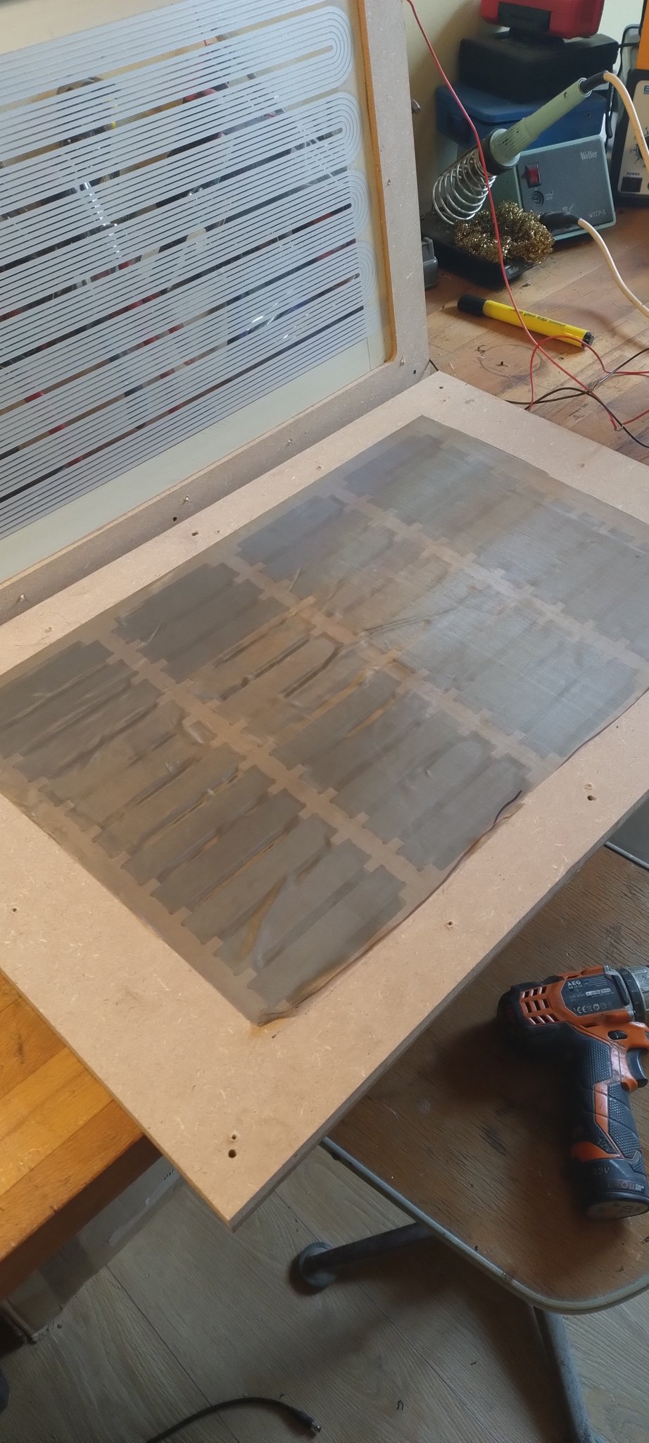

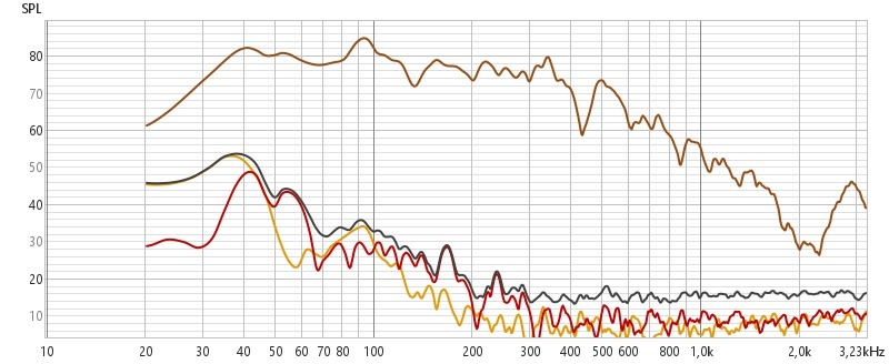

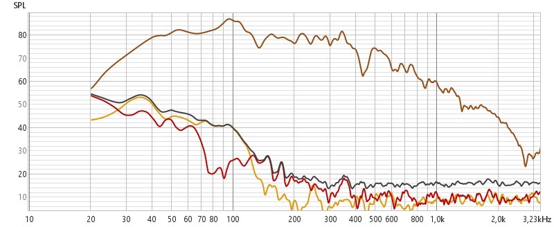

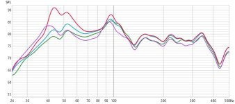

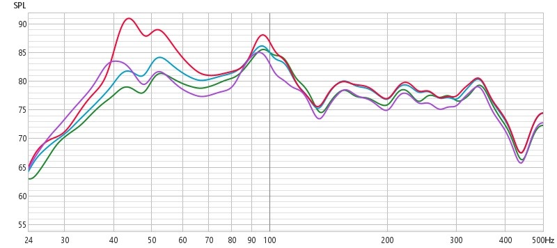

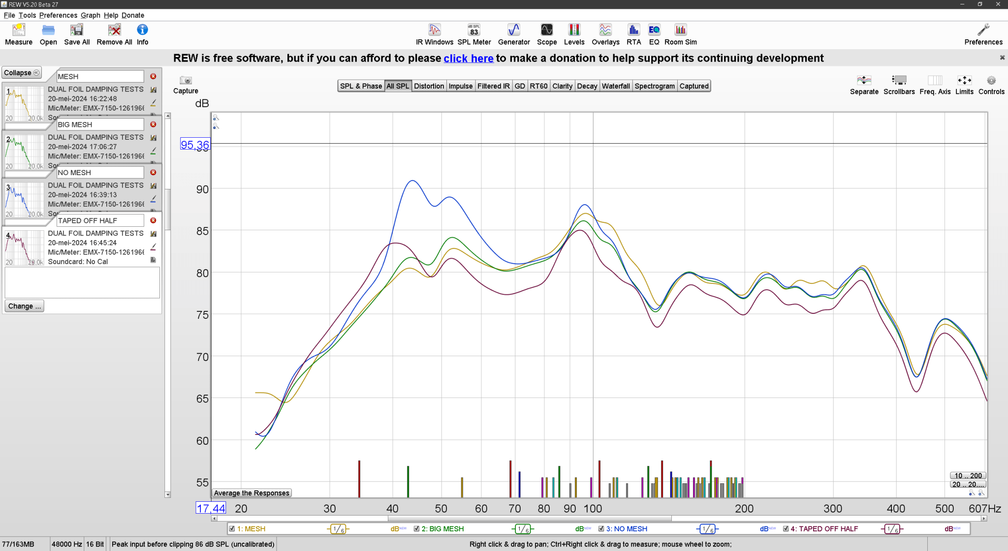

SO here are different damping methods distortion
1 No damping
2 Mesh Fine only in the middle
3 Bigger mesh (conductive fabric) entire surface
4 Taped of half the slots between magnets.. this does create scuffing 🙁 (might be the tapes flapping or to little surface area to move the air between the foils) it also loses on output. so taping of half might be to much, and also to local.
And the frequency response of all 4.
all measured on a stand so the 94hz might be floor relfection ? or walls ? no idea
Pics of the damping
1 No damping
Pics of the damping
