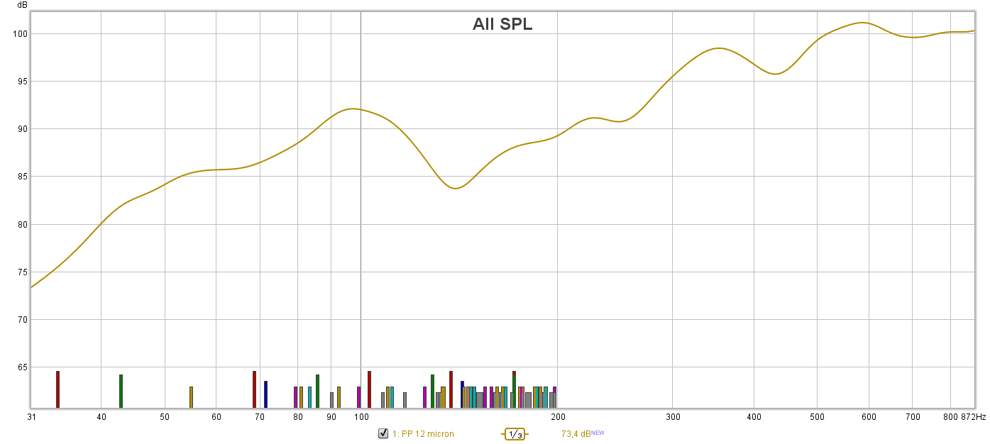

Here is the Push Pulll foil as comparison to all the other measurements at 1 meter spl this time is calibrated. not sure what voltage. dont care either 🙂
Push pull FR

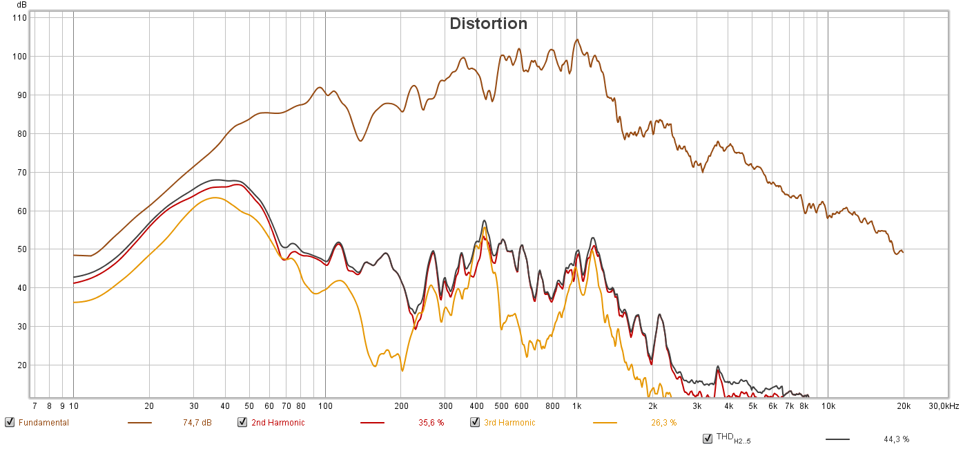

Push pull distortion, there is some nasty poo@400 that im pretty sure is created by the small amount of traces VS undriven foil.

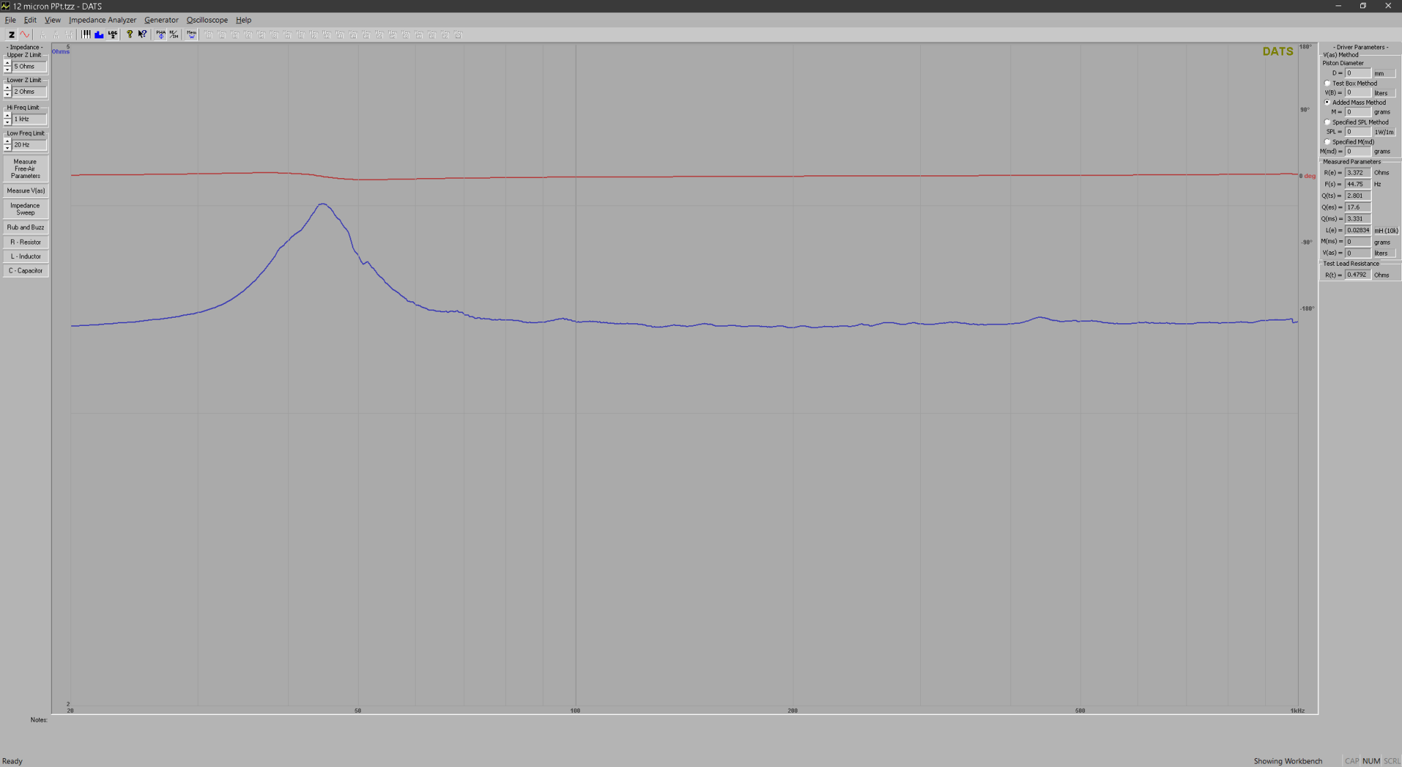

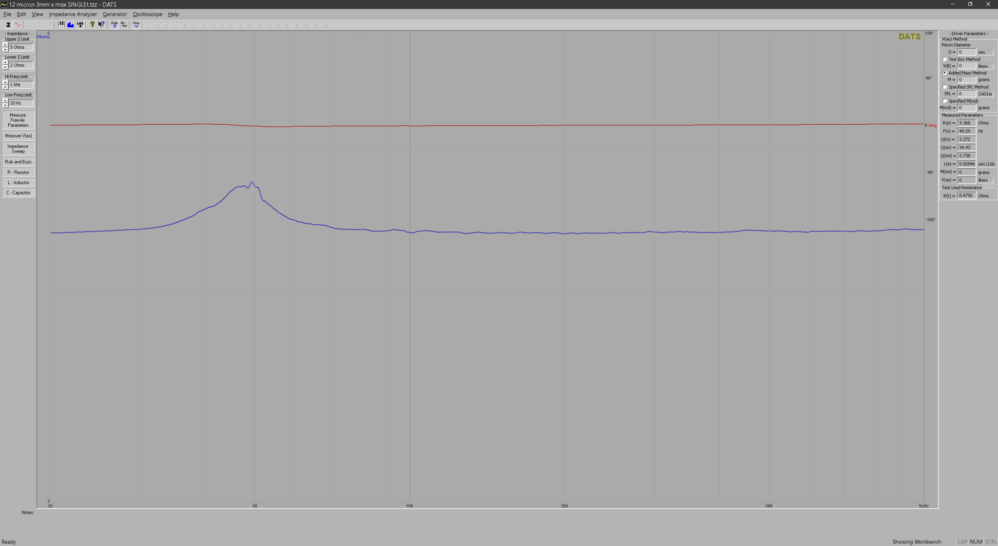

And the free air parameters of the PP

Distortion of single ended 6mm xmax playing as loud as the Push pull to see what distortion does (same lever else its not fair), the crap around 400 becomes more of a problem
hard to see but 2e order in the bass region is almost twice as high, while 3th order remains the same or is even slightly lower, so total THD only becomes 1% higher give or take.
And the free air parameters of the 6mm xmax single ended, you can see Qes is gone again 🙂 probably to high

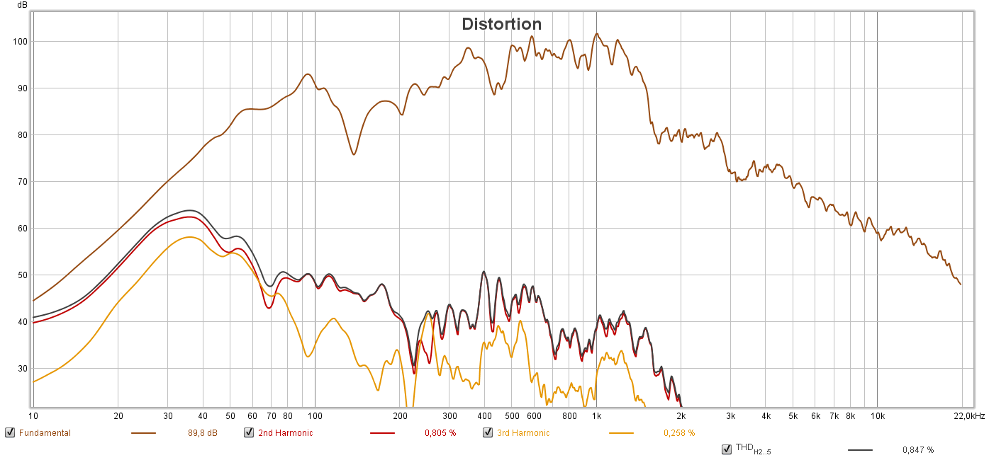

And distortion of the 3mm single ended at the same volume as the PP. now whats interesting is again 3th harmonics are the same as the PP and sometimes slightly lower sometimes slightly higher. 2e order is higher when you go up in frequency100-300hz but below that it comes close to the push pull, and is much better then the 6mm xmax.
And the free air parameters for the 3mm single ended. Qes is back again, but of course much higher then in the Push pull variant. like twice as high, but at least it has a figure unlike the 6mm xmax.

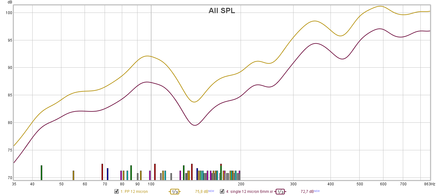

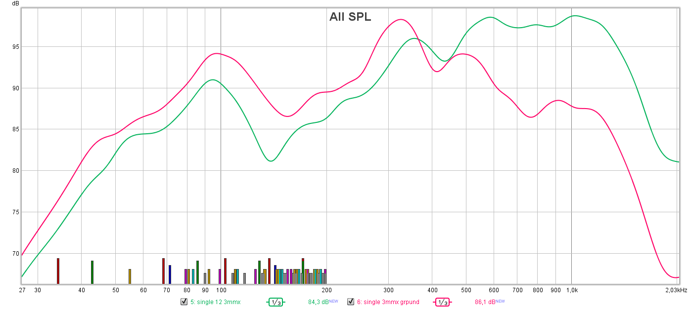

As extra i wanted to know how much gain i would get if you put this panel on the ground, instead of sitting on my speaker stand. The gain is around 3 dB down low, under 250hz
Now, a few things are interesting. push pull gives some extra output +-3 in the lower frequencies of interest (under 100 hz). and 6 in the region im not interested in.
When using half the xmax , 3mm xmax its more like 1.5dB , if you would make the panel twice as big, @3mm xmax. so you have the same amount of air been moved. distortion will be lower then the push pull with big xmax. for my projects that still would be the way to go, since i also gain more db's because of the larger baffle. and is just cheaper and less work, and will perform better then a small PP high xmax driver. not a real surprise ! but nice to be confirmed. even if the specs in DATS look worse. like Qes
Push pull FR

by the way its insane to see how much you lose in the open baffle design... almost 100dB at700Hz and only 86dB at 70 hz for the push pull.
big baffle would have quite some potential, in efficiency but also lowering distortion, without spending more on magnets. (also the reason why single ended half the xmax , but twice the size is a very interesting cost wise)
