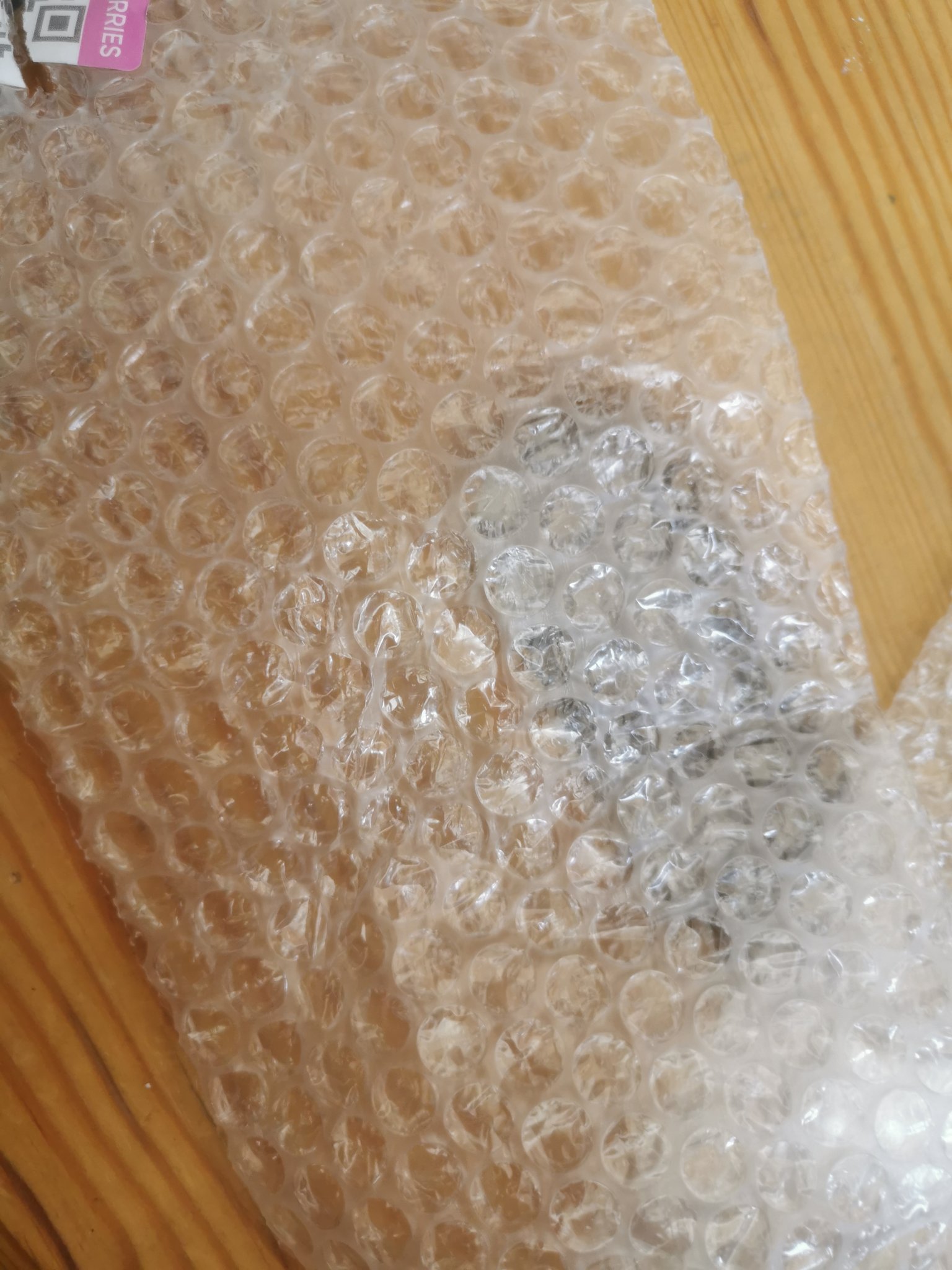

In your case, you can make another driver exactly like this with 2 membranes and... connect them together through a small spacer, and lay damping material between them, it works 100%. This is packaging material in two layers:

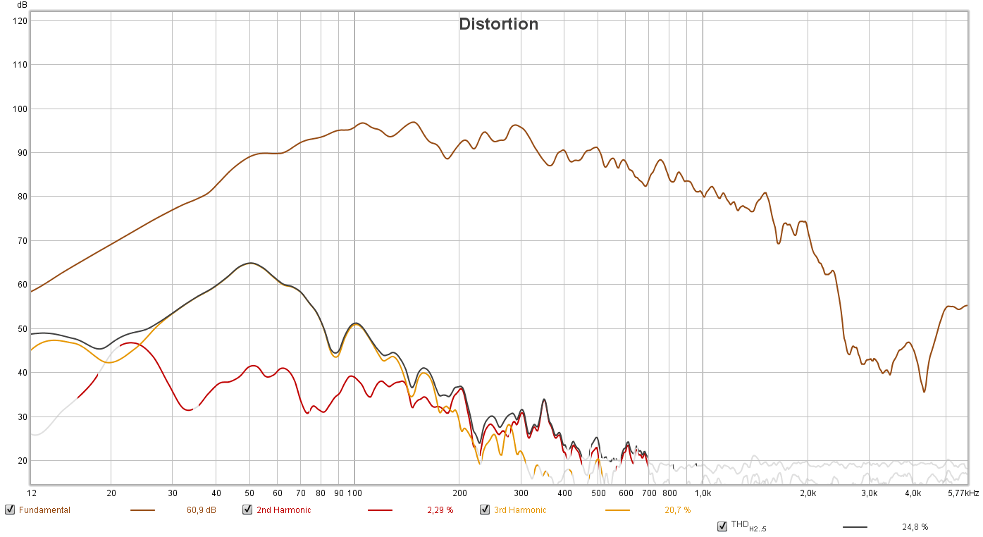

I added one super thin piece of Vliseline non woven stuff on the magnets. here a measurement before and after.

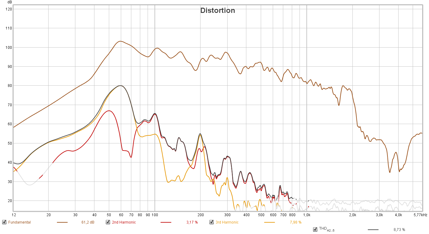

Here dual panel without any damping
And here with one vliseline layer (thinest variant) on top of the magnets. you can see it actually might damp a bit to much.... so i guess i need to find the ideal Q ? maybe ill shop for some of those nylon meshes see how that fairs. one thing to note its an open baffle of course, so it might work fine if i had a baffle to begin with... its now just standing on the floor next to a LRS. i am verry curious how it will perform if i make the panels wider with a lower resonance and more tension on the foil. so it can use the max xmax, then... how it would sound if they where a usefull size, i thought about using 81-90 magnets in a bigger version instead of the 28 used now. should be pretty hefty. i saved some money on metal 😉 so i can add some more magnets 😉

And here with one vliseline layer (thinest variant) on top of the magnets. you can see it actually might damp a bit to much.... so i guess i need to find the ideal Q ? maybe ill shop for some of those nylon meshes see how that fairs. one thing to note its an open baffle of course, so it might work fine if i had a baffle to begin with... its now just standing on the floor next to a LRS. i am verry curious how it will perform if i make the panels wider with a lower resonance and more tension on the foil. so it can use the max xmax, then... how it would sound if they where a usefull size, i thought about using 81-90 magnets in a bigger version instead of the 28 used now. should be pretty hefty. i saved some money on metal 😉 so i can add some more magnets 😉View attachment 1299247

the idea was to get rid of the main resonance , else we got a huge peak, i can dsp that away. but normally i think doing it without is neater. in this case it might damp to much. so i either have to play with less wide vliseline or.. change it out with something a bit more open. like silk screen mesh. i bought a few sizes to see what it does.
