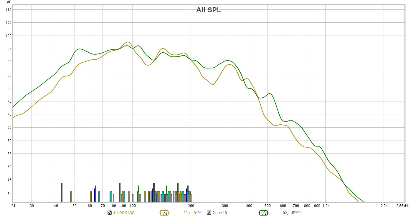

I did a small comparison to a known driver. since when playing with the after a while im not sure if its any good...
Hmm today i was playing some more with the dual foils. i changed the coil to cover more of the foil. not sure yet if i like it, it performed as good as the old one where i added some extra alu to vover the bare mylar.. (makes it move less random there and adds some weight for lower res) but i am in doubt non stop 🙁 is it worth the effort or not ? i thought i just do a measurement with the panel and a known panel, the Magnepan LRS. they are not known for bass., (i did chose the one with the lower resonance) but the LRS is roughly twice as big as my test panels.

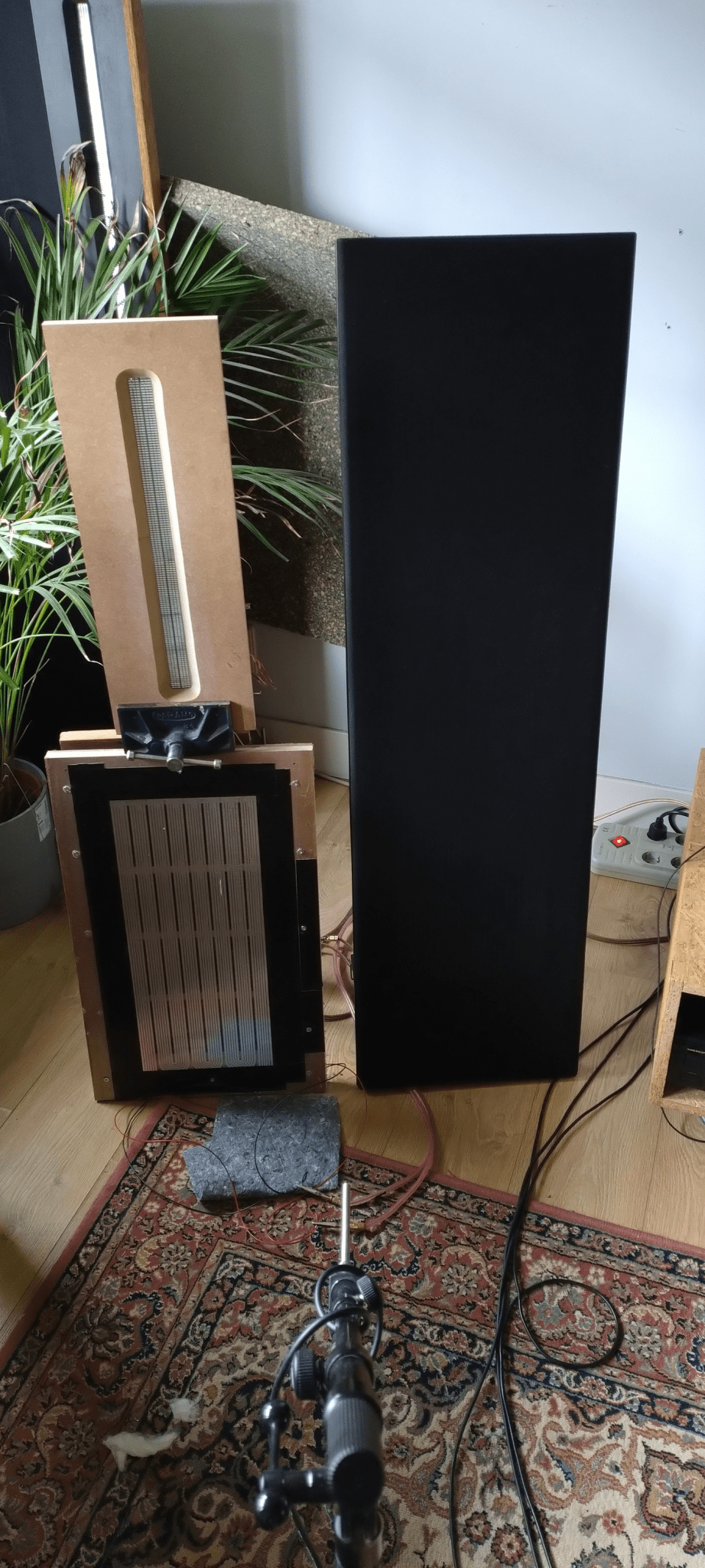

picture 1 The setup (the lrs has besides more surface area also more baffle)

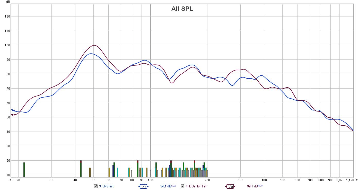

picture 2 FR Brown LRS bass (i used a higpass to not blow anything) Green dual membrane panel.

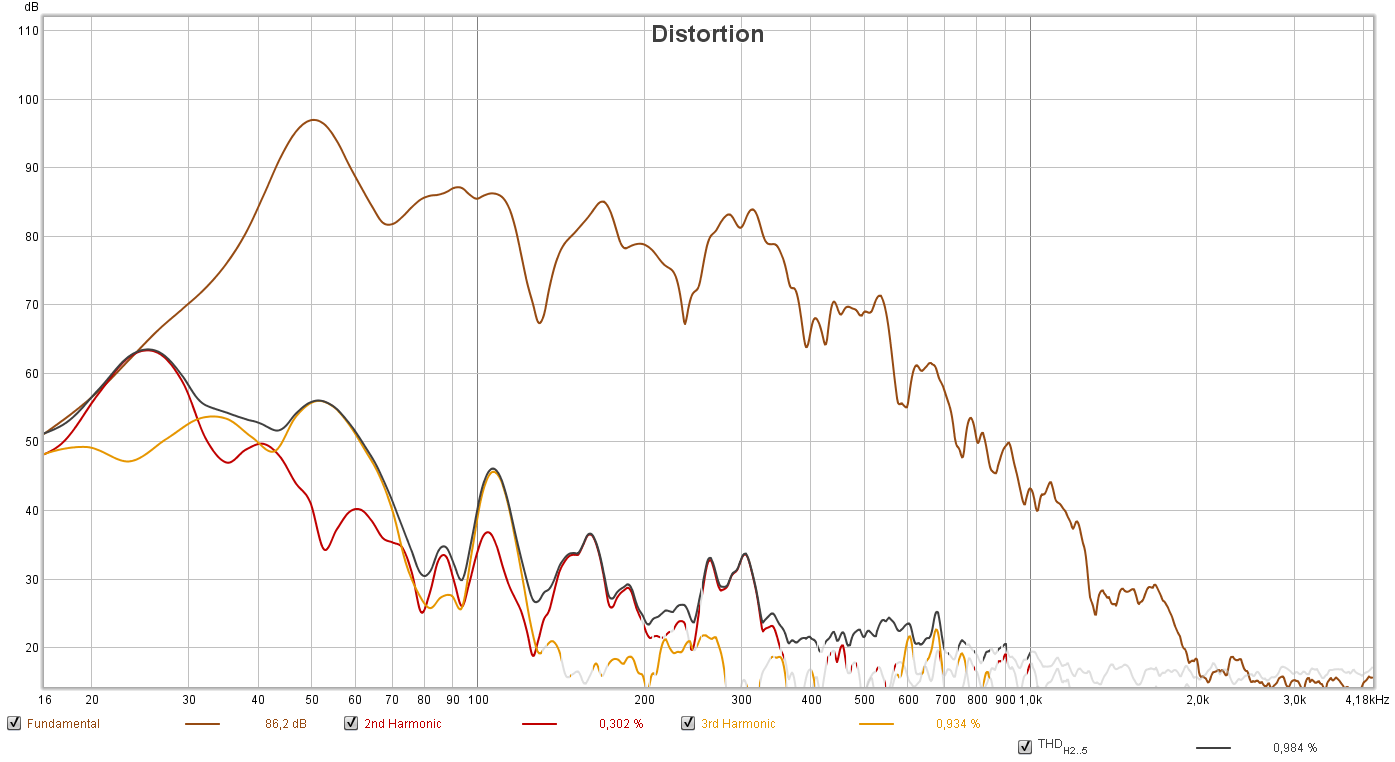

picture 3 Distortion LRS

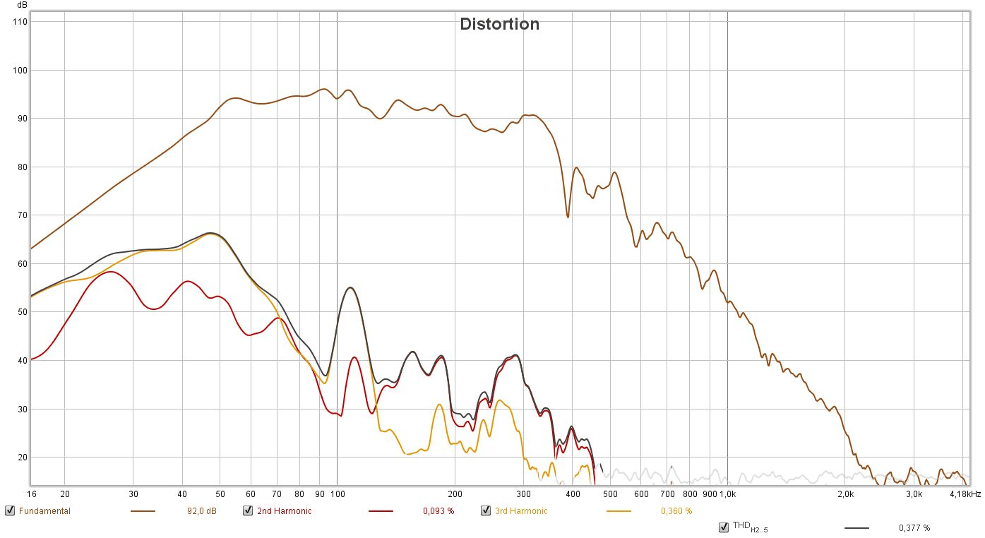

picture 4 DIstortion Dual membrane... most visable is 2e order distortion but also the 3th is a bit lower and the whole panel can reach lower. dB not calibrated, but it was on the edge i want to push the LRS
the small panel has some weird peaks, in 3th still, i might be able to find out what those are in the end.. i had to increase the output of my panel +3 dB to be the same level. then again my foil has an xmax of 6mm and the maggy 1-1.5mm. so i might reduce mine a little 🙂 unless i want to reach lower like 40 hz or something (halving resonance is 4 times the excursion)

These are very learningful graphs! Especially two things: the quasi PP woofer panel makes magnitude better distortion and both of panels knows physics. Decreasing frequency, the response starts fall at resonance point with 18dB/oct. rate, because the membrane compliance determines the excursion.
i thought any panel should drop 18dB below res. 6 from baffle and 12 from playing under res?

Yes, all of panels does it, except if the resonance is very undamped. We can see the 18dB/oct. slope in this case too, but well below the resonance point only.i thought any panel should drop 18dB below res. 6 from baffle and 12 from playing under res?
well i only damped it with the DSP right now.. and i am not liking that to much, but its fast for now - 12 dB or something at 50-52Hz
and another 8 dB at listening position for my room 🙁 haha the LRS goes down to 50 in my room🙂 but only because my room is that bad

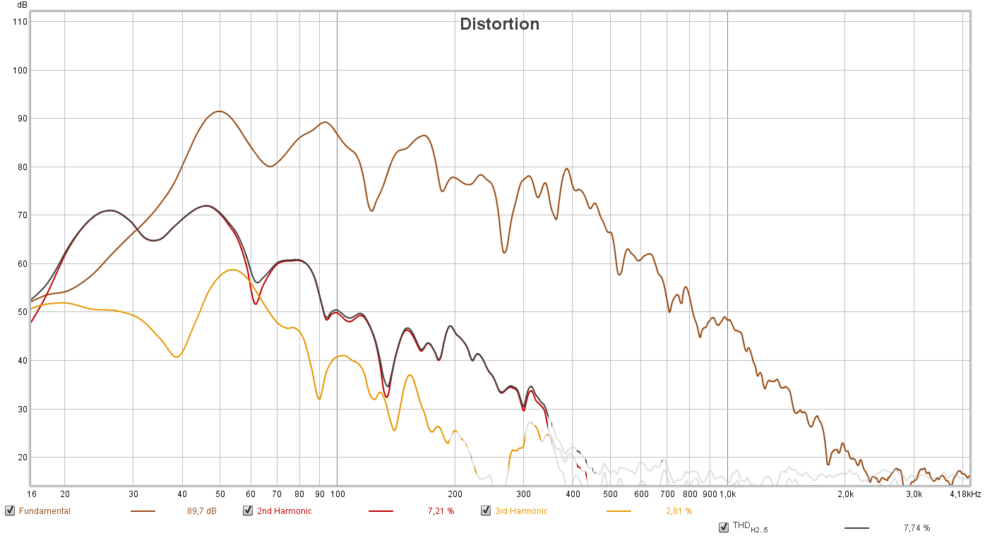

PIC 1 LRS
PIC 2 Dual foil. there is one nasty hump in 3e at 107Hz , not sure what that is 🙁
