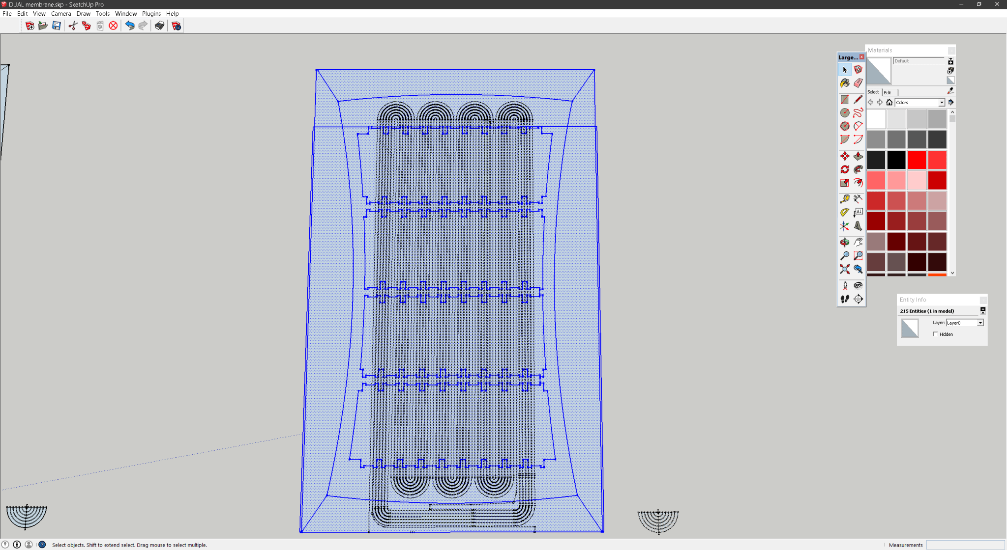

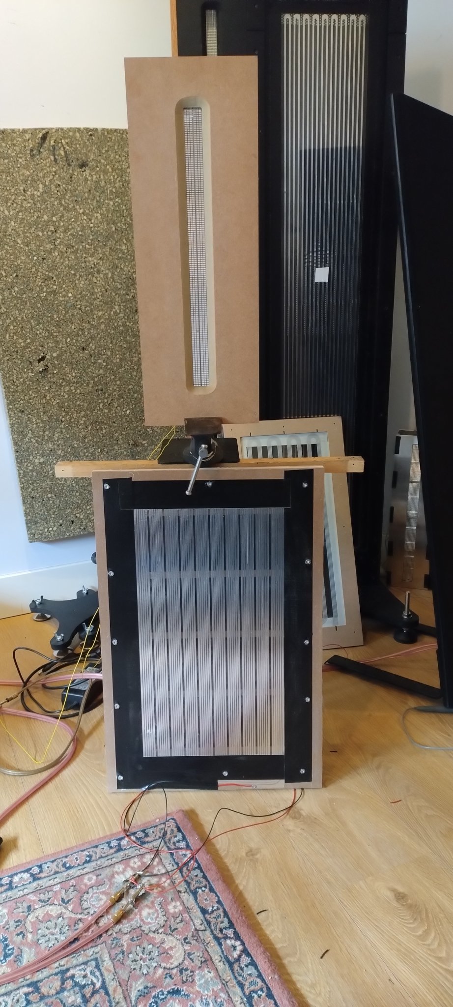

well i increased output on ym panel, else it would not be fair. today i made a wider dual foil.... 🙂 this is how it looksAnd if you play at same level and then measure distortion.... how will it look like?
clocks in at 40cmx60cm including the frame

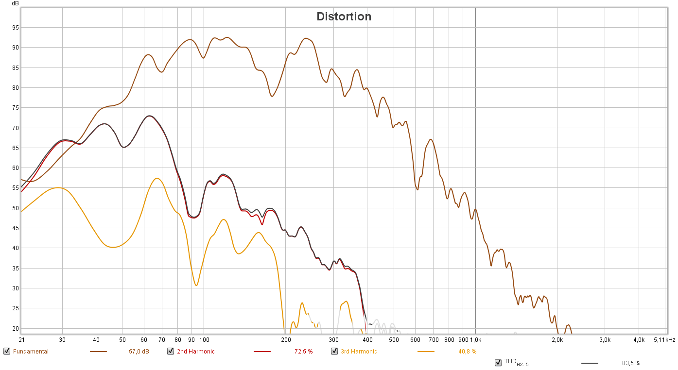

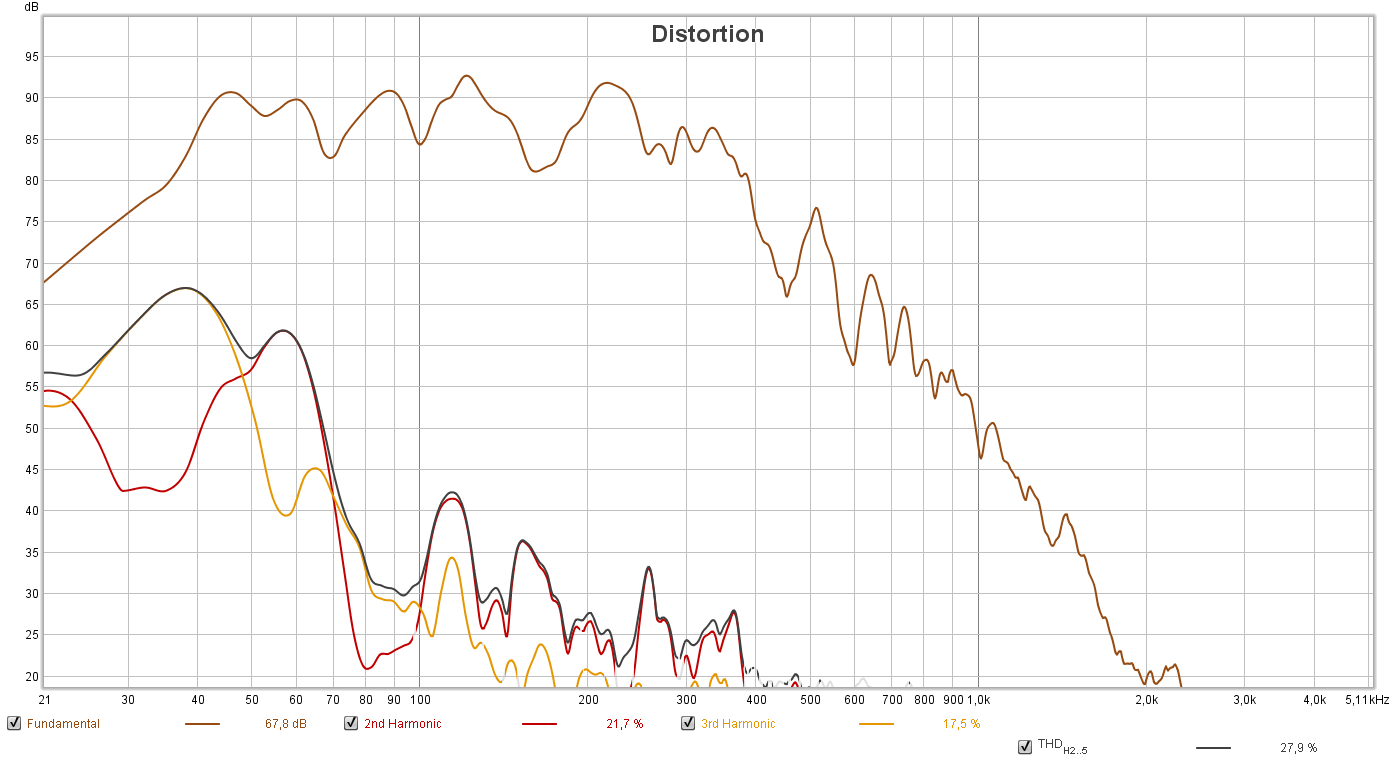

and here is a distortion measurement, i increased my panel in volume to match the LRS. but well i dont think its a match if i may say so.
Pic 2 Distortion LRS right side
Pic 3 Distortion Panel 3 dual foil (with EQ to get rid of the resonance for now) without it my whole room rattles. because its +12 dB on 44 hz or something haha.
so far i still am not able to hit the magnets... so i think i need to decrease the Xmax at least 1 mm. to gain some efficiency hopefully, and i might need to look into adding metal on the outer magnets to get them closer to the foil? and i might need to find a way to damp them without DSP. maybe i can play with the hole sizes between magnets and even add a chambfer ? might reduce som distortion problems i dont no. as for now im not sure if the speakers wants more open area or less... chambfer would decrease oven area between the panels.. i also dont know what reducing the air in between the foils does so with an xmax of 5 the air in bewteen the foils is reduced to, maybe less spring like ?
well it does do lows 🙂 my rooms still adds to much although at 51 hz i already ahve a notch of -8 dB 🙁 on both channels

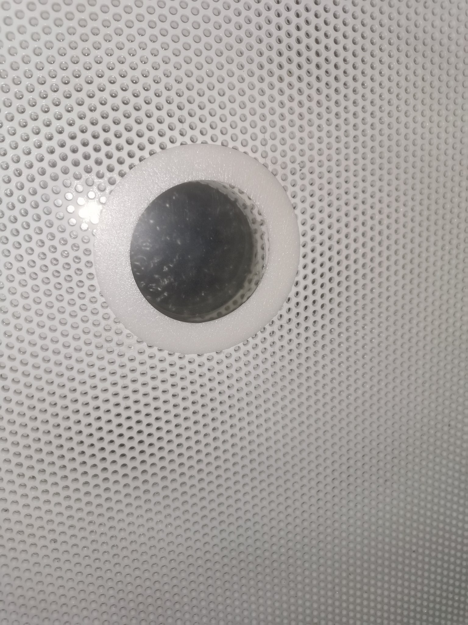

since top and bot are more limited since it has 3 spacer holding the foil compared to only 2 and one side having really low res in the middle. but i guess in your case where the hole is its not driven 🙂 hmm i might remove 2 of the middle magnets when i think of it
When the attraction over the entire area is the same, then the membrane in the center attracts the most, because there the tension of the membrane is the smallest. And when you load the center with a hole, the membrane works more evenly over the entire area.
i think this is only true for ESL , since a hole would make it more easy to move there. 🙂 since it has less damping, and its not driven by a stator.
the reason why it would be easy to move there is because its just like a drum, and its the easiest to move in the middle of the circle.

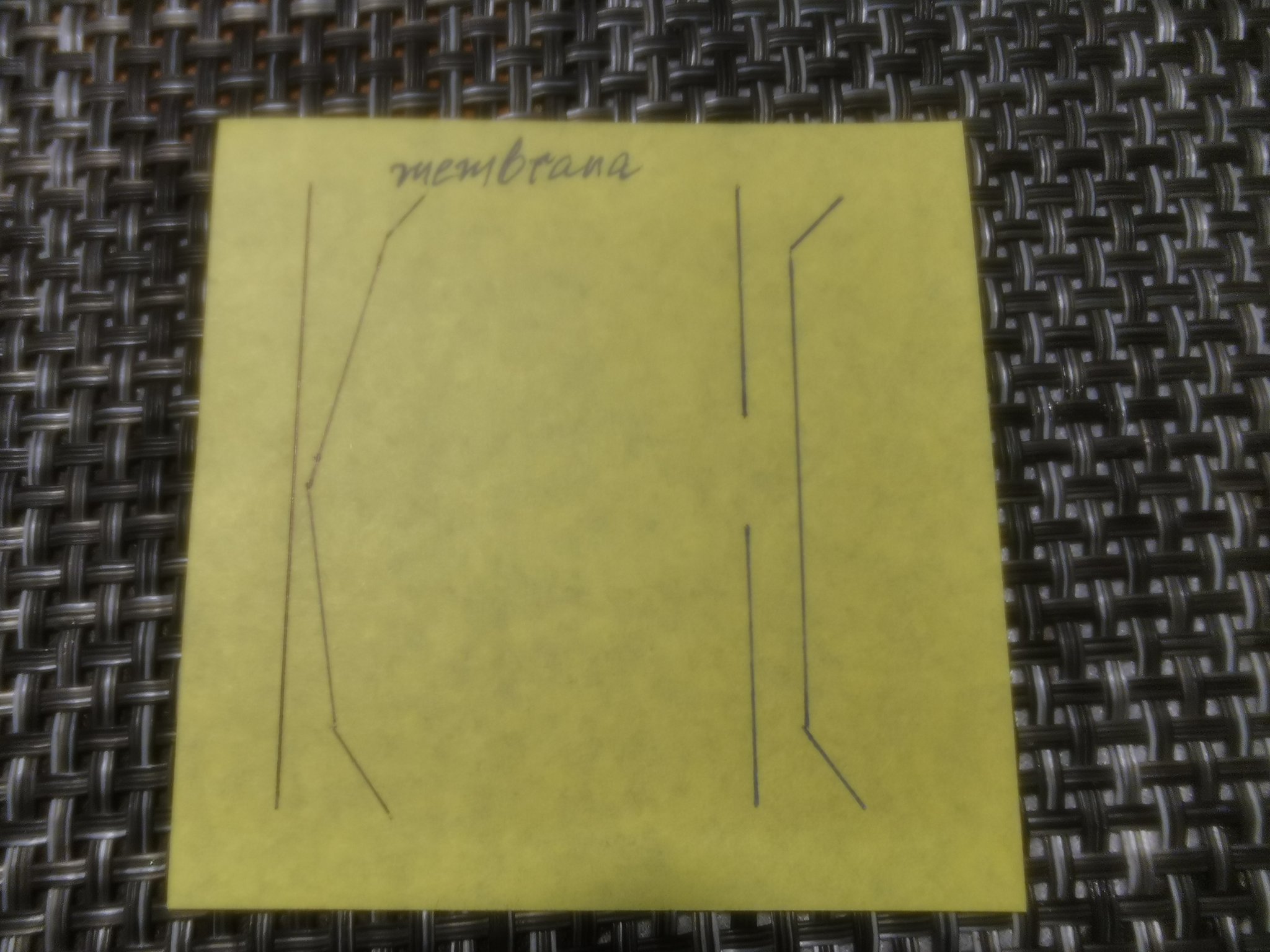

Havun's implementation has a more important advantage (only at static's): the centre of membrane is vulnerable by charge migration because there is the largest excursion. The undriven area of membrane reduces the excursion, and totally eliminates the charge migration (because there is "statorless").
The earlier Magnepans have doubled wire around the perimeter of their membranes, simple wire at centre. Another constructions work with bigger magnet-membrane distance at centre (most of them are push-pull, and the insufficient rigidity of magnet-frame provides the arcs😉).
I turned to the knowledge of a primitive man, he, imitating thunder, beat the center of a large drum with a mallet, this man then knew that the greatest amplitude of the leather membrane is in the center😆.
By the way, there were no electrostatics or magnetpanes then.
But it’s one thing to reproduce only a drum, and another to reproduce the entire range of low-frequency musical instruments, and in the case of our devices, be it magnets and glued-on coils or electrostatics, this position (where the center of the membrane is attracted more) can cause large distortions of the musical signal.
