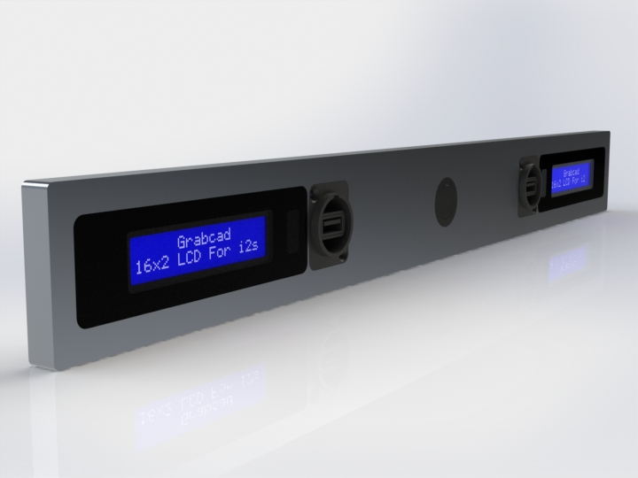

Ok, here´s a first draft of the Najda front panel I might use:
Two displays, two IRs, two USB connectors, one button. 🙂
The first display will show the Najda information.
The second will show the source selected from Twisted Pear Mux, and also the status from the LEDs outputs from the Najda. An Arduino will set the sources and read the LED status and display both on the second display. It will also read the button and send the signal to the Najda and possibly other things, such as triggering amps on/off etc.
The button is a heavy duty chrome button from parts express, flush mounted.
The two USB connectors are for programming the Najda and the Arduino. The Neutrik USB connectors are reversable - I will have the square end facing out, not the rectangular one.
LCD and IR receivers protected behind acrylic.
I will follow Nick´s suggestion and build a small keypad and hide it inside the cabinet, so that I can (re)program the remote when necessary.
Comments? Suggestions for improvements?

Looks nice! But why would you use the Arduino to set the sources? That's not clear to me.
Do you have a source for LCD acrylic protective covers? I'm looking for a supplier 😉
I interpreted this as meaning - set the sources on the Twisted Pair mux
I rather like this concept - an independent second controller and interface for any additional functions not built into najda. I also like the concept of the second to display/instead of the status LEDs.
I have a few sources, TV decoder, Sonos Connect, XBOX 360, Mac Mini in the rack. Perhaps I'll add an Apple TV. Will probably keep the Najda on one source, and have the inputs selected from one or several Mux-es. Another option is to combine it somehow - but I haven't worked that out yet. But that would add some complexity in use (or I have to be clever with the Arduino). I have the transformer-isolated input boards, so with those I could avoid any ground connection between the sources and the Najda. The squeezebox for example, does not have a transformer on the output (which it should I think). I don't use it anymore, as I switched to Sonos, but I think it's safer just to have transformers on all the inputs.. So: More inputs, and no ground connections are the reasons.
For a one-off project, I was planning to have modushop or Schaeffer mill the front panel. I don't know if modushop can also provide the acrylic cover, but I know that Schaeffer / front panel express can make them in different thicknesses. Probably too expensive for production runs though. I know a company in Norway that could probably do it - called Kreativ Plast (www.kreativplast.no). I'm not sure if they are competitive on large quantities, but they can do everything with acrylic.

Hi Nikk,
I've seen a ref in conrad web shop "H tronic - Cadre à clipser pour afficheur LCD 2 x 16 h-Tronic FR 216"
Cadre à clipser pour afficheur LCD 2 x 16 h-Tronic FR 216 - Vente Cadre à clipser pour afficheur LCD 2 x 16 h-Tronic FR 216 sur conrad.fr | 140376

I've ordered a modu case with custom CNC-ing which is currently in transit on its way to Australia. The CNC work I wanted done was slightly ambitious, but well within the capabilities of CNC machining. I am pretty hopeless with CAD, so sent them a PDF generated by something like powerpoint with the measurements, cutouts and other design work and paid their fee to have them generate the CAD files.For a one-off project, I was planning to have modushop or Schaeffer mill the front panel.
After working on the drawings for maybe 2-3 weeks over the Xmas break, they got back to me with a very basic design that had cutouts for my buttons, LCD display and meters. My meters were not flush-mounted and the primary 'really cool!' part of my design (actually shaved ~15-20% of the surface, so kinda ambitious) was completely missing, replaced with the horizontal 'feature' line seen in one of the photos of a case on their site. To be told they couldn't do my design after already taking my money and working on an alternative was disappointing to say the least. We went back-and-forth a few times but in the end my meters are still not flush-mounted and my case will look far more mainstream than I wanted.
So.. I guess the point of that story is to make sure you understand what the design house you are working with is capable/willing to do for you. Your design is reasonably simple but you'll need to make sure modu/schaeffer will do the flush-mounting as modu didn't for me.
Had they been up-front, I wouldn't have used them as I have access to friends who are good at CAD and there are plenty of local joints willing to CNC aluminium :/
MellowFellow, good point. I suppose the easiest is to send the front panel to Schaeffer and have them do the milling. I have also experienced that communication with Modushop is difficult. If they had become a Front Panel Express partner, they could have received the FPD files and avoid a lot of misunderstandings.
Cheers! 😉
Thanks Pascal, that's interesting too indeed!
