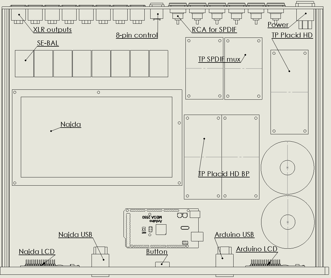

Is there a 3D model of the Najda?
I'm afraid not. There's a upper view from the board as well as a rear panel template available for download on the website.
