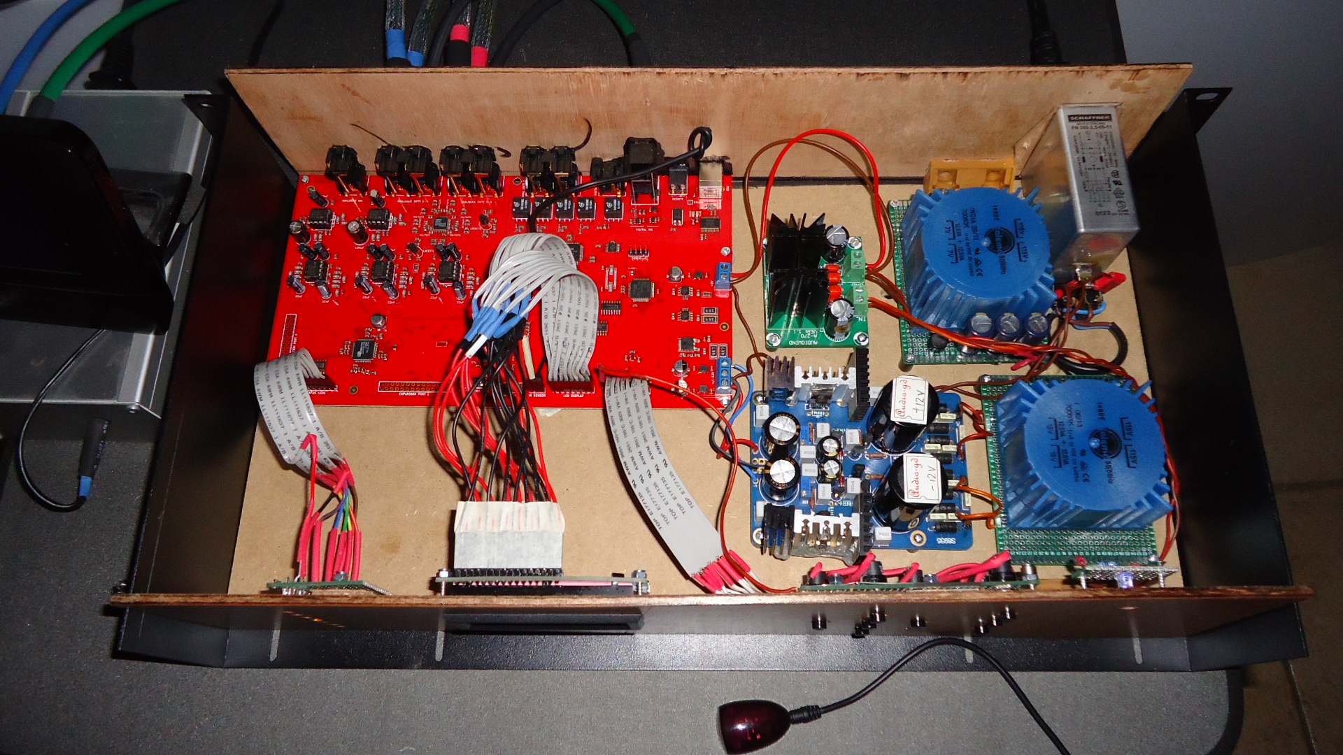

Just finished building the Najda, got the board last week, it works, only very often one of the analog outputs clips, although signal is normal , there are sudden red (clipping) moments, and they are very audible, never had that with the CDX2496, I already adjusted the gain, does not seem to do the trick, what to do?
If you are not using it, try to disable the tone control section and see if that helps.
Hi
I just adjusted gain down further, now it seems ok, only the recordings that are very aggressive (like Muse) seem to have problems, they show clipping in the DCX2496 too, but are not so obvious to hear....in the Najda it gives nasty sharp sounds.
Bjorn is right: you need to lower the input gain. Keep mind that transients require a bit of extra headroom. Indeed, the frequency response plot is only valid for steady-state content.
Maybe you'd want to send me your setup file, I can have a quick look at it and I'll let you know if we can optimize it.
BTW, congrats for your build!

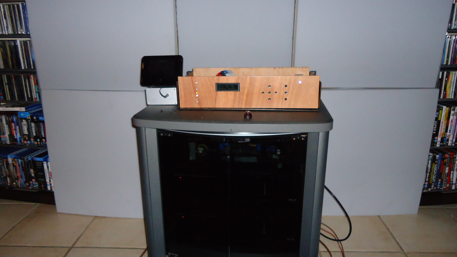

Here a few pics, of the functional, but not yet finished, Najda DSP and my DIY dipole (& ripole) set-up, sounds very good now with the Najda not clipping anymore....

Hi Nick
BTW i am Tom, aka tojoko, I use 2 18 inch woofers in a ripole design subwoofer, push-push configuration, and 2 way satellite so i use 6 channels, sub as sum, the people who heard the set up were pleasantly surprised how well it sounded, I agree!
It is driven by 2 old, but totally done up, Kenwood Basic M2's and a Behringer A500, also a bit tweeked, before the Najda I used a totally upgraded DCX2496, with build in 6 channel preamp based on the PGA2311 (3 X) this worked very well, i just wanted to try something newer and hopefully better.... till now all is well.
