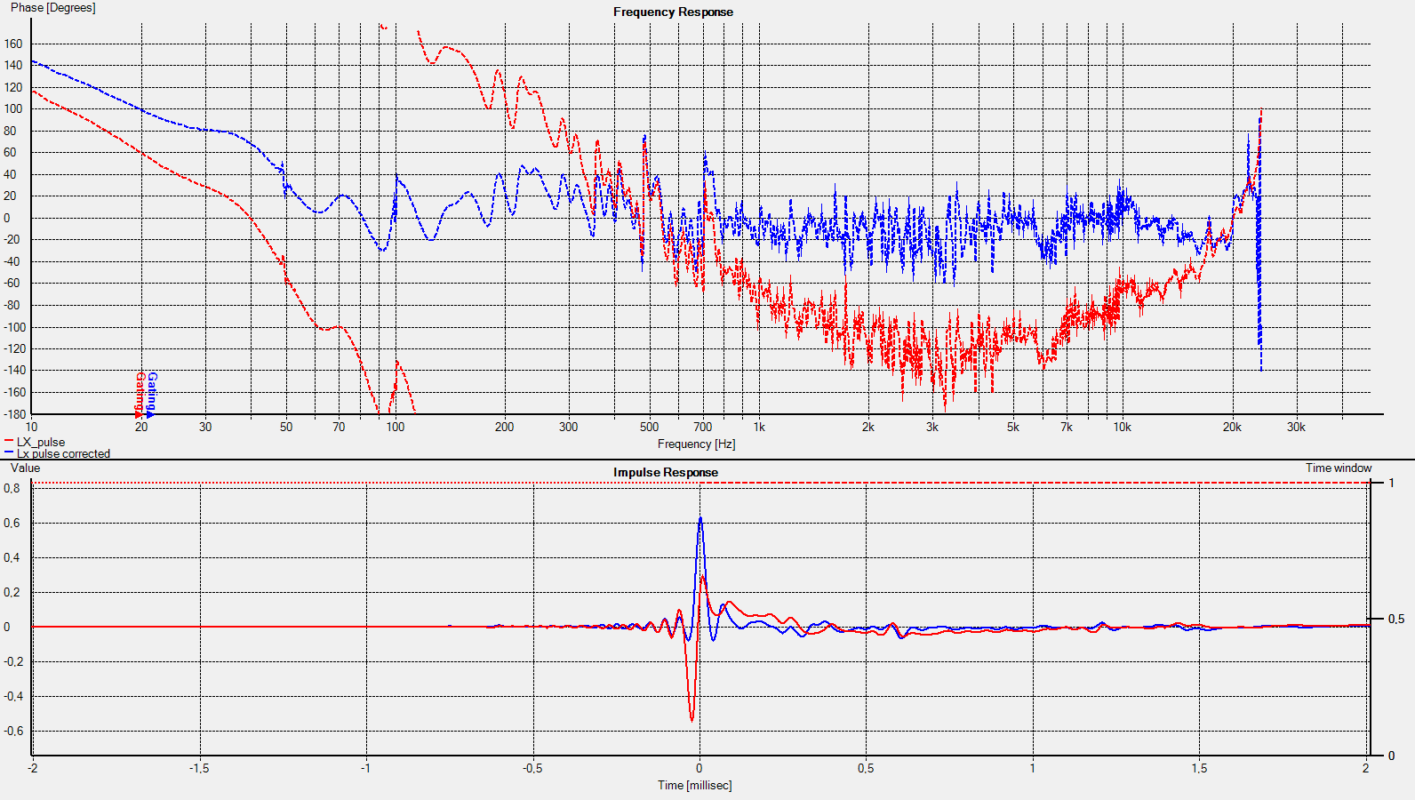

I tried som FIR phase correction in front of Najda. It was hard to produce a good filter With rephase so I measured Acoustic phase at 1 meter and used this in Acourate. The red trace is Najda only and blue is Najda with fir frontend.
I have to make some switching possibility to compare with and without phase correction.

do you know how many taps we can expect?
Will it be in the input section? (2-channels in front of IIR?)

The FIR part of the mix will indeed come in the input section - so basically it's going to work similarly to your current setup with Acourate.
If you have questions on how to use rePhase, you should probably post them in the dedicated rePhase thread. I'm sure someone there can help you.
The number of available taps will depend on your sampling frequency and on the use you make of the IIR section. If you give me this info along with the DSPs load, then I can let you know how many approximately.
