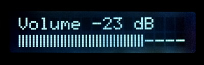

Forgive me if this has been asked before, but is it possible to get big numbers on the 2x16 LCD display? For my previous project I made a little library that uses some custom characters in the LCD character map to get the volume displayed over two lines (many such libraries exist already - google BigNum, LCD, Arduino for example). I would love to use the Najda in my system, but it´s important to be able to read the volume from a distance.
If it doesn´t exist - is there any chance you will include it in the software? Alternatively, any way of using an expansion port to output the current volume so that it can be displayed by a row of LEDs, a display (via an interpreter such a an Arduino or similar)?
Hmm no, the numbers for the volume are standard size, but there's also a bar showing what the volume is.
I guess a picture is worth a thousand words:
We could imagine eliminating the bar and replacing this screen with big numbers. Anyone?
That looks fine! Thanks.
