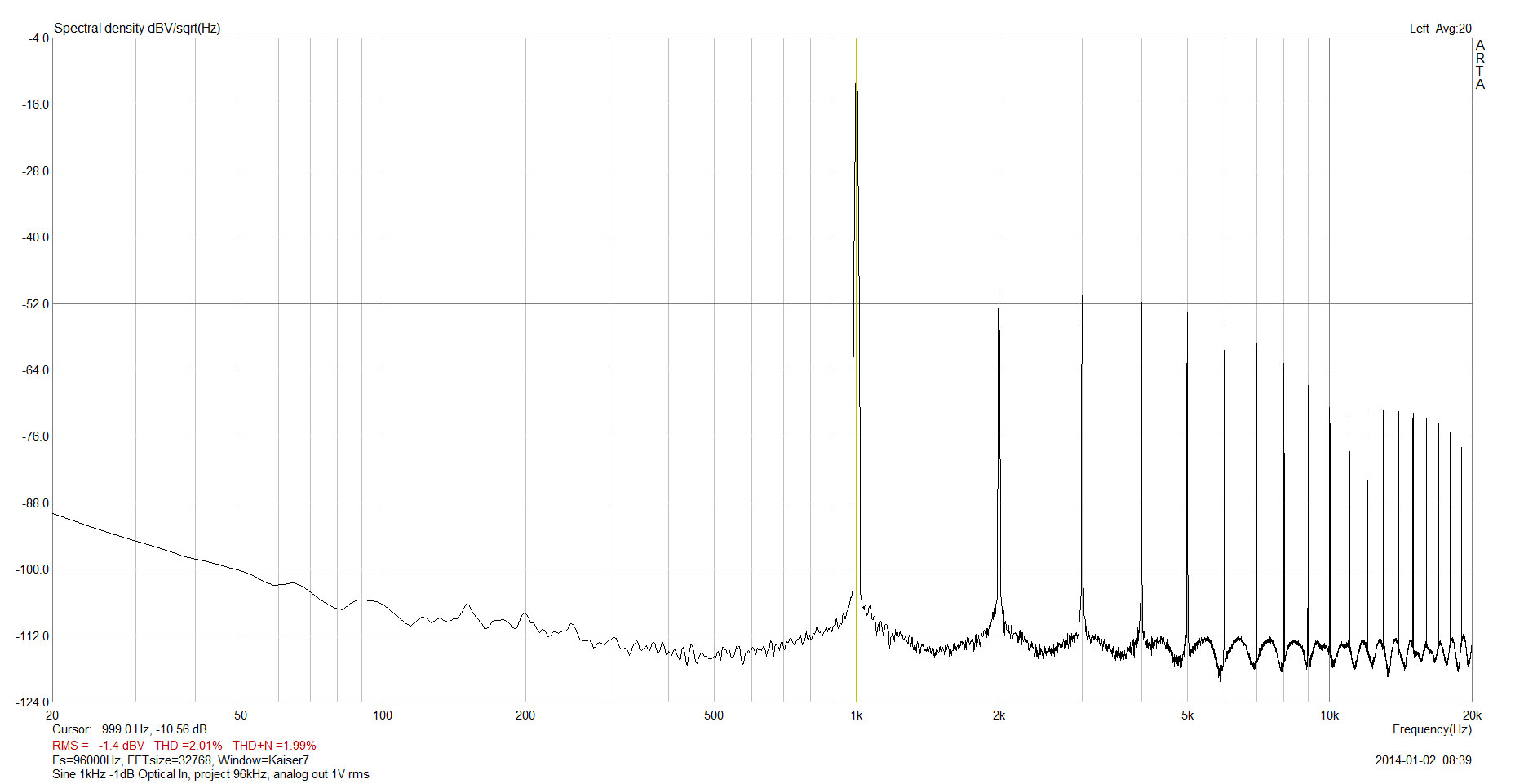

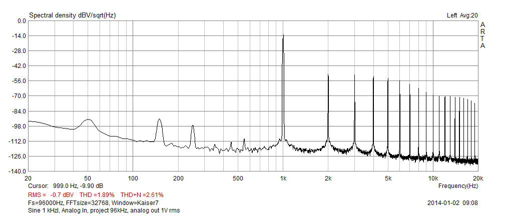

Problem with mute and distortion
I experience problems with the mute function and have high distortion.
Here is the story: Because of other topics my Najda build was delayed. But now I found the time to assemble it. First I connected the LCD, the LEDs, the buttons and the IR receiver. I use an external power supply. A picture of my prototype is attached. I double checked every connection and powered it on. Everything worked fine, I was able to scroll to the LCD menues. Then I downloaded Najda SW 1.04 with Firmware 1.1, connected Najda and did a FW upgrade. All without problems. I played a bit with filter settings and checked the LEDs for overload, SPDIF Lock-in etc. All worked as expected.
Then I decided to listen to it. I configured Najda as coax 96 pass thru and did not define any filters. I connected the coaxial ouput of a CD player to the corresponding coax input of Najda. Two Najda analog outputs I connected to the input of an amplifier with two cheap loudspeakers for first test. I set the Najda volume to -50dB. Then I played a CD and was surprised by the heavy distortion I noticed. I pressed the mute button of Najda, but the output did not mute. I further reduced the volume of Najda. According to the LCD even to -96dB. But the distorted sound did not get reduced. So obviously mute and Volume control do not work as expected.
I then put Najda back to the PC and did some tests with Arta. All test have been done with 96kHz project setting and without any filters defined.

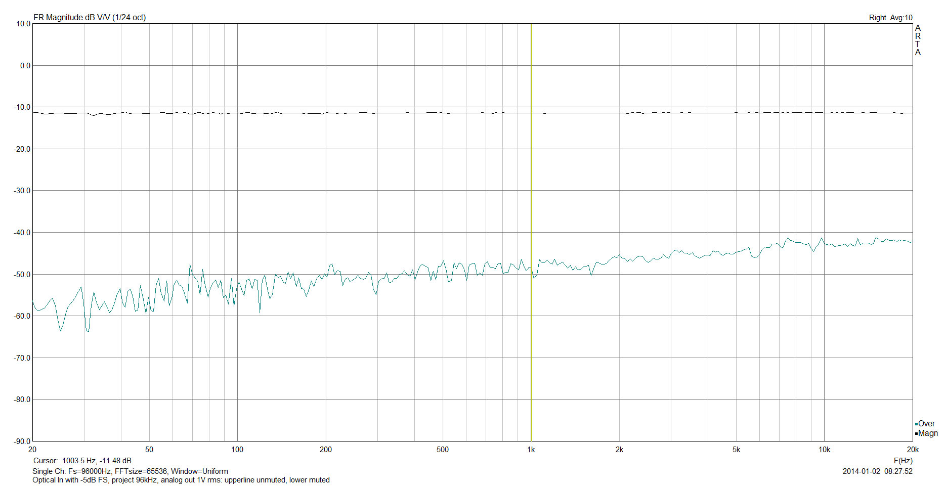

1. I first tested the mute functionality. According to the documenation muting only works for analog outputs. I used the optical Najda input with Pink Noise at -5dB FS and measured the analog output with full volume and muted. You see the result in the picture. The mute function of my Najda does not really mute, but reduces the volume by about -40dB. With the volume setting I could adjust the output, but not less than the "mute level". This means the volume control works only from the 0dB to -40dB setting. From -40dB to -96dB the level stayed constant at the mute level. Strange!

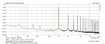

2. Then I measured the distortion. I put a 1kHz sine through the optical input and later through the analog input. Output was coax or analog. I carefully watched to not clip the input signal. I used -1dB FS for digital input and 0.97mV rms for analog input (ADC LED never lighted). You see the results in the attachment.
You notice for optical input and analog input a very high THD of about 2%. And this is with almost full level input. When using a smaller input signal the distortion relative to the signal gets even worse.
It is definitely not a measurement setup issue because I noticed the distortion already with my "conventional setup" mentioned above.
Anyone having an explanation?

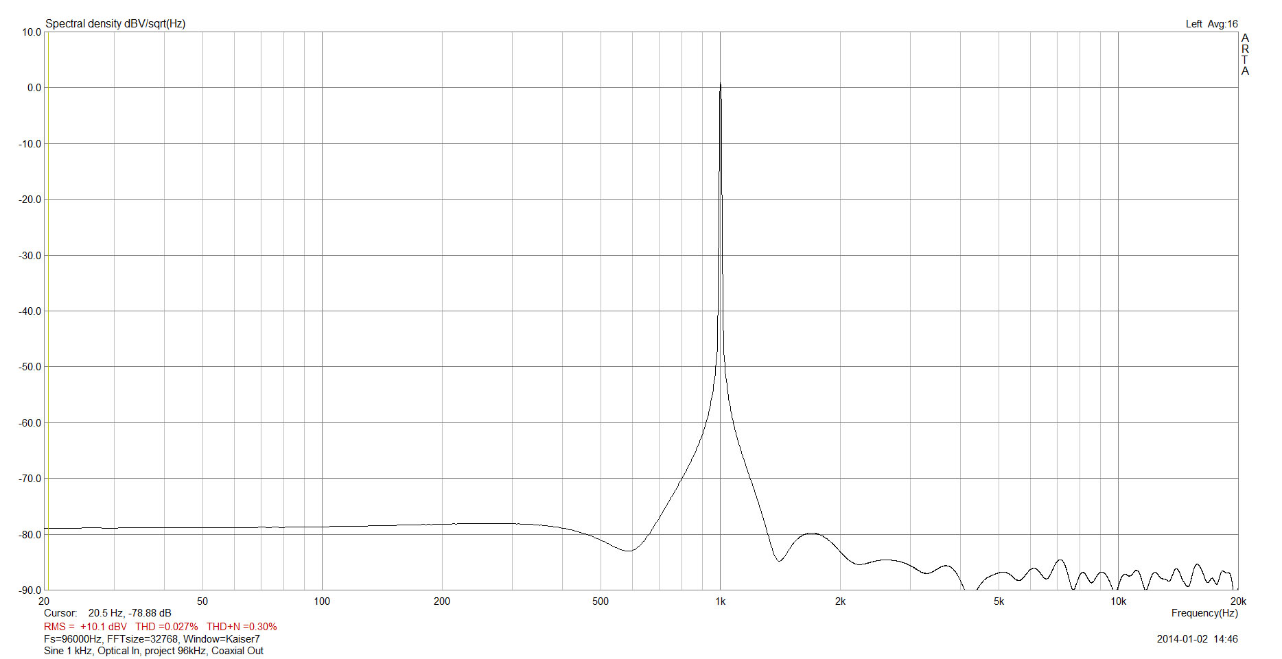

3.) I included a measurement of the 1kHz sine using Najda optical in and coax out.
Looks better.

Hi Uwe,
Thanks for these additional details.
Please send the board back to me. Even the digital out looks bad actually: the noise level shouldn't be that high (or is that related to your measurement setup?). In any case, I'll check the board at the lab and I'll keep you informed.

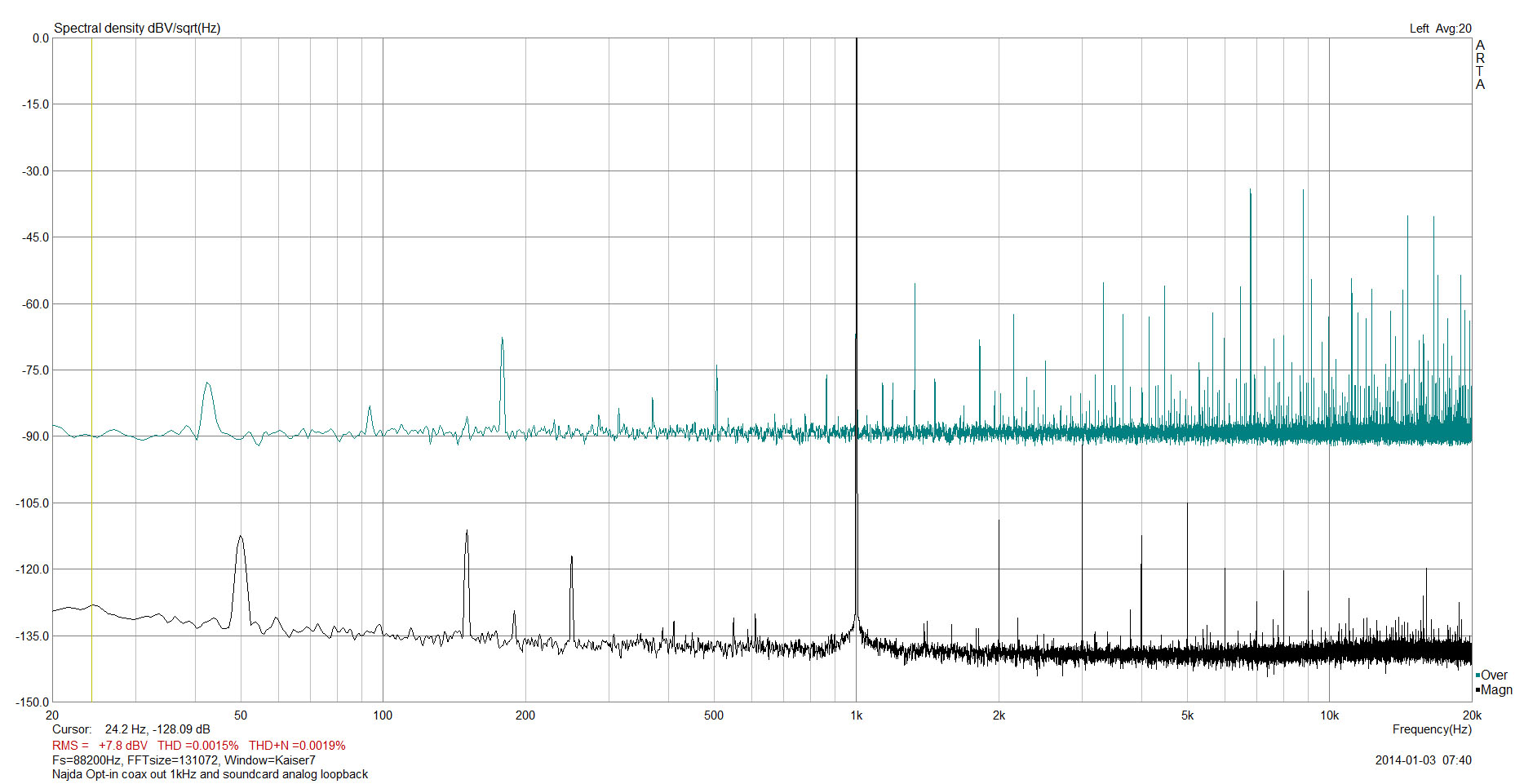

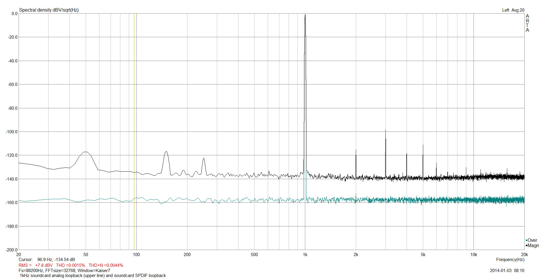

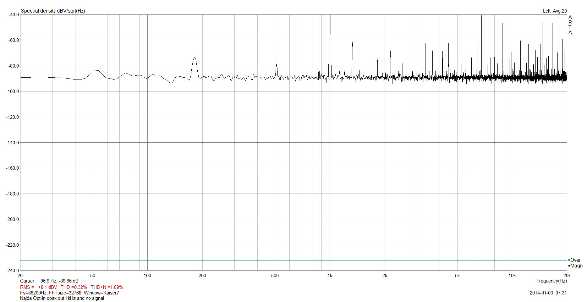

Hi Nick,
thank you very much for your support!
I will send back the board to the address of the invoice.

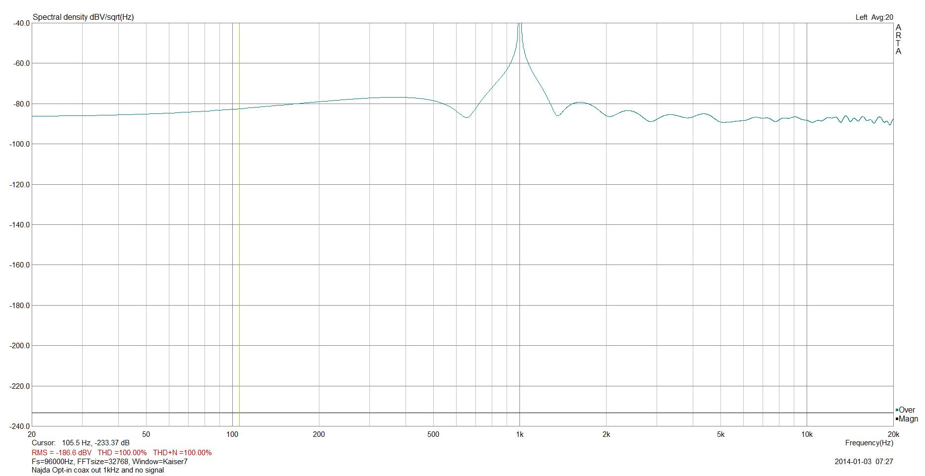

I did some further measurements. There are some strange things going on which I do not fully understand.
1. Setup:
Najda
- project set to 96kHz and classical free routing
- Optical-in Coax Out (pure digital processing), no filters set.
Arta
- sampling set to 96kHz
- used soundcard is an RME Fireface UC
First measurement: no signal (Najda SPDIF locked)
Second measurement: 1kHz sine (-3dB FS)
In the attachment (both measurements shown as overlay) you see for no signal the line at -233dB noise (which I believe is related to the digital resolution of the soundcard).
Strange is the signal for 1kHz (upper line). I guess there are some interactions going on with Najda and Arta both set to 96kHz
2. Setup
Same as 1) except Arta set to 88kHz (but Najda still to 96kHz)
Result see attachment: No signal: -233dB noise as before. The 1kHz signal looks better but for pure digital processing there is high noise.
3. Setup
Same as 2) but second measurement is soundcard analog loopback (lower line, no Najda connected). The analog soundcard loopback is much better than the pure digital signal via Najda.
4. Setup
No Najda involved.
Analog soundcard loopback (same as in 3.) and digital soundcard loopback (using soundcard SPDIF in and out ). Looks good.
It seems that the digital part of Najda is also not working correctly.
Uwe
