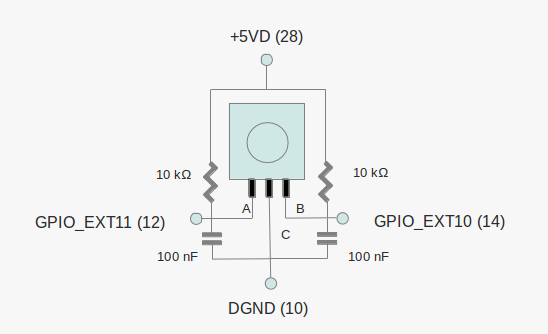

The new firmware has support for volume change via rotary encoder. The encoder should be connected to Expansion Port 1 with a few discrete components (2x 10 kOhms pullups and 2x 100 nF debounce caps as in the diagram below). Please refer to the StartUp guide that comes with the application.

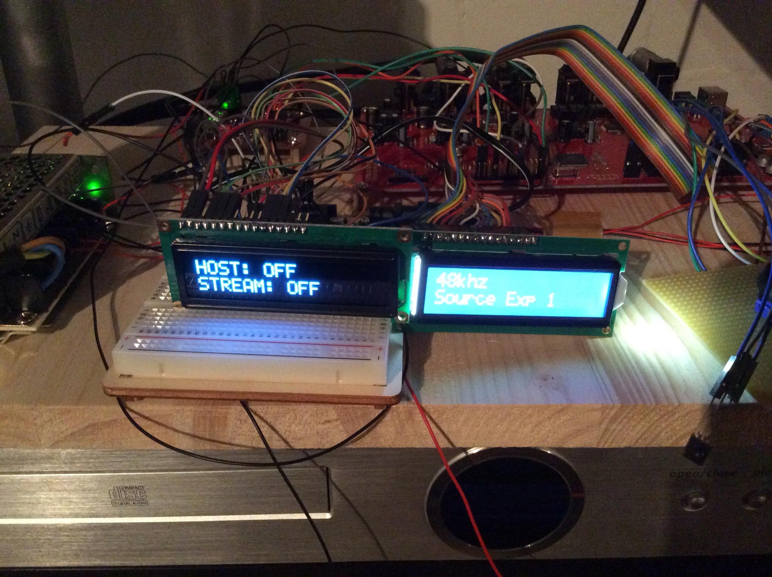

This is my first posting in this Forum. Im looking at this Forum for a Long Time. There is a very nice Diskussion about using an oled Display with the Najda Board. After some busy Nights im happy to use the waveio with the Nadja Board. Im using the waveio by I2s. The Sampler rate is shown by an arduino boarad on an oled Display. The najda just Supports an LCD Display. If you compare these two displays, the LCD Display is a mess. Look at the pictures. It doesnt make any sense to use a LCD display. Nick , i reconfiguered the Library of the lcd to use it on an oled Display via arduino. Is it possible to do the same with an oled Display. The biggest Problem is the latency adjustment of the oled. The contrast of an oled is much better than that of a LCD Display.

Regarding the displays, frankly your picture is not fair 😉 What I mean is that the camera has set proper exposure for the background, not for the LCD display, that's why the LCD seems so bright.

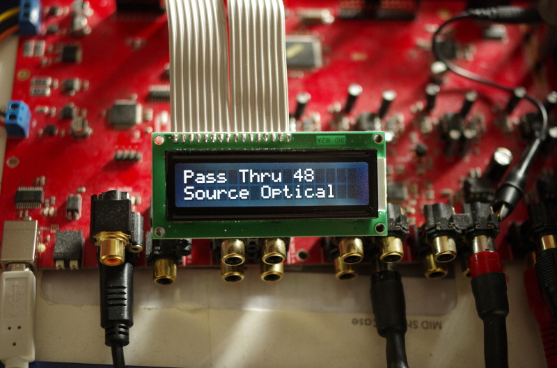

There are various types of LCDs. Below is the pic of a negative LCD being tested with Najda.
But I do understand your concern, please see below.
