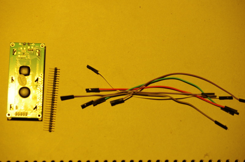

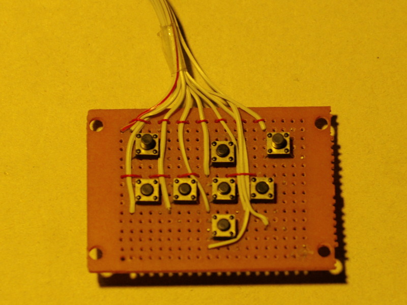

Push buttons I have never done, and the cables were a doubt. Could someone link the parts order for all the necessary cables please? I do not want to get the wrong size or shape or however these things come.
As long as you're preparing a setup on a wooden board, I suppose you don't need the best looking wiring, right?
This is my proto keypad: push-buttons assembled on a veroboard.
For the LCD, the easiest is to attach pin headers to the display and wire it with Dupont point-to-point wires:

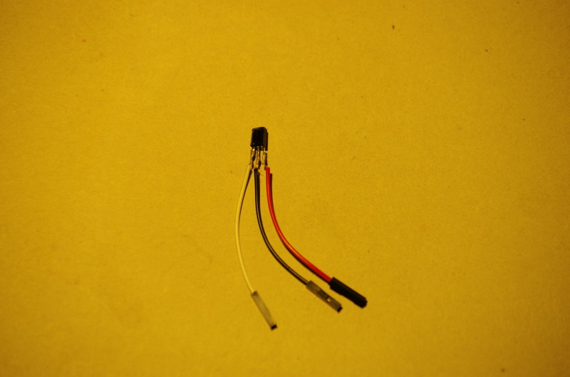

Below is a IR sensor for test: Dupont wires are at use again.
