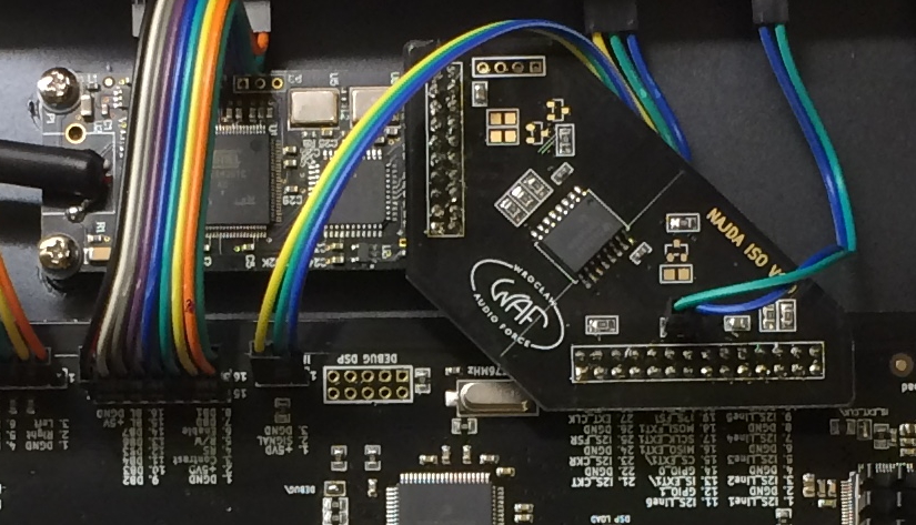

Hi I’m planing to move my jRiver to RPi 4 and had thought to use the USB input on Najda. I have the boxed version that Nick built with an internal USB card into I2S.
Is the Allo Kali into I2S a better solution. I would provobly have to take out the USB card as two I2S will prowobly not work.

I certainly found the Qobuz / RPi / Kali I2S in better route.

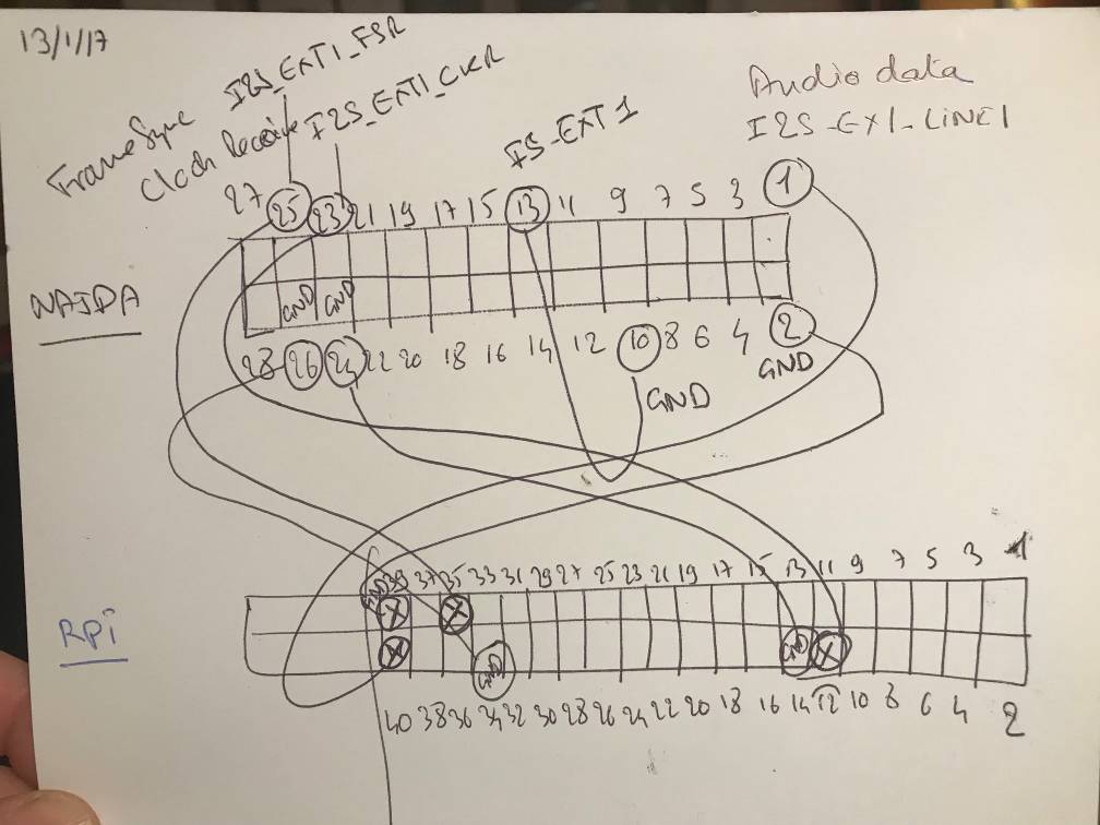

It would be of great help to get some more specific information on which pins did you connect: RPi -> Kali -> Najda
Also, you refer to Volumio and Qobus so is there some settings to consider. In your other thread, you mention Volumio Dac setting -> "R-Pi DAC".
Have you tried to use jRiver with your setup?

Jlop has posted the connection scheme in post #3215. This one works fine in my installation (still) without Kali, but I think Speedysteve7 wrote, that the same pins are to be used with Kali mounted on top.

Here is the diagram I used.
It's on this thread way back as above - Jlop, I thank him muchly.
The fun part is making sure the connecting wires are no longer than 4cm (=magic SQ number).

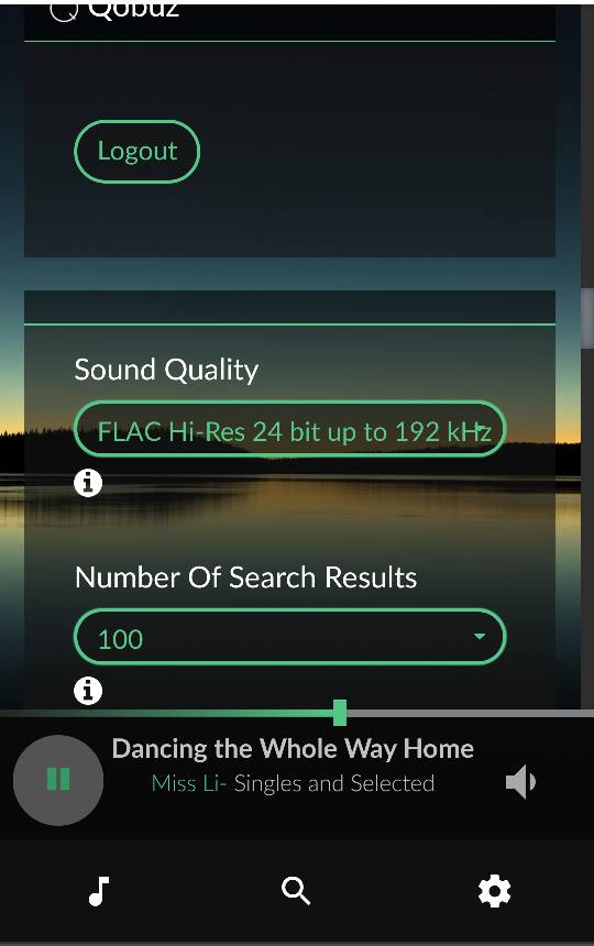

The Volumio settings I mentioned.
There's also a setting to make sure you get highest res.
I can't recall that one, it was counter intuitive.
I'll screen shot it next time I have RPi / Volumio up.

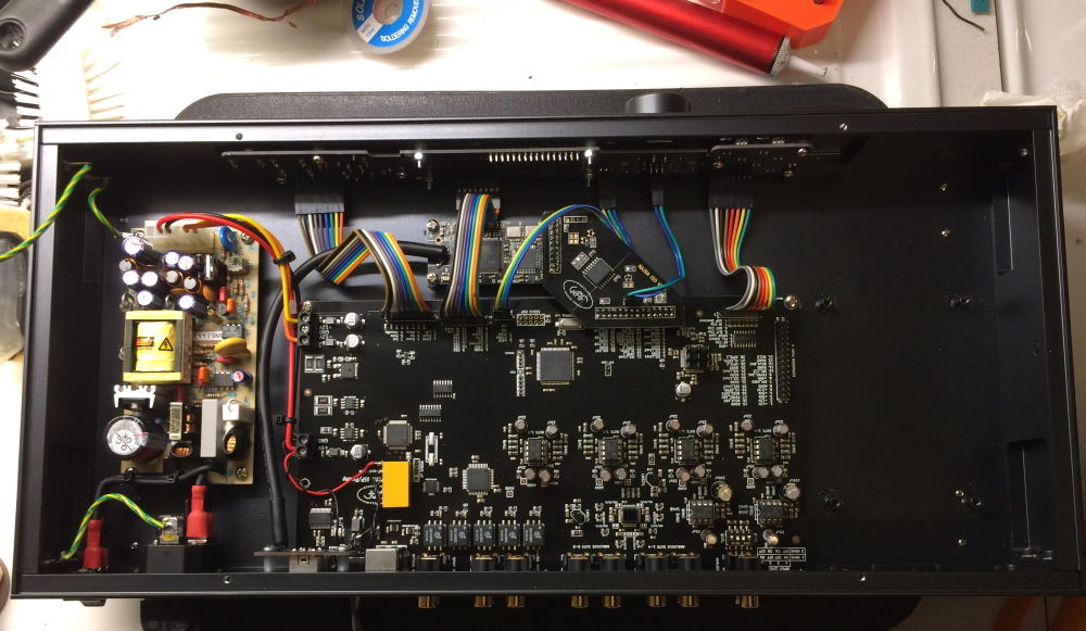

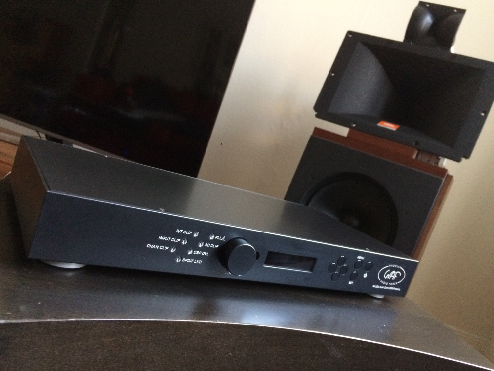

I attached some pictures for thous of you who have not seen the WAF boxed Najda. It is of highest quality and really feels solid and well done. There is room in the box so an RPi should fit nicely. But what do you say about the board between the USB card and the main Najda board?

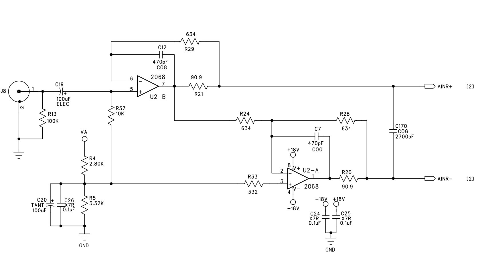

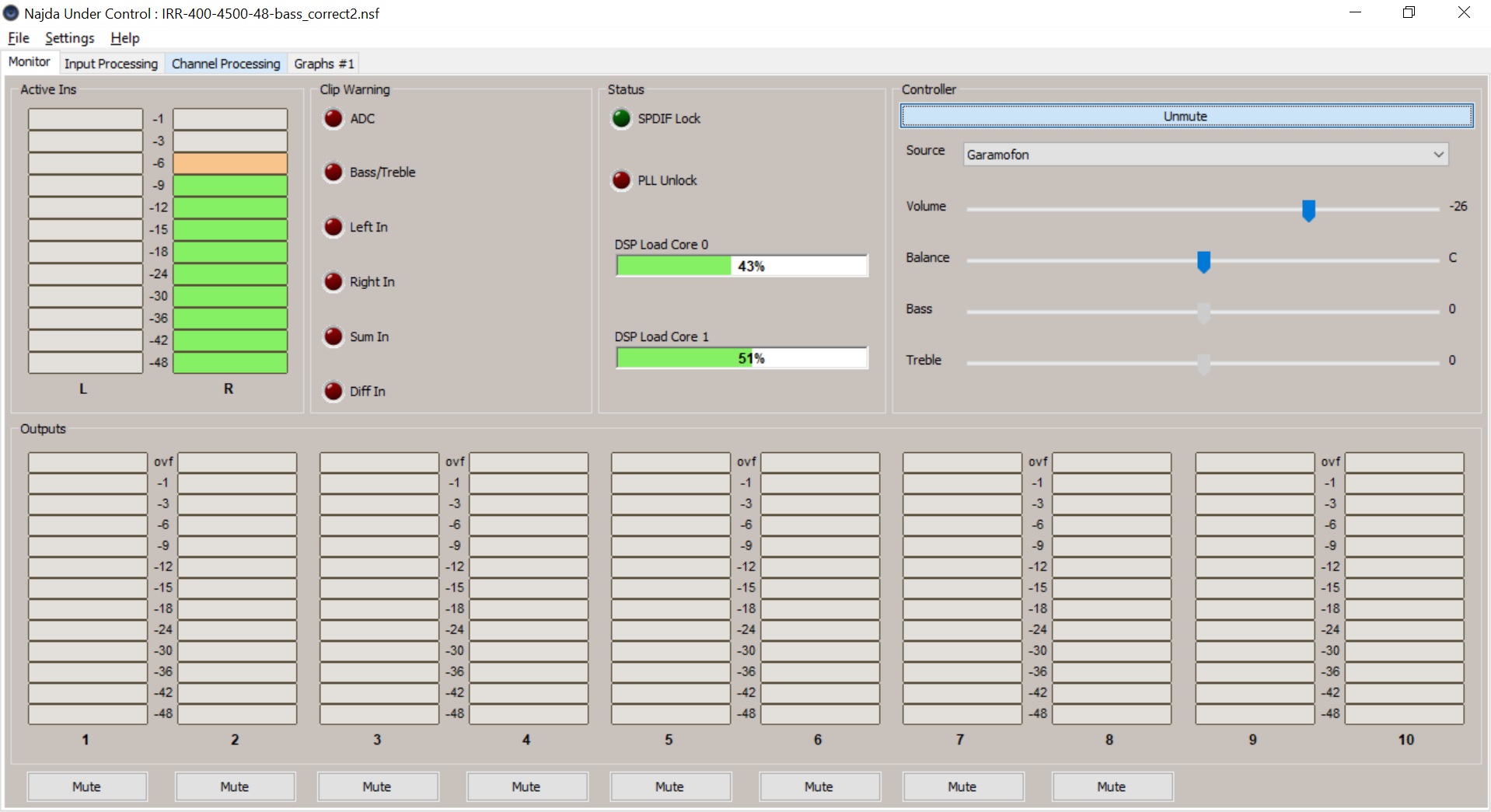

I guess I killed right channel of analogue input. Have version 1.3. Normally it's configured for 1Vrms. I'm using turntable on that input so this level is perfect for it as I don't have to put too much gain on preamp.
Lately I connected there PC card and one right channel died. I hear constant noise on it. In NUC right input level is constantly displayed as -3dBa.
While switching to digital input everything is fine.
So what could be wrong? Fried input on CS42428? Or there is a chance that something in input buffer died?
Anyone has schema of input buffer? Have one from CS42428 evaluation board, but probably on Najda there where some changes (ex. input level selector).
For a start I'll check opamp and path from input to ADC. CS42428 re-soldering will be painful in worst case.

Hello Jbator, there is a good chance that the OP amplifier just behind the right input is out of service, the ADC input of the CS42428 must not be damaged. The diagram attached to your post is the one used by Nick with some variation on the values of the link capacitors and the addition of the input attenuator.
Fortunately it was an opamp failure. But why it failed? Input max voltage for LM833 is +/-15V so definitely I did no exceeded that. Maybe some ESD or so.
I borrowed opamp form channels 1/2, tomorrow I'm going for shopping. Is there a point to use any other opamp on input part?

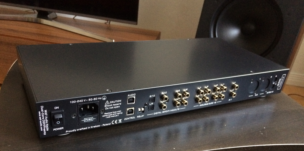

Hi folks !
I would like to put in a box my Najda 1.3 + power supply + USB/I2S converter.
Can you advice me to choose how to do the front & back plates ?
In europe we have modushop for example but I'm looking for cheaper alternatives...
