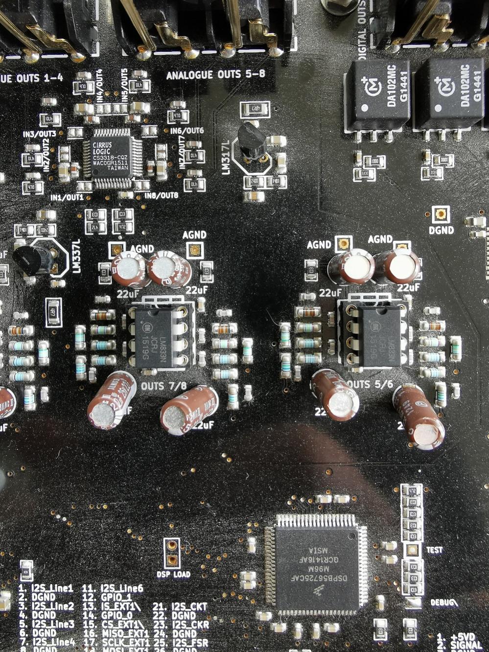

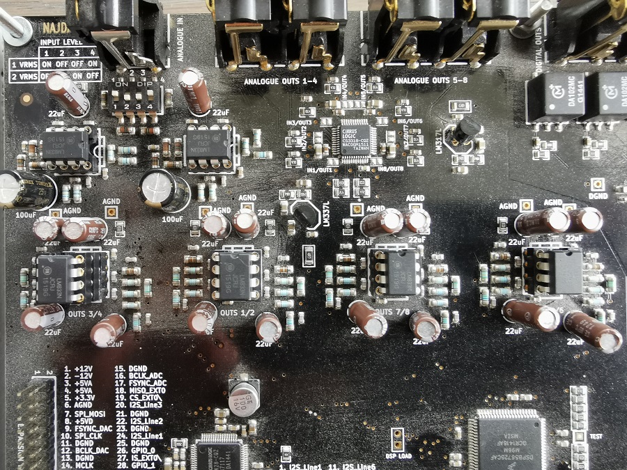

Hi.
I have problem with Najda DSP outputs 5 to 8 (there are only clicks from the speakers when i turn the volume button and low volume distorted sound when i turn the volume way up on Najda).
The problem happened when i changed the op amp for channel 5 & 6 and the opamp was not completely in socket.
I tried to change to stock configuration but the problem remains.
Is there anything i can do? All other works perfect.
Thanks.
I measure the voltage across op amps and i get 2V and 5V on the another ( the other that work the voltage is 24V). Near those not working op amps is LM317. I will try to replace it.
Is there any other part I need to pay attention to?
