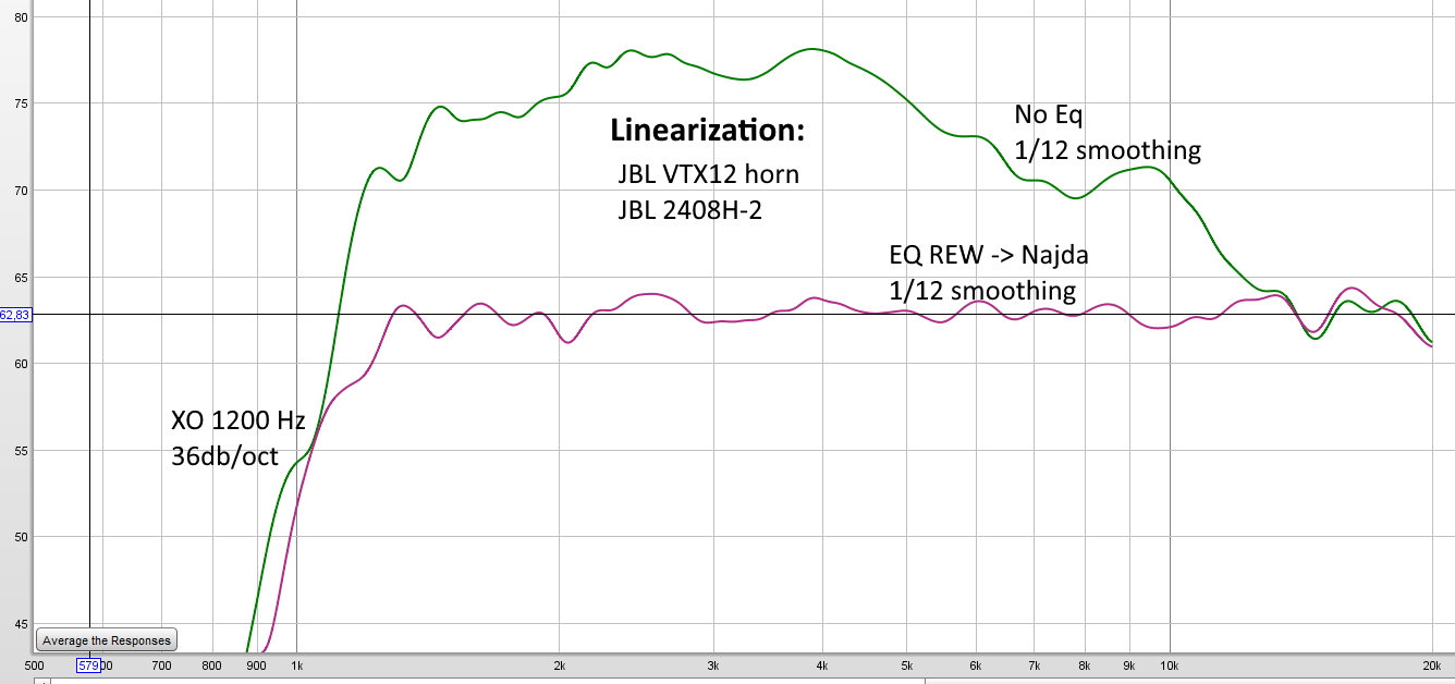

Here how I go about when I adjust Najda. I have some new JBL VTX12 horns and did this procedure last weekend. It is much faster to do if you have decided on the order for each task.
But it still takes many hour to do it properly.
I use REW for measuring and then go to the EQ tab to let REW calculate the filter. I measure each driver separately and calculate the linearization filter for them.
I defind the house curve text file:
1000 0.0
20000 -3.0 (or -6.0 or whatever you like)
You can easily alter the curve up or down. This changes the QE for the treble and hi midrange.
It is important to understand that the best direct sound curve is not a straight line but a falling curve towards the hi frequencies.
EQ Match range a little wider than the xo range. Max boost 3db and flattens 1db or 2db. I recalculate until I find "EQ filters" that I think will not overload Najda.
I then manually add the filters to Najda.
The time alignment is tricky. You can find many recipes and I must say I'm not sure am I doing it right. This is how I do it.
I measure the left speaker about 1m from. In the "Measure" screen set "Timing" -> "Use acoustic timing" reference". The right speaker will produce a reference point in time.
Measure each driver separately. Each driver is measured with a narrow Freq Range around the xo frequency. This means two measurments for mid if you have a 3-way setup. The idea is that you are interested in the sound delay (phase) where the driver is working in parallel with the other driver close to the xo frequency.
Press the "i" (Info) button in the left upper part of the main interface. Look at "IR start time". The difference between these values is the difference in time that the sound is produced by each of the drivers.
Lastly, you need to choose which driver has the longest measured delay. This driver shall have 0 delays in Najda. Then you calculate the difference for each driver compared to this driver.
When this is done I set the XO where I think that is good to start. Then I remeasure with REW and adjust xo frequency and slope until I find a good compromise.
