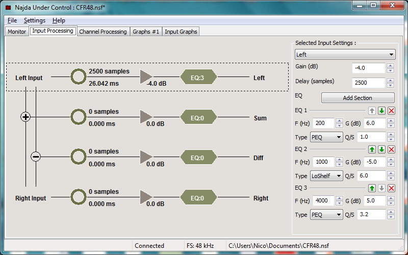

We're getting ready to release the software, so I'm posting a couple of screenshots of the IIR filtering mode (which is coming on top of the FIR Engine mode described earlier). If there's enough interest, we'll add gradually more meat into the software 😉 (How about a subtractive with Lipshitz-Vanderkoy delays? 🙂 )
Well for now it's a classic IIR. The input section:
So this is where it's all starting. The user supplies a stereo pair of inputs, and Najda transforms this pair into 4 separate signals (L, R, SUM, DIFF) with their own processing path.
In the above screenshot, only the Left channel processing path has something relevant in it (i.e. the other channels are unprocessed).
Processing begins with a 2500-sample delay (max 8191) followed by a -4 dB gain, and a set of 3 second order sections.
The second order filters that you have here are the ones that all of you have used: peaking/low shelf/high shelf. The peaking filter has of course adjustable Q factor and the shelves have adjustable slope.

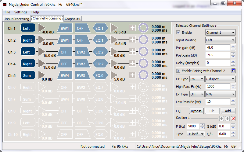

I'm often asked: How many filters per channel do I get?
Well, Najda doesn't use a fixed processing path. You can see on the screenshot above the ADD SECTION button. Click this button and the application will add a filter to the selected channel. Click this button as many times as you like, there's no limit (well we've set a limit of ten for the sake of wisdom, but we could extend this to virtually any number).
Now an important point: you might remember that the monitor tab shows the DSP load. It's the user responsibility to make sure that the processing he's devising doesn't overload the DSP. In other words, while the user is adding filters, he should check the DSP load meters and make sure they stay below 100%.
This flexibility feature allows distributing the processing power where your system needs it instead of allocating a fixed number of filters to some channels you might not even use.

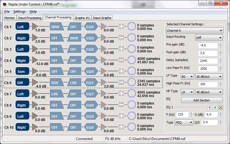

The next tab is the output processing.
On the far left, you're routing the signal. This means that you select one of the 4 processed channels we talked about earlier (Left, Right, Sum or Diff).
Routing is followed by a Pregain, then a group of 3 IIR blocks.
First block is the LowPass filter.
Second block is the HighPass filter.
Supported filters are
- Butterworth 6/12/18/24/36/48 dB/oct.
- Bessel 12/18/24/36/48 dB/oct.
- Linkwitz Riley 12/24/36/48 dB/oct.
Butterworth cut-off frequency is where the response is -3dB, as usual.
For Linkwitz-Riley, we also use the classic cut-off at -6dB.
Bessel filters are phase match - so there's no fixed dB number at cut-off. Instead, a low-pass and a high-pass with same orders and cut-off frequencies will have phases that are a multiple of 90 degrees apart at design frequency.
The cross-over design follows the same principle as the filter section I described earlier: a by-pass doesn't use processing power, and the higher the filter order, the more processing power it burns (so always check the DSP load meters!).
The crossover block is followed by the EQ block (peaking/shelves) which is identical to the one on the input processing tab.
Then you get the PostGain, the channel polarity invert and the output delay (4095 samples max).
As a quick and dirty example, here's what you can read on channel 6:
- Routing is the Diff signal
- Pregain -4dB
- Low pass F=1000 Hz Bessel 36dB/oct
- High pass F=100 Hz Linkwitz-Riley 48dB/oct
- Only 1 EQ section(it's a good driver 😉 ) which is a peaking filter with F=235Hz, 6dB gain, and Q factor 3.4.
- 3dB PostGain
- Polarity inverted (don't ask why 😛)
- 2345 samples output delay, which is 24.427 ms at 48 kHz sampling frequency.

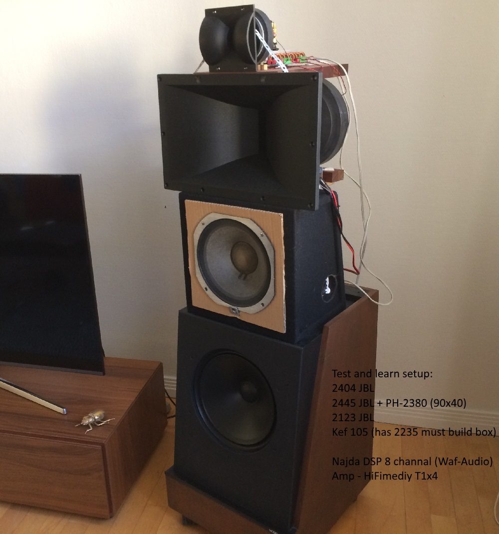

I have started to play with it...

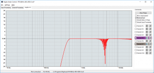

On first picture where you can see measurement of a quick three ways Linkwitz Riley 4th at 150 and 2kHz. The additional high pass curve is the one with the the CS3318 set at 6.0 Vrms. Others are outputed with the nominal output set at 1 Vrms.
Second picture is to show the board configuration where you can set the DAC interpolation filter along with the nominal output.

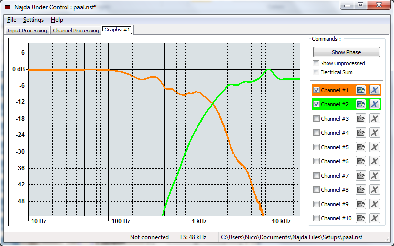

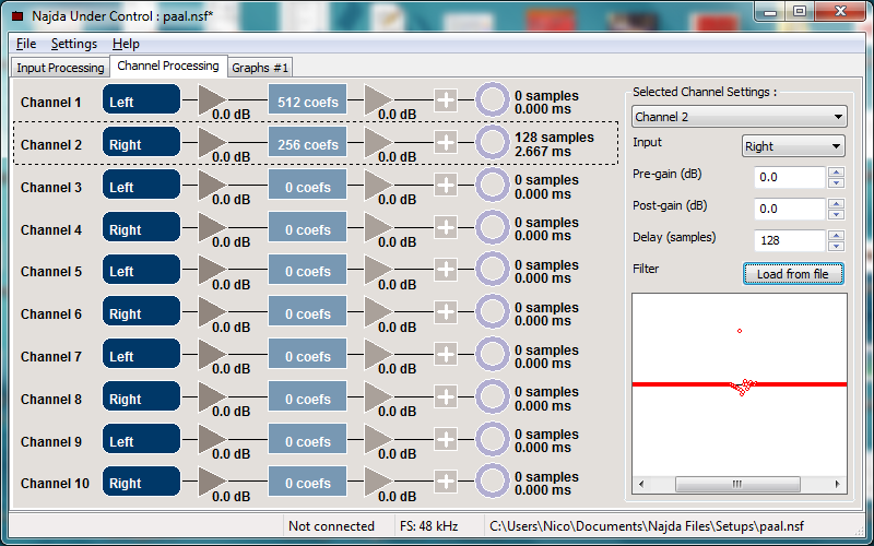

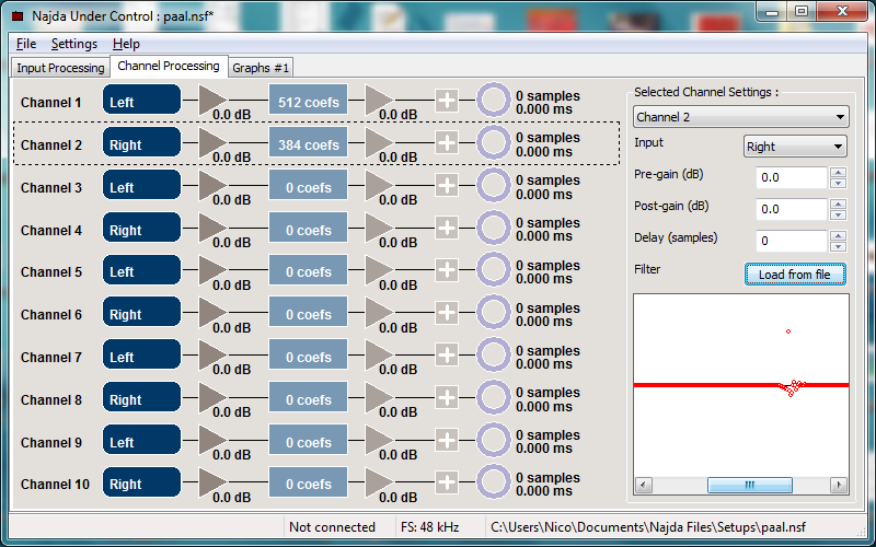

I'm just coming back quickly (!) to the FIR filters that Paal has designed. Paal sent me his coefs - I hope he won't mind if I post a few screenshots here.
So I've loaded his coefficients on Ch1 and Ch2:
One filter is 512 samples long, the other one is only 256 samples.
The design procedure for FIR filters often yields to impulse responses that extend to infinity in the past ... and in the future, with (luckily) most of the energy being at the time 0 (the impulse response appears here in red). Time 0 is the time of now.
No computer, regardless of how powerful, can compute the output of a infinitely long filter. And no computer can guess what the samples of the future are going to be.
That's right, the theoretic model requires to know what the sound was before you were born. 😕
It also requires to know in advance what the sound is going to be long after you have died. 🙄
That's why we need to approximate this infinitely long filter by windowing its impulse response - i.e. keeping only a certain number of coefs and ignore the remaining ones.
So first thing we do, we keep N points of the impulse response symmetrically about time 0. This way we have a filter that expands only approximately N/2 coefs in the past and N/2 coefs in the future.
There's still this problem that the filter needs to know samples of the future. To go around this, we 'shift' the impulse response in the past so that the future becomes the present :shhh:
The amount of shift is usually half the length of the impulse response, so for a 512-coef filter, the amount of shift is 256 samples. In clear, by shifting the filter so that we can implement it, we effectively introduce a delay of half the length of the filter.
This is why Paal introduced a delay of 128 samples on the tweeter channel. Indeed, the medium filter, by design, induces a delay of 256 samples meanwhile the tweeter filter a delay of only 128 samples. Thus Paal has time-aligned the outputs of both channels.

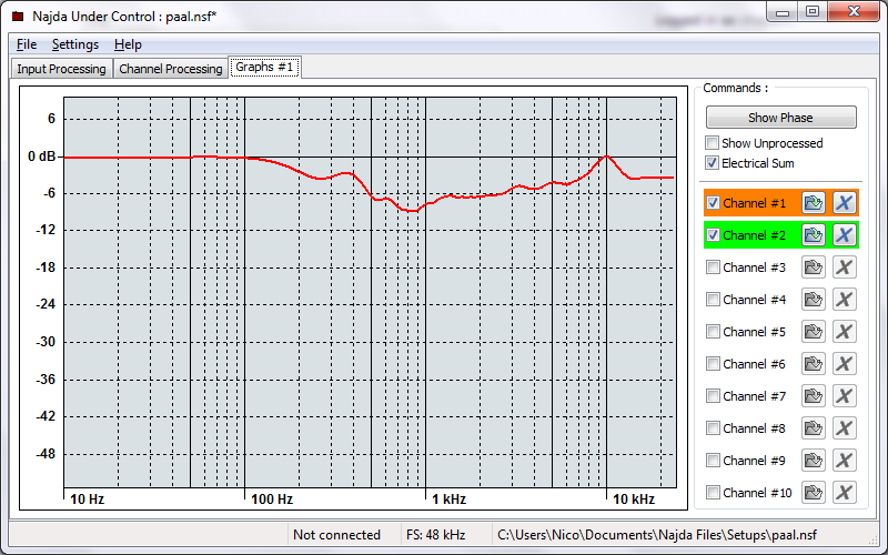

So here's what the frequency response of both filters is looking like:
As Paal explained, they combine a FIR approximation of a 4th order LR to some EQing.

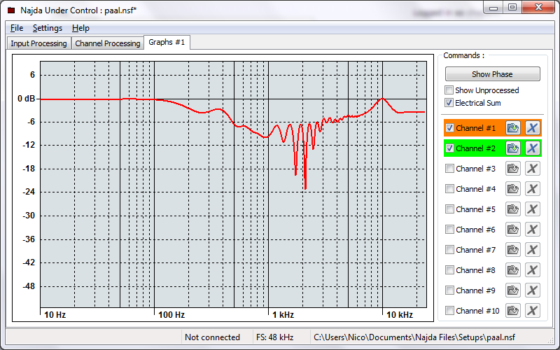

I asked Paal to show how the channels sum together. Here's what he showed:
I frowned quite a bit when I saw this. There's obviously something wrong with this crossover. Or something wrong with the graph.
The fact is, the Summing feature in the graph utility doesn't take the delay into account. So this plot shows what the sum would be if there had been no additional delay on the tweeter channel. (Rest reassured I will fix that asap).
So I cheated. I opened Paal's tweeter coef file and I inserted 128 'zeros' at the beginning of the file. These zeros act as a delay: indeed, during the first 128 samples, the modified filter ignores the incoming samples (it multiples them by the null coefs).
Finally, I reloaded the file and suppressed Paal's original delay. I had now the medium's 512-coef filter with a new tweeter 384-coef filter equivalent to Paal's original design.
Again, I checked how the channels were summing, and here's how it looks like:
Isn't it looking much better? 🙂 If there was no EQing, the channels would sum flat.

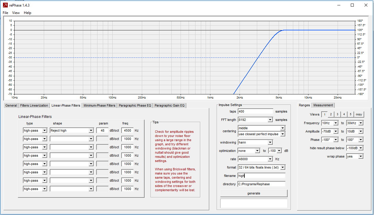

I had a look a the application you have used so far, and suggest you just try rePhase (as recommended by a few forum members):
rePhase | Free Audio & Video software downloads at SourceForge.net

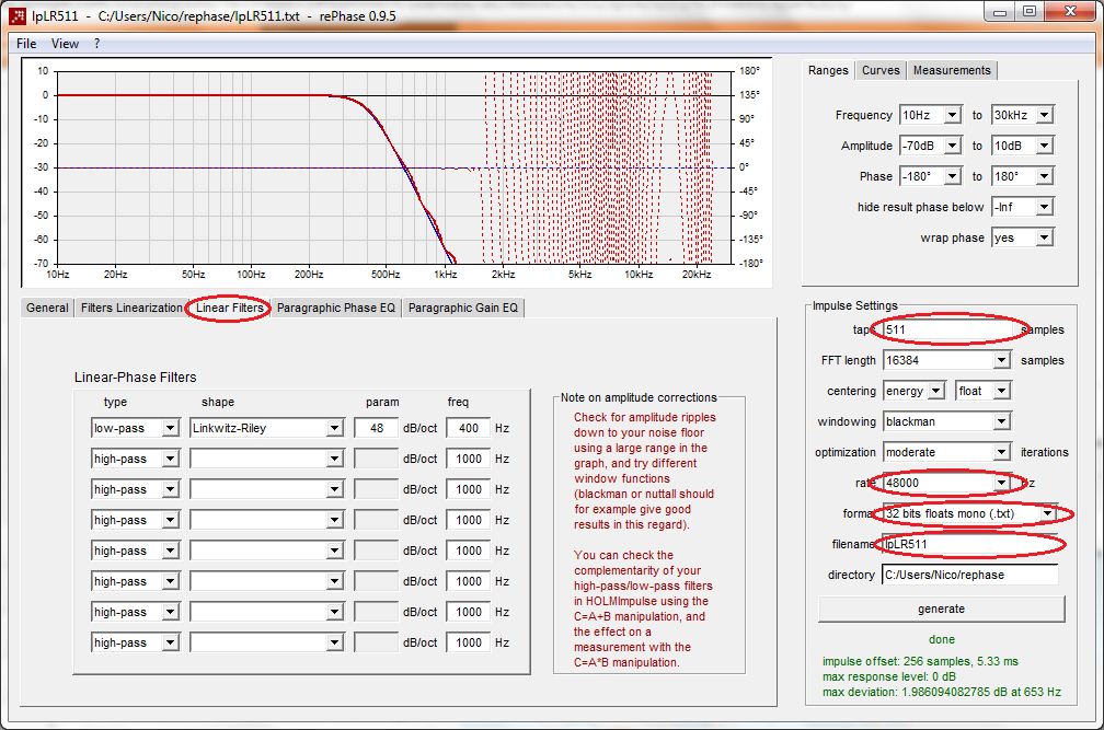

Not sure whether you need this, but here's a simple example: I want to design a 3-way FIR crossover that mimics LR 48 dB/oct. (it's just a simple example in order to illustrate, don't ask me why LR 48 dB/oct 🙂 ). I want one crossover at 400 Hz and another at 4 kHz.
So let's open rePhase and build this crossover together.
I've circled the important fields.
On the right, from top to bottom:
- The number of taps. More taps will allow you achieving a better approximation, at the expense of increased DSP load.
- The rate: select here 48 kHz (select the same in Najda).
- Format: 32-bit float txt. With this option selected, generated files are compatible with Najda.
- Filename: make sure to save your file under a proper name 🙂
On the left, select the 'Linear Filters' tab.
We generate first the low-pass coefficients. I've selected here 511 coefs, and rePhase signals a max deviation of about 2dB with regard to the LR model. Yeah why not. Let's keep it.
Now we generate the bandpass:
I've tried another number of taps (911). This time max deviation is only 0.22 dB. Fair enough.
Finally we generate the high-pass:
In the high frequencies, I know I need less taps. I've tried 121 and it seems fine, with a max deviation of 0.00...

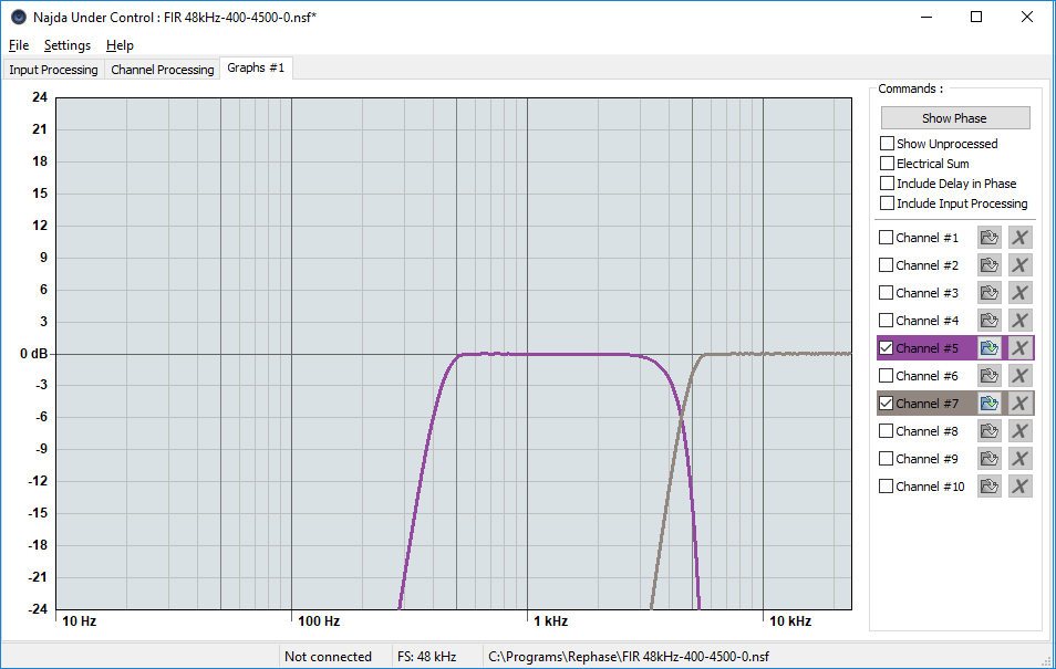

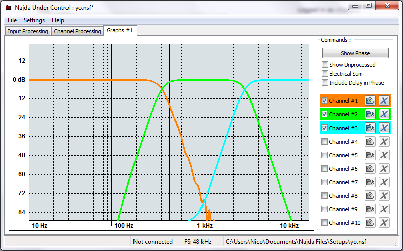

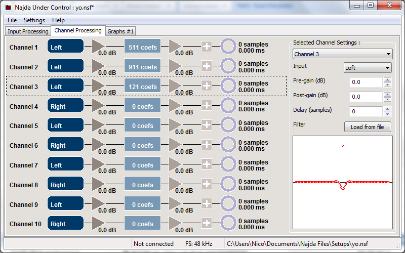

Now I can load the files in Najda Under Control:
I can check the plots in Najda:
Well it's crossing at 400 Hz and at 4 kHz, so we're happy aren't we? 🙂
What would be the sum?
Oh no! what is that??? 😡

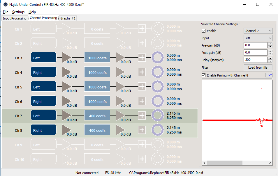

Alright, that's a time-alignment issue because filters have different lengths (= different numbers of taps).
Looking again at the 3 rePhase screenshots, we can see that:
- The low-pass has an offset of 256 samples
- The band-pass has an offset of 456 samples
- The high-pass has an offset of 61 samples.
We need to compensate for that.
The band-pass has the largest offset = largest delay. We leave it as is.
Then the low-pass requires a delay of 456-256 = 200 samples.

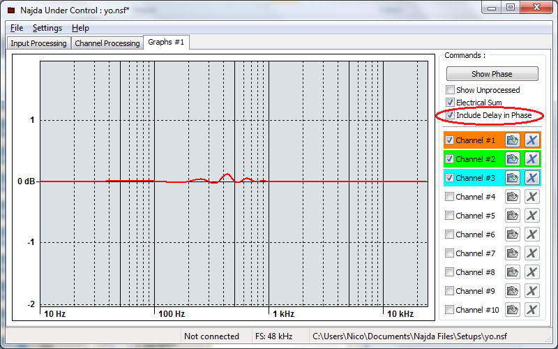

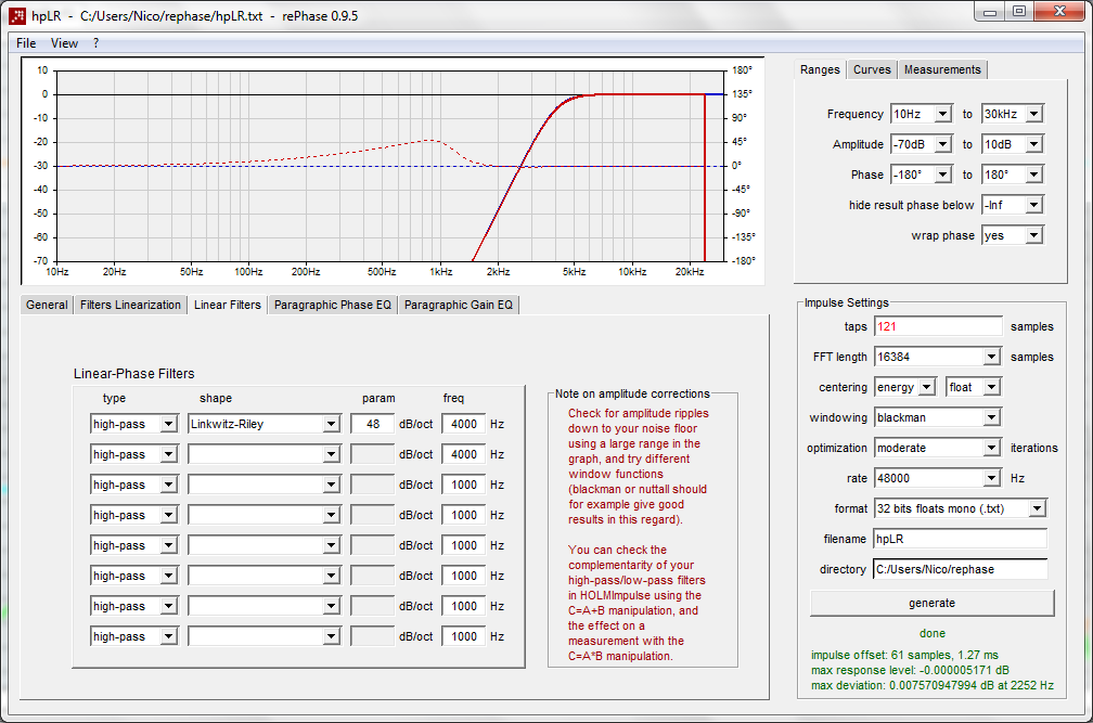

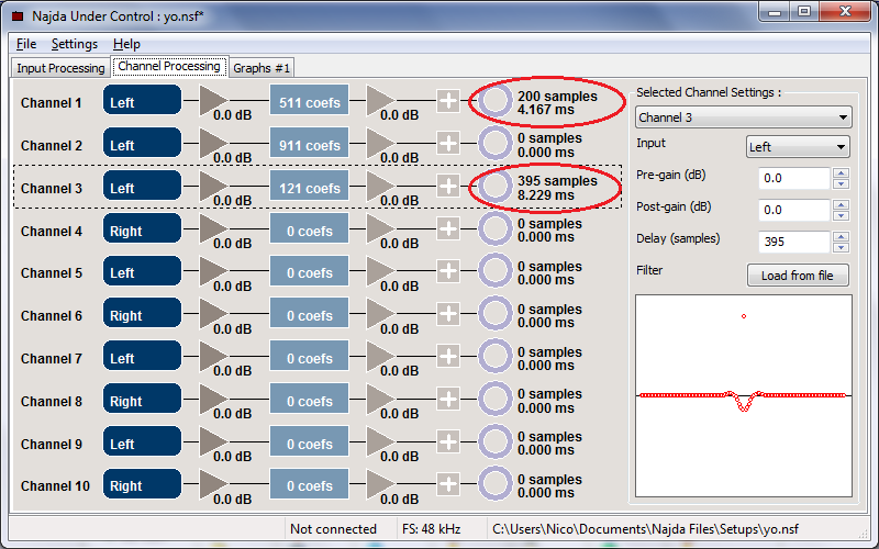

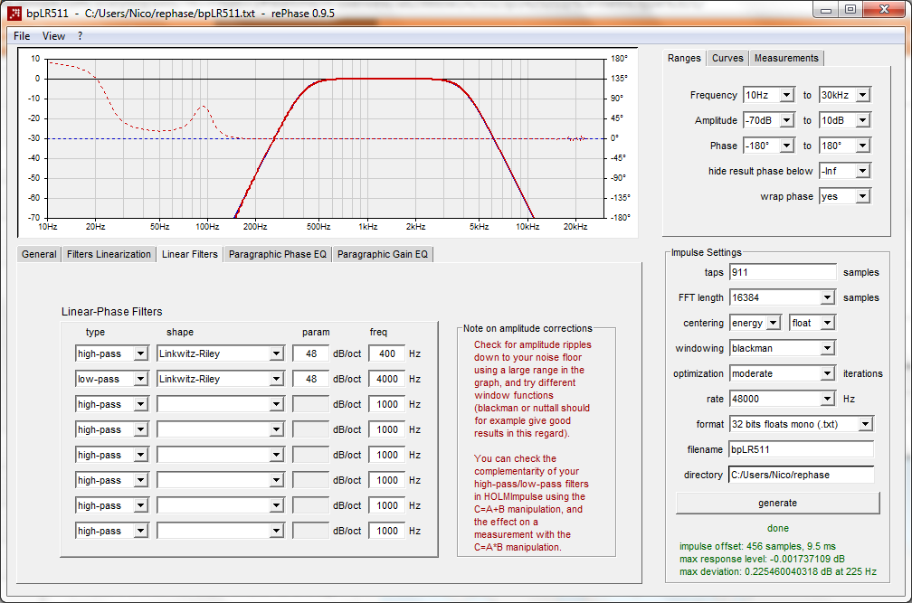

And the high-pass requires a delay of 456-61 = 395 samples.
Now we can check the sum again. Make sure to check "Include Delay in Phase".
So it's not perfectly flat because we didn't have perfect LR filters at the start.
Anyway, looking at the scale, the residual dip is quite small.
(Note:
In Najda's graph view:
- Click and drag to move the 0dB line up and down.
- Click+mouse wheel to zoom in/out
- Double click to reset the graph to original view)

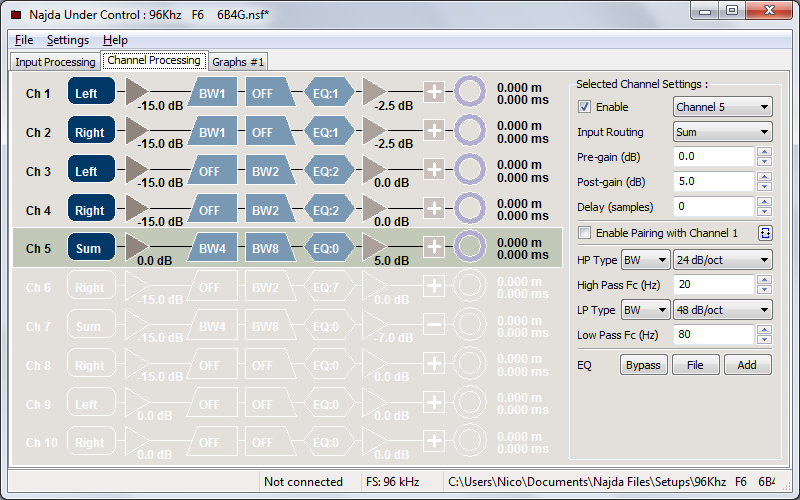

Thanks Ake. I had a look at your setup file and you have nearly 24 dB gain at 50 Hz, and it's still growing towards the lower frequencies with 33 dB at 20 Hz.
If you need so much bass boost, then you must provide a similarly large headroom. Let me try to explain this briefly (and sorry if I say things you already know):
- Digital content (via SPDIF for example) reaches the DSP at a normalized level. This means that the content will hit 0dBFS (FS stands for Full-Scale) from time to time (if you're listening to classical music) or all the time (if you're listening to modern pop or DJ stuff).
- If you add 1 dB of gain in the DSP, then this is enough in theory to clip the signal: everything beyond 0 dBFS is clipping.
- Your setup shows more than 20 dB of boost in the region F < 60 Hz: any content with bass hitting full-scale will require at least 20 dB of headroom.
I'd say you should set more than 15 dB of attenuation on the input signal if you want to keep the setup the way it is now.
There are probably ways to improve your setup.
1. The HF band doesn't need so much headroom. So you should be able to optimize the headroom for each of the frequency bands. Start by moving the input gain to the channel processing pre-gains as illustrated below (the input gain is now 0 dB).
2. Now you can increase the pre-gains in channels 1 & 2 (driving HF) until it starts clipping. A wild guess based on your filters is that you would need only -8dB of gain. This is pictured below. Note that I've moved the corresponding gain difference to the post-gain in order to keep your balance HF/LF as before.
3. You could now move the above -9.5 dB post-gain to the analogue gain section.
4. There's probably something wrong with the sub management: you set a 5 dB post-gain in the digital domain, with no prior headroom provision. This is going to clip. Easy solution: move that post-gain to the analogue gain section.

I found a difference: The electrical sum: Include Delay is not working.
LG, Rainer
Have you pushed the "show phase" button?
br
Paal

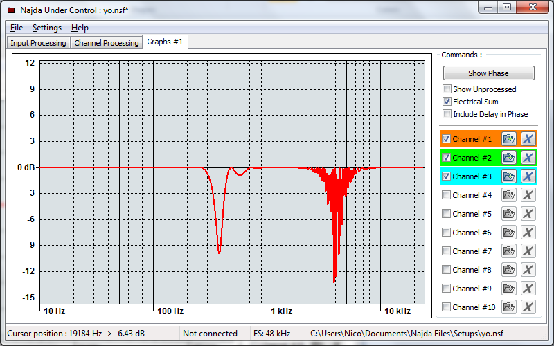

I'm trying to configure Najda with DSP filter. Doing it for 3 way system. XO points are 400 and 4500 Hz. All filters are reject high -48 dB. After importing to NUC and looking on simulated response I have strangely looking connection between mid and tweeter. I have defined delay for tweeter (difference in taps/2).
When I defined both filters with same number of taps (1000), crossover point looked pretty flat, but part from 10kHz-20kHz was really wavy. Cound you tip me what I'm doing wrong?
Your tweeter channel seems to be inverted also...
Actualy Najda doesn't know what is physical phase of the twitter. Chageing it doesn't do much for this simulation. Also enabling "include delay in phase" does nothing.
Speaker measures pretty well so I'm not if this is NUC issue or effects are too small to be visible on real measurements.
