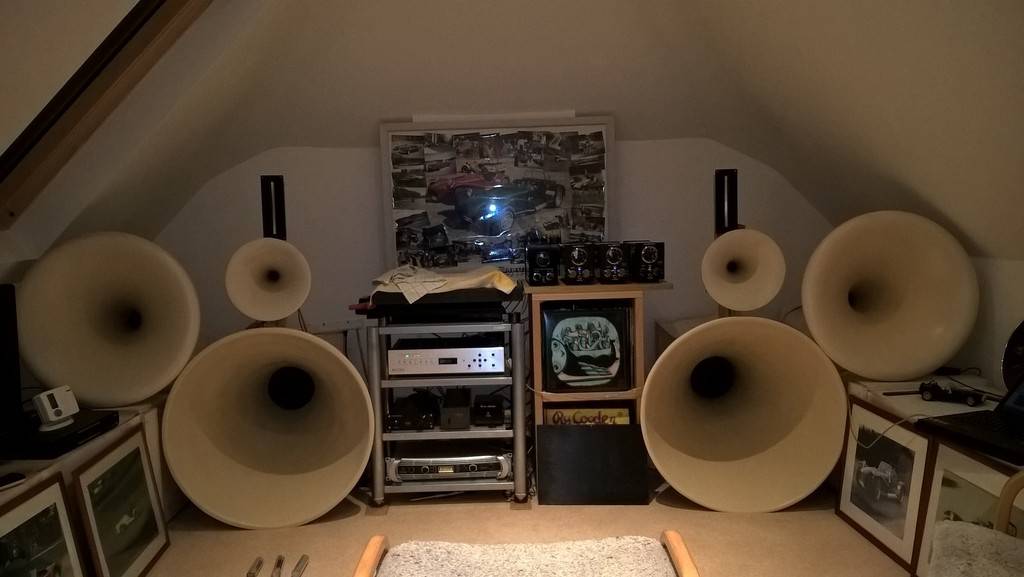

The new board arrived today :)
Many thanks to Nick and Eizof.
Rear of case only needed slight modding to take V1.03.
All plumbed in including my fav Burson op-amps, and WaveIO I2S in.
My favourite config files reloaded and all is working a treat.
Now for some tunes!
Here's my current config in my music loft.
We moved here 3 years ago now!
