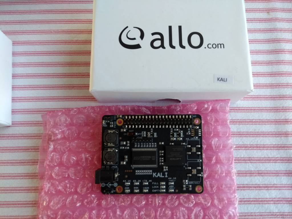

Got the Allo Kali reclocker before Christmas!
Plumbed it in as per instructions.
Made not the slightest difference to the weird instrument and vocal placement on a few tracks, or the slight left balance bias for all tracks I play.
So for now I'm abandoning RPi -> I2S! -> Najda.
I'll try it with the Hifiberry DAC and see what that sounds like and if no better, get a Allo Digi One and feed into the Spdif input!

I messed about with Kali reclocker a bit more.
It won't work with Hifiberry I2S to SPdif as Kali only talks to Slaves..
Multi armed Goddesses of time tend to be that way 🙂
I tried using Kali's master clock to the usual Najda I2S_Ext_CLK (pin 23).
No sound.
Then I tried Ext_CLK Pin 27 external clock input.
Again no sound.
Anyone ideas?
How does WaveIO do it so well?
Then I put it back on Kali's output BCLK / Najda's pin 23. That gives sound, the weird sound on a few tracks and a little off centre to the left balance..
I am feeding RPi and Kali separate 5V supplies now and it definitely sounds a lot better for it..

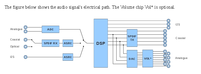

Looks like in Najda, I2S goes through the DSP function before the dac. Could it be that the DSP is somehow causing the problem? Can you change the symptoms by messing around with the DSP settings?
Also, looks like there is an ASRC between the I2S input and the DSP. The ASRC could be doing something odd. What input sample rate are you sending, 16/44?
Thanks Mark, I'm not sure about that. It's the same route in for WaveIO using I2S and that performs fine.
I've contacted Allo directly about Kali use and connections - I've referred to the Najda blurb - hope they can see what's going / not going on, where my I2S numptiness cannot. I suspect a Master / Slave clocking incompatibility.
My other option is to get a Allo Digione or Signature and go in the SPdif route (= defeat). I've heard the Digione working just fine on Najda with a friends RPi and Allo Digione..
