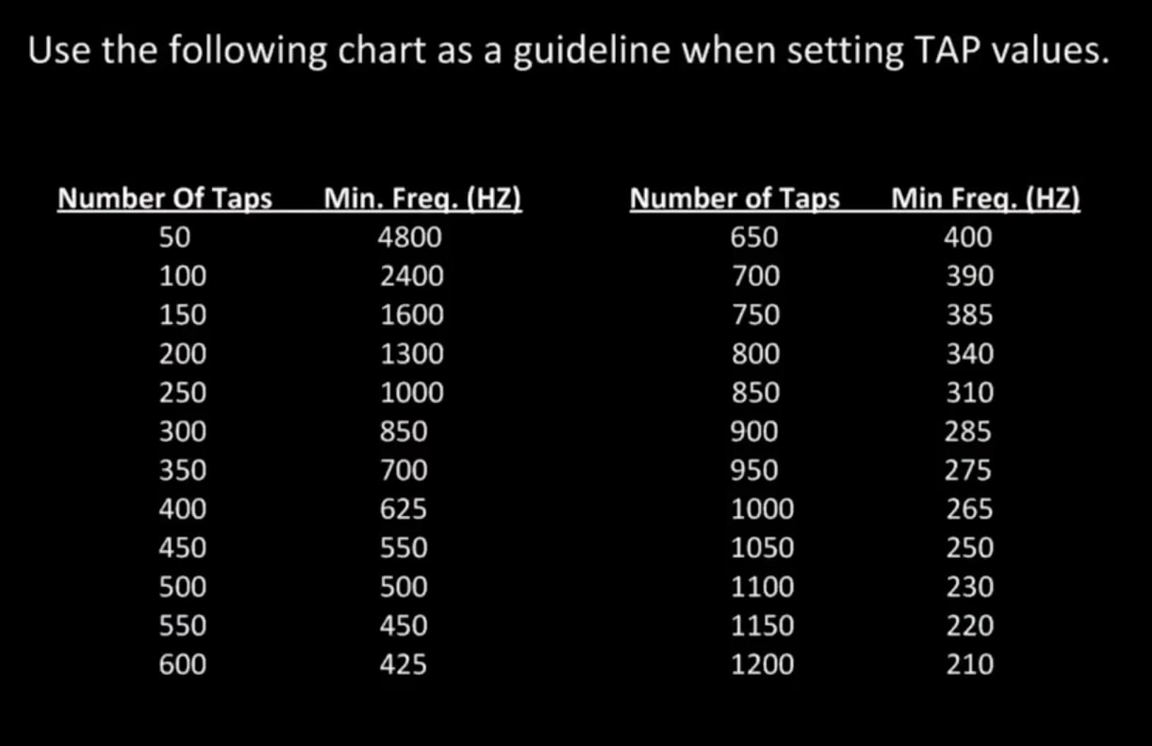

Still trying to get my head around FIR filters. The number of taps one can devote to each channel seems to be a contentious issue. I understand more is better, especially for the lower frequencies. But I don't recall seeing anybody quote any actual numbers.
However, I found this guide while I was looking at a video on Xilica DSPs. Here's what they recommend when setting up filters on their boxes. I believe they have 1200 taps available on each output channel.
What do you guys think of these figures as a guide? Screen grab attached.
(Their chart only goes down to 210Hz. I guess in the subwoofer range you'd just be allocating the max no. of taps?)

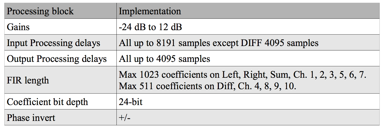

Hello,
I want to use Acourate with my Najda for generate FIR files to:
- digital crossover
- linearizing each driver
- performing a room correction
Has anyone ever used Najda's input Acourate FIR files? Are they compatible? Is the number of tap in Najda sufficient for a 3-way system?
noun ouches
FIR taps in Najda are very limited, only 1023 on most channels. Most Acourate filters would be set at 65536.
It is the lowest frequencies that suffer the most as you need a lot of taps at low frequency to get an accurate slope match.
attachment.php
To get the most out of Acourate a computer running multichannel convolution is a better solution.

All the hardware solutions available with FIR capabilities are limited in processing power and don't really have enough taps to do what you want without compromise.
I think the better method is to use IIR crossovers and EQ to get you close to what you want and then use FIR for a final overall EQ and time correction.
The DAC in the Najda is very good and the analogue volume control isn't something I would want to lose. Leave the Najda on the end of the chain and put the Open DRC / minisharc or whatever in front of the Najda and connected digitally to process the incoming stereo signal. It doesn't matter which order the processing goes in as long as the measurement is taken with the same setup. Try that first and see if it works for you.
