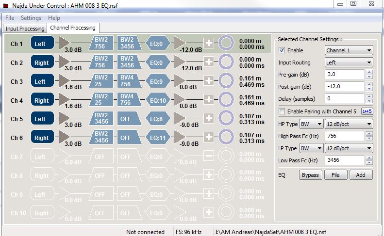

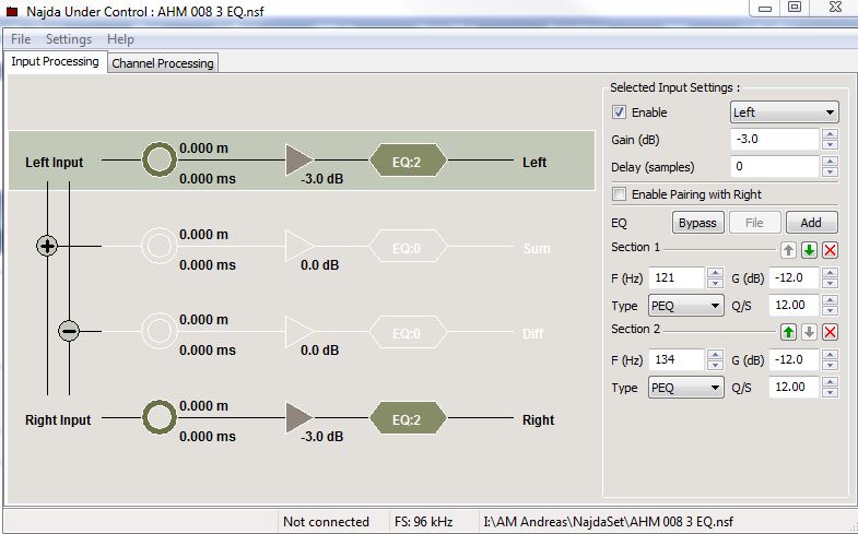

I have set all levels when measuring in my system with ARTA (pink noise), setting the Input on -3dB and a high pass filter, see images. Low / Bass is the reference - see 0dB after EQ-processing - and Mid / High are adjust to this reference. There is no overdrive of my amplifiers and I use the Anaview ALC 0180 for Bass (99dB sensitivity) and tube amps with low gain stage for Mid / High.

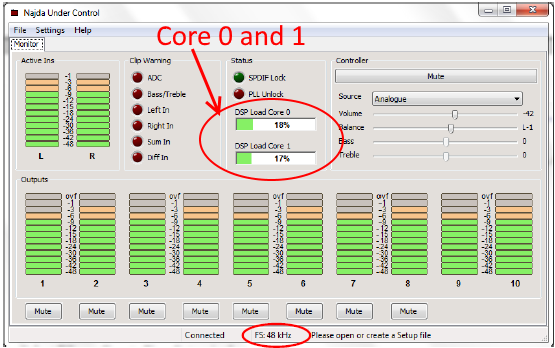

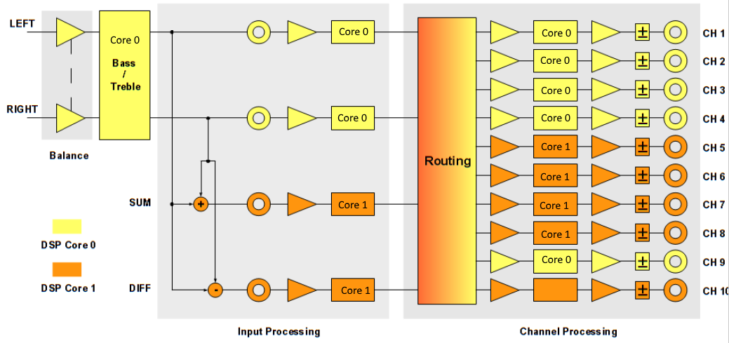

Core load
There are many things to consider when setting up Najda. I hope this will help to understand the Core load.
The Core load can be seen at the Monitor screen when Najda is on line.

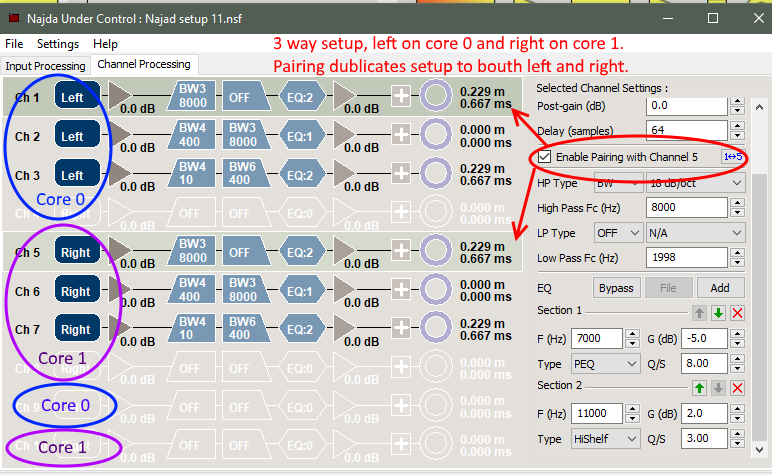

Core 0 and 1 can be loaded to prosess different parts of the setup. See my 3 way setup .
There is a risk that you overload Core 0 if you don't rout them as I have done.
Pairing helps you so that you can alter your EQ etc. on right and left channels at the same time.
