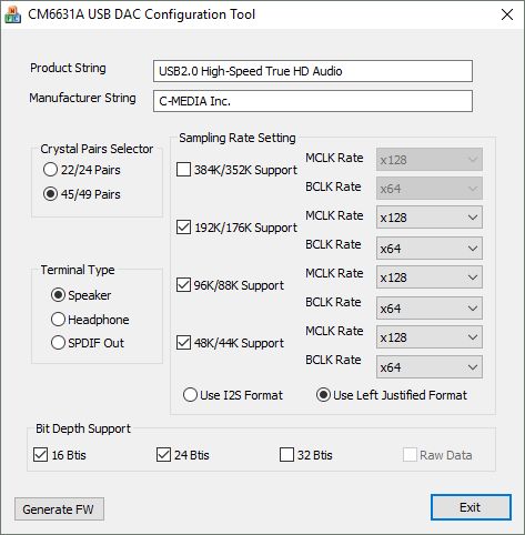

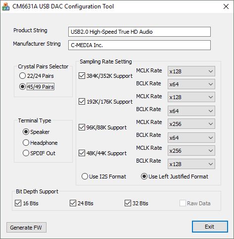

CM6631A USB to I2S issue
Hi Guys,
I am builing 3rd NAJDA setup and using USB to I2S for the first time. I am using LJM CM6631A module from eBay. Unfortunatelly, the NAJDA shows only LEFT channel inputing and no audio from the right channel. I checked the wiring and signals using the scope and all is OK. Any idea what to look for?
I found this Configuration tool for the CM6631A, but not sure if it can help me to reconfigure the board to work with NAJDA. Any hint?

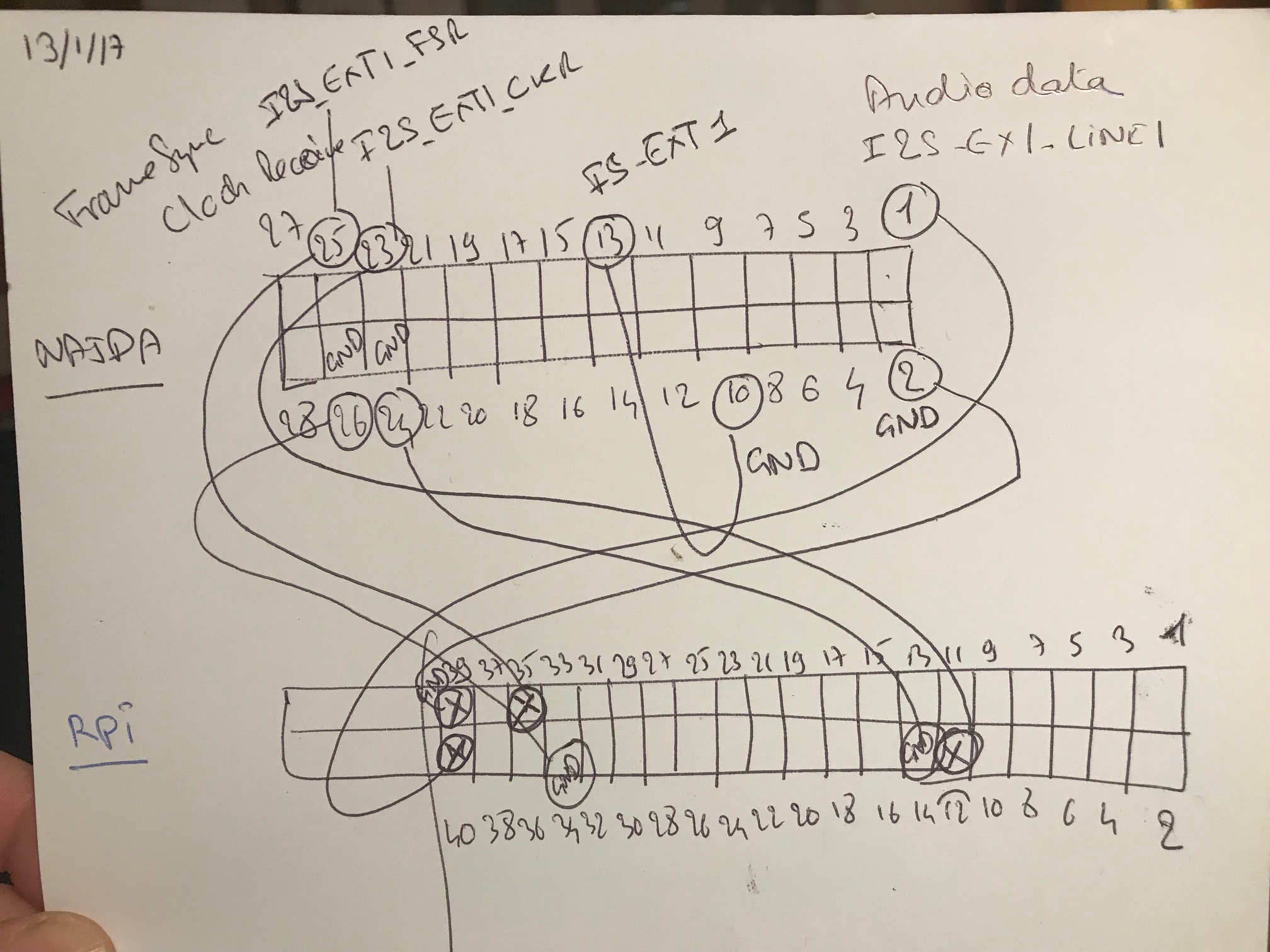

RPI to Najda I2S
Hi 30m20
Actually, the most difficult was to find out my stock of female female dupont cables that I lost after moving a year ago 😡. I just could find a few 25 cm long. Hopefully I had the headers at hand.
The connection drawing is attached, for a RPI B+ to Expansion Port (sorry it is a rough draft).
The only precaution I took were
- use one digital ground per signal line
- twist the two cables together
As it was working flawlessly, I even left my RPI in my Najda case with that temporary setup and was surprised not to hear any additional noise on my high efficiency setup. I dont have measures though. Someone here told me that I could try to put 100R resistors in serie to improve impedance matching but It was after my build and have not tried yet. I2S and digital signal path - in-line resistors?
BR
Jean-Louis
I2S Connection RPI - Najda
@JLOP: Bonsoir...
...bought 25cm connectors, wired everything (twisted each pair 8 times) as shown in Your drawing, confirmed this in the Najda manual and RPI2 pinout description (same as B+), controlled the whole thing several times - but no music.🙁
Najda input selector shows "Ext 1", that´s alright.
I tried each possible "I2S driver" setting in Volumio, including "generic" and "RPi DAC" - for sure rebooting every time after a change - no music.😡
(S/PDIF is working flawlessly all the time)
Do You have any advice, what could go wrong besides the described settings?😕
Are Dupont cables a "must" - I used an available alternative?😕
Merci

Hi 30m20
I dont think câbles might be a problem if you checked continuity & shorts. No red error message in Volumio ? I am using the generic I2S DAC, no resampling or whatever, volume control no mixer . Sure Najda or Volumio not muted 😕? And use expansion port 1 of course, my drawing is from top view. And check « Source Exp1 (I2S) is available only if pin IS_EXT1\ is tied to DGND » as stated in my drawing.
Make sure you use startup procedure as stated in Volumio startup
