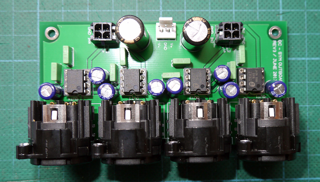

xlr-board, crlc board
Somebody want to buy my xlr-out boards and crlc-board for najda, since I dont get to use after going passive. Never used, not testet. Picture is the user I bought the pcb's from. Can sent photo pm.
I have smps never used a well.

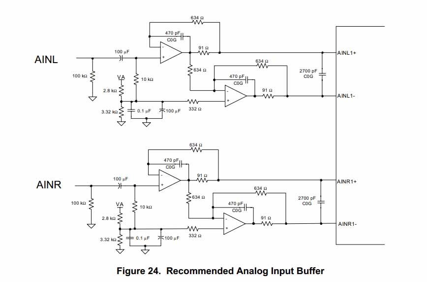

I wonder how many uF is needed to get a straight frekvensy down to about 20Hz??The MKP´s I used are 2,2 µF, the reduced capacity does´nt matter, only in the low-bass-way you have to lift the output-gain at approximately 3 db.🙂
Rainair
Here the inputbuffer from the data sheet of the ADC,theres only one elyt/channel.Seems there are an input impedance of 10K.

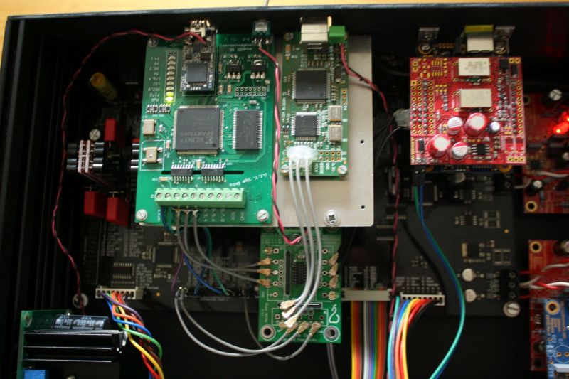

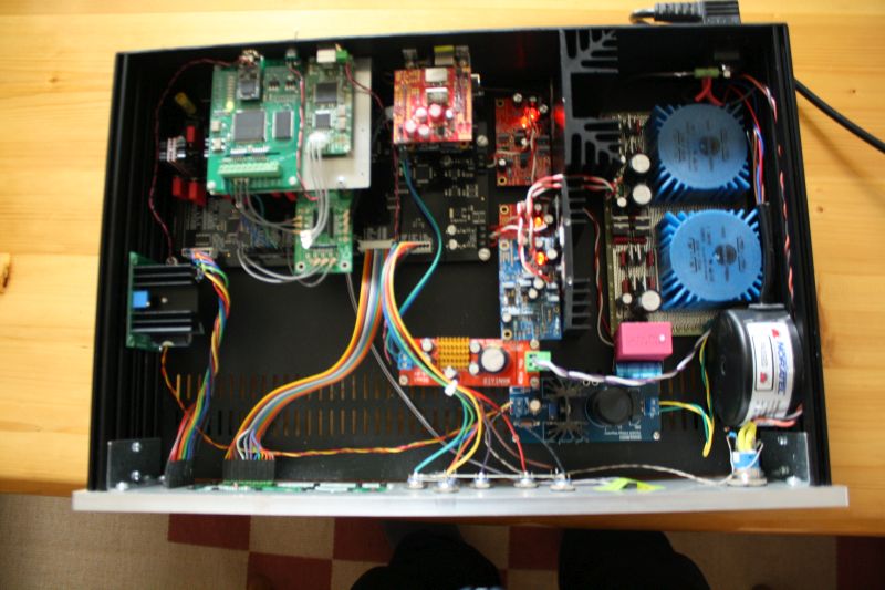

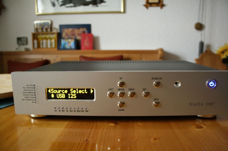

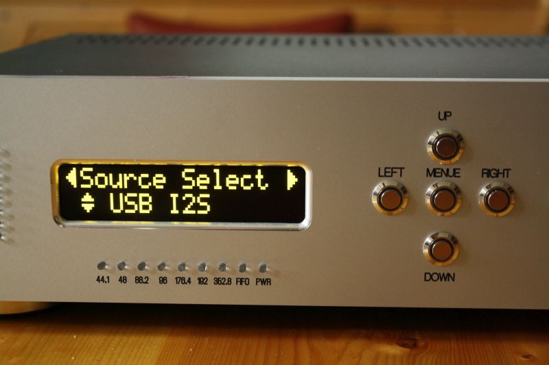

Highend Najda
If somebody is interested in a complete finished Najda with:
1. All ultra linear power supplies from Sjöström ( -+ 12V, 5V)
2. Linear PS for Exa U2I USB-I2S Converter
3. Linear PS for JLSounds USB-I2S Converter with isolation and clock Board with Crystek ultra Löw Phase Noise Oscillator
4. The 2 USB converters can be switched from one to another from the rear
5. Big Oled front Display
6. Amanero USB-I2S is also installed, can be used instead of JLSounds converter
7. Apple remote controller
For those interested send me a PM and I will provide photos from inside and outside.
Best regards
Sigi

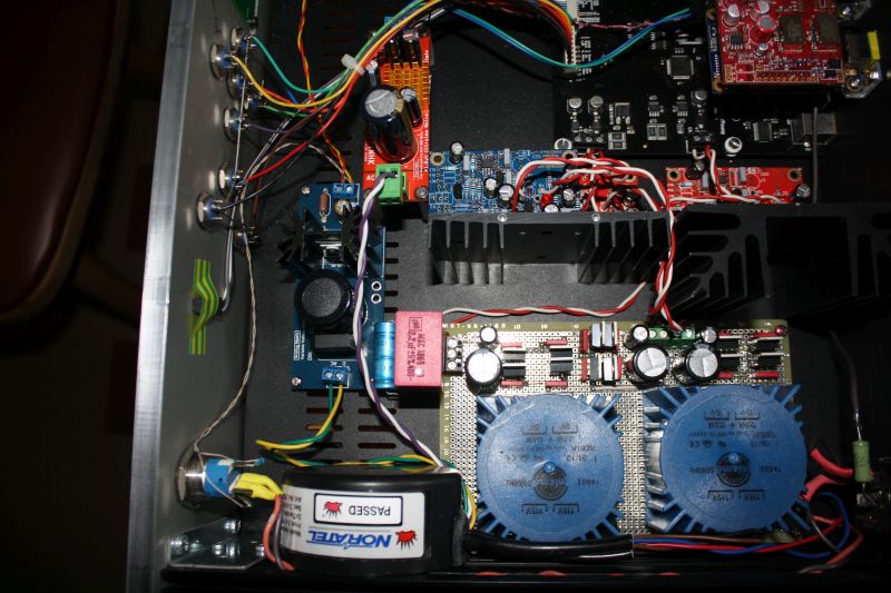

Highend Najda
Best regards
Sigi
Best regards
Sigi
I forgot to mention that the electrolytic caps were replaced by MKPs and 3 OPAMPs by BURSONs based on FET and Transistor amplifiers!Hi,
Best regards
Sigi
Best regards
Sigi
