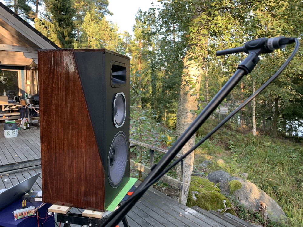

A strange thing is this: My speakers have a response nearly absolutely equal - measured using the analog input. Hearing music afterwards via digital input (coaxial S/P-DIF), I need to shift balance 2dB to the right.
Speedysteve7 had a similar theme a while ago but blamed it on the raspberry (connected via I2S!) or volumio, if I remember well.
