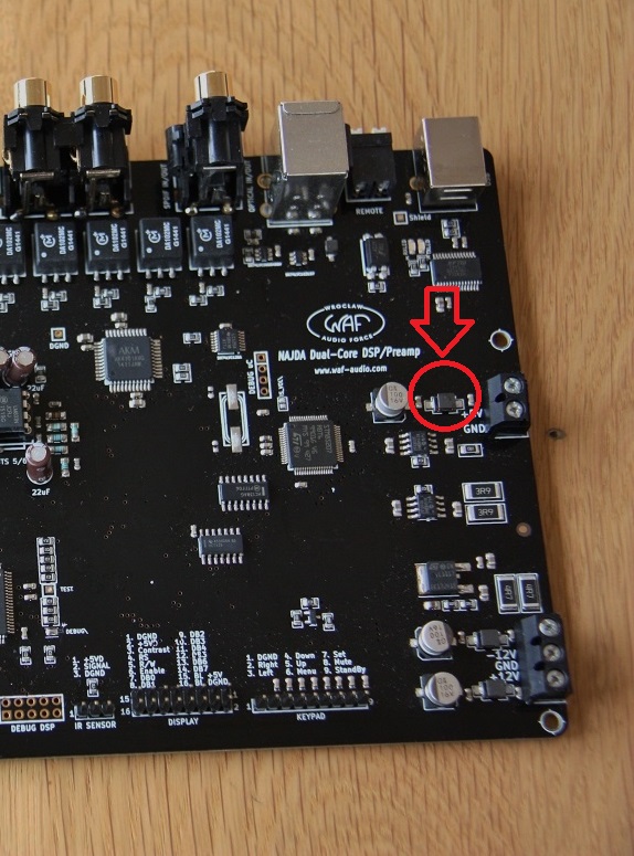

The 5v polarity was switched inadvertently [emoji30]
Perhaps one good board could be made out of them both?
I have a new board and a spare one in case that dies [emoji6]
Did the same with 12V some time ago. Only inductor close to connector broke (it's kind of fail safe/fuse). I have replaced it and board worked fine.I've got a Najda board that half powers up.
Perhaps one good board could be made out of them both? You can also check those two close to 12V connector.
[emoji6]
Check one from the attachment.
Info from charpaK recieved then
"This small inductor is rated for roughly 0.4 A and will fry if the current exceeds that value - typically a short circuit - so it acts also as a fuse.
Not a big problem! Replacing that part will fix the issue."
This is one I have used as replacement
LQH43MN220K03L MURATA
Inductor: wire; SMD; 1812; 22uH; 320mA; 0.94Ω; ±10%; 4.5x3.2x2.6mm
