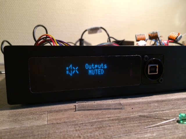

Hmm. it updated the firmware, but now it doesn´t register in the Windows environment at all.
Yes - its a black board.
I didn´t connect the display yet, as I have a VFD so I thought it wouldn´t do much anyway until I had configured the board to use it.
Seems it could have been a power supply issue. At least it worked well once I changed to a switched power supply for the 5V. Thanks Nick for assisting!
Here´s how the VFD looks behind 3mm acrylic. Now, it looks dirty because of the protection film, but I think it will look really nice once it´s off. 🙂

Hello MellowFellow,
thank you for the compliment! The frontpanel is made by " frontplatten designer "
Schaeffer AG: Home in Germany. You make your design, they make the frontpanel.
It is not a mass- manufactured piece, you see my name on the panel. Inside i changed the couple elkos and the Opamps. It is not really necessary i think. The NAJDA ist a fine piece.
Thanks a lot for the compliment
Ulf
