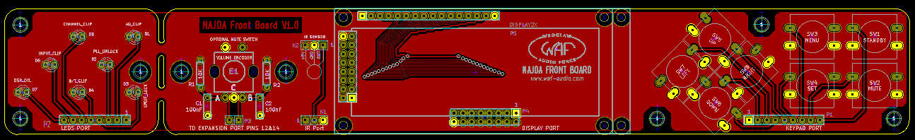

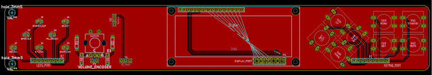

I'm looking at designing a front board that would support all the bits required to operate the Najda: buttons, leds, IR sensor, rotary encoder and display.
If there's interest for such a board, we can discuss the details here.
As usual when we design something for more than one person, we need to make compromises - that's the hard thing about it.
I've attached a sketch of what this PCB could look like. Don't pay too much attention to the details, it's just a sketch.
Leds would be the standard type 3mm pitch.
Buttons would also be standard 10mm x 10mm.
Only one encoder type would be supported (Bourns, with optional center button for Mute).
IR sensor to be decided.
2 display pinouts could be supported in order to cater various types of displays.
The board would come with all the required cables if necessary.
In the sketch, the PCB is 40 mm high so that it can fit in a 1U case. I could even make it a little shorter, about 35 mm, so that it fits in those 1U cases that have less space available inside. This however forces us to use a regular size display (the larger ones don't fit in a 1U case).
Thoughts?
Nick

Hi Mike,
Thanks for your enthusiasm
The front board is only in a pre-development stage, it's time to discuss about what it should look like (in particular whether we want it to fit in a 1U case). I don't believe this is going to be ready before July unless we quickly find a consensus (which is not likely ).
Your Najda has already shipped, please see your mailbox for the tracking number.
All the best,
Nick
Thoughts?
Nick
Hi Nick,
This was interesting
How about making some weak Points so we can break it in two or Three?
best,
Paal

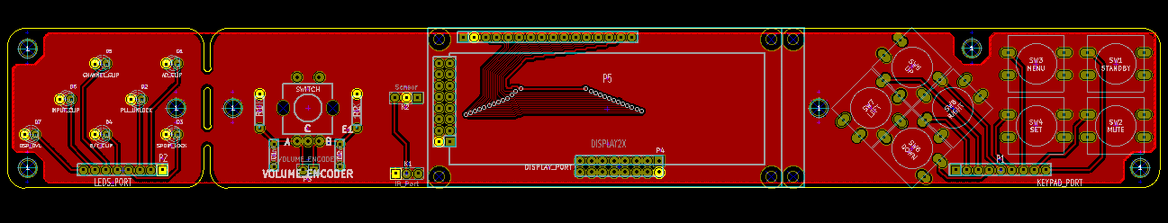

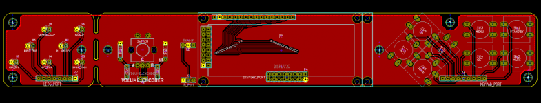

Some progress on the front board:
- It's now 36 mm high so it should easily fit in any 1U case. 36 mm is actually the height of standard displays.
- Compatible with 2 types of displays (the ones that have the connector on top 80 x 36 mm, and the ones that have the connector on the side 85 x 36 mm).
- The led section can be separated
I think I have now a front board layout that could be final.
I've seen rotary encoders that have a central push-button, could be used as a mute switch. If such an encoder is used, then the original mute switch in the lower right corner is redundant and should be left unmounted.
Great idea - save all that point to point wiring.
