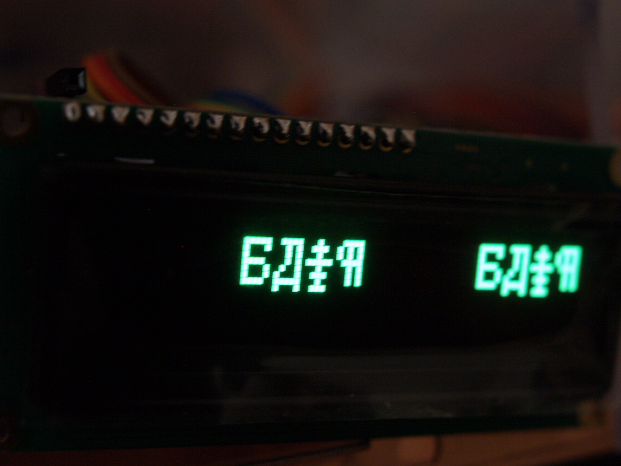

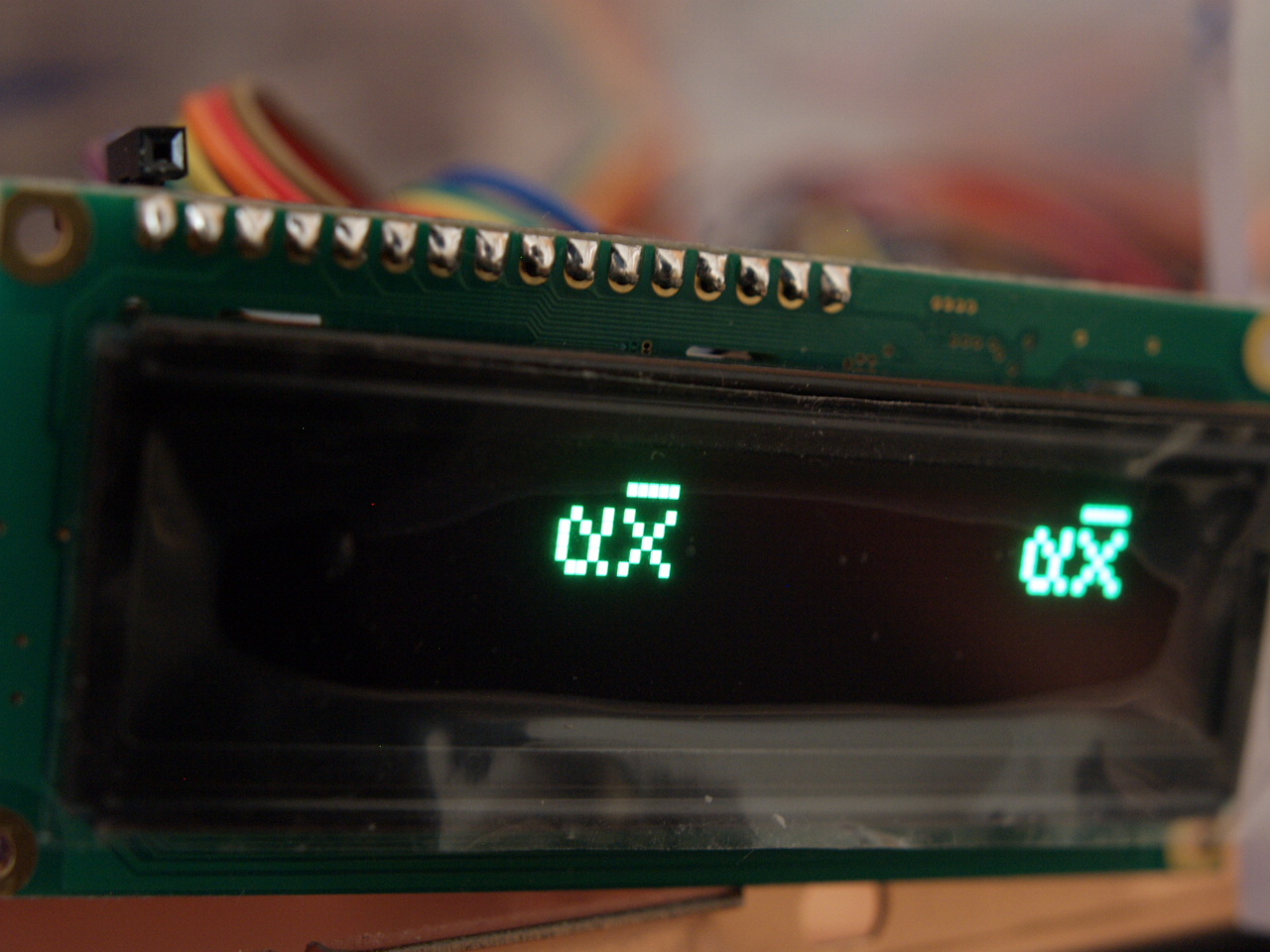

I did the disconnections but no change. Tried again later, and though I touched nothing, now there is life - sort of. Any ideas?
Off shown in the first photo.
On in the second photo;

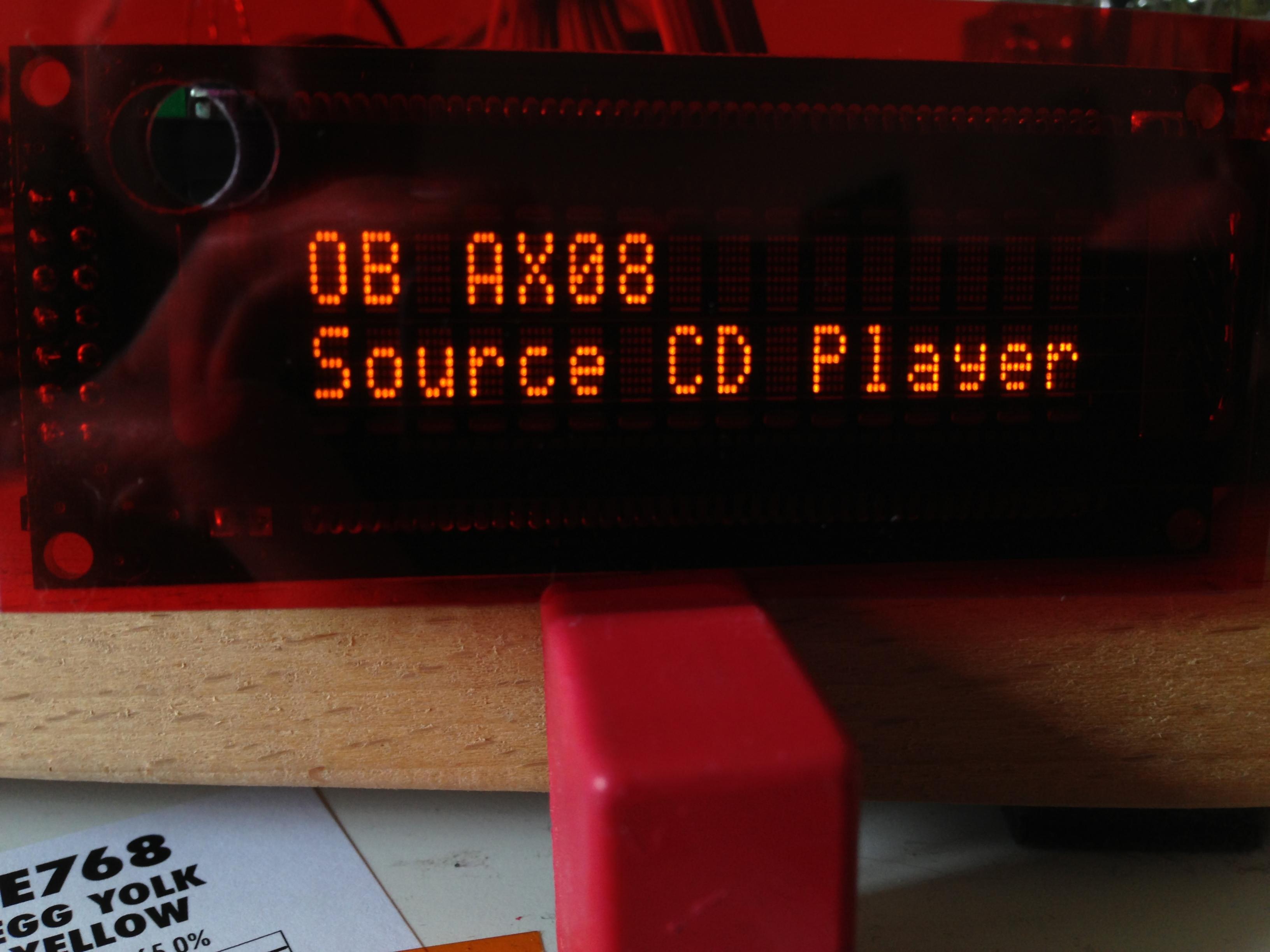

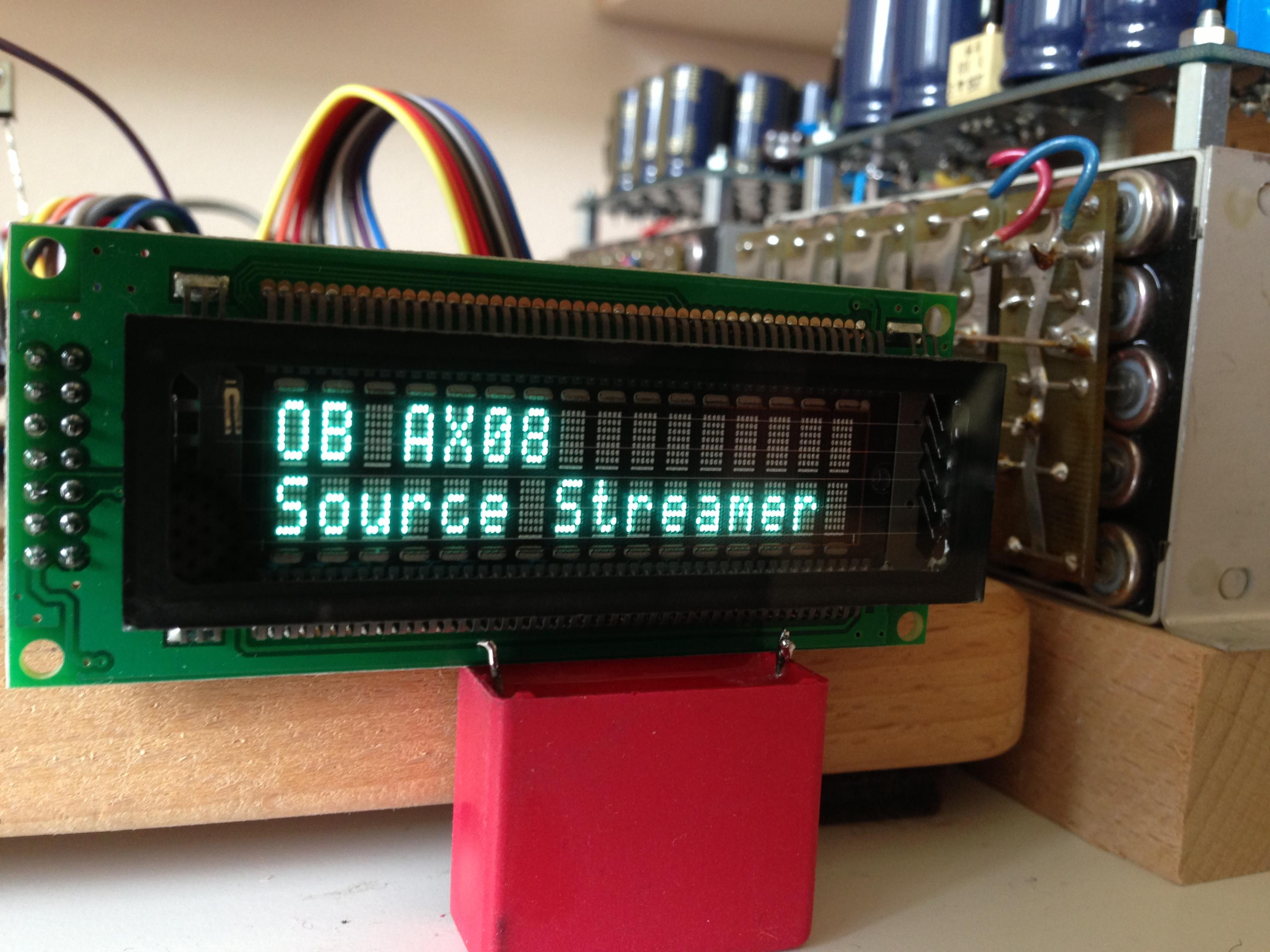

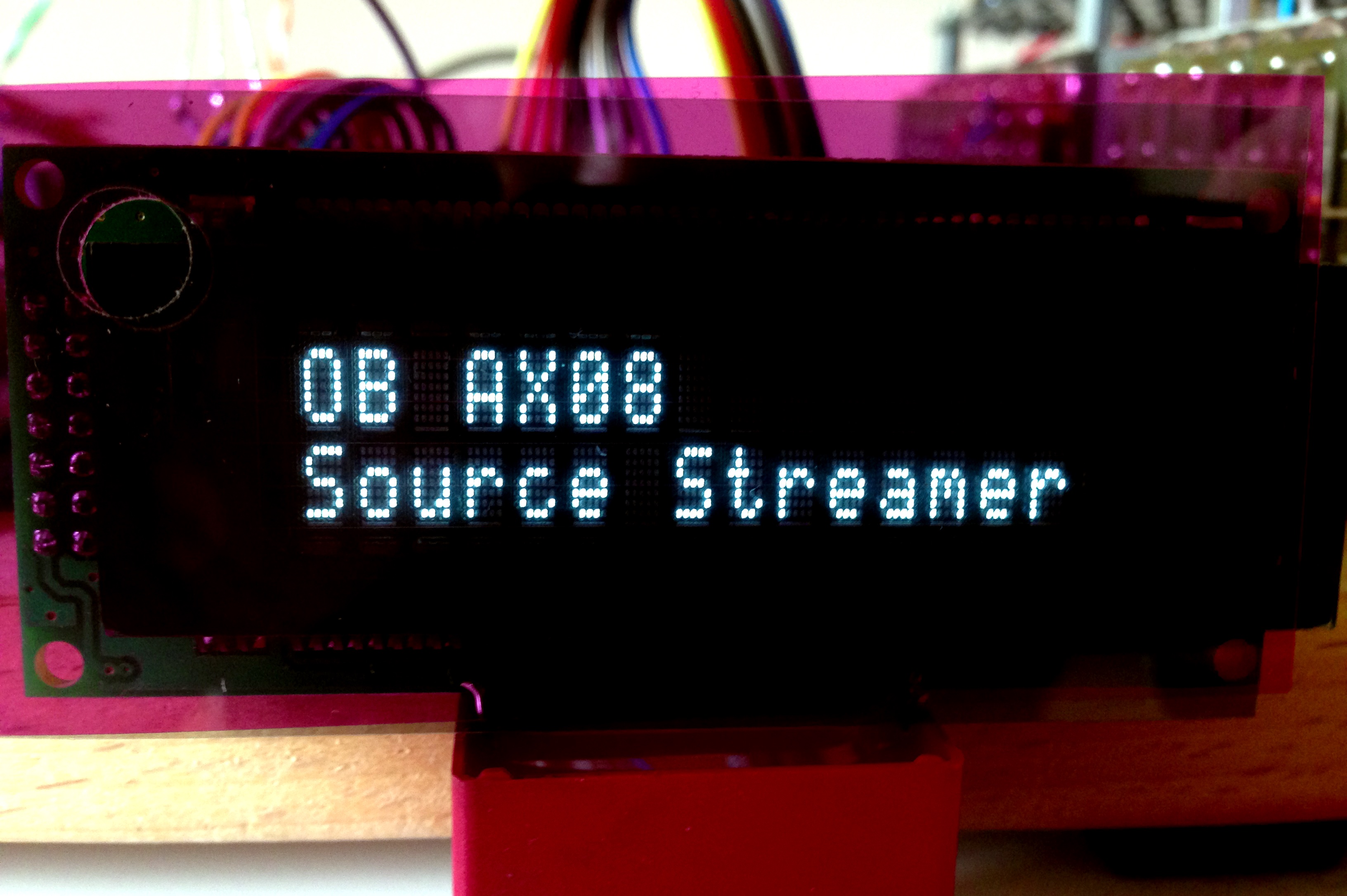

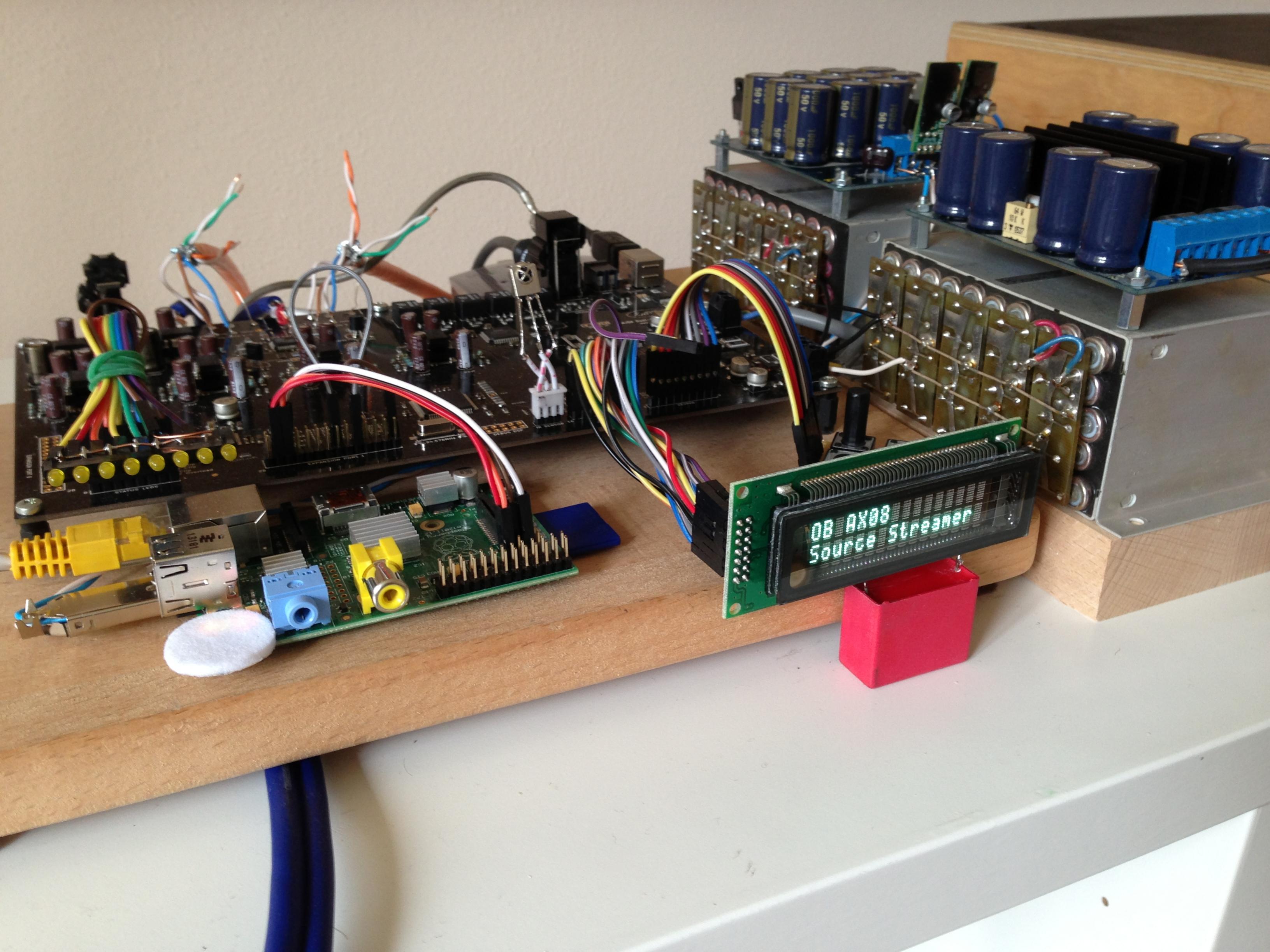

Hi all,
got the VFD going - thanks for working it out Nick!
Very nice and works like a charm! Played with some filters in front of it. Now if it only would be a tad bigger …
(The phone camera cannot really capture the contrast).

Looking good! Do you have very sensitive speakers? Because I can hardly hear it at all when I switch to standby. I use an Apple remote too btw, I use that button for standby. It works, but I have to double click to turn it on (single is enough for standby). I think it's been mentioned as a known issue though.

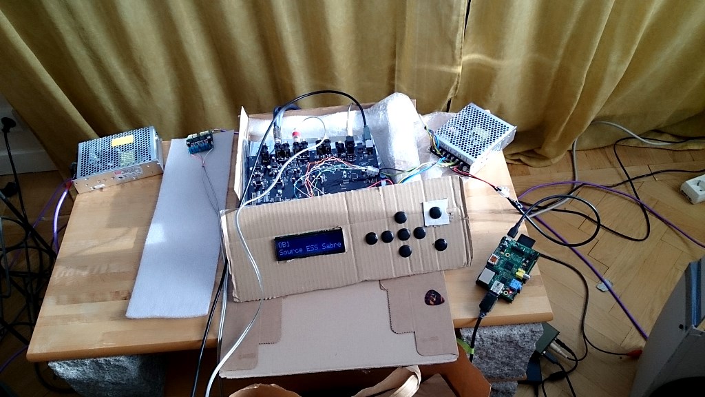

Here's an update from my own mess, I mean build 🙂
My display has arrived and works great. Went for a fairly big one, works well. Also got my buttons and mounted it all up on cardboard for now. In my final build only a standby and mute button will be visible and the rest hidden, since I will mostly use the remote (like, 99% of the time).
I have made a cable to power my Raspberry Pi from the Najda PSU (cut a USB A to micro B cable in two and measured where I had 5V then connected it up basically), I have also soldered pins to the Raspberry for I2S out. Still need to solder a header on the Najda for the inputs, so still using the HifiMeDiy DAC for USB-> Coax SP/DIF. A filtered IEC socket with cables is ready for the PSU, but not yet connected. I've also started making signal cables for connecting the Najda to the amps, which are to be mounted at the speakers.
My Sony receiver is back on PC duty and my full rangers are driven by the tiny amp seen on the left next to its' much bigger PSU. It's a TPA3116 based module built by hiamplifier here on the forum, not had it long but first impressions are good.
What display are you using? Is the brightness adjust working?
Looking forward to the final build (in a decent case 😉 )!
Yes, mids around 95db and highs peak at 105db, and amps are rather sensitive as well, so it's a clear, loud plopp. I can even hear the resistors switching in the ladder while changing volume!

Looking at your pic, I can see that the RCA connectors are missing. How do you get your sound from the Najda? Through the SPDIF ports or I2S?
Because indeed, if you use the analogue outs, then the pop should be minimal (i.e. nearly nonexistent).
Connectors are missing, but analog out is used by directly soldered cables ...

Yes, this is how it should be - but I suspect Abel doesn't use the onboard analogue outs. To be confirmed.
Analog it is …
Phantastic Photos, now i understand!!!

It's the one from the polish vendor from the link you've provided. Can't see any option to adjust it - did I miss that?

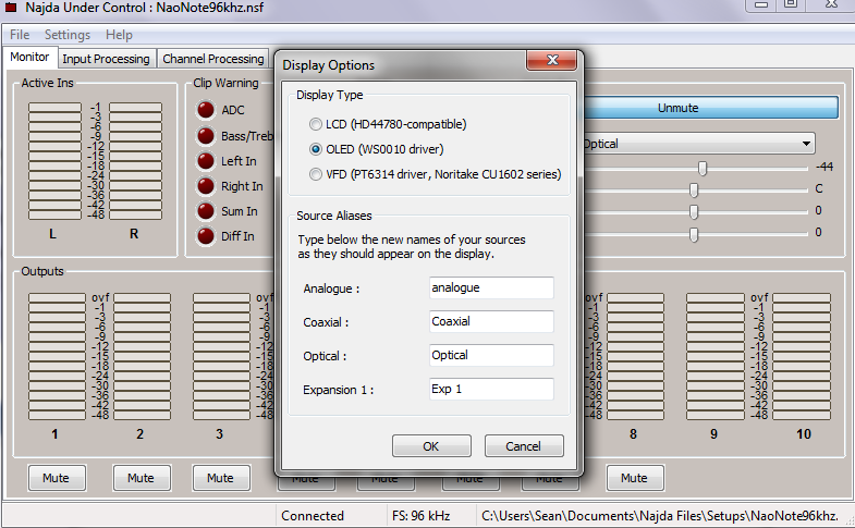

Aha, so we have the same display. When you configure the Najda for VFD, then you should see a Brightness option in the menu (4 steps). Also different graphics that eliminate the issue with the bottom line.
(yeah they all say HD44780-compatible but when you look at the details it's just not compatible).
That's great, I've configured the display for VFD, but didn't think to check the menu for any adjustment, just assumed brightness is fixed. So ya, there was one more step to increase brightness - well done!
